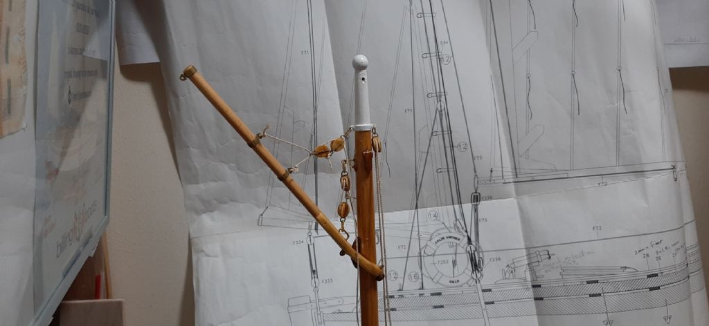

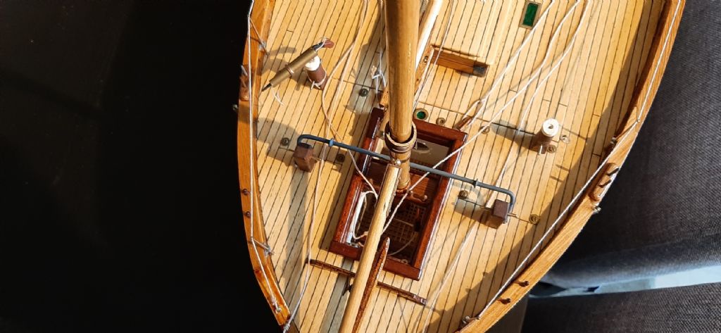

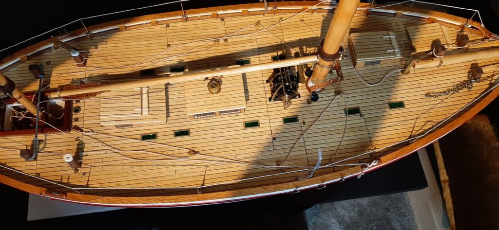

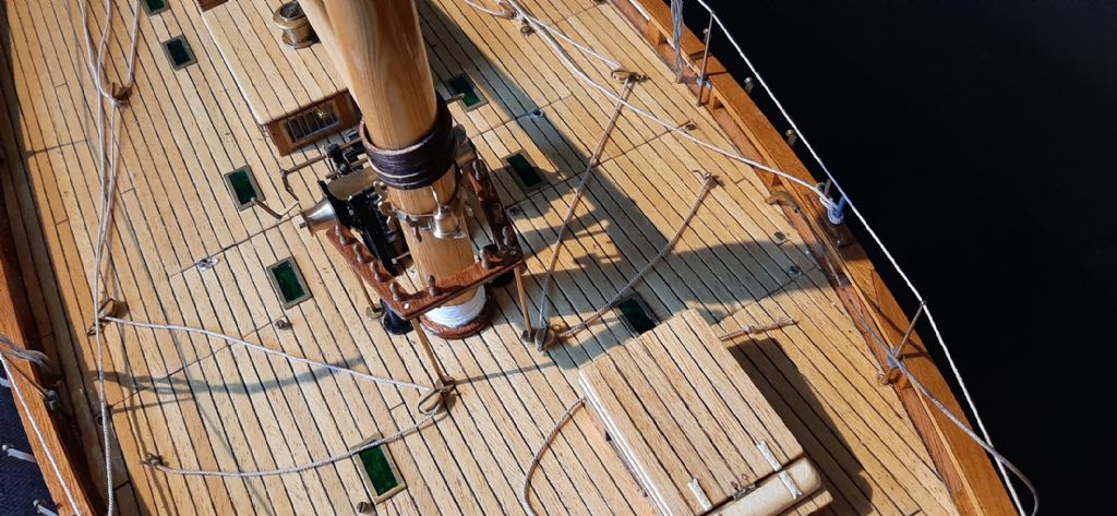

        Today I've been 'getting knotted' and 'all strung up'. Doing the running rigging on deck.
        Most of the brass is supposed to painted white. I would have painted it if the parts were plastic, but I simply do not want to paint over all that brass. It will of course change colour after a while…so maybe I'll paint it brass when it all takes on a greenish huesmiley.
        Posting a few photos of today's efforts.
        George

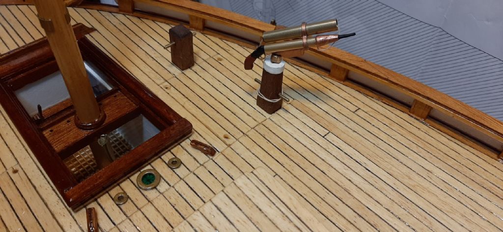

              I actually meant to write that I'd paint the brass bits WHITE if they went green-ish. But now that they are only going to be dull-ish brass I'll simply look forward to that process yes.
              I have in fact painted some steel screws and washers with brass Humbrol nr.54 (?) as below.
              George
              The three brass painted washers just forward of the steering well represent bilge pump outlets port and starboard. The large centre washer is a 'porthole' to allow light into the aft cabin to illuminate the compass which is placed about 1meter below decks. If you zoom in on the photo you can just see the compass rose which is drawn in pencil onto the deckplanking. 20220525_123923.jpg

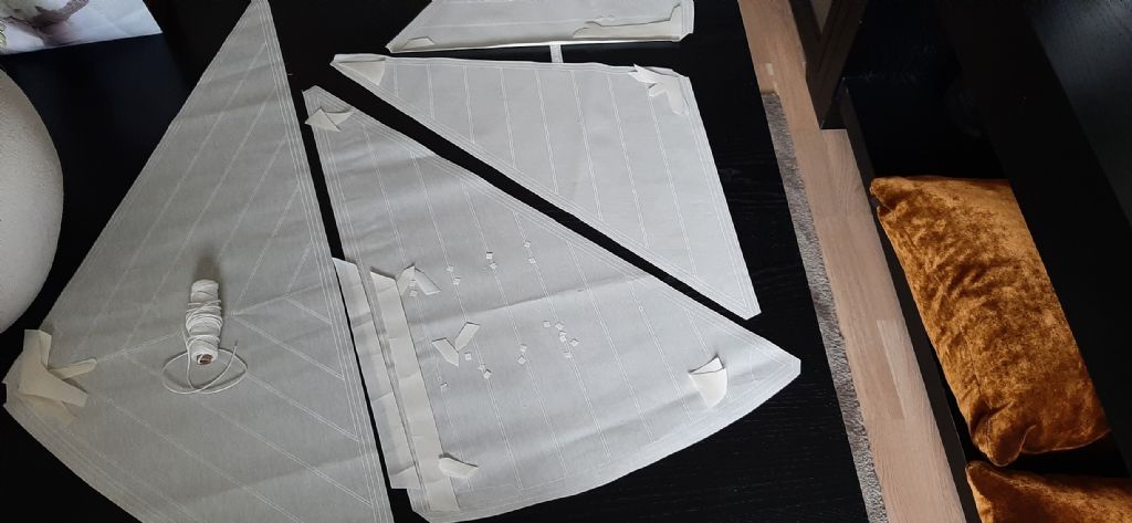

                I have at least prepared the sails for the sewing machine activity sometime next week. Cut out lots of small bits to be added by glue and stitches, later.

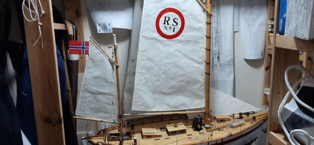

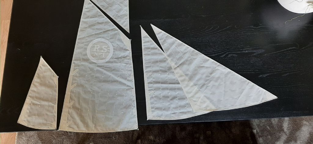

                      Sail-sewing session now completed. Only 6 days from course-start to fastening the last loose thread. That includes 20 hrs to repair the lifting lever failure on the sewing machine.
                      Used about 125 metres of extra stength polyester thread. Re-inforcing sections glued on with clear Universal UH Glue-hu, which is a sort of mix between contact glue and plastic cement. They were then sewn around the edges. Far from perfect, but good enough from 1 metre! I did not always have full control of the compass heading of the sewing needle you understand.blush.
                      Next up is how to make a decent job of painting the 'RS No 1' logo on each side of the mainsail.
                      Couldn't get high enough to include the whole of the topsail in the photo. Sailcloth is quite stiff -so a bit wringkly- don't dare to iron it in case it melts!
                      George

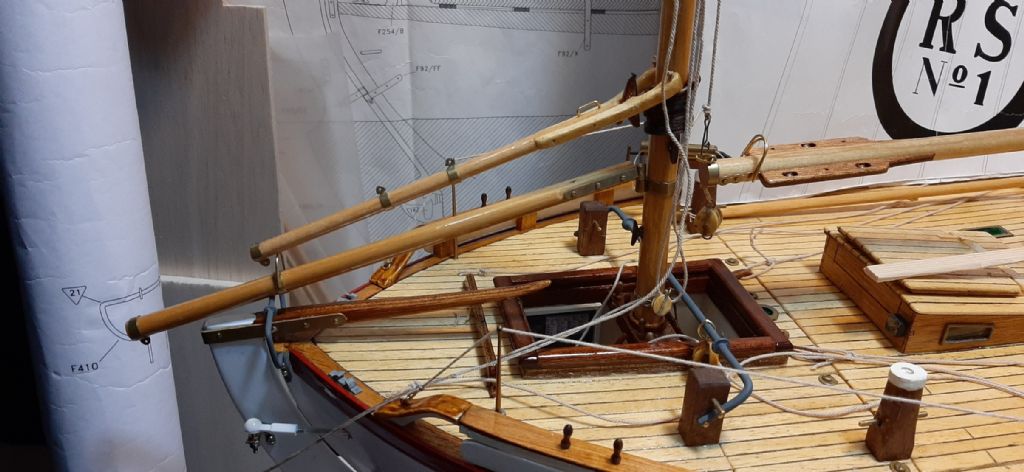

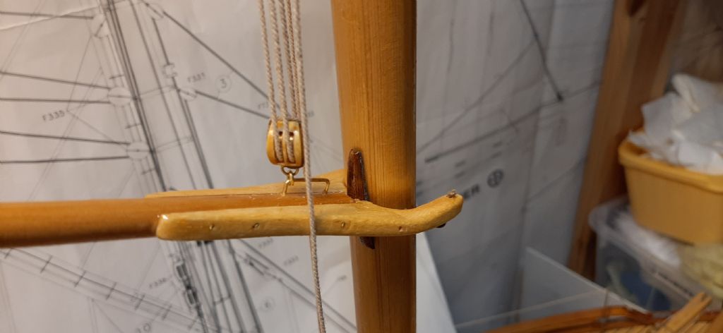

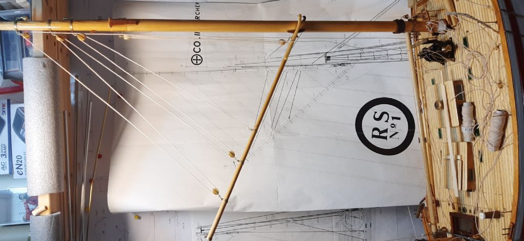

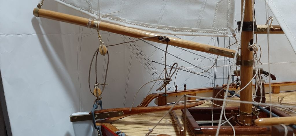

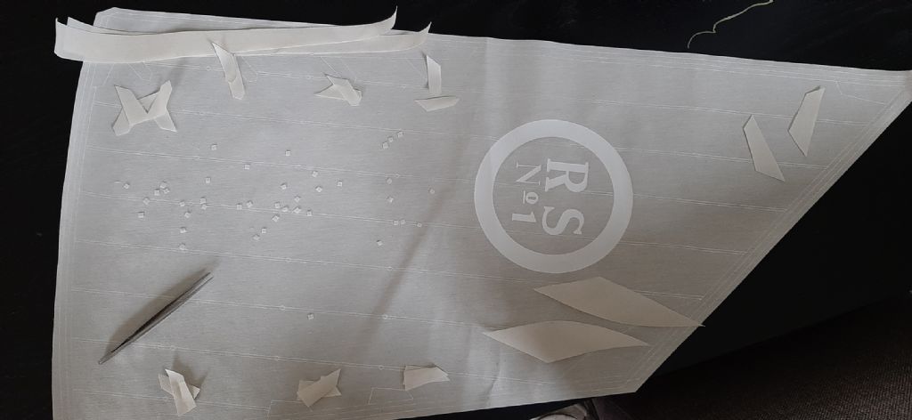

                                      Working at fitting the mizzen and mainsail. Very fiddly, but not difficult if you do it slowly -and take frequent breaks!
                                      The mizzen boom is attached to it's horse by brown-stained 1mm round elastic, threaded through the blocks. Doubled .5mm elastic is used to fasten the lower block to the horse. All this gives enough stretch in the system to allow the mizzen to self-tack softly. ie. without 'clonking' against the stops on the horse. It can also stretch a small amount if the breeze should pick up a bit.
                                      The main boom blocks are threaded with the supplied 2mm cord. The top block -right under the boom- has to be released to allow the mainsail servo to control the main boom.
                                      Painting the logo on the mainsail was a bit nerveracking. One stray drop of red or black paint would be visible from more than 1metre.!
                                      George
