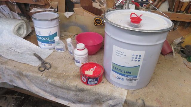

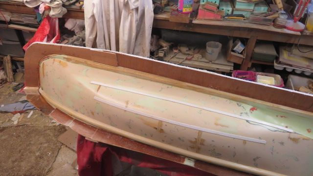

        The plug has now had 2 coats of wax, none silicon type specially made for mould release! It will have two more waxings tonight and then one tomorrow morning before a coating of release agent.
        Once the release agent it will be given its' first layer….the gelcoat, tomorrow night, as late as possible in a heated workshop, before laying up the chopped strand matting on wednesday morning.

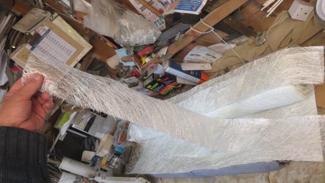

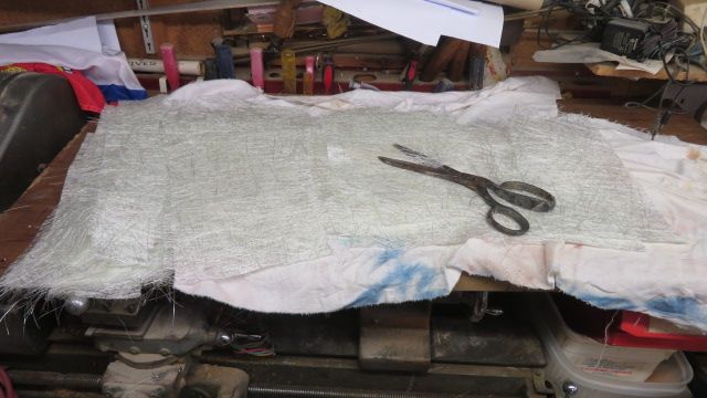

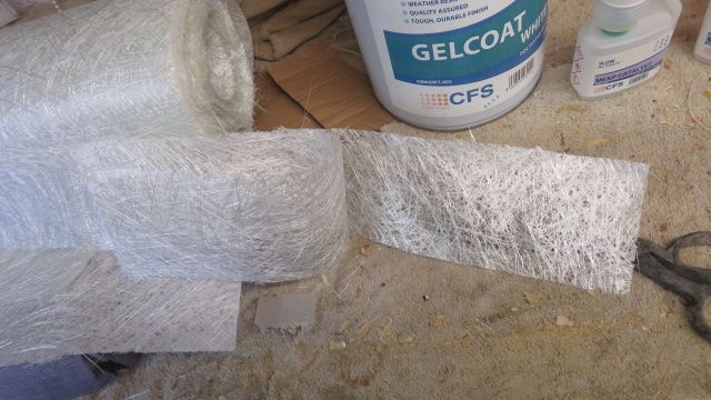

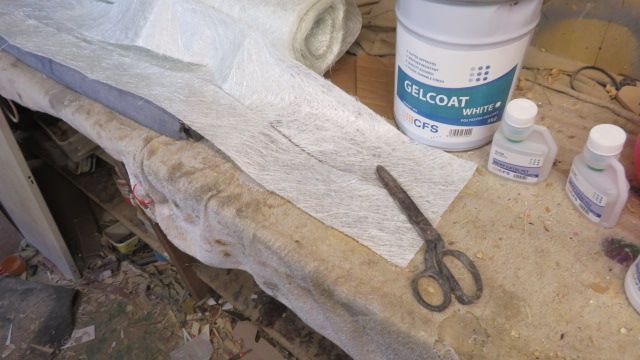

        This afternoon I re-organised a working area where I could lay out all the materials and start cutting the matting into strips, rectangles and triangles for the different areas of the plug to be covered.
        Also, I split the matting.
        I always order a heavier weave of matting as it works out cheaper in the long run, is easier to lay up without the hassle of getting a roller into tight areas once split into thinner sheets, and on tight curves such as working around the belting and into the tight groove made between the belting and the flance it is forgiving and never collects air bubbles, as long as you don't lay up too much whilst the resin is still "wet", especially when working with small width brushes to stipple the mat into the grooves.
        So!, from tomorrow its all hands on deck!, and no rest until the mould is finished by the weekend.
        And it was such a delight to smell that oudor of grp resin again….not done any glassing up for at least 8 years.

                  RIGHT!!!!!………ready for blast off!

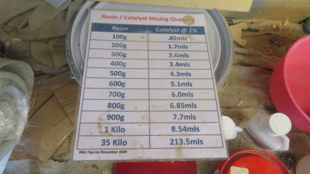

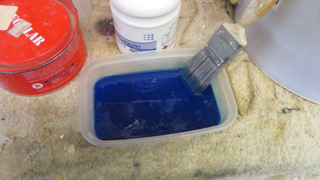

                  Dug out my catylist measuring bottle, my PVA, release agent, brushes and given the plug a coating of pva…..signed and sealed, belt and braces, the grp should now NOT stick to the plug.
                  I have found my measuring chart for catylist to resin ratio, and the most important sign I have in my workshop……..a remender NEVER EVER do what I did once in my early years of grp laminating…….I forgot in my haste to put the hardener into the resin……and a whole side of gelcoat went on a plug……..never in a month of sundays to harden!!!
                  It took me a week of cleaning, wiping and removing a very sticky mess from a plug…….AND THEN I had to re-do the plug with all the preperation spent on it before my stupidity had kicked in, in haste.
                  I certainly learned by that mistake.
                  So tonight I will lay up the gelcoat, making sure that the pva release agent has dried thoroughly, and then I have 24 hours in which to lay up my matting and resin……..but hope to get it on within an optimum of 12 hours at the latest tomorrow morning.
                    I always order a heavier weave of matting as it works out cheaper in the long run, is easier to lay up without the hassle of getting a roller into tight areas once split into thinner sheets, and on tight curves such as working around the belting and into the tight groove made between the belting and the flange it is forgiving and never collects air bubbles, as long as you don't lay up too much whilst the resin is still "wet", especially when working with small width brushes to stipple the mat into the grooves.

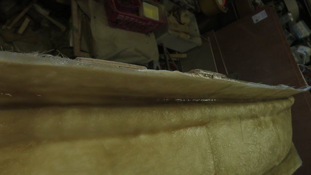

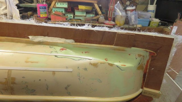

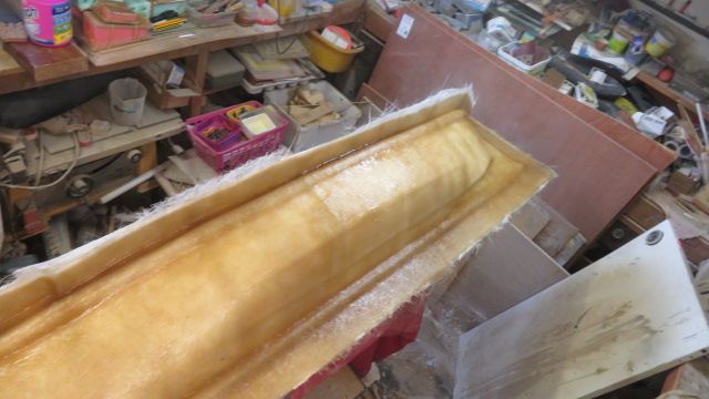

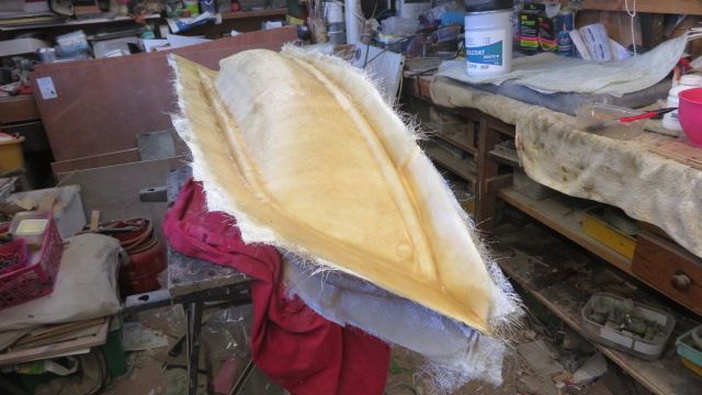

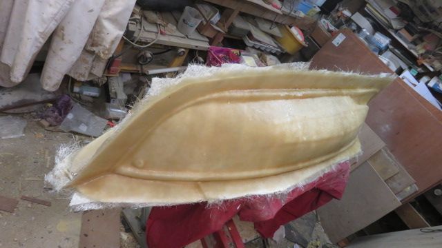

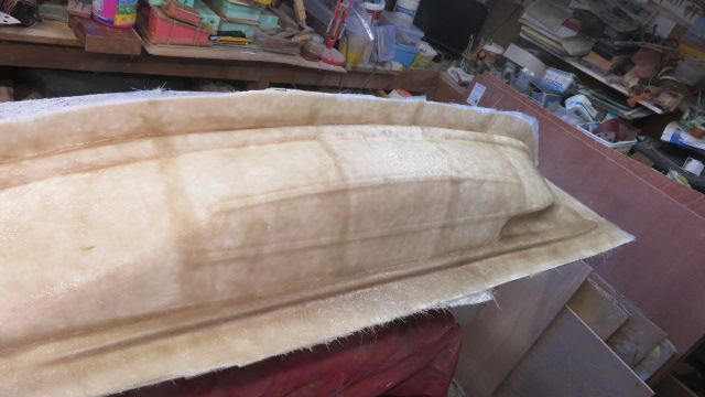

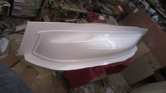

                          The first layers of chop strand matting have gone on to the gelcoat and very well stippled in to the sharp edges and corners.
                          i do this one overall layer first so that it doesn't get too thick and hide any air bubbles in the corners, and it looks prety well clear now with a good stippling of the matting and resin.
                          once this has gone off in about 30 minutes i can then make another mix of resin and hardener, and work through the afternoon to get a full complement of layers of matting on to the plug.
                          It will then be left overnight to go off and harden before i remove the keel flange and then waxing up the other half of the plug ready for starting the process again late thursday night/friday.

                            TIME FLIES when you are having fun???
                            Well it has done since I laid the first brush full of white gelcoat last night!
                            In all, taking in to account cutting the chop strand mat and splitting it into thinner sizeable pieces for handy laying down, the gelcoat mixing and painting on to the half side of the plug, and then two sessions of laying up the hull in two seperate sessions, the whole process of laying up that one side has taken me nearly 6 hours in total……….
                            But I am pleased with the result before my eyes, and if the mould turns out as good as it looks,

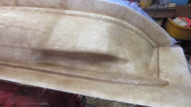

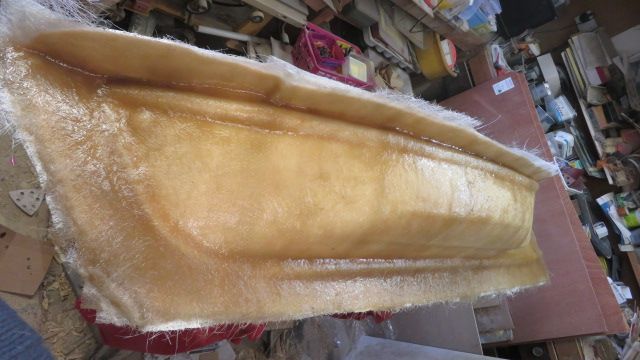

                            #102187
                              Apart from nursing little pooch as she has been sick in the night for some reason, but her temperature is fine and one more thing to clean up, the day has started well!

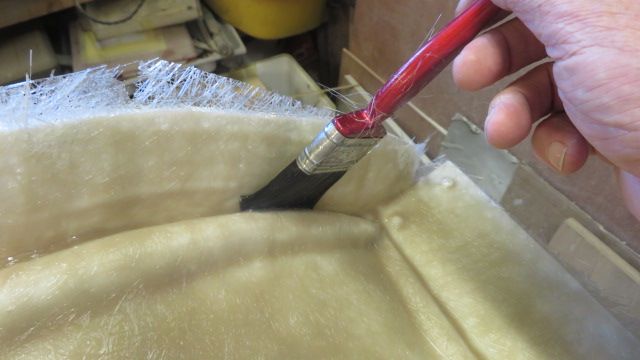

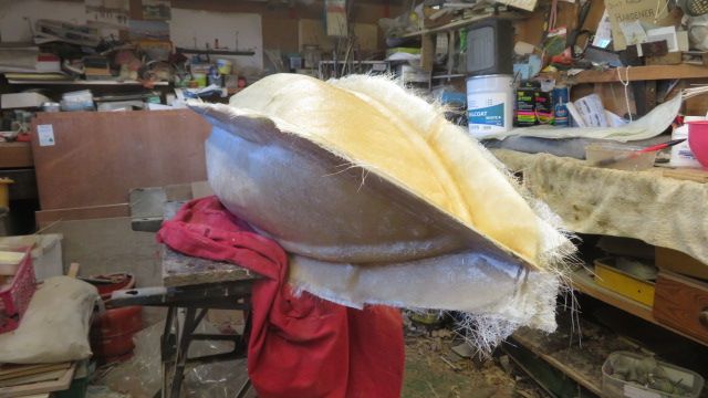

                              My first job was to run a sander all over the matting laid last night………why, you ask. Self preservation and to avoid pain!!!
                              You will, no matter how long and how hard you stipple or roll the surface of wet grp/resin, there will always be those strands, hardened by the resin that are just like needles…………..and hurt far more than steel needles when they pierce your skin, and break off under the skin, and so I always give a newly laid and hardened grp surface a good sanding with 60 grade abrasive paper……avoids pain and tears.
                              I started the mornings work by trimming the ragged edge of the grp on the top and ends of the flange with a grp blade fitted into the jig saw, and once done and then on to cleaning off the plasticine, whitetack sticky patches and pins from the other side of the keelson flange,
                              I then unscrewed the blocks holding the flange to the plug so that it was free to remove.
                              If the mould splits as easily as the first half and the flange did with absolutely no force at all using my nylon wedges on Sunday, job will be a guddun, as it just pinged off with no effort at all.

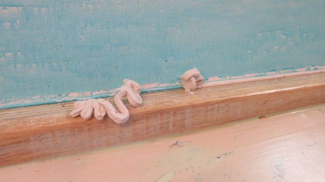

                              And then I scraped off the gap filling plasticine from the keel which has made a perfect line between keel and grp flange.
                              I sanded the top and side edges of the flange to remove any raised or sharp edges, wiped the flange with a soft damp cloth, and then brushed the dust and bits of sanding debry from the plug, and applied that sides' first coat of release wax. Another will go on in a half hour, followed by two more by lunch, hoping to get the release agent on sometime this afternoon. I can then get the gelcoat on this evening for the second half of the mould.

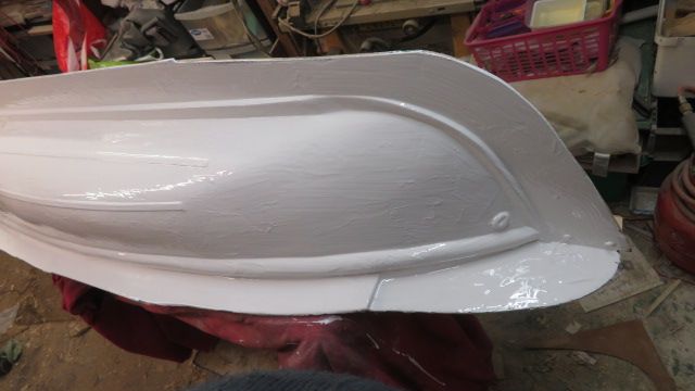

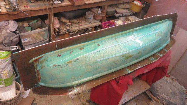

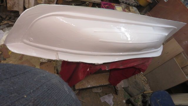

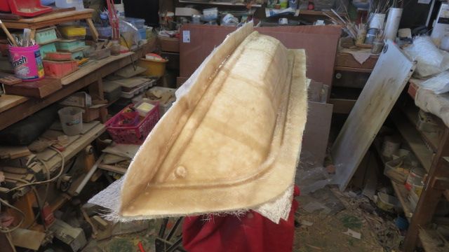

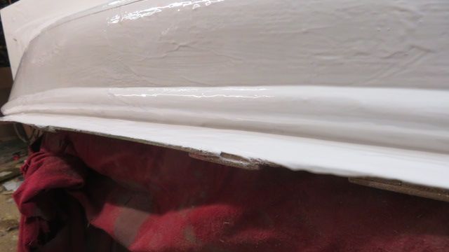

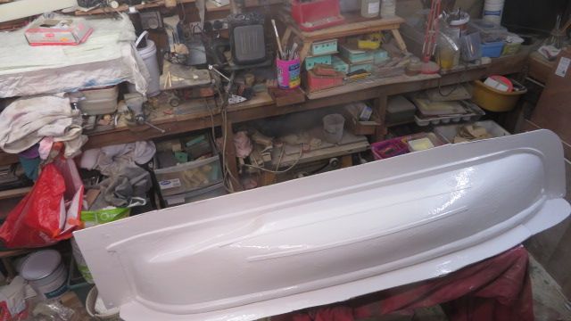

                                As forcast, the second half of the mould has now had its wax and release agent applied…………
                                And the gelcoat has been painted on to the plug.
                                If all goes well the chop strand matting will be laid up as was the first side, tomorrow, and then left to cure over the weekend, when by Sunday afternoon, I'll trim off the waste and some of the flange down to a narrower strip all round and then drill the flanges, whilst still attached to the plug for the coach bolts to eventually hold the two halves of the mould together, for the process of laying up some hulls.

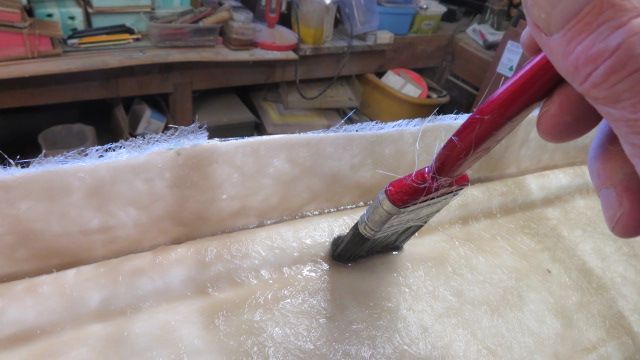

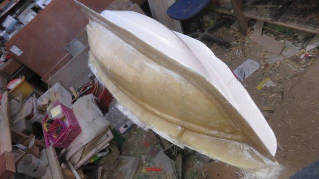

                                  Well, that is it!
                                  Both halves of the hull have been glassed up, and tbh have both gone smoothly with no problems, and these will be left as they are until sunday afternoon to cure well in a heated workshop ……hate to think what the lecky bill will be like next month…..but hey ho!

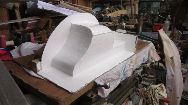

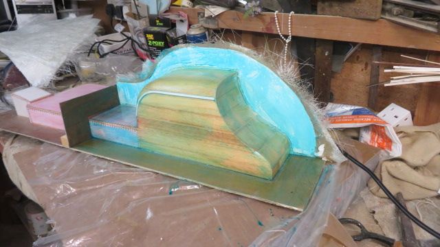

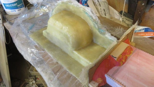

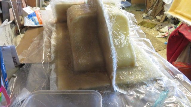

                                  Tomorrow i will concentrate on the mould for the cabin which is ready for glassing up as it has been waxed………just needs the blue release agent adding.
                                  And this 3rd below will be the first section of the cabin to be laid up.

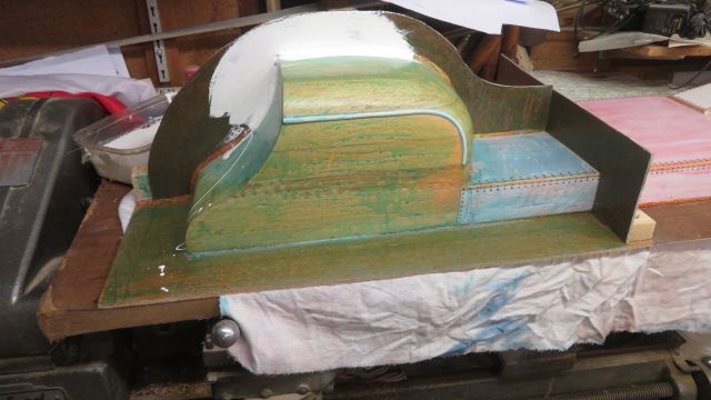

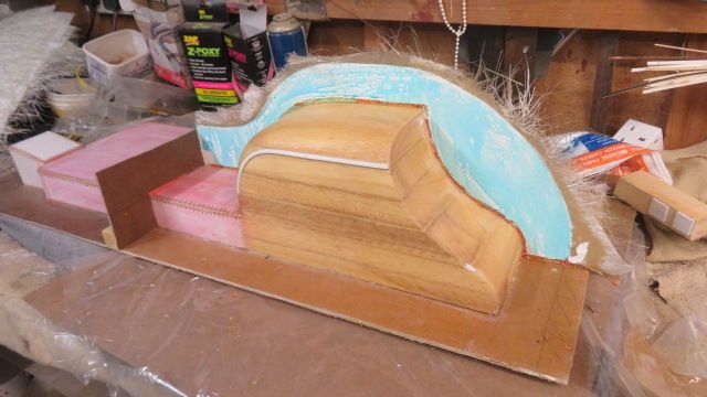

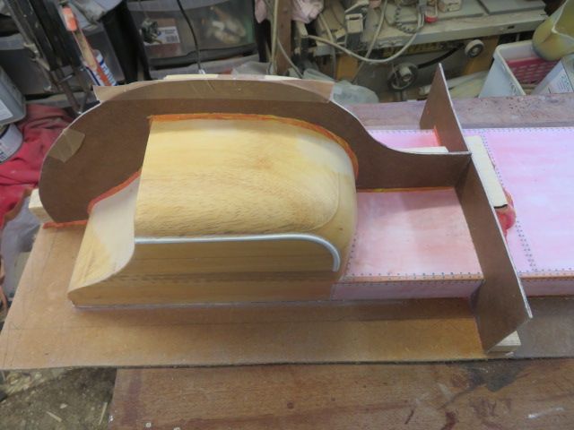

                                    And now that the main hull mould has gone off and started it's curing process over the next couple of days, my attention moved on to the cabin/engine casing plug.
                                    I had waxed it a few weeks ago and this was still obvious to the touch, and so I painted on the blue release agent.
                                    Once it had dried I applied the gelcoat to the read starboard side, amd tomorrow will lay up the chopped strand matting to that area.
                                    On a charge now, and hopefully should have this mould completed by sunday night.

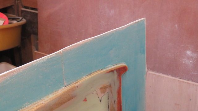

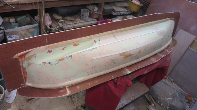

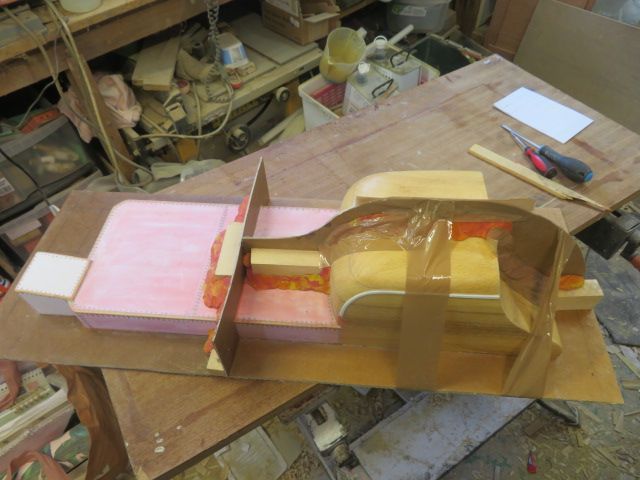

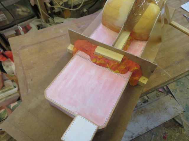

                                              The flange has been removed from the aft part of the plug, and….
                                              The Second side of the plug is now ready for laying the gelcoat as soon as the release agent has dried.

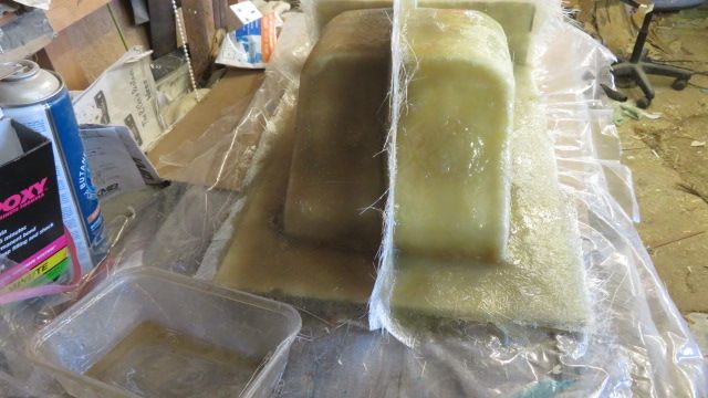

                                                    The second side gelcoated,
                                                    And all the chopped strand matting cut and ready for laying up tomorrow morning……..

                                                    #102259

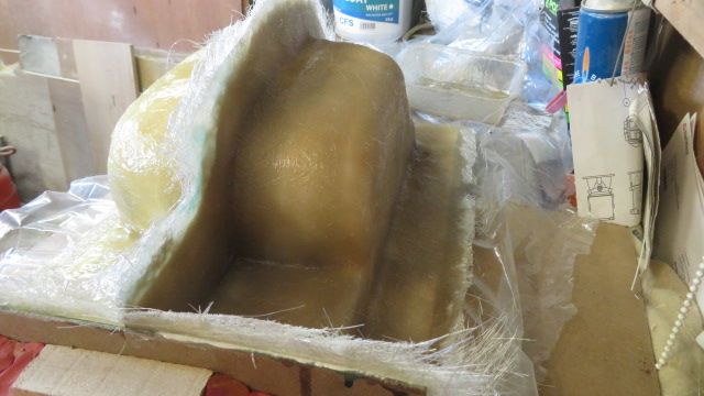

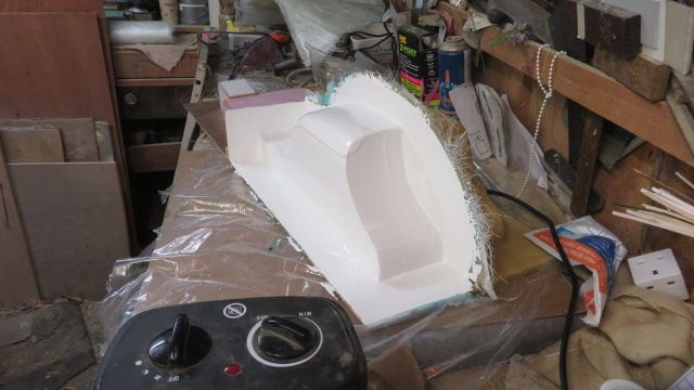

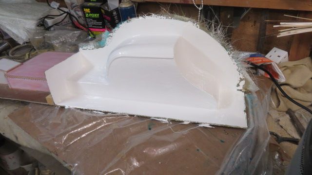

                                                      I'm almost there with the grp moulds for both the hull AND the cabin/engine casing for my new lifeboat model.
                                                      As the mould for the hull is in its final curing process under warm heat, it gives me the chance to work on the cabin mould.
                                                      I have laid up the 2nd of a 3 part mould for the cabin/engine casing, and also added an extra layer to the 1st part that I laid yesterday as it had very ever so slightly come away from the cross flange as it cured overnight……..and looked just a little thin. This will help it from anymore movement.
                                                      And this will be ready for stripping the final front flange this afternoon, and starting the 3 part process of release agent, then gelcoat and final layering up of chopped strand matting late on tonight to go off over night,…..
                                                      That is a moment I will rejoice in, as it has been a long slog due to its' size and weight.
