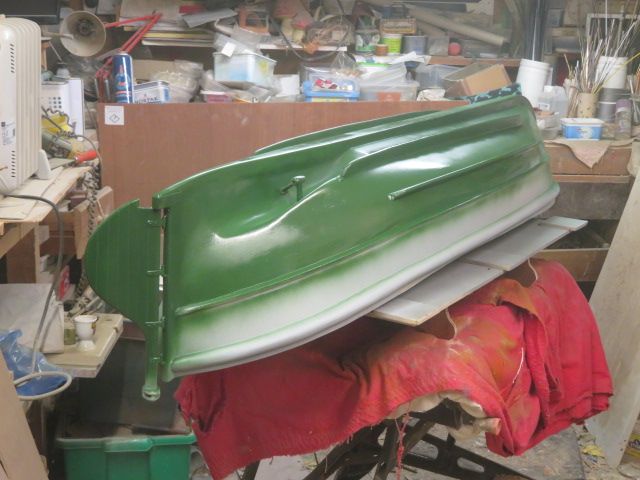

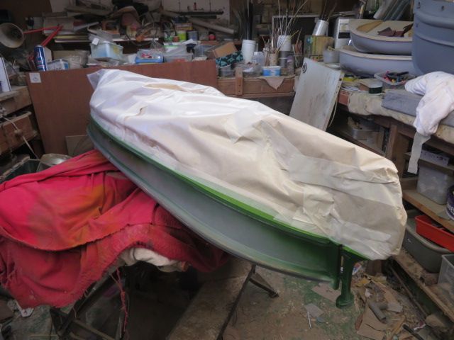

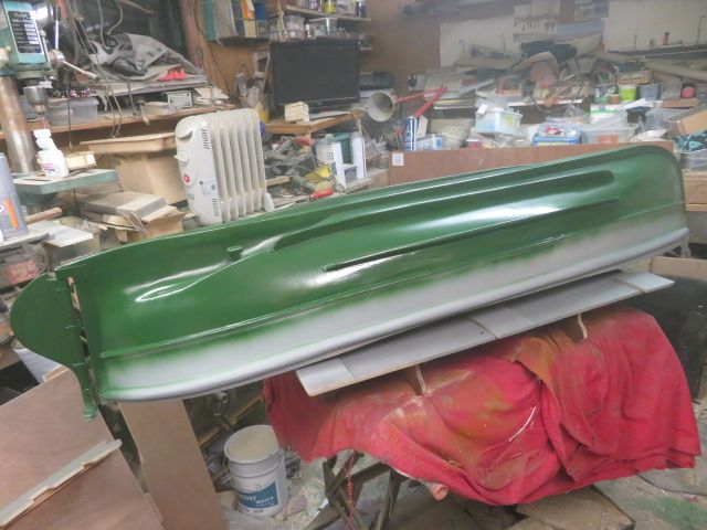

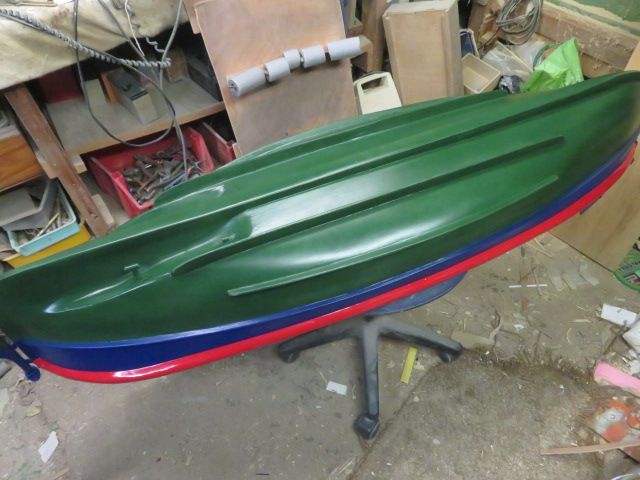

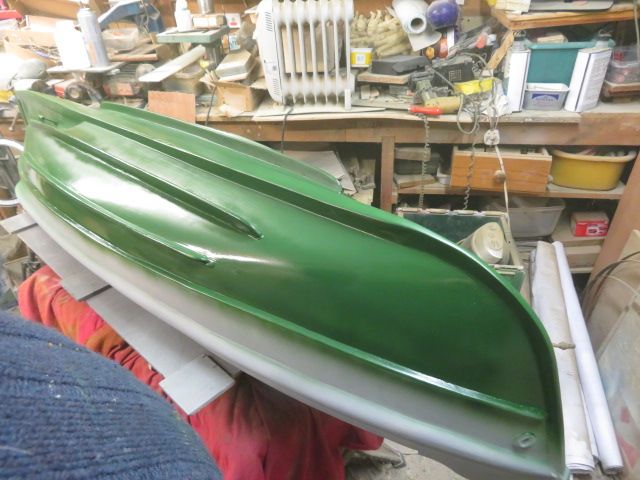

        The Laural Green anti fouling has gone on to the first boat with a nice rich lusture, bit too shiny under the lamps but looks ok to me.
        Will leave that now until I hopefully come back from the hospital on Tuesday, when I can mask off for the regatta blue above the water line and then starting the 2nd boat late Wednesday.

          Thats a different colour for anti fouling, very nice Neil.
          #104520
            Lovely job Neil. I've always been a fan of the good old fashioned rattle can for convenience and, you you've proved there, you can get as good a finish as a professional job with a bit of care and attention.

              Posted by ashley needham on 10/04/2023 08:55:41:
              I get asked this regularly Ashley
              Long before red lead for anti fouling and protection of both wooden and metal hulls, there was the grean leaded paints, and i suspect you live near or on the coast yourself……..remember back to your grand dads day, and think of the majority of houses at sea side towns. they were in the majority of having their wooden doors, windows, out houses etc always painted in mid to dark green.
              It was because a lead based constituant was added to the paint work to keep the salt sea air from rotting the woodwork!
              As with the houses, so were the boat hulls painted with green lead for anti fouling and protection against damage from sea water, up until the very early 1930's.
              Another fact that my grand father the master cabinate and pattern maker told me as a young boy.

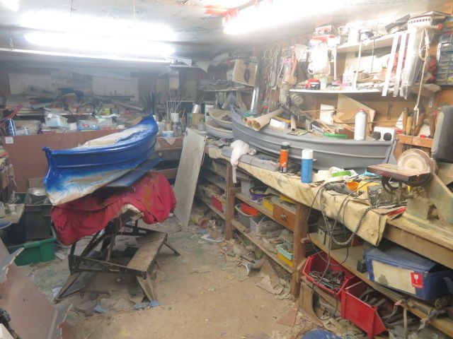

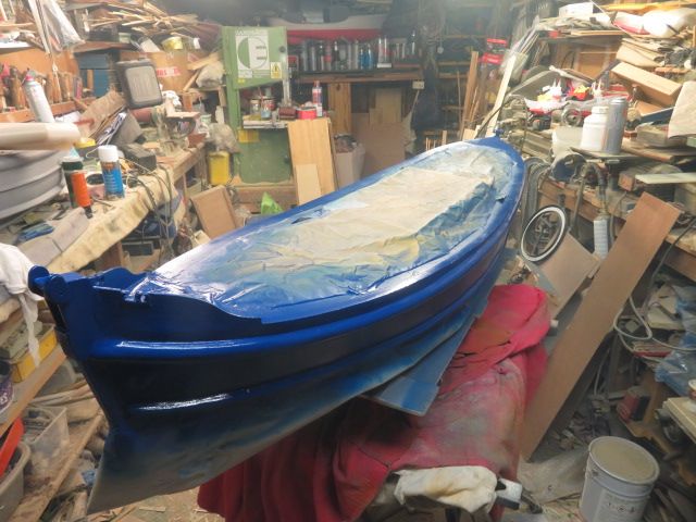

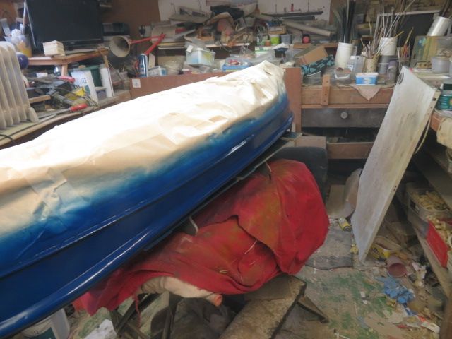

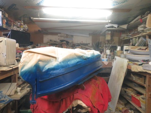

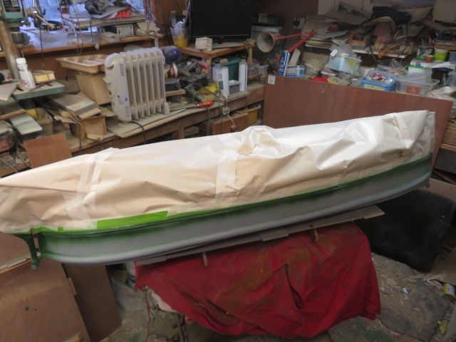

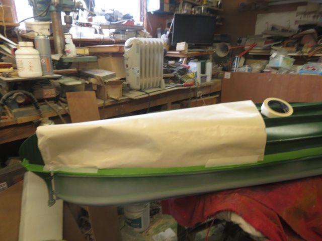

                      I have now masked the bottom half of the boat up including the rudder, with a roll of parcel brown paper and masking tape.
                      And then I sprayed the upper part of the hull with the Vauxhall Regatta Blue,that I had mixed at a UPOL station, a lighter blue than the more modern Oxford/Baliol Blue that is used on lifeboats today!

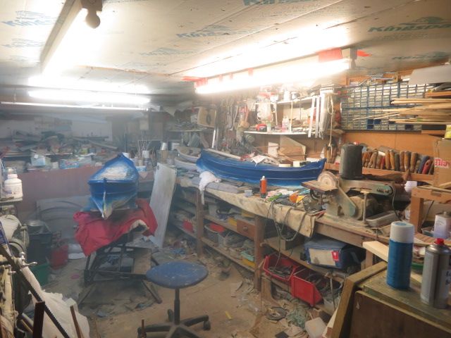

                      #104529

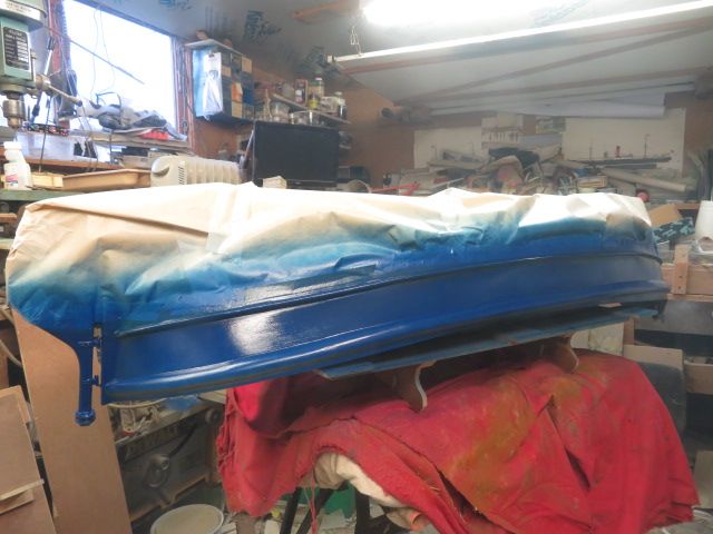

                        One down, one to go!
                        The two major colours have now been applied to the Princess Mary, and hopefully I'll feel cheary and positive enough to start doing the same to the William and Kate Johnston.
                        I will then leave them until the weekend for the paints to cure and harden before I apply the red to the belting, and the white boot topping.

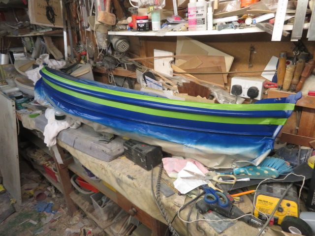

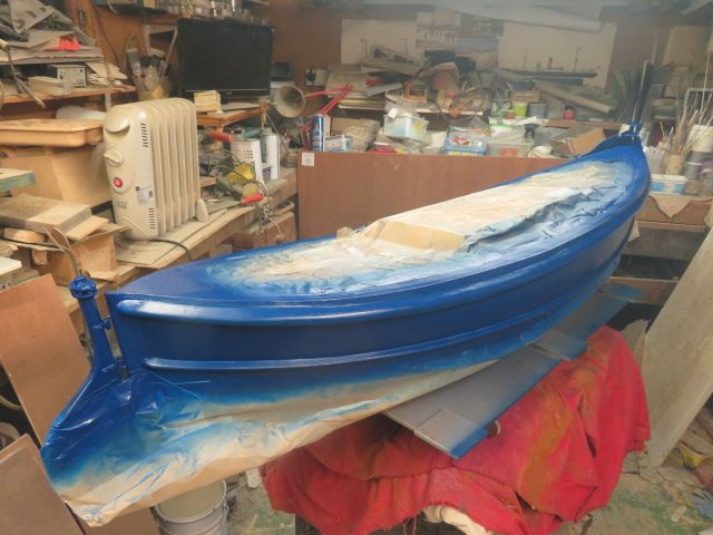

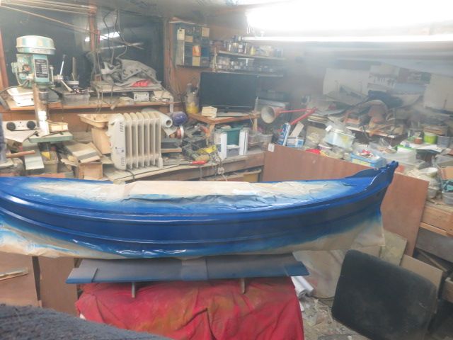

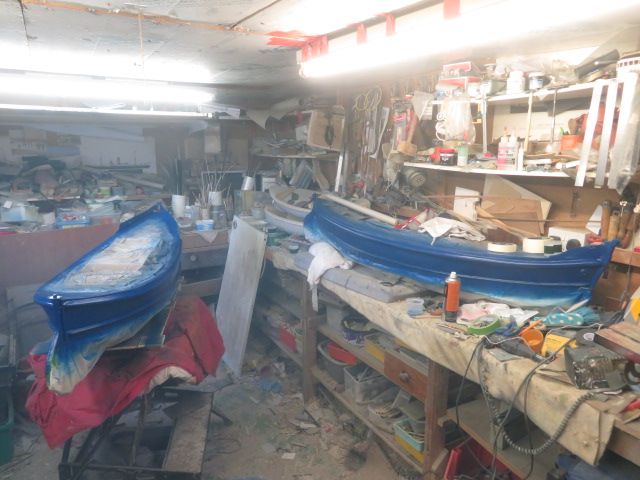

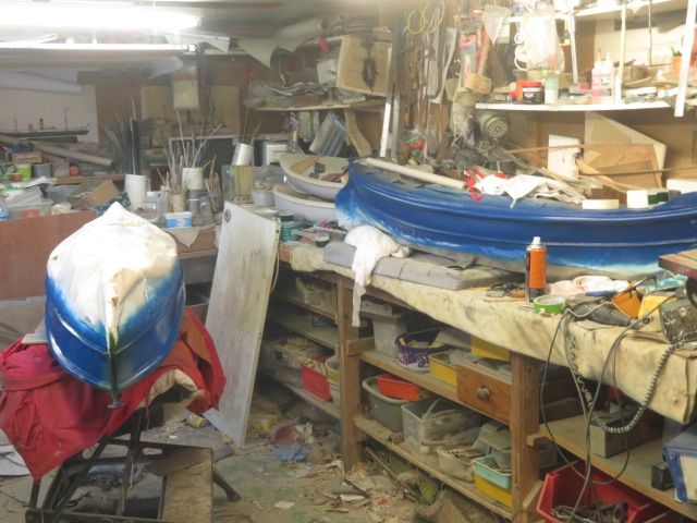

                            Second boat has been masked up and the Regatta blue applied to the upper part of the hull.
                            First layer on, and I'll apply the second layer in an hour or so.

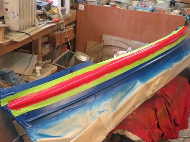

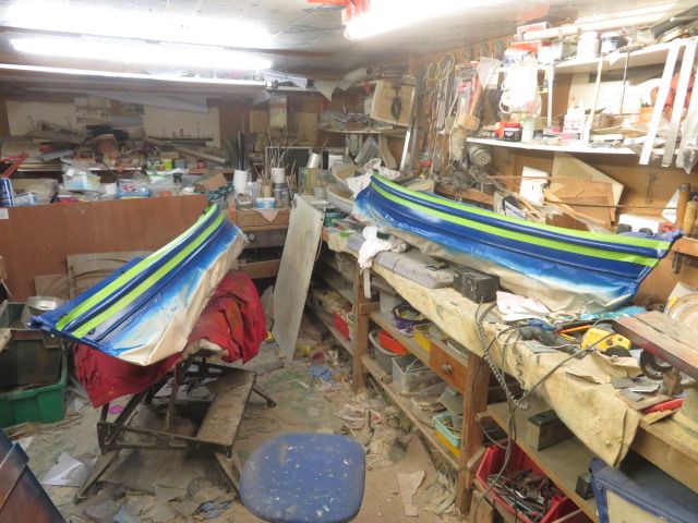

                              both done, and hopefully later tomorrow I'll be able to mask up and follow RNLI practice of painting the upper belting bright red.
                              #104553

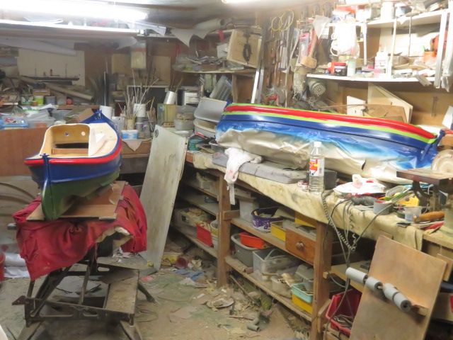

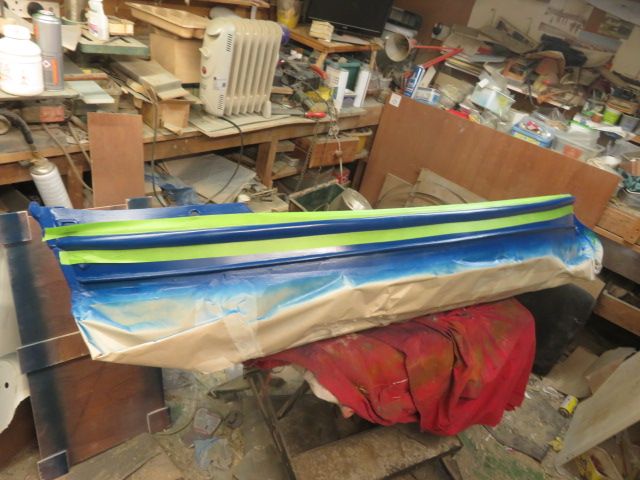

                                And now, the top belting has been masked up for my final piece of painting on the hull, the masking up of the upper main belting ready for painting with Humbrol no.19 gloss red enamel……
                                time to dig out my artists mohair soft brushes.
                                Hopefully I can start those tomorrow evening!

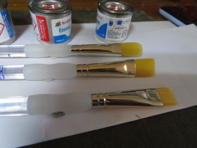

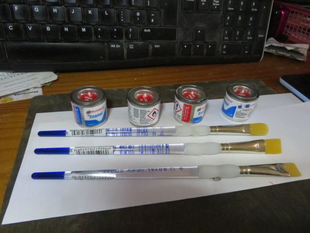

                                  I went out to our "local" artist shop in St Annes this afternoon for some new brushes.
                                  Thought the two models deserved some, and bought 4 tins of gloss 19 humbrol red, which I have used before for the belting on almost every model of classic lifeboat I have built.
                                  Bought some nice soft "squirral" hair brushes, two straight cut, and one rounded end brush for the extreme ends to the belting.
                                  I will get started on the four belts tomorrow, hopefully finishing by putting on the white boot topping by early evening.

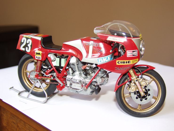

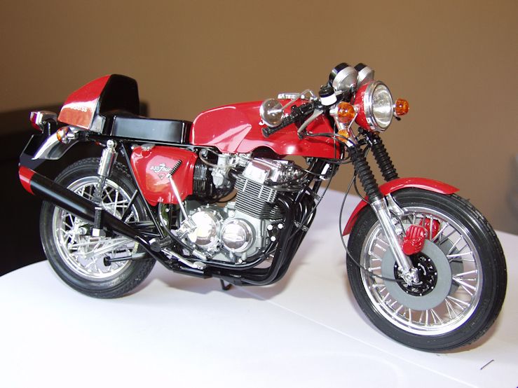

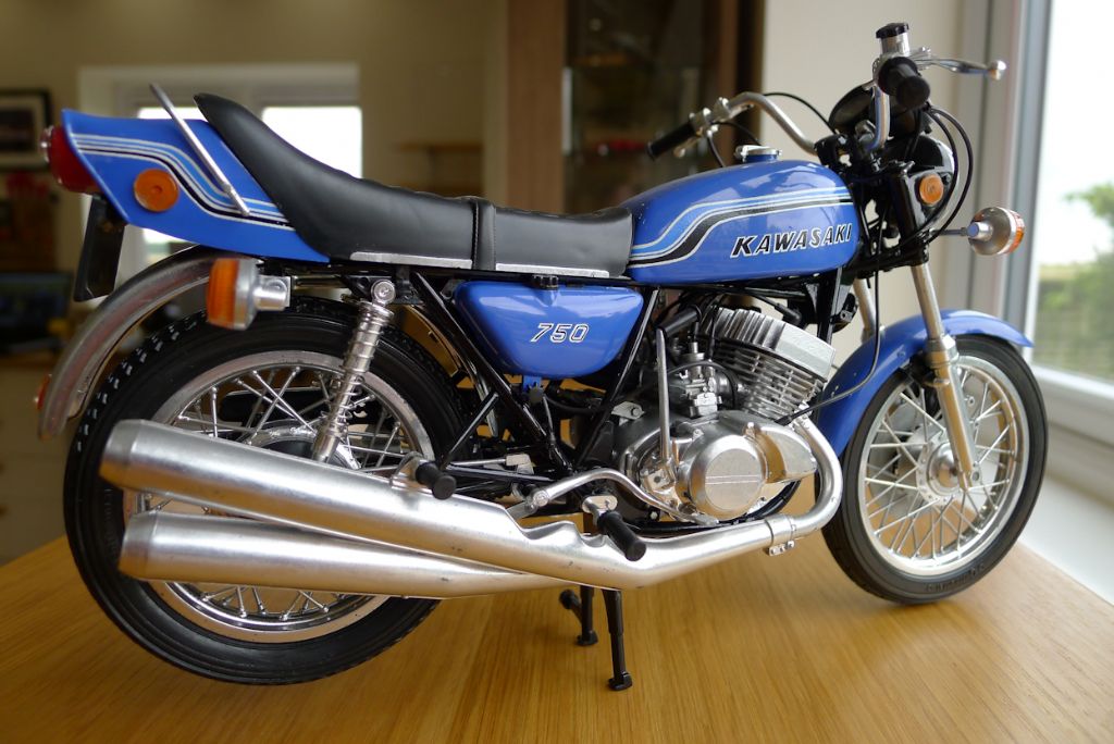

                                    Neil, In my younger days I frequently built motorcycle models, mainly Tamiya 1/12th scale and Heller 1/9th scale kits. This is in the days when they were a fiver! Anyway I could afford the kits but no way could I afford air brush gear so the only way I could paint them was by brush. Consequently I did quite a bit of experimenting to get the best finish by brush. At the end of the day the process I adopted was to A) Always use a brand new soft flat brush for the final coat and B) Always use a brand new tin of paint. I then started by washing the brushes out in clean new thinners to get any dust out of them and mixed the paint for a very long time.
                                    After many discussions in those days with fellow modellers regarding the time and money I was apparently wasting it is so good to see you confirming that such procedures are worth doing! It's taken around 50 years but I finally feel vindicated.
                                    The Kawasaki I built as a teenager and the Suzuki I built during my first trip to sea in 1977.

                                      beautiful bikes, and superb painting Richard………..they look brilliant. do you still have them.
                                      Remember the suzuki and the Duke from my days of following GP racing, but cant for the life of me remember who rode Suzzi no.10 as Sheene rode no.7 but did Foggy Fogarty ride the Duke………….havent a clue who road the Honda, and always remember the MCN saying in the road test of the "widow maker" as the Kwakka was dubbed, that she was the fastest bike between petrol stations………..on a hard ride she used to return an mpg of just 17 – 20…..but what incredible bikes they were especially when triumph and norton "superbikes" as they were regarded as, the Trident and the comando were light years behind the Jap bikes.
                                      I owned for just 4 weeks whilst in Australia, a Comando 850 Interstate, and what a bag of shackles that was……..soon moved on to a BMW R90s before leaving OZZ……….. and that was a nice bike, great handler and beautiful ballance on ozzy dirt track roads.

                                        As Neil says you have made a lovely job of those and if it wasn't for the spokes being a bit fat they look just like the real thing, especially the last one. Never got into bike kits because I could never find ones of my own bikes! One bike I had of that era was a 1980 Yamaha XS850 which got me hooked on triples so I had a few Triumph triples after that, modern ones. I have a 1973 Triumph Tiger 750 twin but the rest of my bikes are more modern.

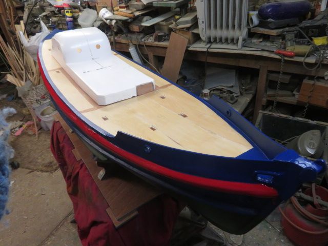

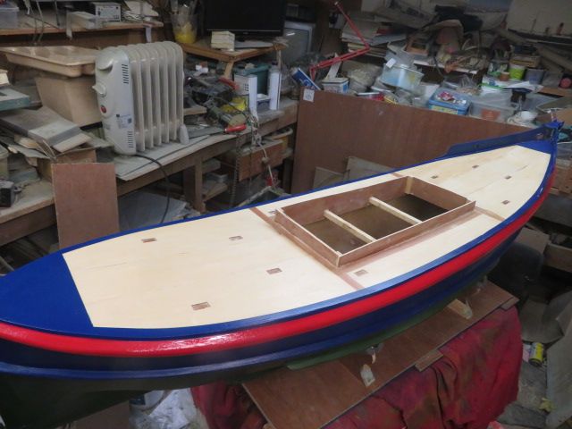

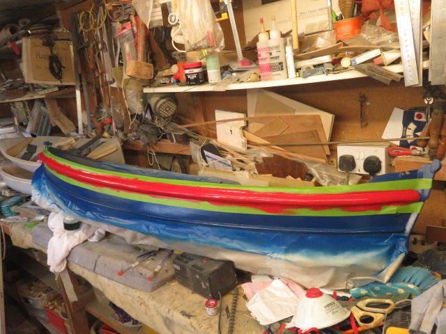

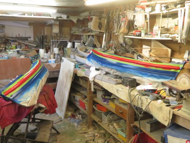

                                          Painting of the upper belting has begun.
                                          They are so large and heavy that I am painting just one side at a time until finished and dry. I will then turn them round and paint the second side tomorrow.
                                          One small pot has done two layers of paint so far on both boats, and probably a final coat this evening after my nightly dose of M*A*S*H…………EVERYTHING stops for that prog, lol.

                                            Is the red painted straight on over the blue? If so I guess it's because they are similar colour densities? Just wondered because I painted a couple of my Fairey hulls all white and didn't think I'd be able to overpaint part of the hulls with blue because of the colour difference.

                                                yes straight over Chris, but it needed 3 coats to get a full even cover……..i'm sure wih a white base, you might only beed two coats………but its just trial and error.

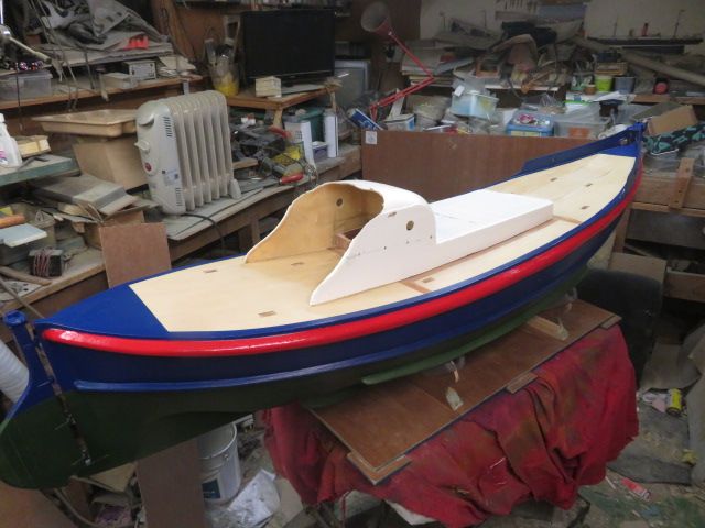

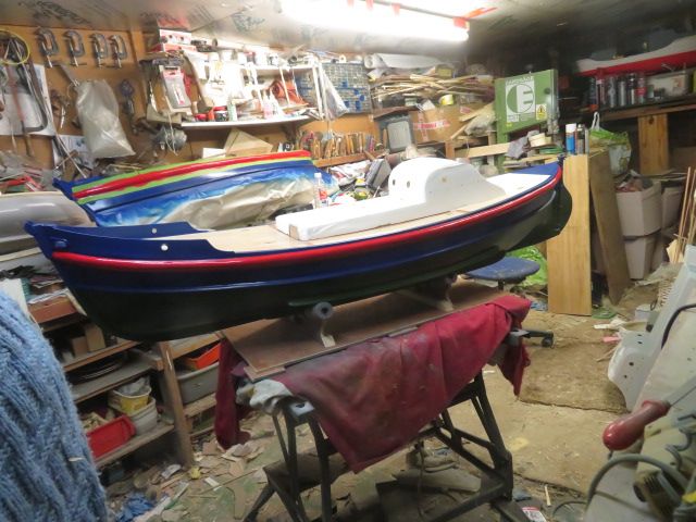

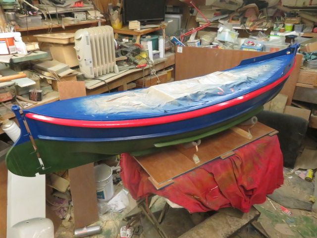

                                                      WELL, for a crap painter as I call myself, I am quite pleased with how the first of the two Barnetts has come out this evening.

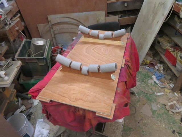

                                                      And now pearched on one of the stands that I prepared earlier with pipe lagging to stop the hardened anti fouling from scratching on the bare ply uprights, I slowly took off all the masking from both the hull and the deck, and I like what I have done.
                                                      That is all that matters to me.
                                                      I will be adding some hull fittings and painting the bow gobeye ports and rope ports, plus some exhaust ports and water inlets under the hull bottom and add the boot topping tomorrow hopefully, before I can start on the second boat the same.
