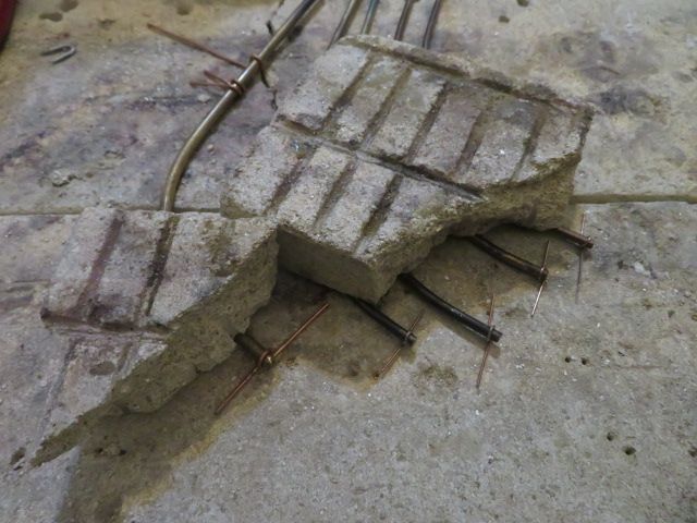

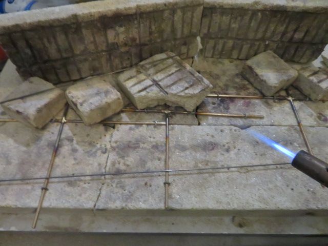

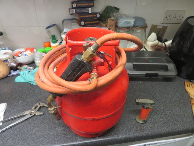

        I am almost out of propane gas for my brasing torch, so got my weed burner out, and along with the heat from the propane torch, and the butane grass/weed burner i had enough to aneal the brass rod to end them into 3 sets of Jumper net "davits" and the davits for the anchors. I will make the rigging rings and cleats to solder on to the davits tomorrow, and if [as it says] the weather warms up at the weekend as our illustrious and disbeleavable meteoralogists predict, I can silver solder them all up ready for eventual rigging.

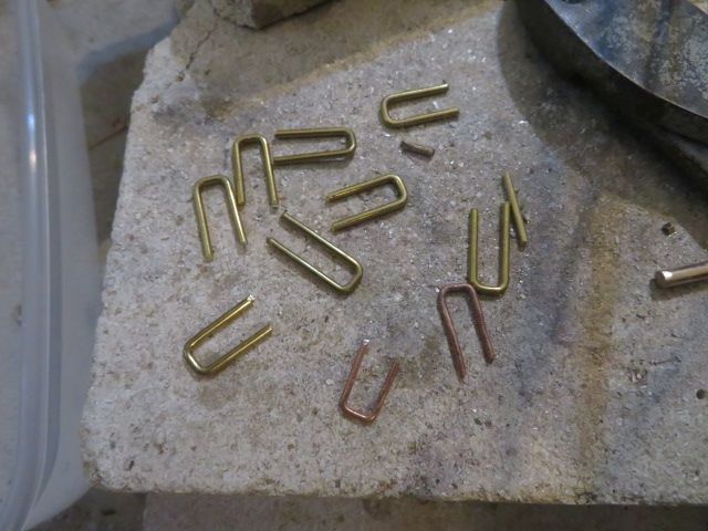

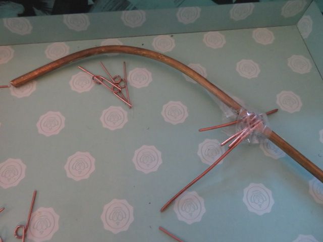

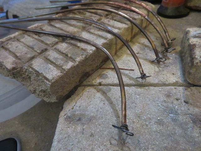

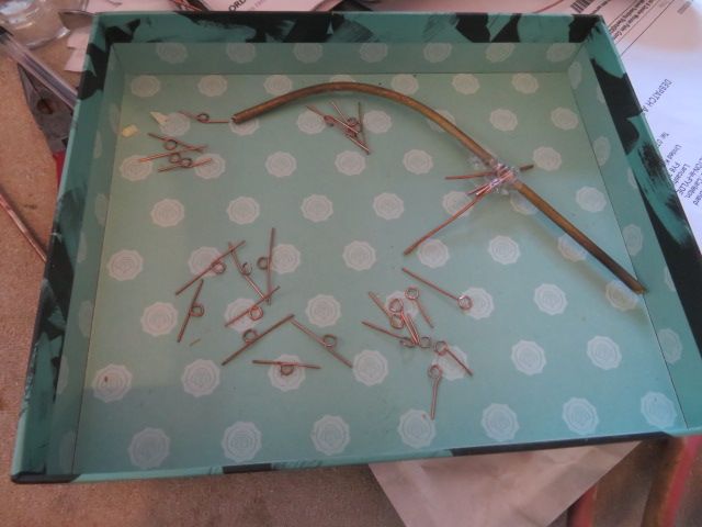

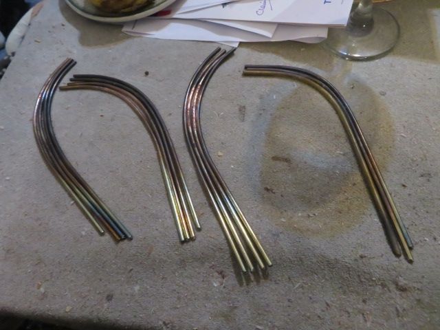

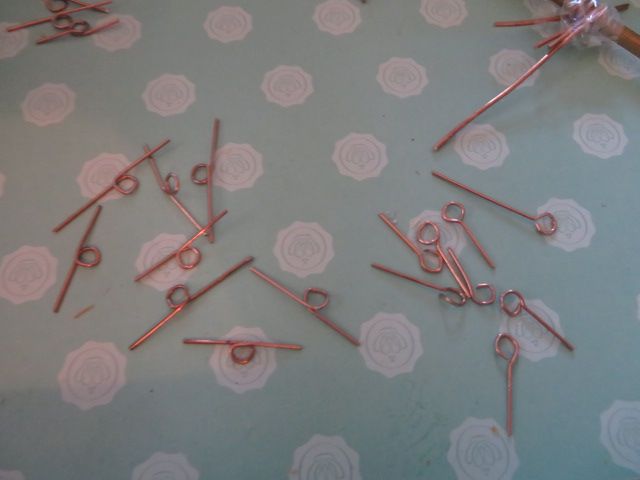

          So reverted back to a small but labourious job of making the support rings and fittings for the jump net stanchions..
          Nearly 2 hours of bending copper wire for the 3 sets of stanchions and the 3 sets of anchor davits they will be ready to silver solder on to the uprights as soon as I have bought some replacement propane gas for my torch and got the garage up to a tropical temperature lol.

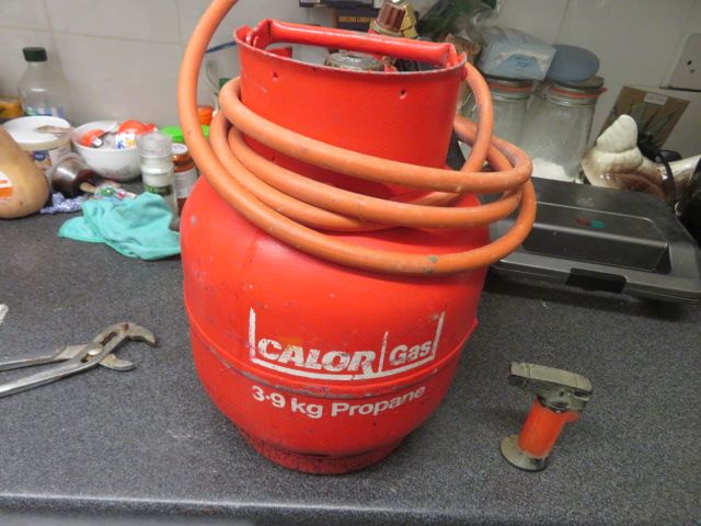

                SUCCESS!!!…….I have found a stockist of Calor Propane that has exchanged my almost empty and 10 year old bottle for a new full one.
                The problem I had was that it was only a 3.9kg bottle, and they are as rare as rocking horse poo………but as this one lasted me ten years, the new one might outlast me……at least in the modelling world, lol.
                I can at least now do some silver soldering of my bits and pieces, and once I have done all the silver soldering, i will then start sanding the hulls smooth ready for building.but that might be after Christmas.

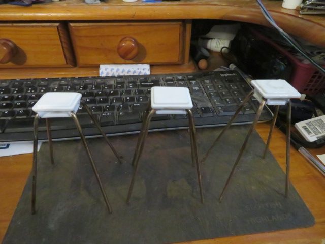

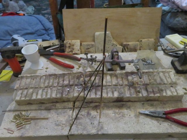

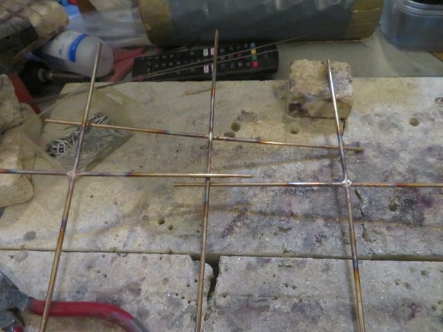

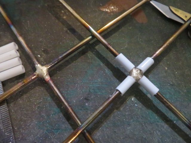

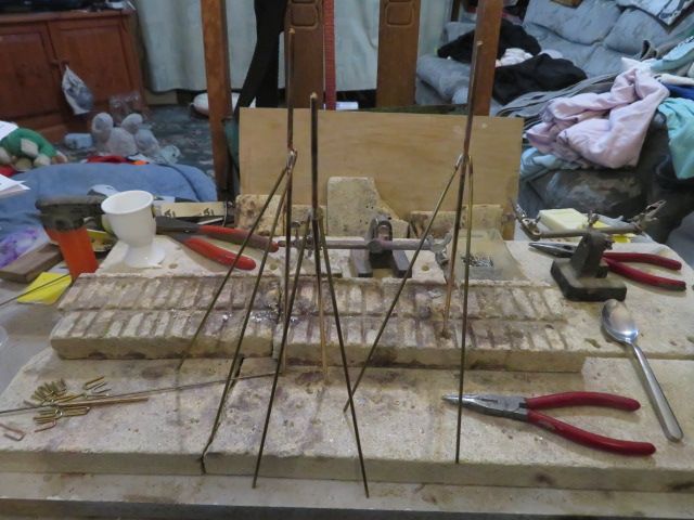

                  I sat there tonight in the warmth of the house, watching TV, [NO NOT the world cup] thinking if i were to wait for the temperature to rise enough to work in my workshop i might be sat here until next spring.

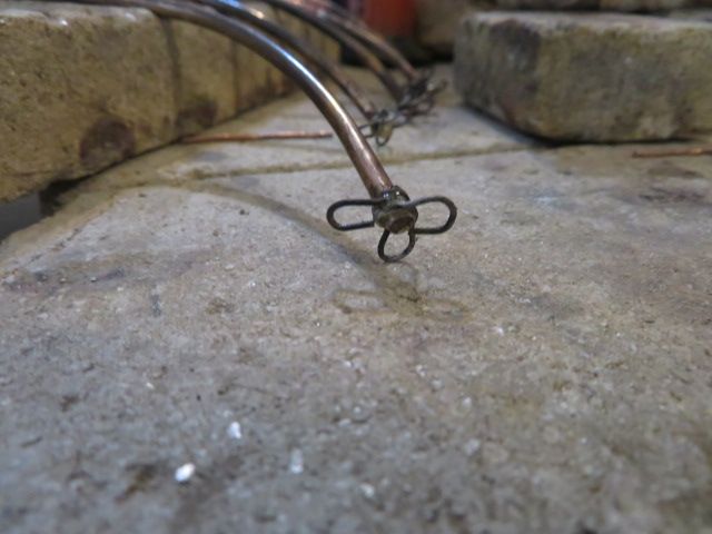

                  And so i brought in my gas cylinder and hearth bricks that are capable of taking up to 1200c and decided to start putting the aft search light tower together and soldering the eyelets on to the Jump net supports using silver solder.
                  Very fiddly and very annoying, but eventually got two of the three sets done before i got fed up and will leave the 3rd set until tomorrow night, before soldering on the tying cleats for the davits.

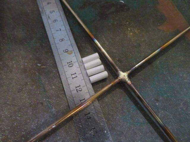

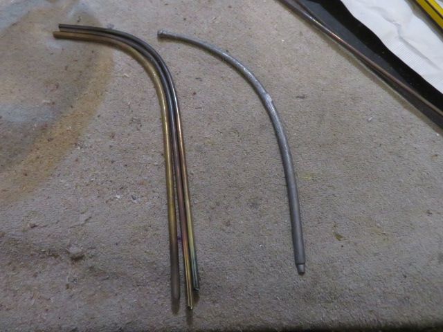

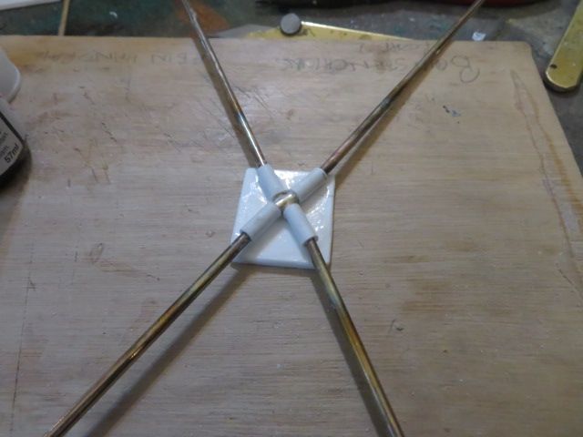

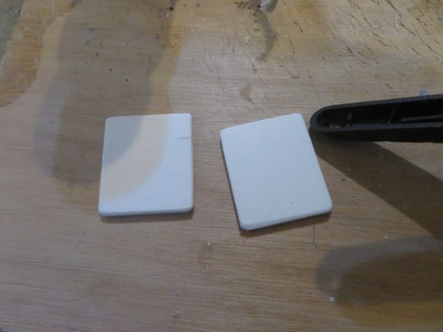

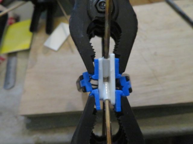

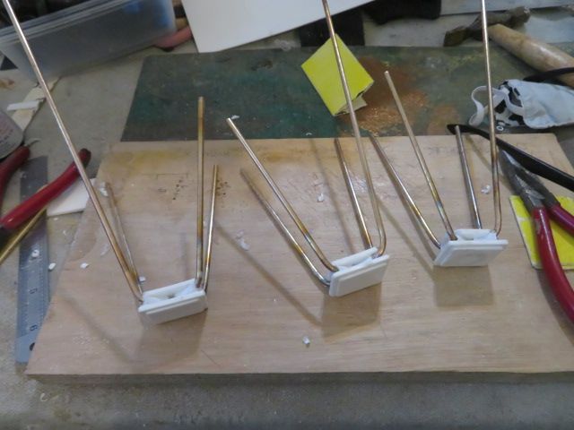

                    I placed plastic tubing to the centre of the cross on each of the quad legs for the searchlight platform this evening.
                    Then placed a top and bottom [from 2mm plasticard on to the plastic tubing, trapping the brass brazing rod inside the structure, and finally placing a thinner 1mm raised panel on to the top of the platform on which the searchlight will sit on the aft end of the boat.

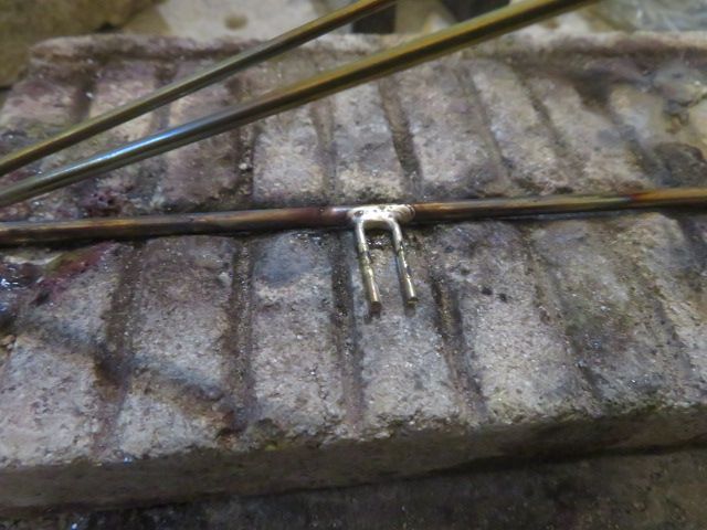

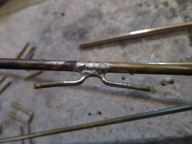

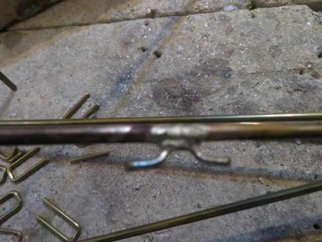

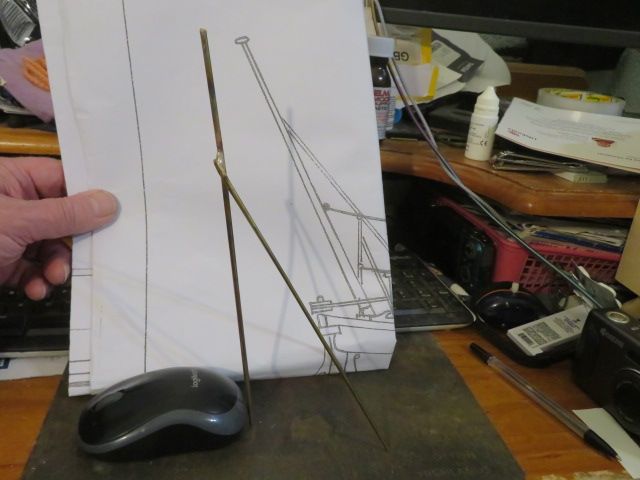

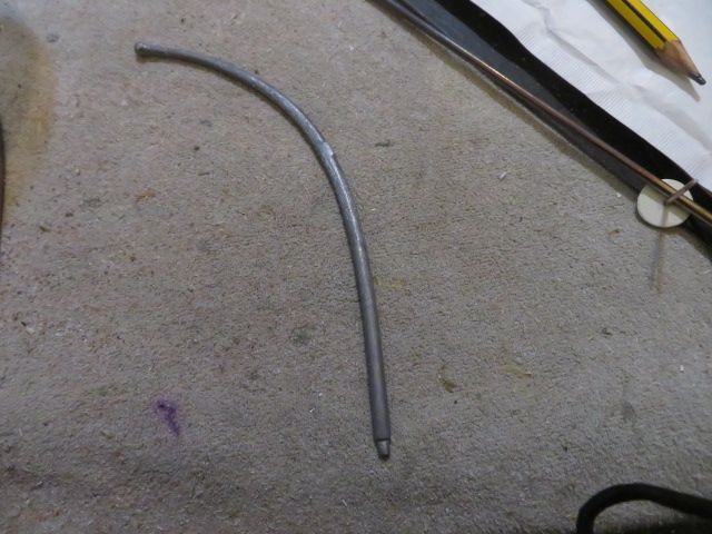

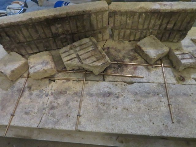

                      A day for me and my sleepy doggy on our own as my elder daughter has gone out to her works christmas party, and so got on with the stern ensign tripod pole.
                      That was silver soldered using a "helping hands" to hold it down on to my hearth bricks.
                      Once soldered, I made a preformed cleat from copper wire and soldered that on to the ensign pole, before then cutting and bending into shape, cutting off the excess.

                        Lovely neat brasswork as always Neil. Do you use coated rods or a separate flux paste?

                            Posted by Richard Simpson on 21/12/2022 09:26:50:
                            a seperate white coloured etching flux Richard.
                            comes as a powder and you can either dip the water doused solder rod into it, or mix the powder with water into a paste [ which i prefere] and apply it with a thin piece of wood used as a spatulat into the place where you need the solder to flow.
                            Just a case of cleaning it all up with needle files after that.

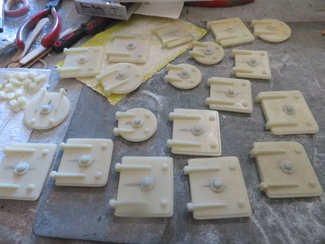

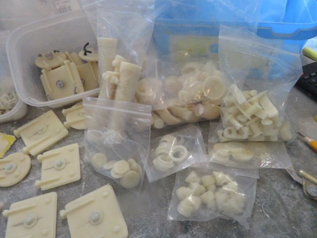

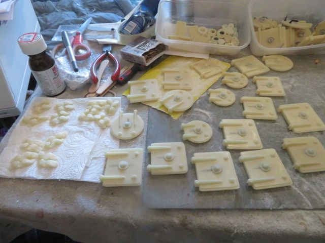

                                Still too cold for comfort to go into my workshop to carry on readying the two hulls for painting by Dave Stavros Jones, and so!

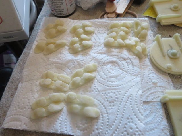

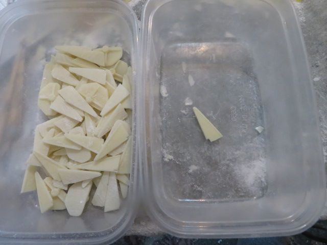

                                I have brought my workshop back into my house to clean, sand and sort the mirriad of different fittings for the 3 boats that I made the mouldings for.
                                And there are hundreds of them, 6 different sizes of w/t hatches for a start, and some of them multiple, 30 hatches in all and excluding the resin cast 4 more fittings per hatch to fit……120 fittings in total……….
                                All takes time, plus the casting time of the small fittings on top of it all. lol.

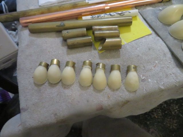

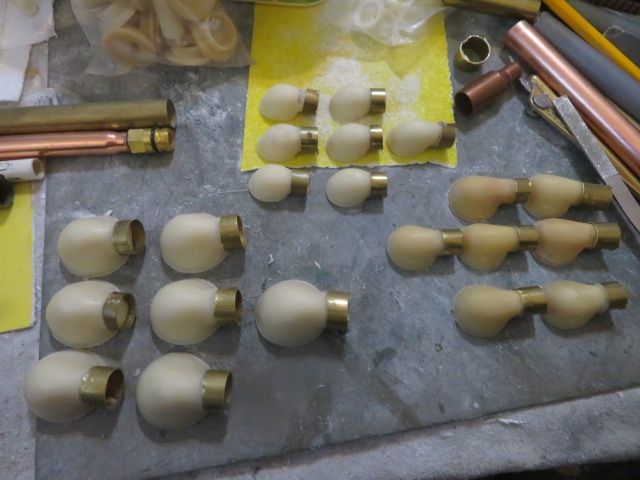

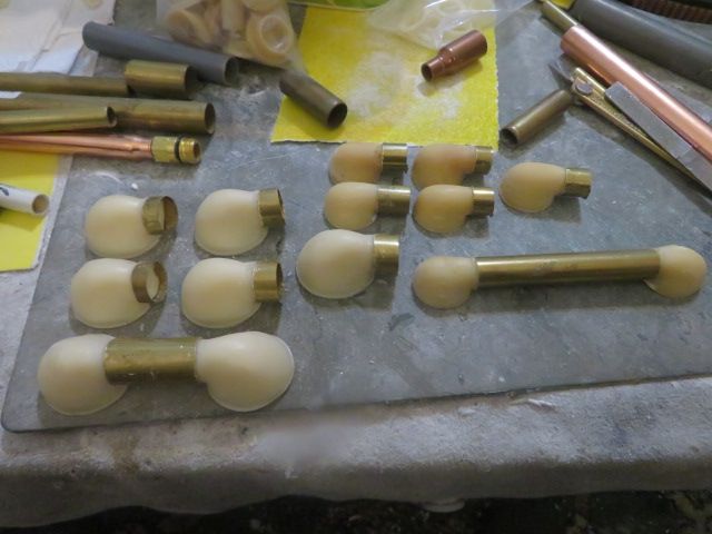

                                            next job which took me most of this afternoon and evening, was fitting the ferruls to the 3 different sized ventilator cowels, ready for the shafts, and then the bases.
                                            these are for 3 models of course, not just a single boat.

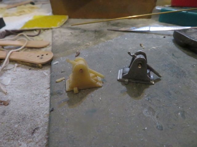

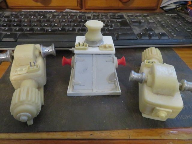

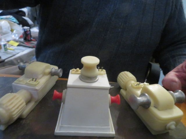

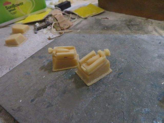

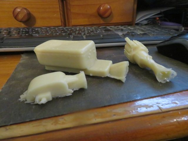

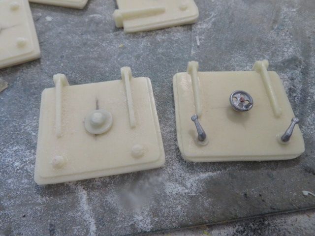

                                              The last of the 57 angle bracket stays for the jump net davit brackets, and the anchor davits………..sore thumbs and aching shoulder joints can now relax,

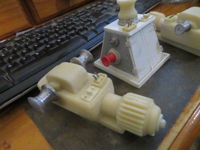

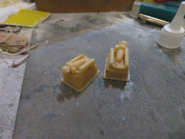

                                              As the next task was to make the second of the two more "modern" anchor windlasses that the later three Barnetts had, whilst the prototype William and Kate Johnston had the earlier boxed windlass.
                                              The second of the two was finally put together from parts I had cast some weeks ago and after cleening up, glued together and detailed with other cast parts from my stocks.
                                              #103459

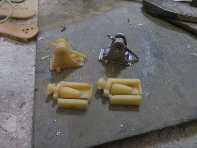

                                                The cable stoppers and cable cutters have been made from parts that were generic with the later 51' Barnett class lifeboat that I built some 10 years ago, and still had parts for.
                                                These are for the later 60/61' Barnett class boat.
                                                The ones for the prototype 60' boat William and Kate Johnston are different.
                                                #103460
                                                  Whooopppzzzzz!!!
                                                  I had forgotten to attatch the cable stoppers to their bases…….so here they are.
