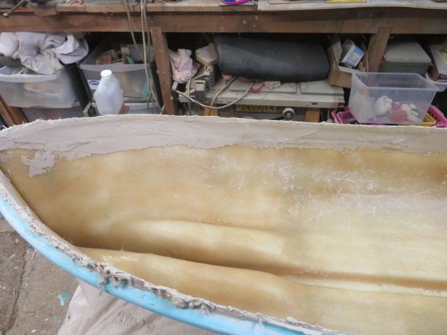

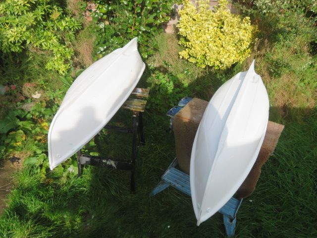

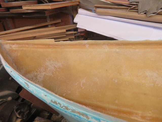

      The build of the 2 RNLB Princess's Mary has begun.
      The hollows running on the insides of the hulls longitudinally have now been filled with P38 to level them out so that I can lay 12 x12 mm sprue along them longitudinally, to glue same size cross members and the decks in to, eventually and also strengthen the hulls.
      Once set they will be sanded smooth, and then the top of the mouldings can be sanded level and parallel to belting, before adding the longitudinal and cross members.
      Once this has been done, I can then turn the hulls over and fit the prop tubes and shafts before decking the boats.

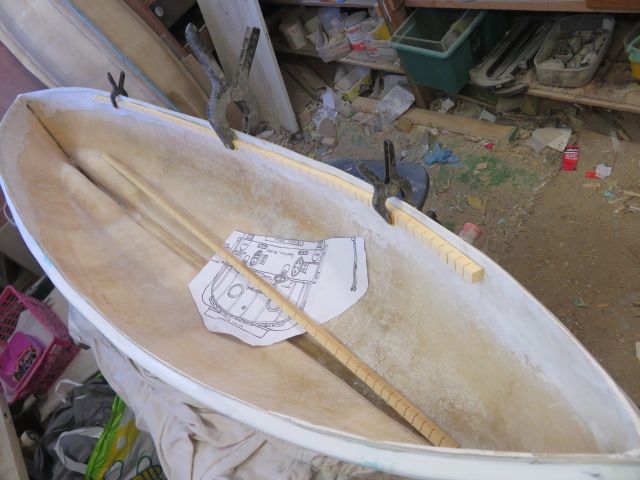

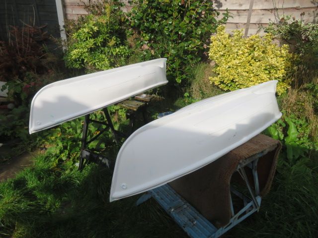

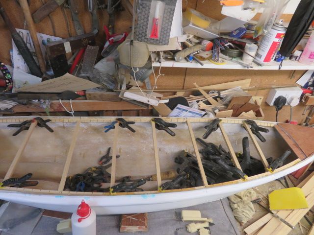

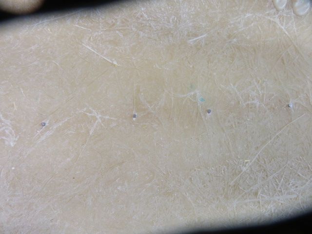

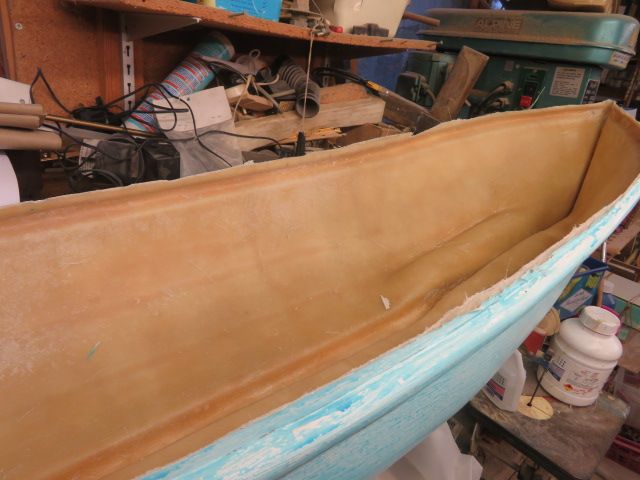

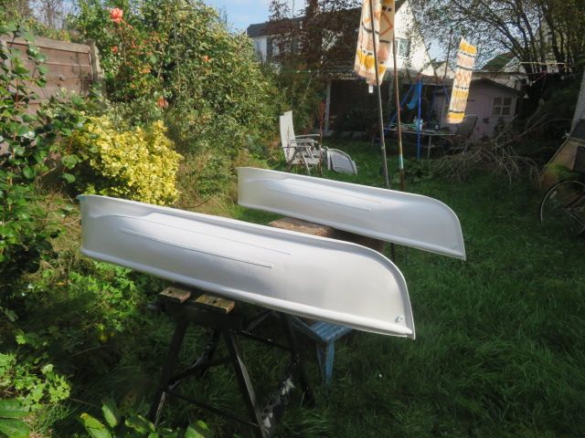

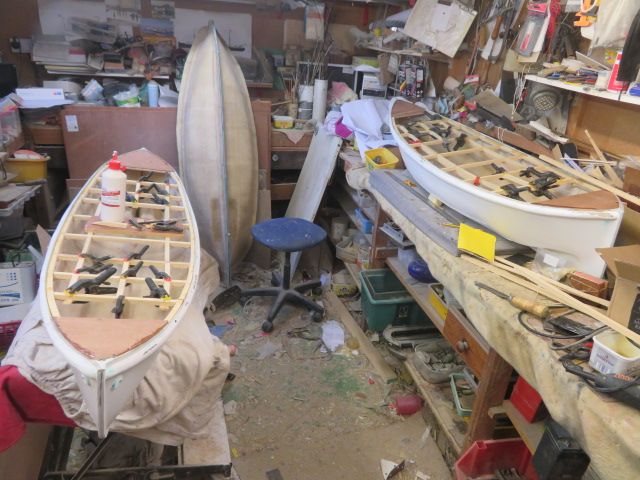

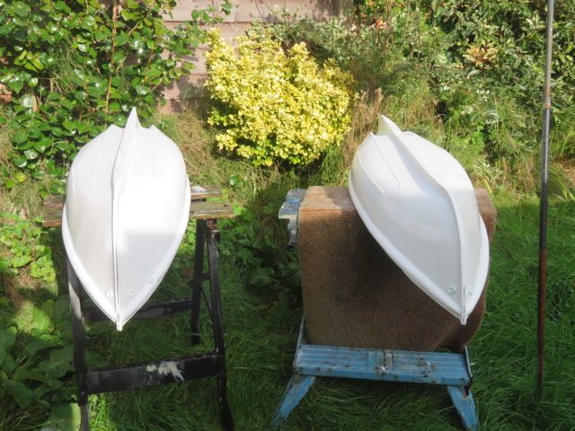

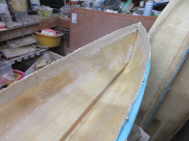

          Two rare and beautifully shaped beasties together, and ready to start the build process!!

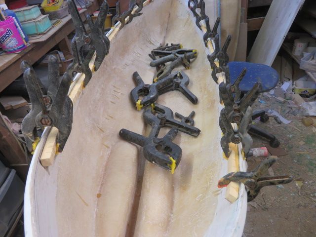

          The bulwarks have been sanded with a delta sander and 40 grade grit paper, the insides of the hull have been sanded smooth of all "needles" and loose fibres,……………..
          ………….and then almost all of the PVA blue release agent has been washed off.
          Now the first job is to saw and glue the longitudinal leangths of 12 x 12 mm obeche strips to the port and starbourd bulwarks ready for then measuring and fitting the cross members, later today.
          But first a bath as I am full of dust except for my mouth and nose, as I wore my mask.

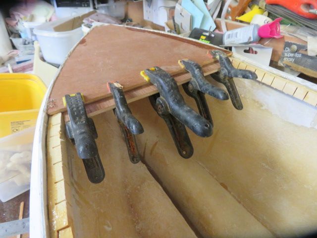

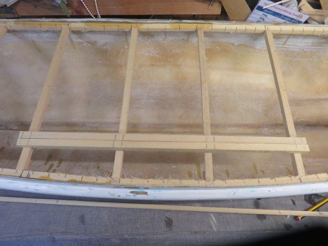

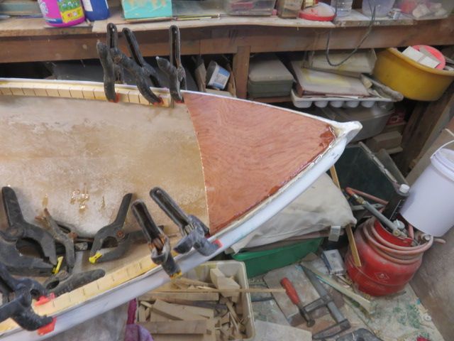

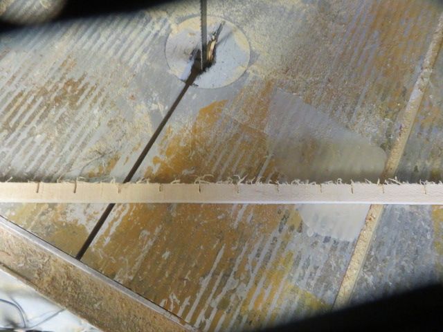

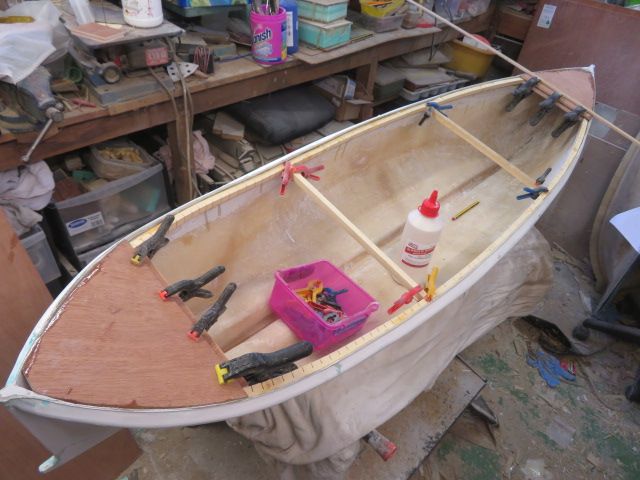

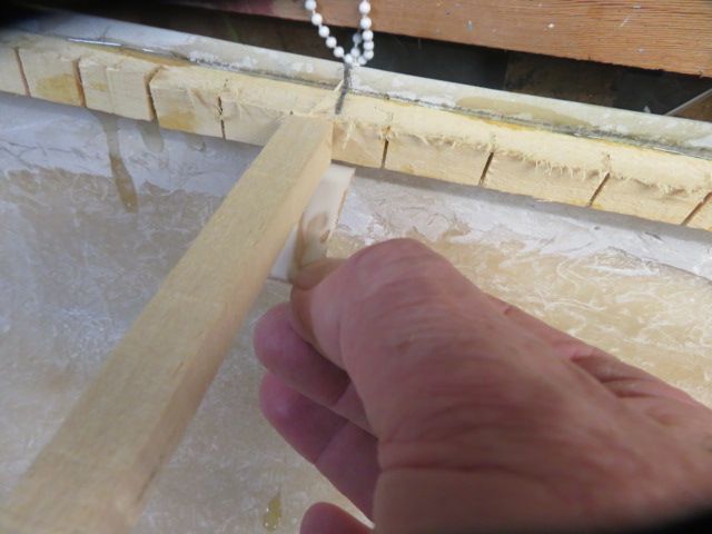

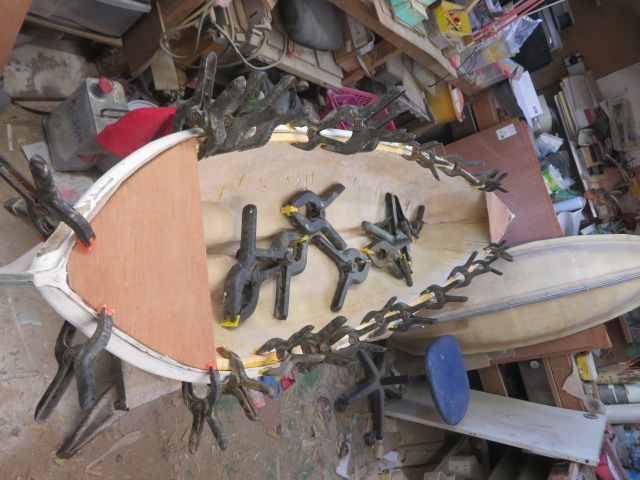

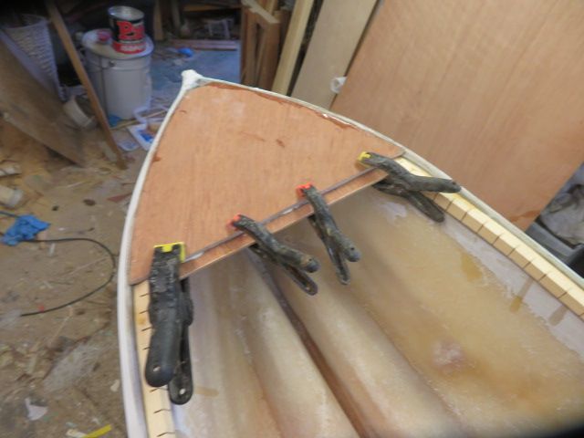

            This afternoon I started by putting in the longitudinal sprue. Firstly I cut through halfway along the full length of the 12 x 12 square timber to aid the bending of the timber to form to the shape of the hull. I used 30 minute Zap epoxy and spring clips to glue to the pensil line 4mm down from the upper level of the bulwarks. this measurement gives me the 4mm to set the ply deck into the hull bringing it level with the pre sanded bulwark tops.
            And then I glued two fillets of ply into bow and stern that will give both strength to the hull and a level base to glue the deck parts to!
            I will now do the same to the second boat, before placing cross beams into the hulls.

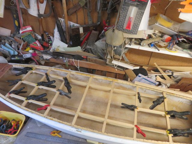

            #102569

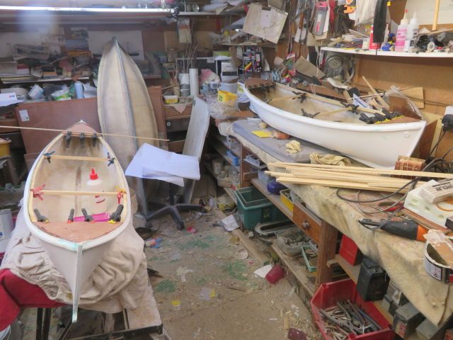

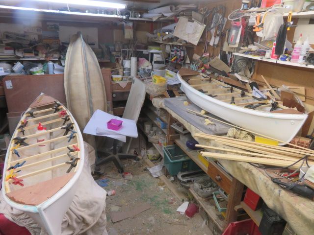

              I have always found that building the same and similat models at the same time, rather than build one, and then start another and then even a third is far easier than the latter choice.
              And as I am building two RNLB Princess Mary's I am building side by side.

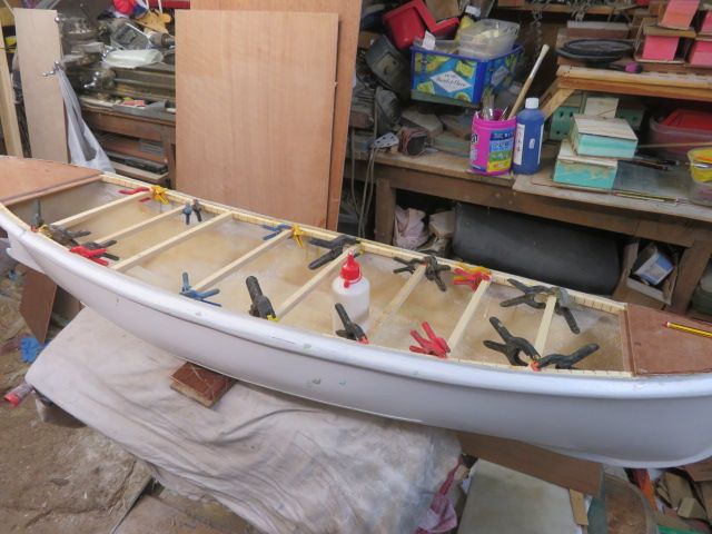

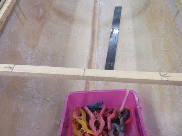

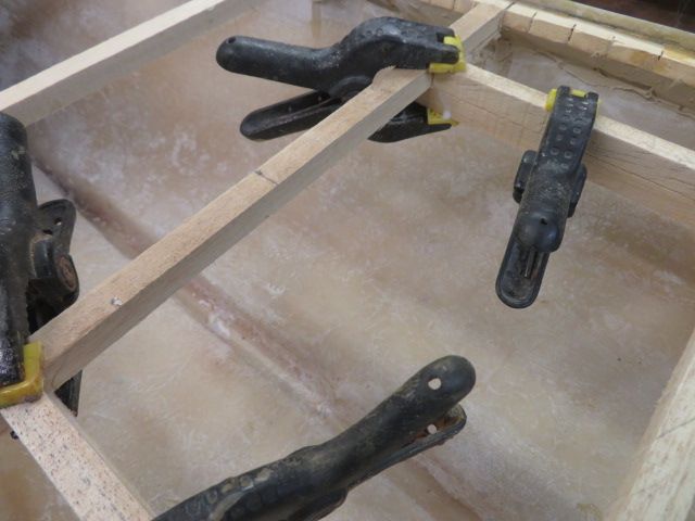

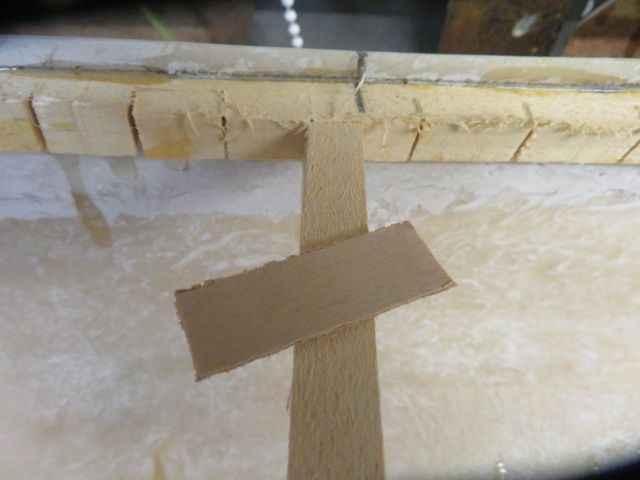

              This morning I glued fillets on to the undersides of the bow and stern plates to support the ends of the under decks.
              Then it was time to place and glue the two cross bearers that denote the ends of the access to the hull, marked by the front and rear parts of the main cabin and engine casing.
              these were supported at their joints with the longitudinal stringers by small plates of 1.0mm ply glued to bothe the longitudinal and cross bearers using aliphatic resin glue..
              I shall leave all this to set for a couple of hours before putting the side bearers in for the width of the cabin/engine casing.

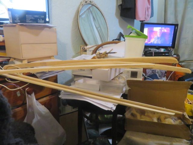

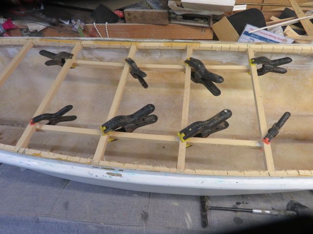

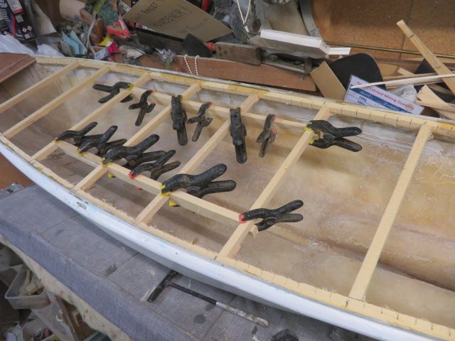

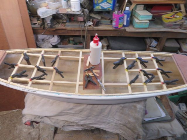

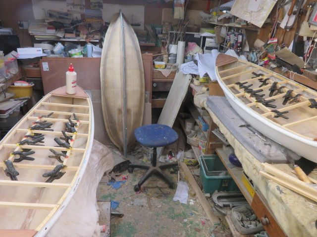

                Once all the measurements have been taken, worked out and posted on to the boat, the job of placing all the cross beams in possition was easy.
                The major time was working out the distances across the hull and the spaces between them.
                The first model on the bench took 45 minutes to do, cut the timber and fix in place…………..The second boat hull took just 18 minutes…….as I said…..easy enough to build 2 boats as one.
                But all cross members on both boats have now been fitted and glued in place with the support "brackets between cross and longitudinal sprue also glued and cramped, using aliphatic quick grab glue.
                If there's nothing on tv later I shall ad the final support to the longitudinal lengths of sprue.

                  Apart from building the boats, it looks like you`ve got a sideline in breeding clamps!smiley
                  Jim.
                  #102581
                    Posted by James Hill 5 on 23/10/2022 21:22:25:
                    Looking really good Neil,
                    Jim.
                    the more the merrier Jim………….learned from my days at school in woodwork………nothing worse than gluing something up and running out of sash cramps or G cramps when someone else beat you to them lol.

                      two jobs today both to strengthen the frameworks, before attaching the main underdeck.

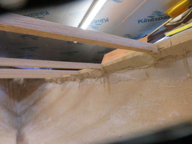

                      First job was to run a fillet of P38 under the side strips of 12 x 12 mm sprue…..this does, contrary to some opinions, bond to both the grp hull and the obeche timber, and also acts as a waterproof barrier should there by any remote chance be a gap between the obeche and the grp hull.
                      Been using this method of seeling the wooden supports to the hulls since my first Caldercraft build in 1979, and never yet had a parting between the frame work and the hull, of any boat I have bult………and I have built one or two, lol
                      Seccond job was to mark out the central access "hole" where the main cabin sits, width wise.
                      The length had already been determined by the possitioning of the two cross beams, and so reverting to my handy measuring stick I marked off the 4 cross members for each boat, and glued to the bottom of them, in a nice straight line the lengths of 12 x 12 obeche and cramped them up, and left to dry.
                      I will infill on the top of these with more 12 x 12 mm obeche, once set to give me the basis for a nice combing of 1.5mm ply to glue to the 24mm deph of timber for the cabin to sit over nice and tightly should i be called to sail windermere next summer……………
                      no sails will be relied upon this time lol.
                      #102583

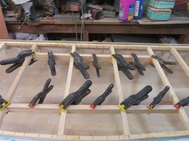

                        The double layer of 12 x 12 mm sprue for the access hole has now been glued in to the rectangle, on both models and now left to cure and set until tomorrow……….lights and heaters off for the day.
                        Tomorrow I will complete the framing of the skeletal frame to support the deck,
                        #102587

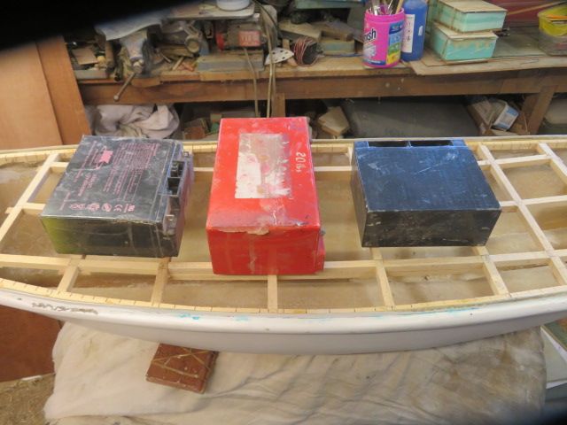

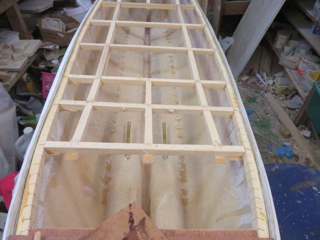

                          Apart from a single mid sprue at both bow and stern of each boat, the deck suppor frames have been fabricated, piece by piece to fit tightly to the cross members and the underframe support gussets made from 1/16th marine ply………
                          And I think I now have a very sturdy frame to lay both under and top decks too, when the time comes.
                          Later this afternoon I shall turn each boat over and firstly fit the prop tubes And the A frames to support the exposed shafts and propellors in the right possitions………….however, I have a sneaky suspicious feeling that the legs on the Aframes thay i made for the 51' Barnett lifeboat years ago, might NOT be long enough and then it will be a case of getting out my silver solder, and brazing torch………..

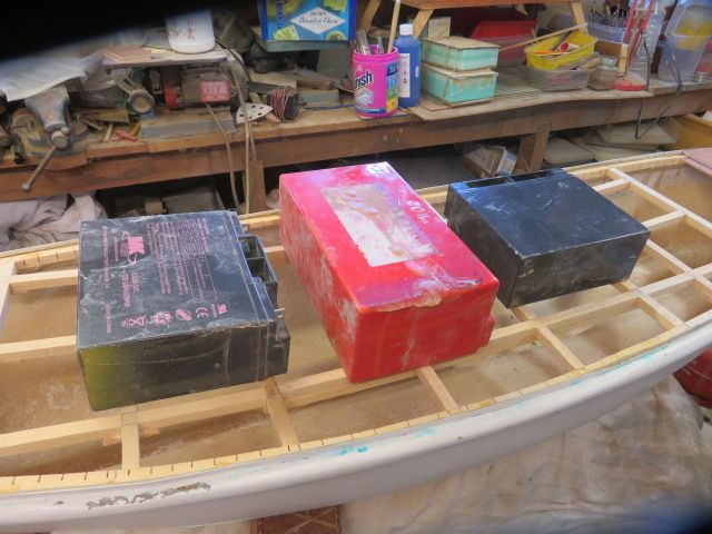

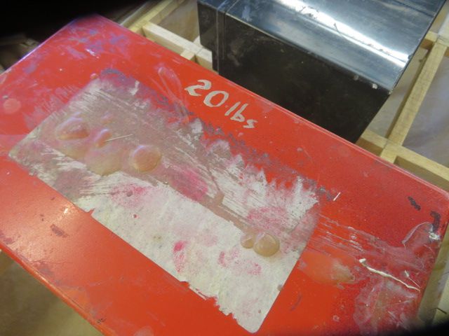

                            I build them big, bulky and blooming bashable.
                            the glue is barely dry and set, and there's 25 kilo, [55] of weight resting comfortably on it without any grones or creaks from the frame or hull at all………no sagging and no sinking…….now, I'm pleased with it.

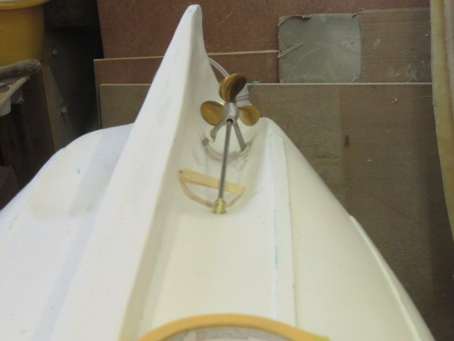

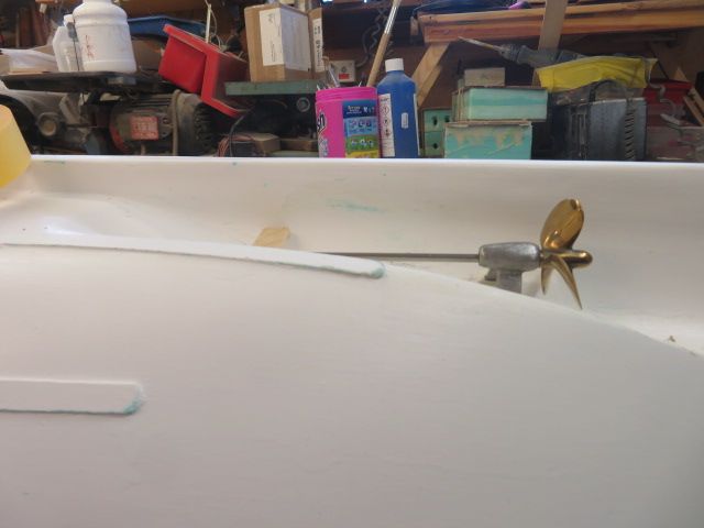

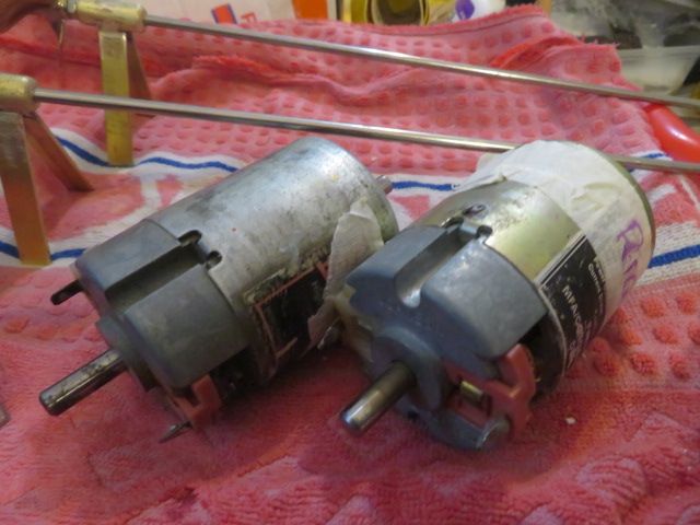

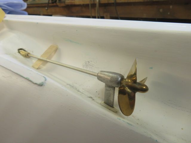

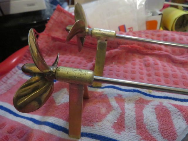

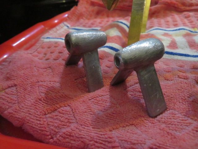

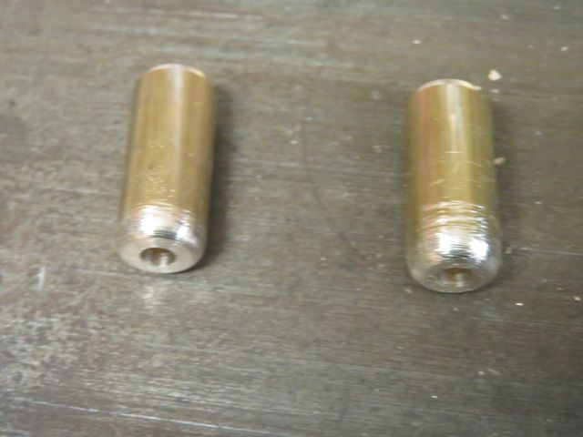

                              Fitted the prop tubes into the hull today, lining them and the A frames in the tunnels, and tacked the tubes into the elongated holes with 5 minute setting epoxy.
                              Tomorrow I will back fill from inside with P40 fibre glass stranded filler to keep in permenant place………and then glue in place the A frames.
                              However, as I said earlier, the gas torch and silver solder will have to come out as the two A frames that I have used for the first boat were the last ones I had cast in white metal.
                              I have the moulds to cast them, but as I have no white metal or melting pot anymore, I dont think even polyurethane resin ones will be tough enough………and so will have to make in brass, silver soldered together……tomorrows first job.
                              I have already drilled, shaped and drilled the two bosses needed, and just have to cut 4 legs now for the two frames.

                                    That shaft looks quite thin for the size of the model Neil although I'm sure it is in scale. Do you think there is any risk of whipping? Although a long shaft overall, it does have the benefit of three bearings to support it.
                                    I had a lot of problems with one of the 11 inch 4mm shafts in my fishery cruiser. The whole lot, tube and all had to come out in the end.
                                    I’ve just updated the completion of the model. Not done on the forum at the time as it appeared in the magazine.
                                    All chronicled on this thread:
                                    https://www.modelboats.co.uk/forums/postings.asp?th=106093
                                    Edited By Colin Bishop on 26/10/2022 18:35:26
                                    #102600
                                      i'll have a read of that Colin. thanks for the link.
                                      as for the shaft……i dont think I''ll have a problem as i used it on my build of the 51" Barnet, and although that was 10" shorter as a boat, the actual drive set up was exactly the same, with a 4mm shaft and tube to fit….
                                      and it sailed like a dream…………..but i can always chanhe it should it give a problem.

                                        Thank you Martin…………they look and sound superb.
                                        The pics of my silver soldered A frames for one of the boats and the plastic feet to fit both sets of A brackets were all done last night, as I fealt ok…………just glad I did.

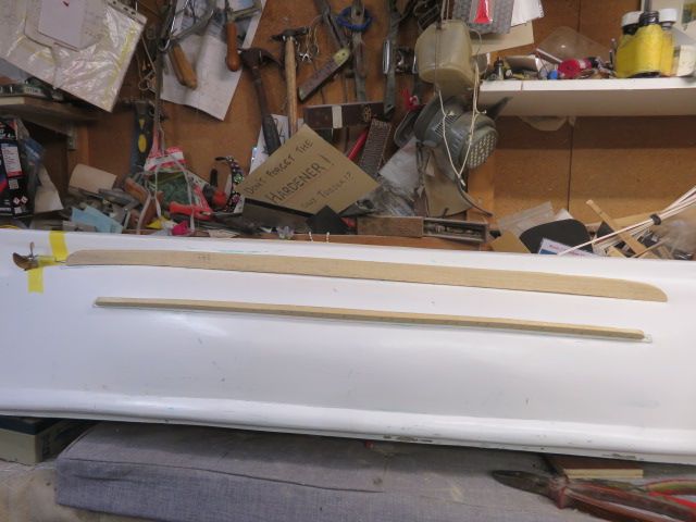

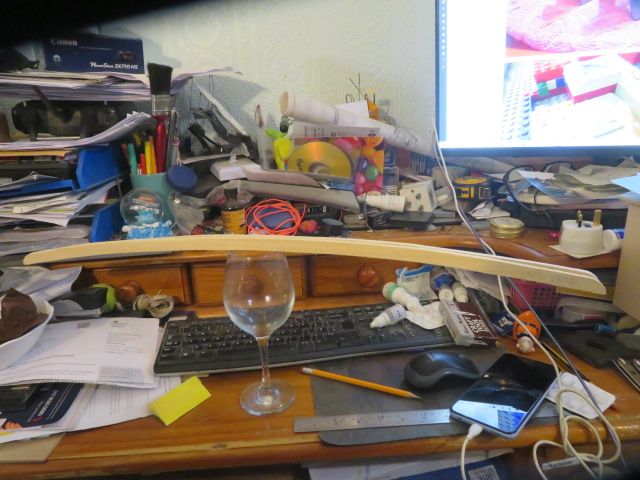

                                                As a friend Bob Blease told me this morning to get off my bum, I couldn't disobay a retired ships' officer, so this afternoon I took the first steps to mounting the 4 bilge keels onto each of the two hulls.

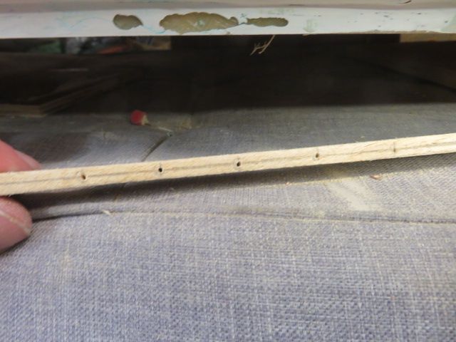

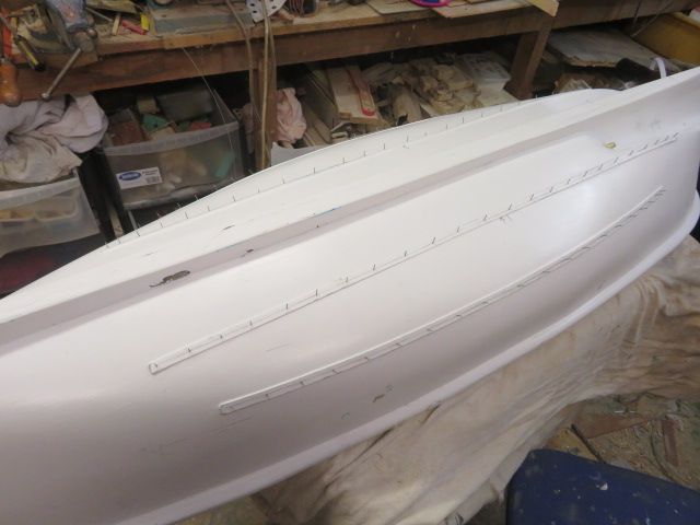

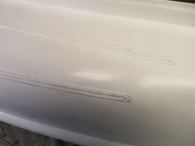

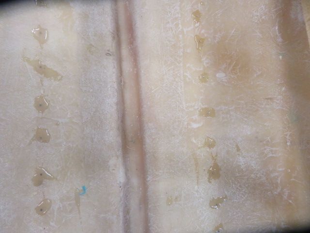

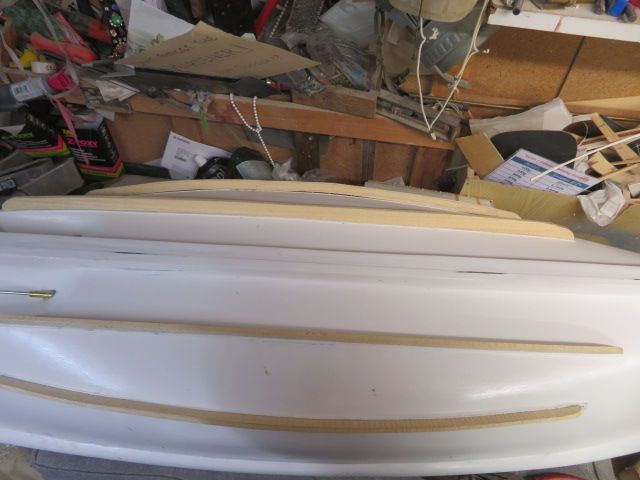

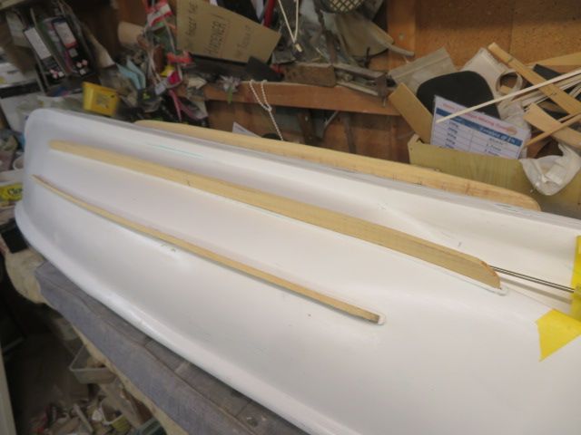

                                                The bilge keels are made from obeche and so should be easy to attach using 30 minute epoxy.

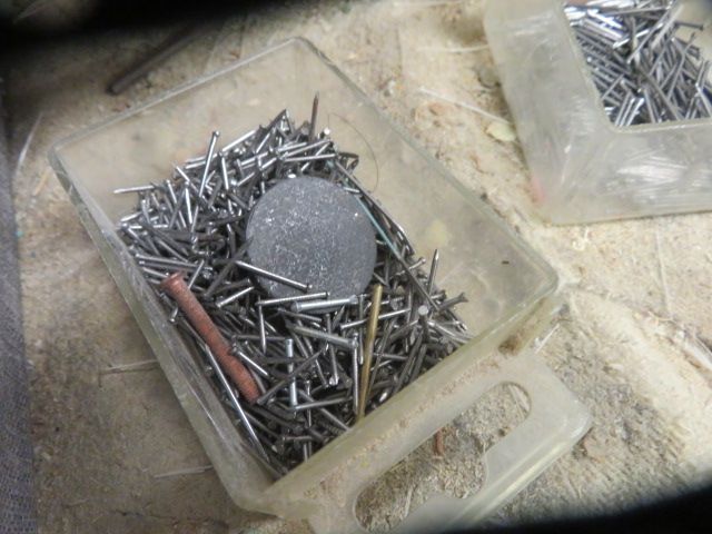

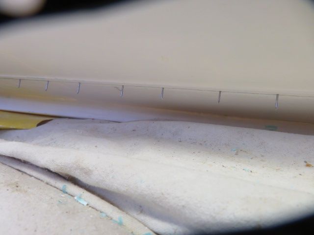

                                                But first I had to start by fitting the fastening pins that will be driven in to the timber.
                                                Before, on smaller boats with shorter keels, I have fixed pins into the wooden keels and then drilled the hulls in line with the pins secured in the keels.
                                                This time I have drilled the nulls, put the 0.7mm framing pins through the hulls and locked them into place with a backing of 30 minute setting epoxy.
                                                These will be left to set and the lower bilge keel pins will be pressed home, epoxied from inside the same, and left, untill the second boat has been treated the same.
                                                The images are hard to see for some reason but the idea is plain to see.

                                                  A stressfull and tense 90 minutes has just been spent dry fitting the 4 bilge keels on to the first boat.
                                                  Getting the nails protruding from the boat hull and marked onto each keel individually, then drilling it and finally fitting and hoping that each drilled hole would match up with the nails from the hull was almost too much, but as it went togethjer ok on a dry fit, I will glue them to the boat hull with epoxy tomorrow.
                                                  And whilst they are setting hard, I'll spend hopefilly a shorter time doing the second boat now that I know what I'm doing [hopefully]
