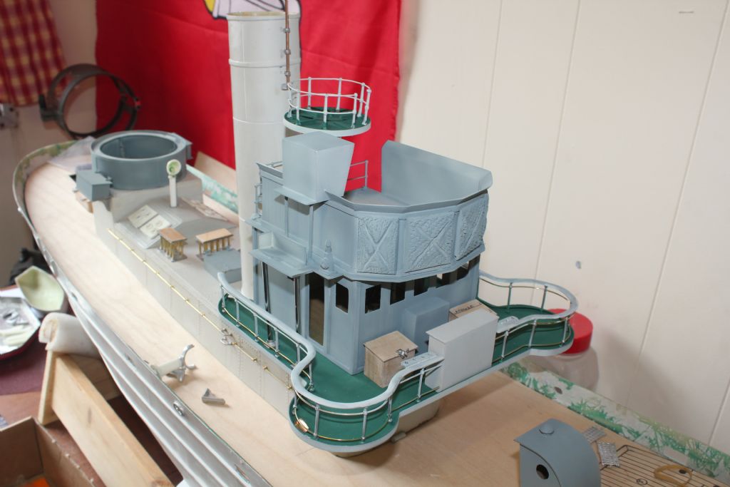

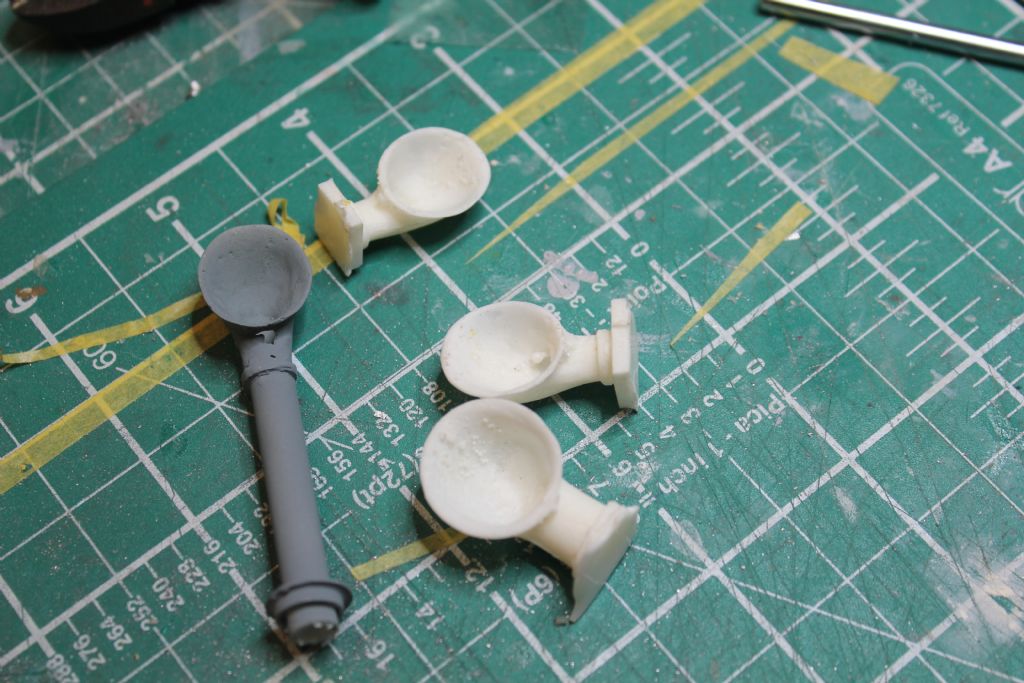

        Here a few more piccies of the progress, Getting to look a bit busy. I started the supports under right hand side Nav light, the White metal castings were too small Diameter wise for the tube supplied to I cut up a telescopic aerial and salvaged suitable with tube to use. The Second Aerial I had of course does not have the Diameter I need! Arrgh. Might get some Brass rod in BNQ or such as the LMS are sold out of Suitable Tubing plastic or Metal!
        Also the Resin Casting of the Cow Vents are pretty crude so these were drilled out and my Favourite Green stuff putty (no longer being made) Was used to smooth the bad bits.
        I answering the cutter questions these one if pretty Feeble, I used it is set in the groves using the blade in the plastic and then a sharp scalpel to do the rest. I think I got it in the local Art shop in Cork. Fine for Paper really.
        This one  I use is a tennor on Amazon.

          I've been advised that the grey I have used (Humbrol 147) is no where close to the home fleet grey these ships were painted in. Humbrol 145 is a closer fit it seems.
          So out came a tin of that and I re sprayed the cabins and stern tub to see what they were like. Any opinion on this colour folks? The original colour is the light grey on the box in between the front handrails.

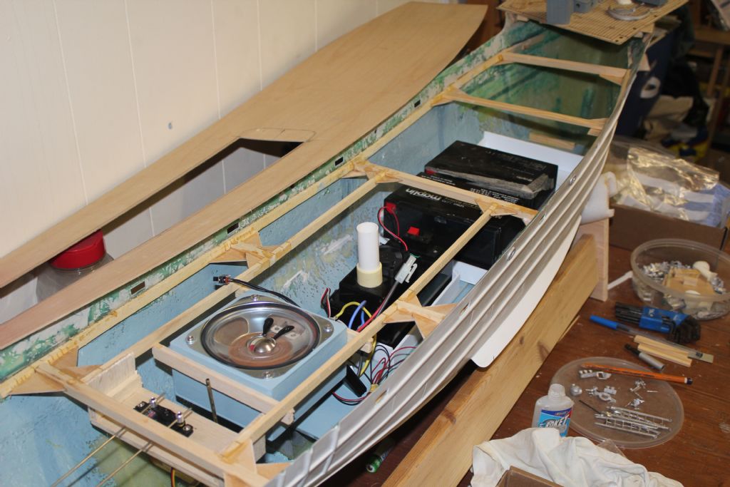

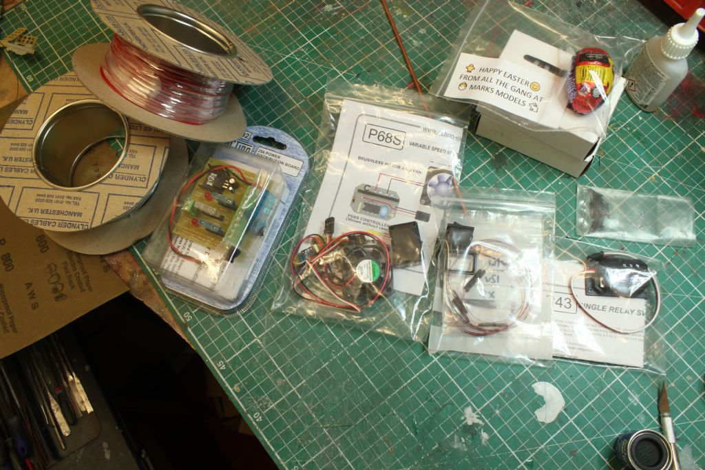

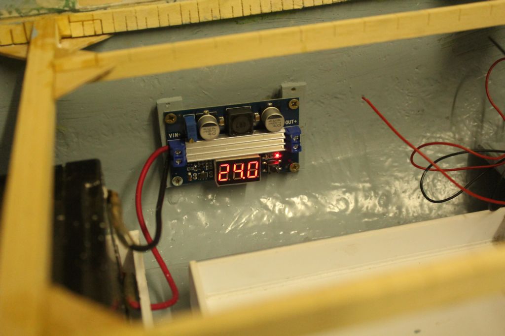

                    Speaker, Switch for the searchlight, power board, Some wire and a variable fan unit. The Local LMS supplied some copper tube, paints and a welcome Creme Egg for the 9PM Cuppa.

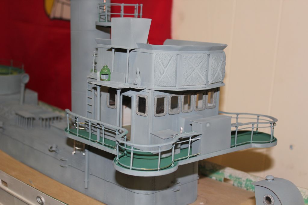

                      A week off work enabled some more time in the Shed, The finishing touches were to replace the Rivet heads lost whilst tidying up the superstructure.
                      The first coat overlaid was done over some black pre-shading. I must admit the Darker grey suits it brilliantly and makes it more warlike!

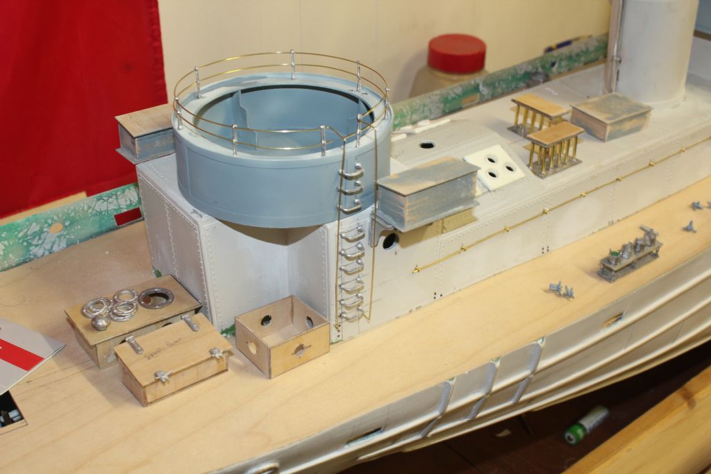

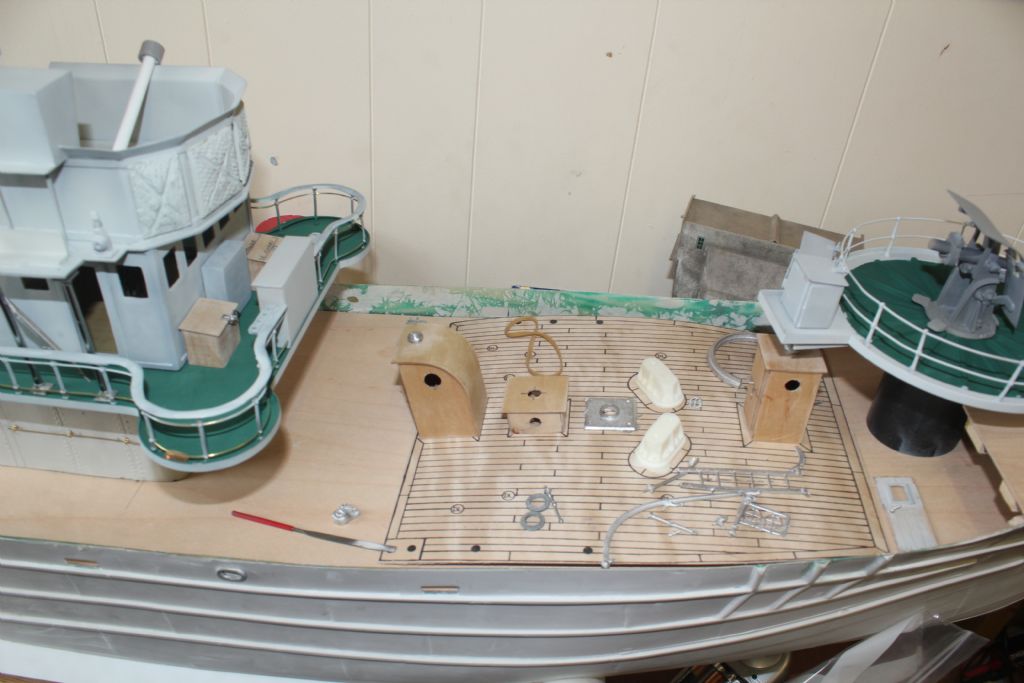

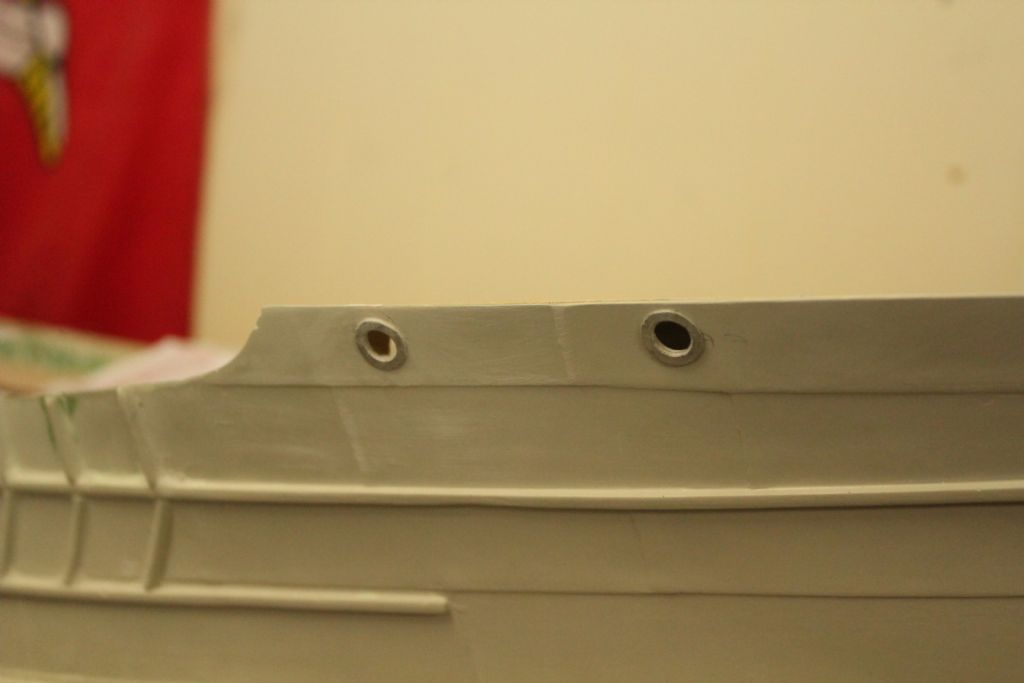

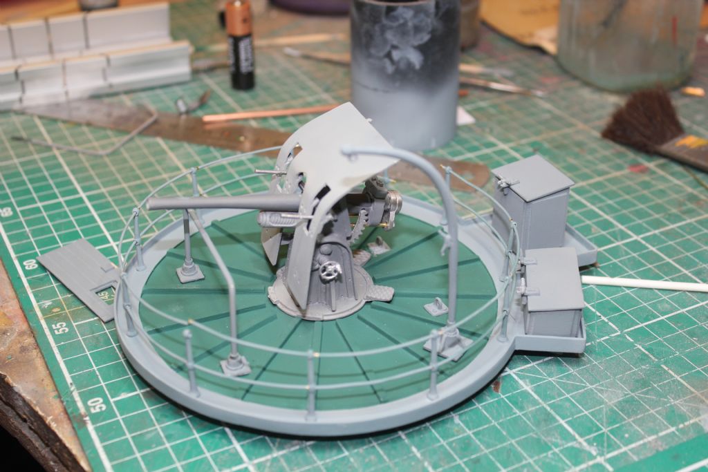

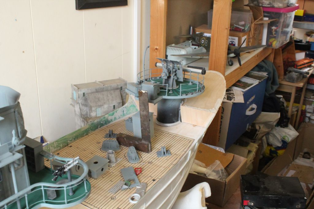

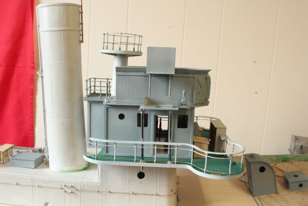

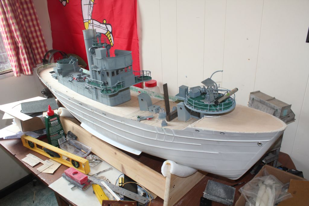

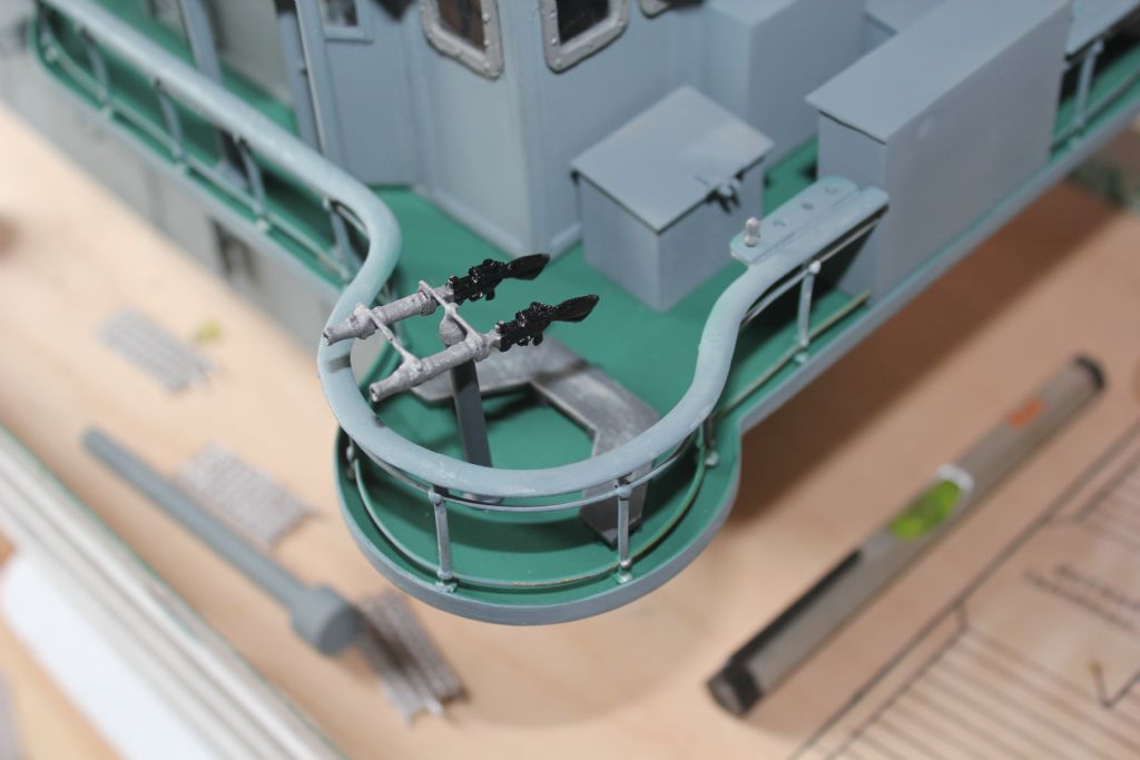

                        And the Boat Yard is on O/T this week. Windows in, Gun Platform more or less done
                        I need to get better cowl vents and the ones supplied are just very poor and too thin to tidy up as per the pics and the hole that has appeared in the one I tried to do.
                        And the leccy stuff is being worked on and where best to place what is needed where, Although it is s huge hull the batteries and smoke unit take up a fair amount of space not to mind other weights I will have to carry no doubt!
                        Bad Cowel Vents, I cant do anything with these. You can see the one with the hole. very poor casting, you have to ask why bother at all? Order into Cornwall Model boats this weekend sa me relived of 30 notes for replacement ones.
                        Gun Platform is slowly coming together now.
                        Would they really have shells stowed around the deck of this Platform, the plans show this but it strikes me as a bit strange?
                        #94473
                          "Would they really have shells stowed around the deck of this Platform, the plans show this but it strikes me as a bit strange?"
                          iN ONE WORD, Yes!
                          #94476
                          George Norman
                            @georgenorman68347
                            Thanks Neil!
                            Spose handy for the Battle to have them on hand!

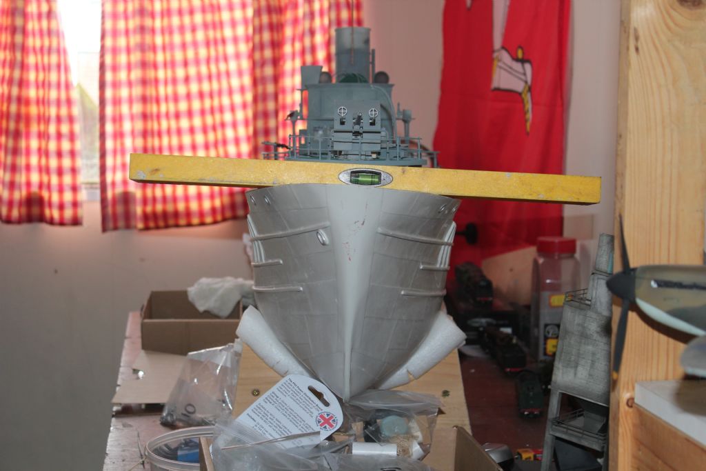

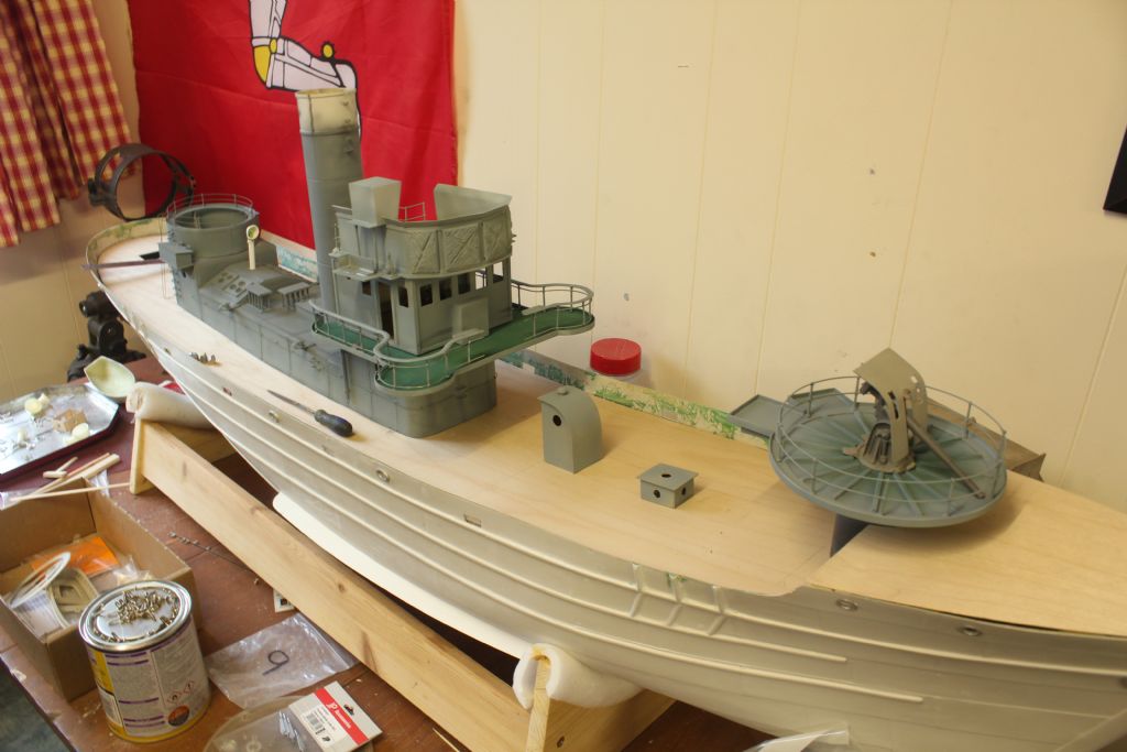

                                Good Afternoon Gents,
                                Looking forward to the weekend now!
                                Still working away on this one, Lots of tidying up with the white metal parts and my order from Cornwall Model Boats arrived with the replacement cowl vents which look fab, I think they look to be 3D printed.
                                I was hoping to have the sound unit installed but these are not able from Action just yet so I have installed the speaker and I will work on how to install the other wiring but the next big step will be the deck and after placing all the bits n bobs on the deck I noticed something is just not right…….

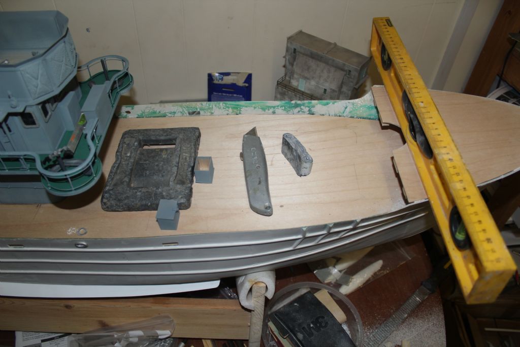

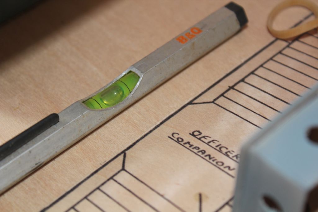

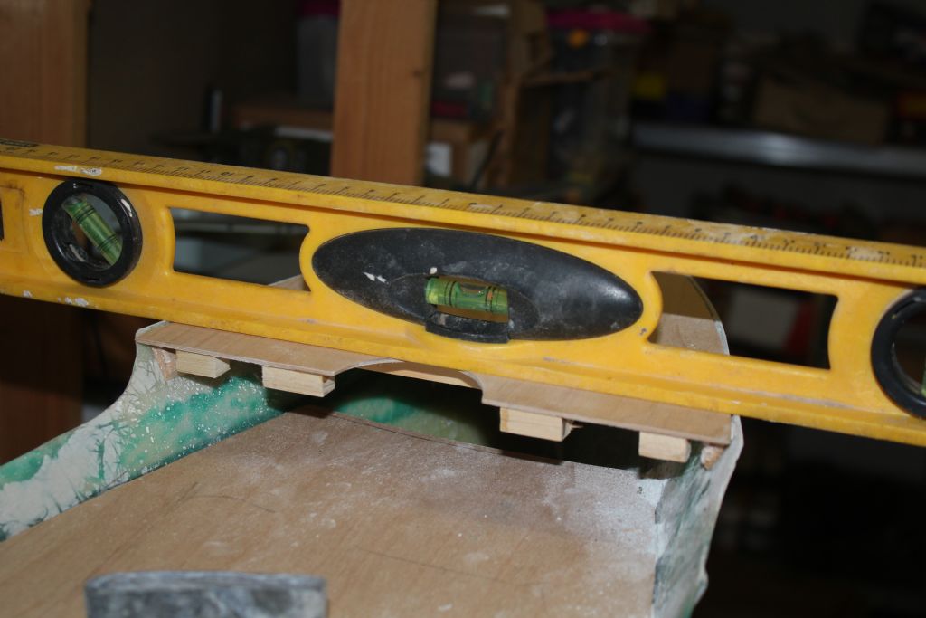

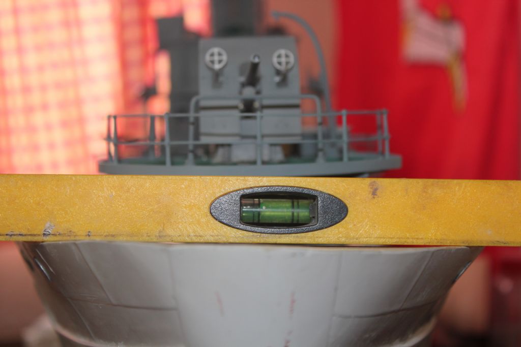

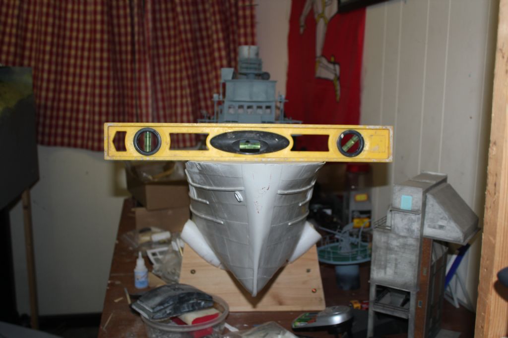

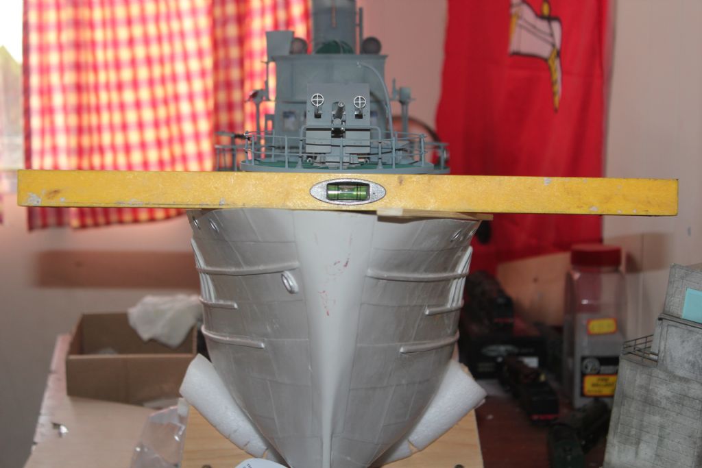

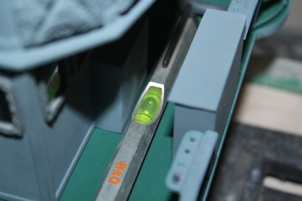

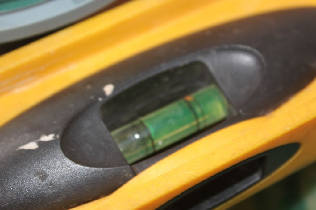

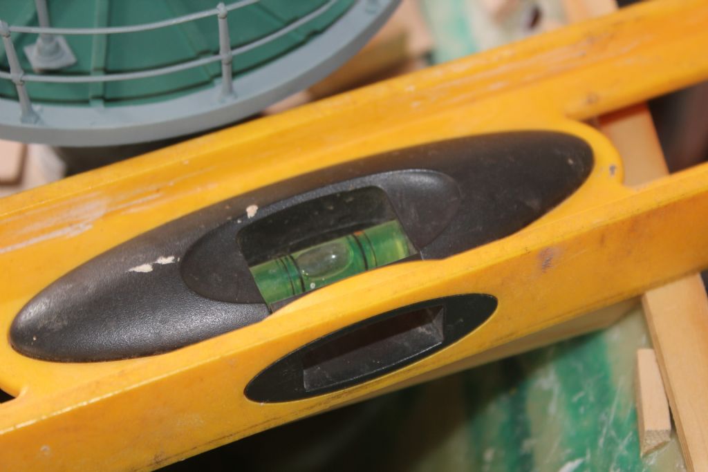

                                As per the photo I have the Main Deck Level as the bubble indicates (these are not calibrated BTW!)
                                Also the Superstructure stuff is not glued on so don't panic! (just yet!)
                                Hooooooooowever…….
                                When another level in placed on the bow….. Oh no….

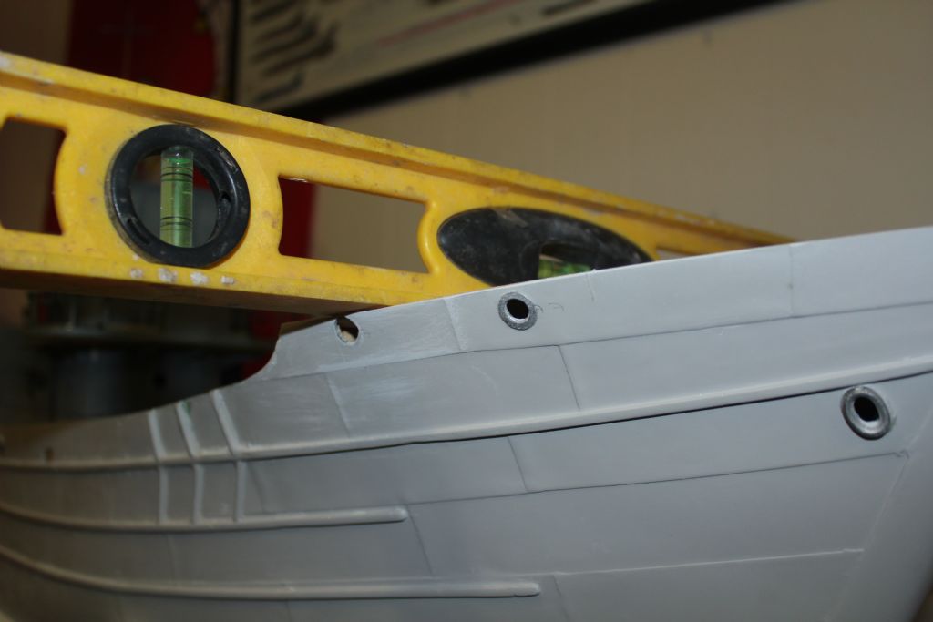

                                You can see here that one side of the Hull and the other is mismatched by looking at the 'strips' along the hull.
                                You can see the beef up using bit of wood up to get this sorted so the issue is do I build up one side or take down the other by about 5MM. What to do??????

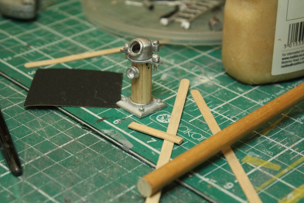

                                Meanwhile the other detail parts are coming along. New Cowl vent and vent pipes in.

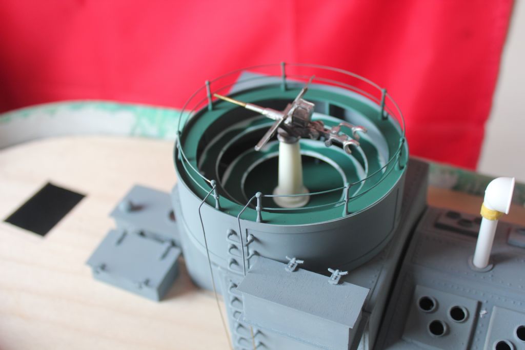

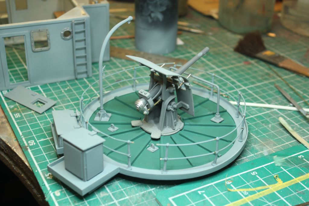

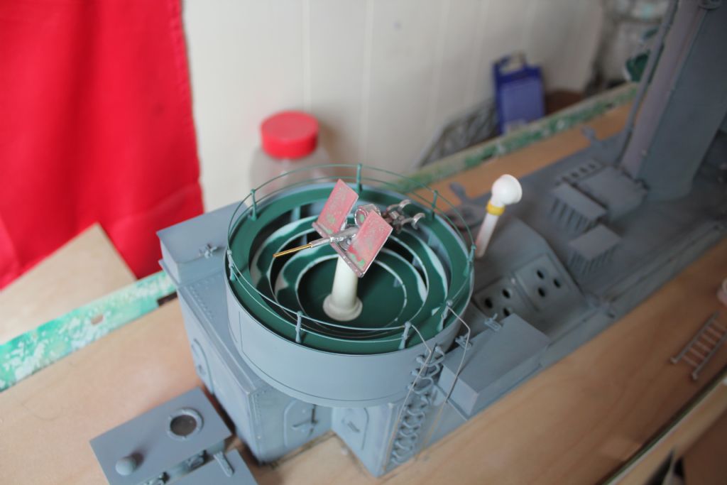

                                Lewis guns installed, All soldered up and very delicate. Some nice Lewis guns available from Gas Patch Models so I might just replace those basic ones. Not finished the painting of these yet.
                                Rear AA gun has also been soldered together and the inside of the Tub Painted and a few touches needed.
                                So there we have it. If anyone has had this issue I will be all ears. I imagine it is easier to take it down how ever.
                                All the best
                                George
                                Edited By George Norman on 09/04/2021 12:14:26
                                #94734
                                timg
                                  @timg12590
                                  Hi George
                                  She is coming along nicely,
                                  for your issue at the bow, could you add abit of cardboard to see how it looks or take 2.5 off the high side and add 2.5 on to the low side ( see what other members suggest 1st they might have a better solution)..
                                  Good luck
                                  Tim
                                  #94741
                                  George Norman
                                    @georgenorman68347
                                    Thanks Tim.
                                    After much deliberation it was a case of 2 steps forward 1 step back what ever I was going to do., I took the high side down, Easiest option really. The next issue is relocation of one of the Starboard Portholes as that was placed too high. Need to get some P39 for that me thinks.
                                    It seems to be all plumb now, Wheelhouse deck, Main deck and Foredeck. Just need to do the leccy stuff and then the decks get be stuck on and the funs starts then!

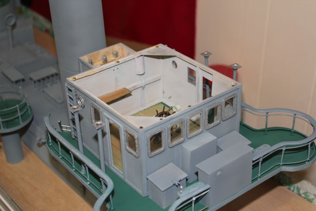

                                    #94791
                                    George Norman
                                      @georgenorman68347

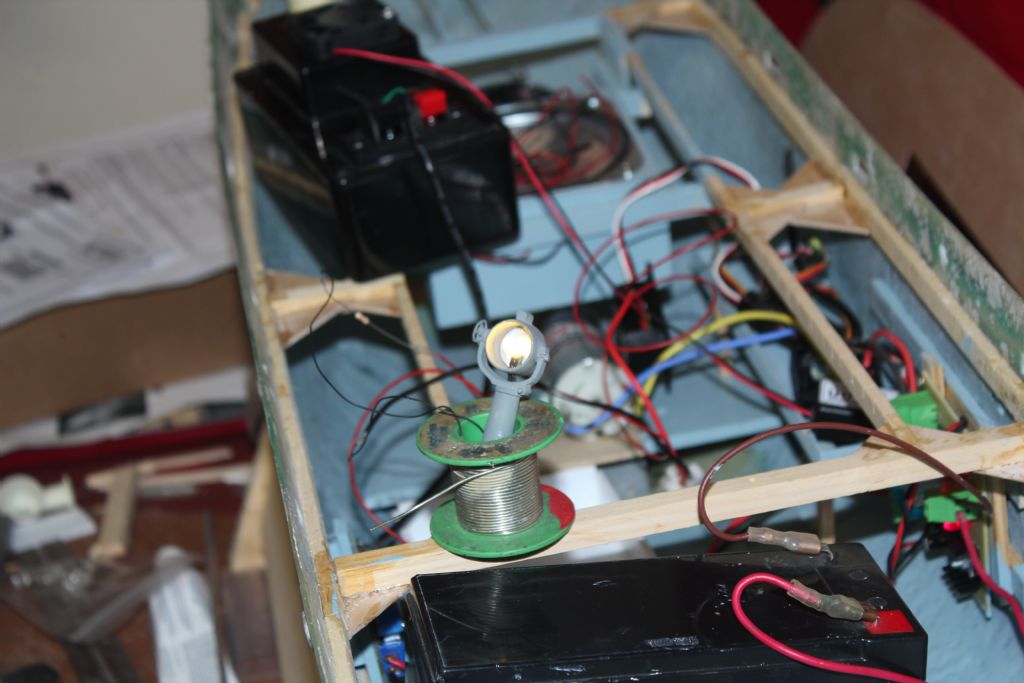

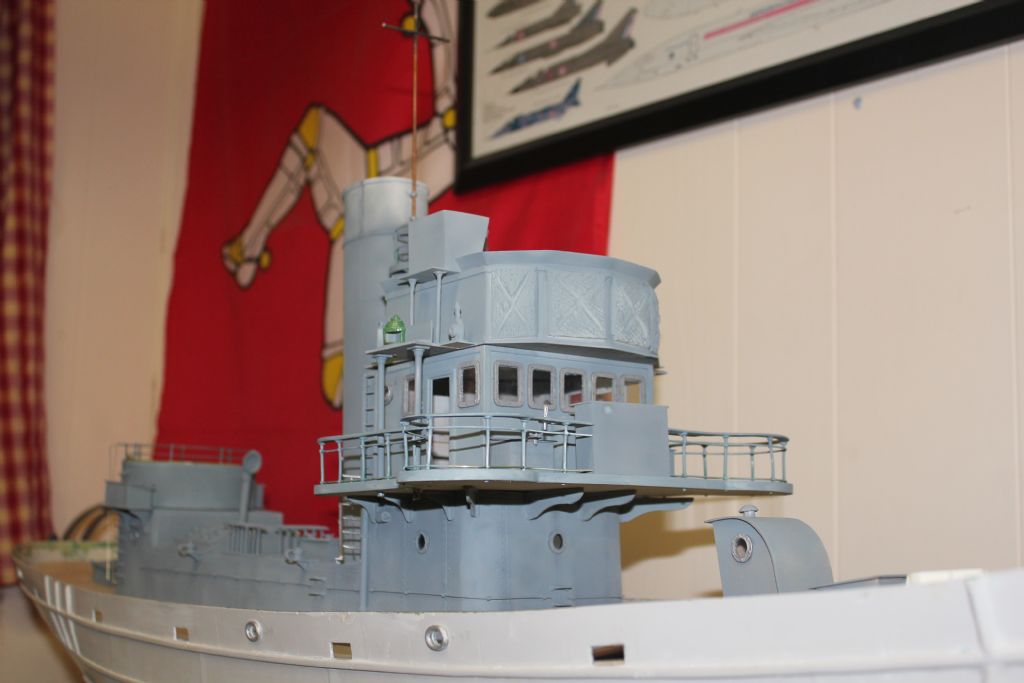

                                      Morning all,

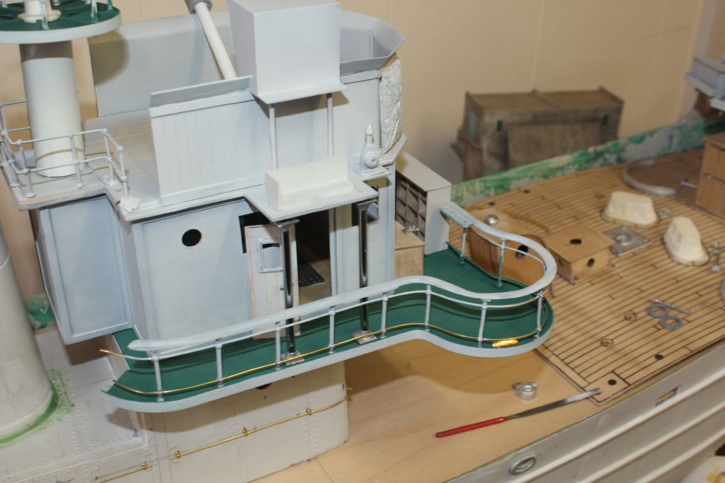

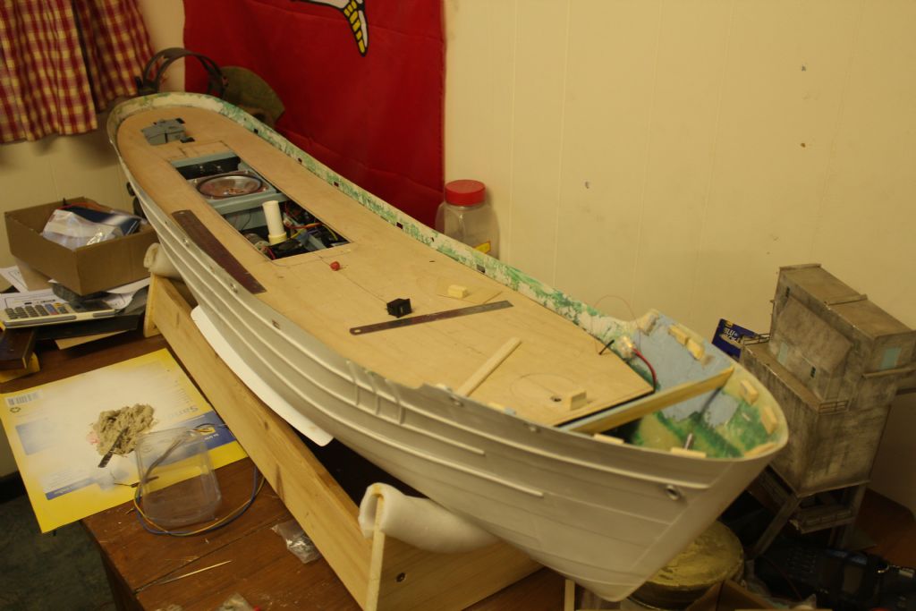

                                      Well happy with the Deck now and I have relocated the porthole now slightly lower now so well pleased, Just used P39 for the Filler.
                                      The Next Thing I decided to tackle was done on Sunday am when I snuck out to the shed instead of laying Patio slabs, That lasted till 2 before the Fun Extractor called me for work duties.

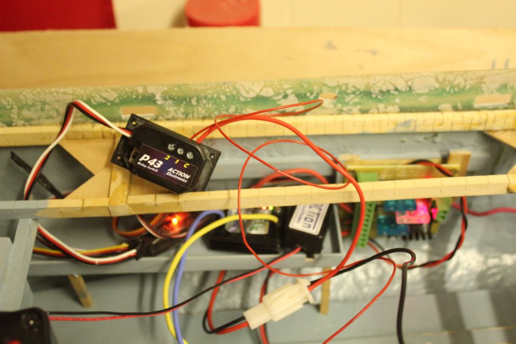

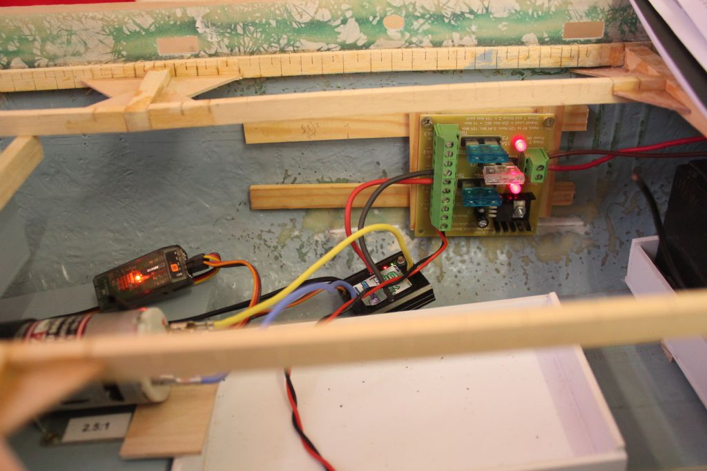

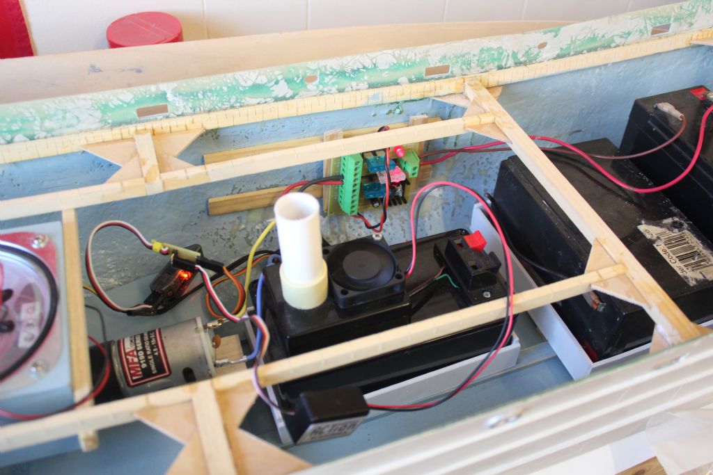

                                      Anyhow got the Leccy Tested and she Runs, Little glitch in that the Viper Speed Controller, the on/off switch would not budge and after some pressure just fell apart so I will get a more Sturdy one to use. I just twisted the wires together for now.
                                      The Rudder, Fan Controller and Throttle work and uses a Snazzy Spectrum Receiver which now have no bind plugs Amazing Tech these days and no Aerial! I still am amazed about all this can be all set up in Seconds! I have made a little Tray attached to the side of the hull to hold the Controller, Fan Controller and receiver using a Action Power board. Not as technical as others have designed but it will suit myself, Keeping it simple.
                                      I will use a connector then from the board to the Superstructure for the lights and hopefully will be able to use Magnets for the bits n bobs that will need to be removed in order to get to the Batteries to charge them

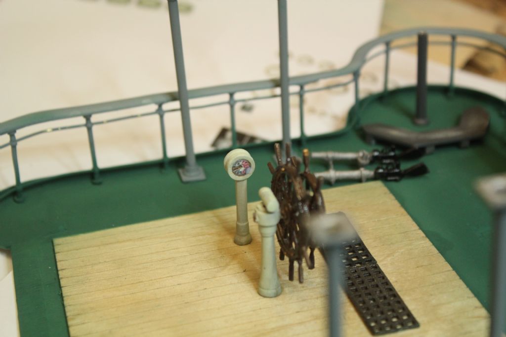

                                        Forgot to add I was in the office last week and decided to print off some Telegraph faces, Barometer faces, clock Maps and a Piccy of the King for the Wheel House deck.
                                        Of course I forgot Measure it so stuck it lucky with the Size.
                                        I Stuck the Telegraph one on with PVA Card glue. Looks ok I think!

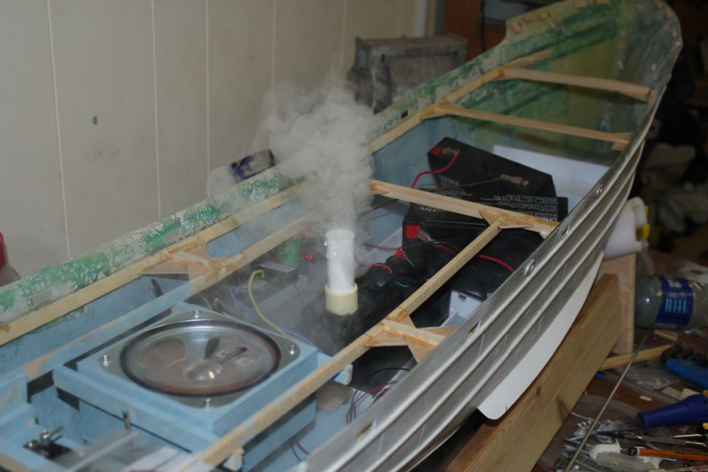

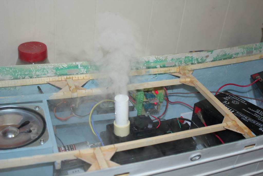

                                          As the Red Arrows Say Smoke on go!

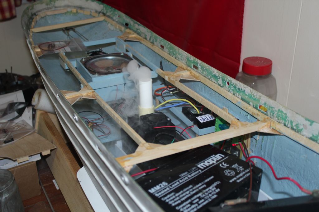

                                          Mister is from Marks Model Bits, Clever system using Water only which is blown up the pipe by a little Fan. Unit is run off of 24V so a Step up is needed. Fan is run from 12V and some electronic Wizardry from Action electronics is needed to keep the fan going in the same direction.

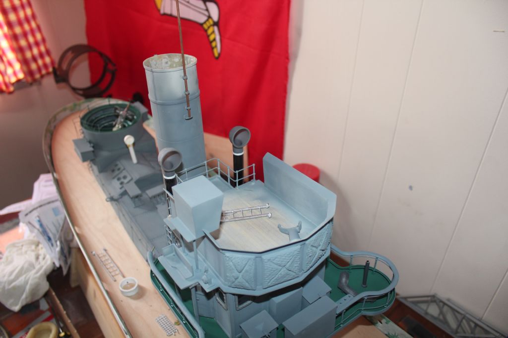

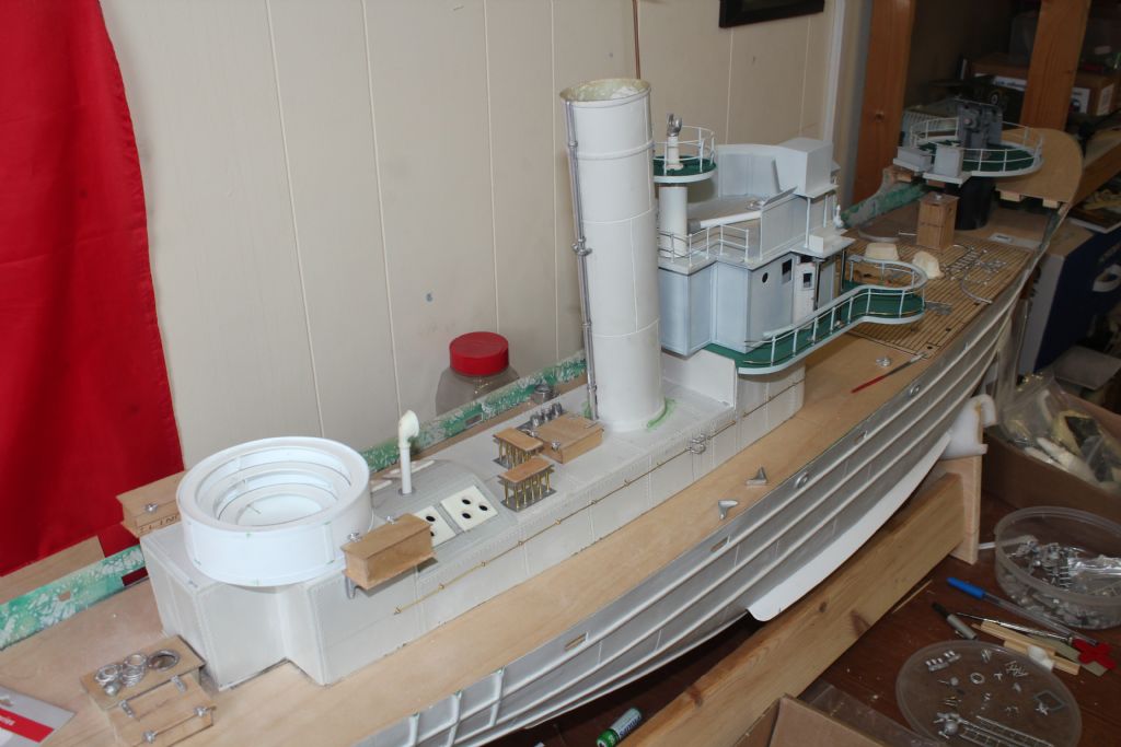

                                            Good Morning,

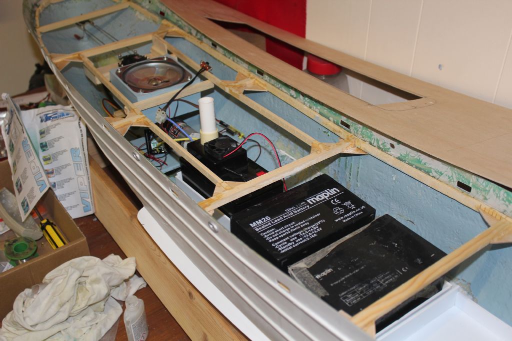

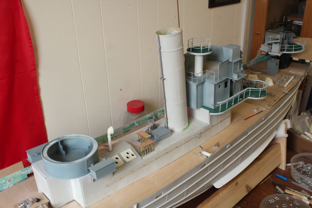

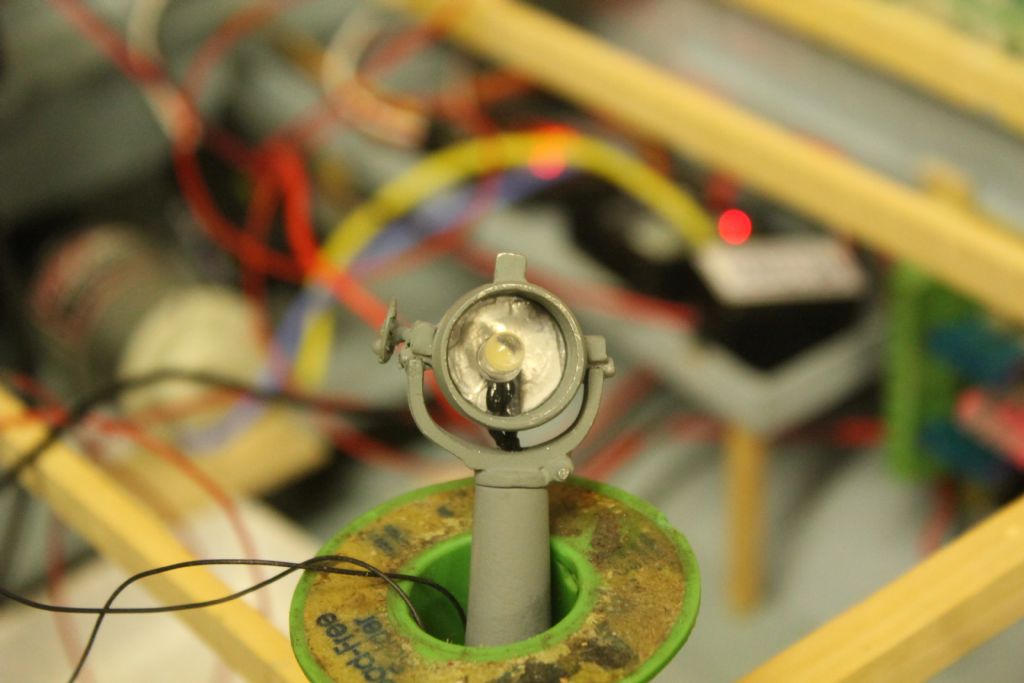

                                            Work in the dockyard continues with some massive step taken, all the wiring is complete internally for the lights in the hull , Superstructure, mice little Prewired LED were installed.

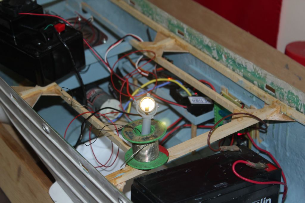

                                            Also work on installing a Bright LED into the Search light and this was completed and tested as well as a Reed switch operated by the transmitter, its not latching so I used the off option with the on happening at the flick of a lever on the tranny. At the rear of the light Silver foil at the back was glued on to give a Mirror appearance.

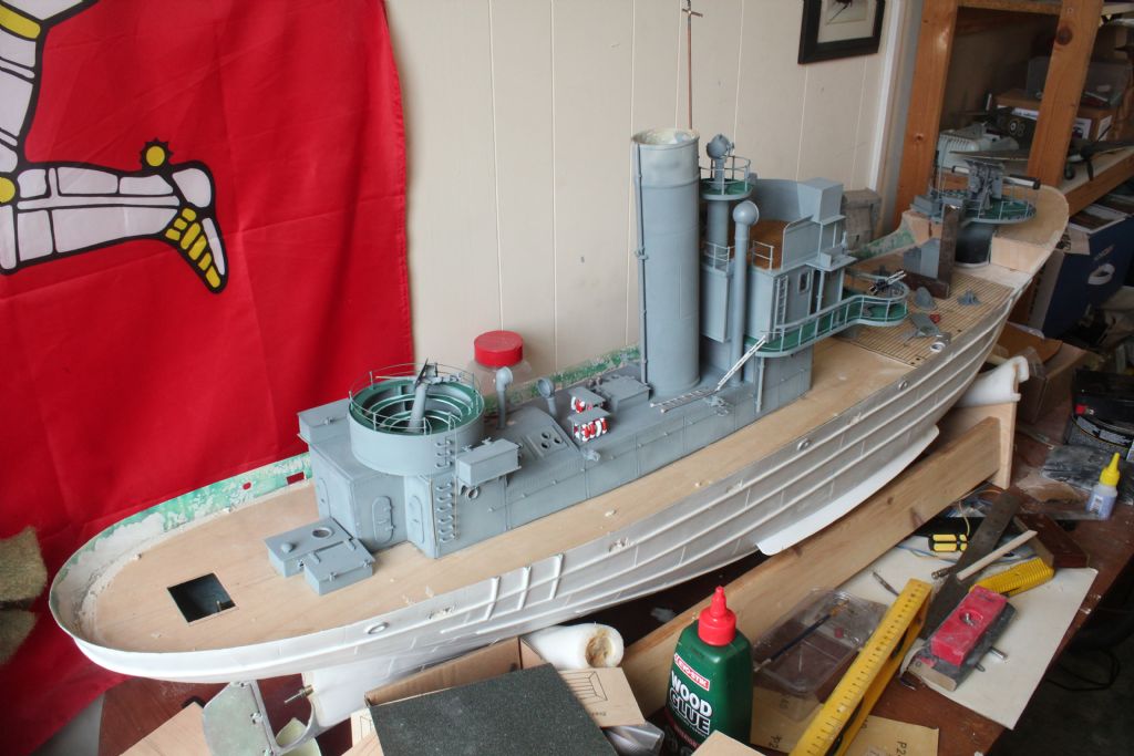

                                            And finally I plucked up the courage and decided to stick the deck on used copious amounts of wood glue so the next step will be to probably paint the hull and then to the Deck Armour plating. Flying along here!
                                            #94885
                                            George Norman
                                              @georgenorman68347

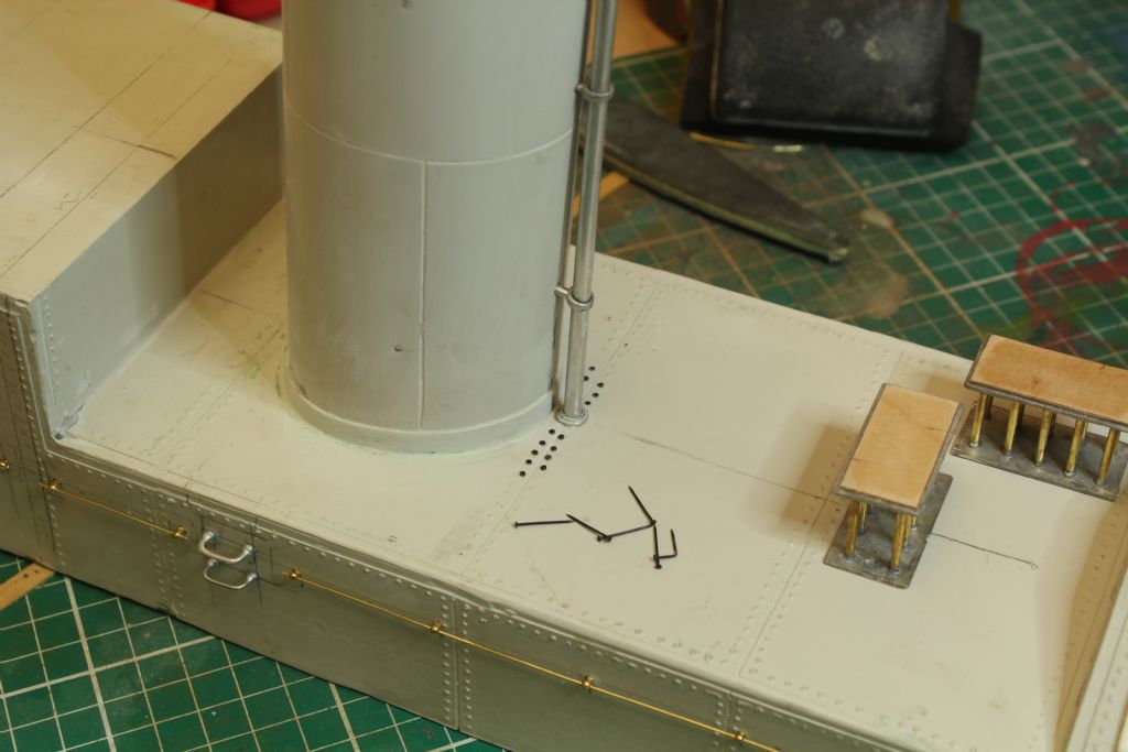

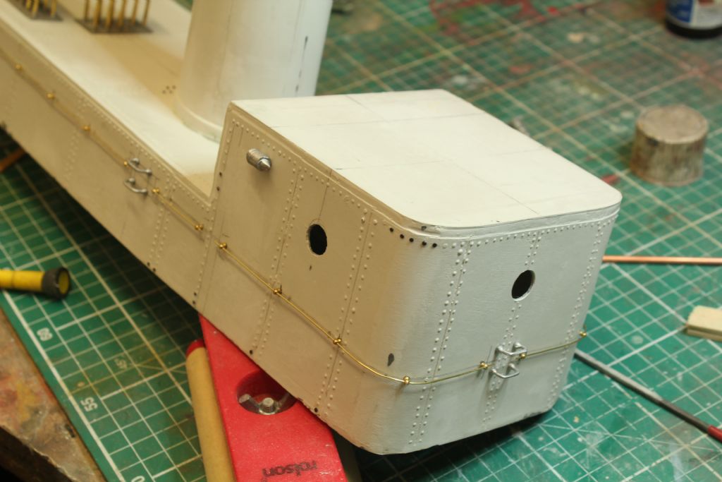

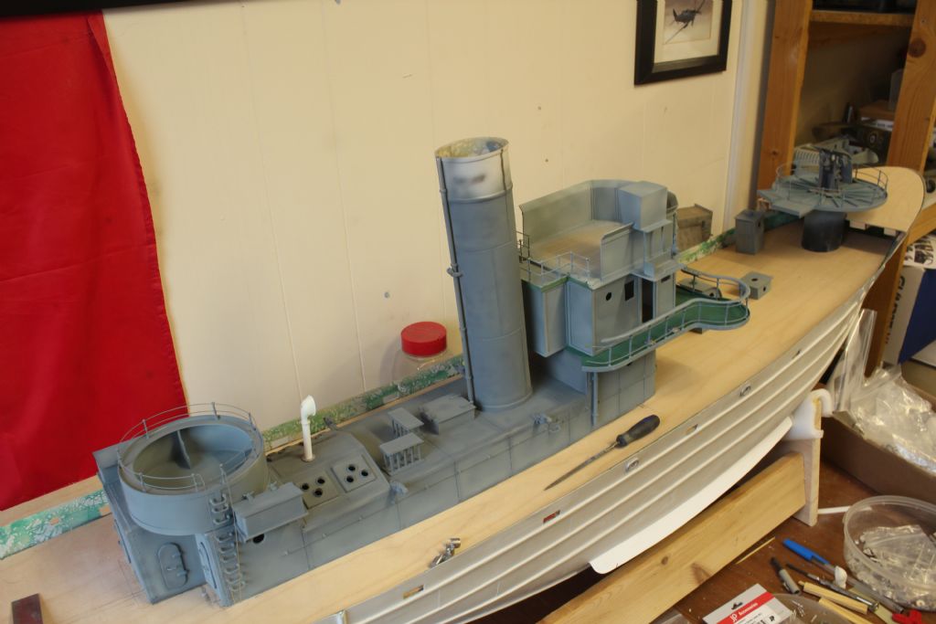

                                              Well that went well except I glued a LED wire under the Deck and a cross beam but that sorted now and the little Light rewired and the LED working under the Bow which will look nice on Sailing a dusk which I have never done!

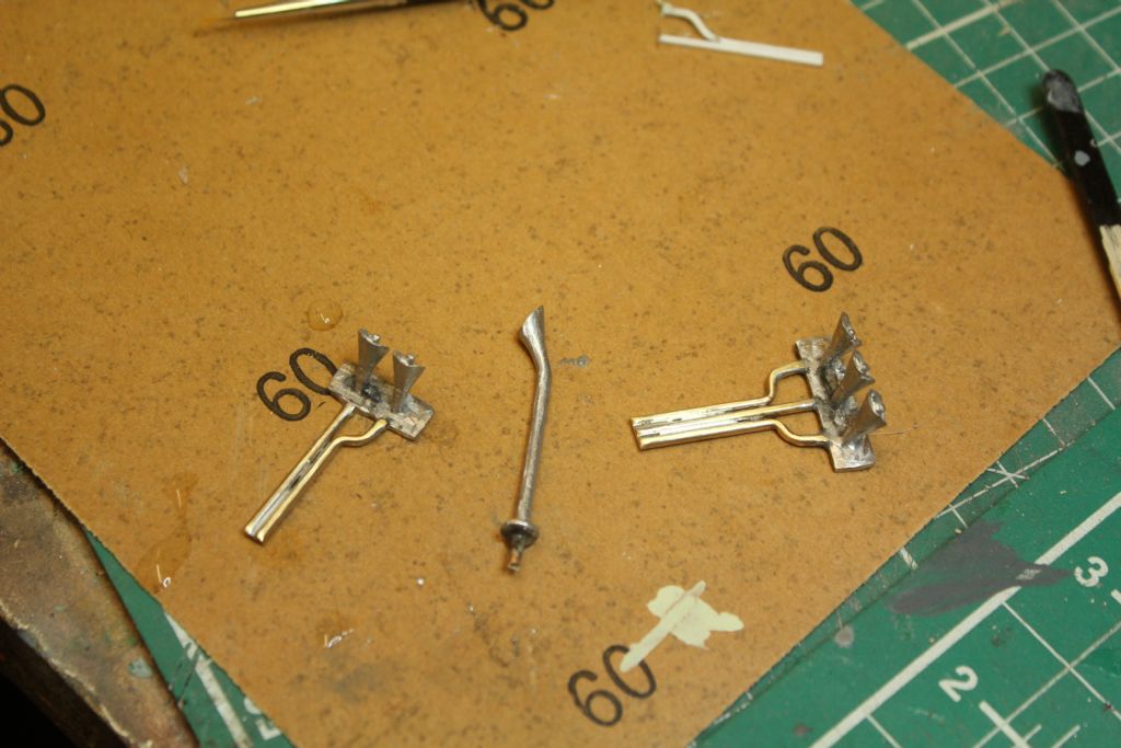

                                              I then soldered up some White metal and Brass rod for the voice pipes for the Bridge and started on the Binnacle using some 9mm dowl and coffer sticks sanded smooth! Needs to be Paint next.
                                              The Bow plate was also glued down with PVA and Left to Dry and then the edges were filled in with P39 Car Filler and then sanded smooth, Well the front part anyhow.
                                              I need to adjust one of the tall air intake pipes and one seemed to of moved and has set slightly off which is a balls but thems the breaks!

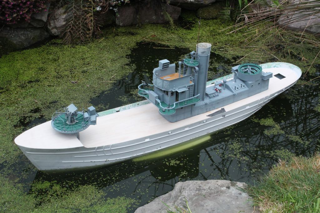

                                              #94886

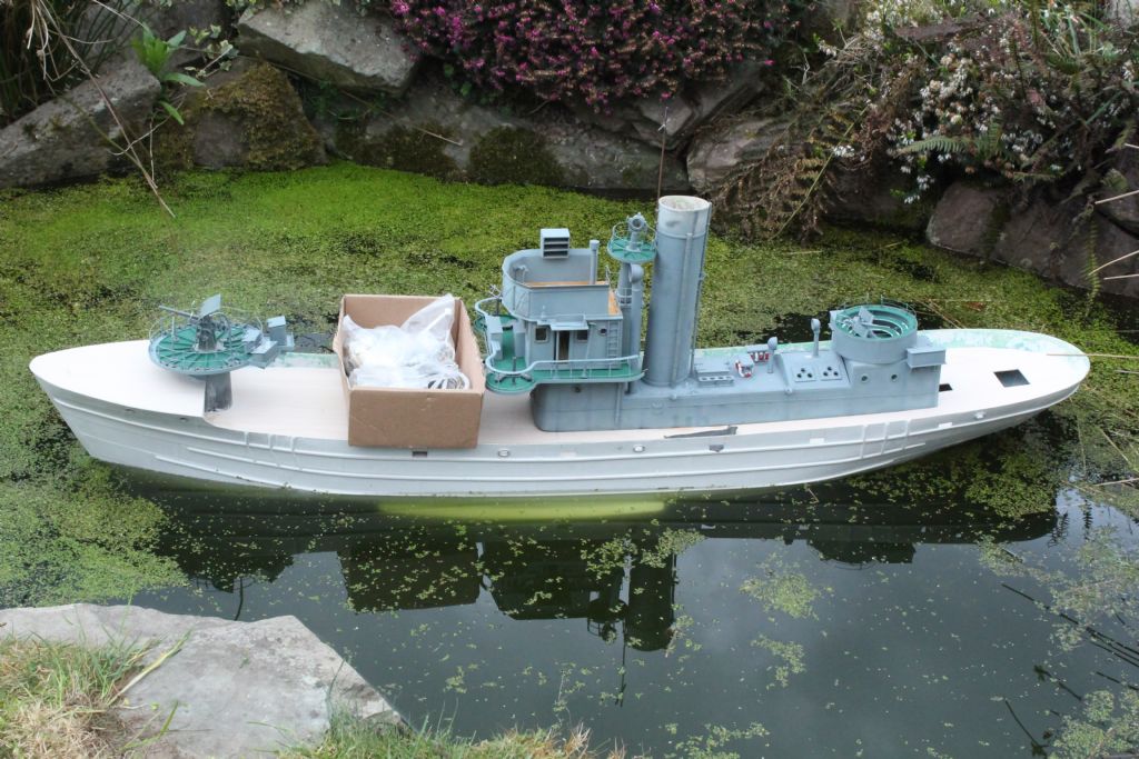

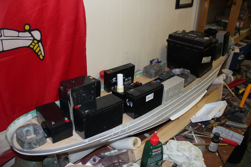

                                                Have you done some floatation tests with all that stuff aboard George? Stability can sometimes be an issue with this model unless the bulk of the internal weight is carried low down.
                                                #94888
                                                George Norman
                                                  @georgenorman68347
                                                  Not yet Colin.

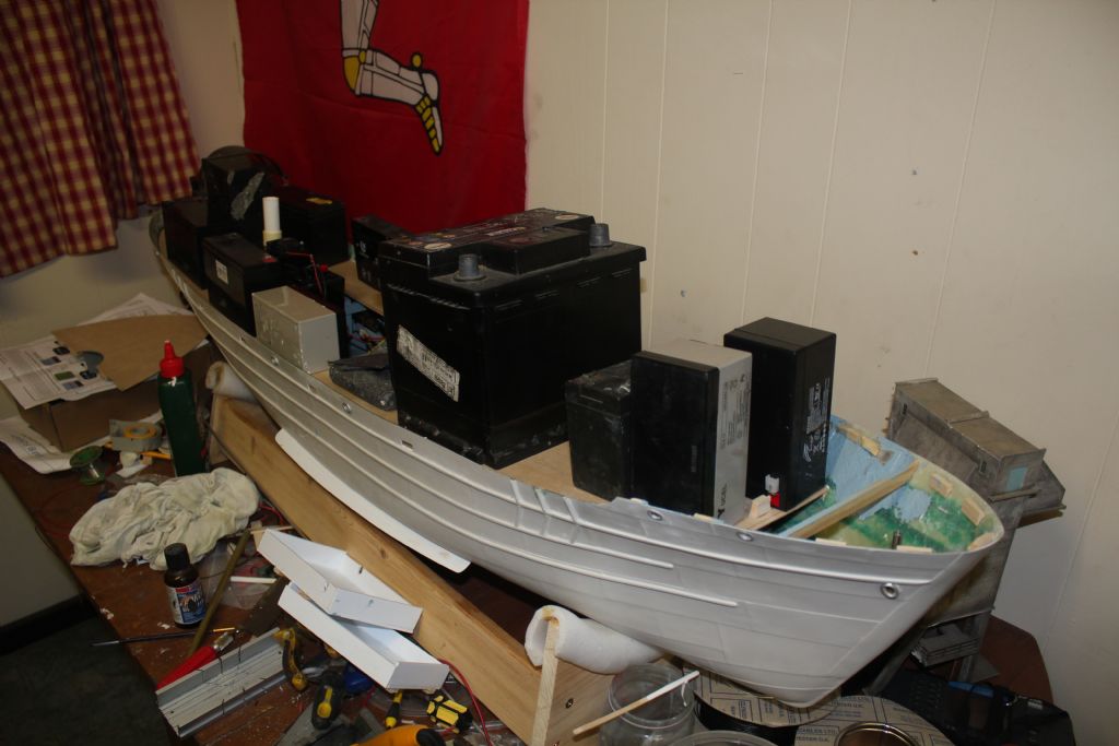

                                                  I seen some other Chaps work on the water so it defo sails! Once I have the stuff now buttoned up I will do some float tests in the bath or garden pond.
                                                  I will have 2 Large 12V PB batteries flat down about 5mm off of the bottom, I have another tray full some lead weight pummelled into a small dense lump as close to the hull bottom as low as I can go so these are the main ballast right now
                                                  I have some flat diving weights too, the placing of the Stern weights will be the main issue.
                                                  I'll give it a go later and will let you know!

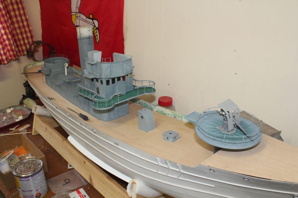

                                                    Good Evening,

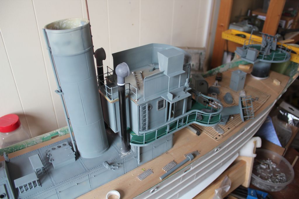

                                                    Well the sun that has been out all week has typically gone away for the weekend! Anyhow decided to see if this ship does exactly what it is supposed to do! Happy to say yes. 3 12V PB batteries in the hull and some lead aft trimmed it out. Too Small for the Tadpole pond in the fish one it went.
                                                    the shot with the box is the remaining white metal parts.
