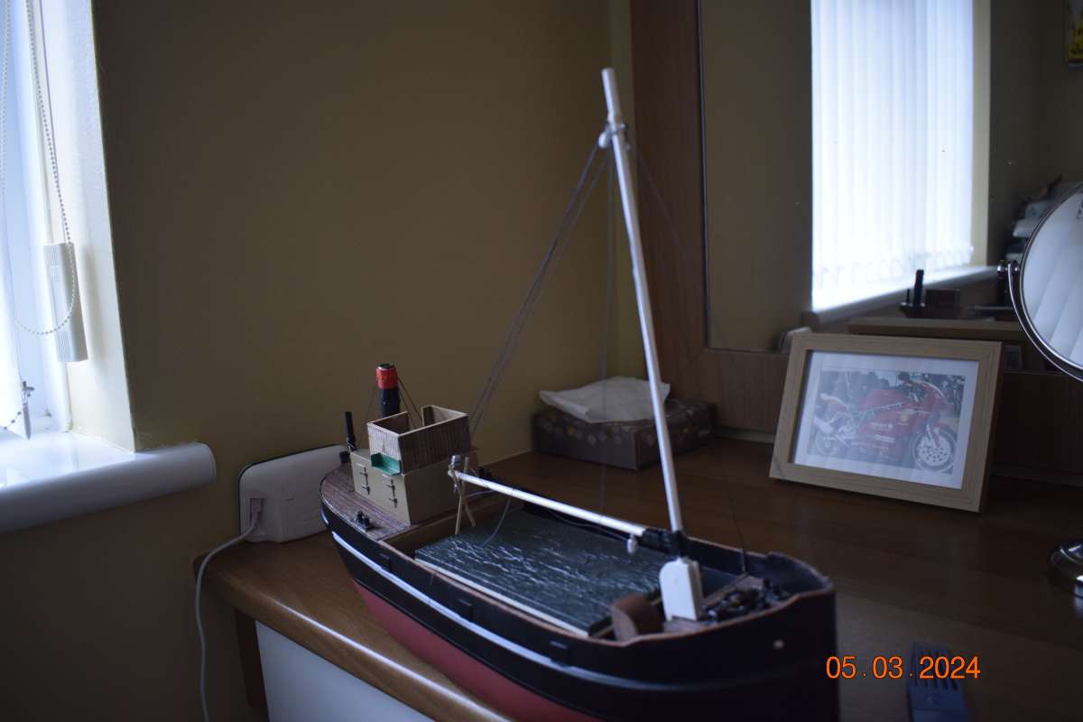

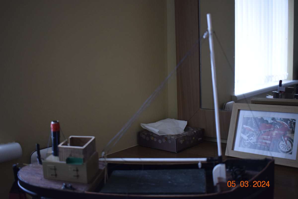

            Hi One & All
            Just when will the wealth get better?
            on Monday I started to fix the rope work on the puffer and after four hours I finished, I still have to find or make a hook, I went for the cross beams type of support for the boom.
            The next time I can get into the garage I will start to make the railings
            _DSC4467_DSC4466

              hello Fred,
              looking good there!
              is the boom static, or can you raise it/swing it?
              cheers
              Mike

                @fredellis1
                Hi Mike
                Yes the boom can move but only by hand.
                Fred

                Len Morris 2
                  @lenmorris2
                  Hi Fred,
                  Excellent progress.  You need the boom to swing to get inside without struggling so well done.  Looks like you’ll be in the water before soon!
                  Len
