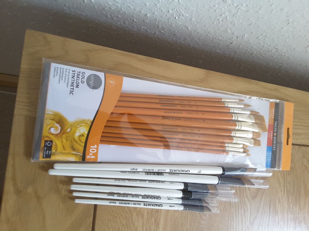

                                                #101148
                                                  Next stage has been reached!
                                                  Brushes
                                                  #101153
                                                    Hiya Chris,
                                                    Now you have all the gear, what lovely warm painting weather it is
                                                    #101158
                                                      It's too hot Ray! smile d
