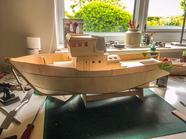

          Hi I’m new to this and recently built an Aero-Naut Fishing trawler this I painted with Halfords spray cans which were enamel. Wasn’t cheap but for a first go I’m fairly happy.
