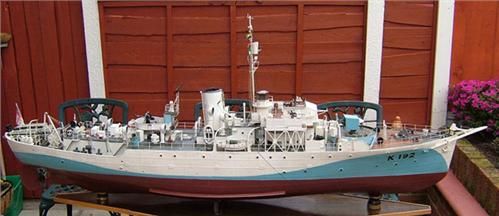

                          Super long fcstl model, as a matter of interest is the hull self built and to what scale is the ship. I dare bet that it looks superb on the water.
                          #15428
                          ARH
                            @arh
                            All scratch built to a scale of 1/32, she does sail nice.
