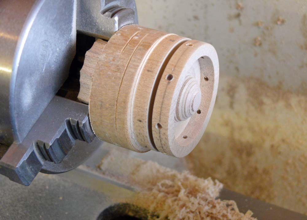

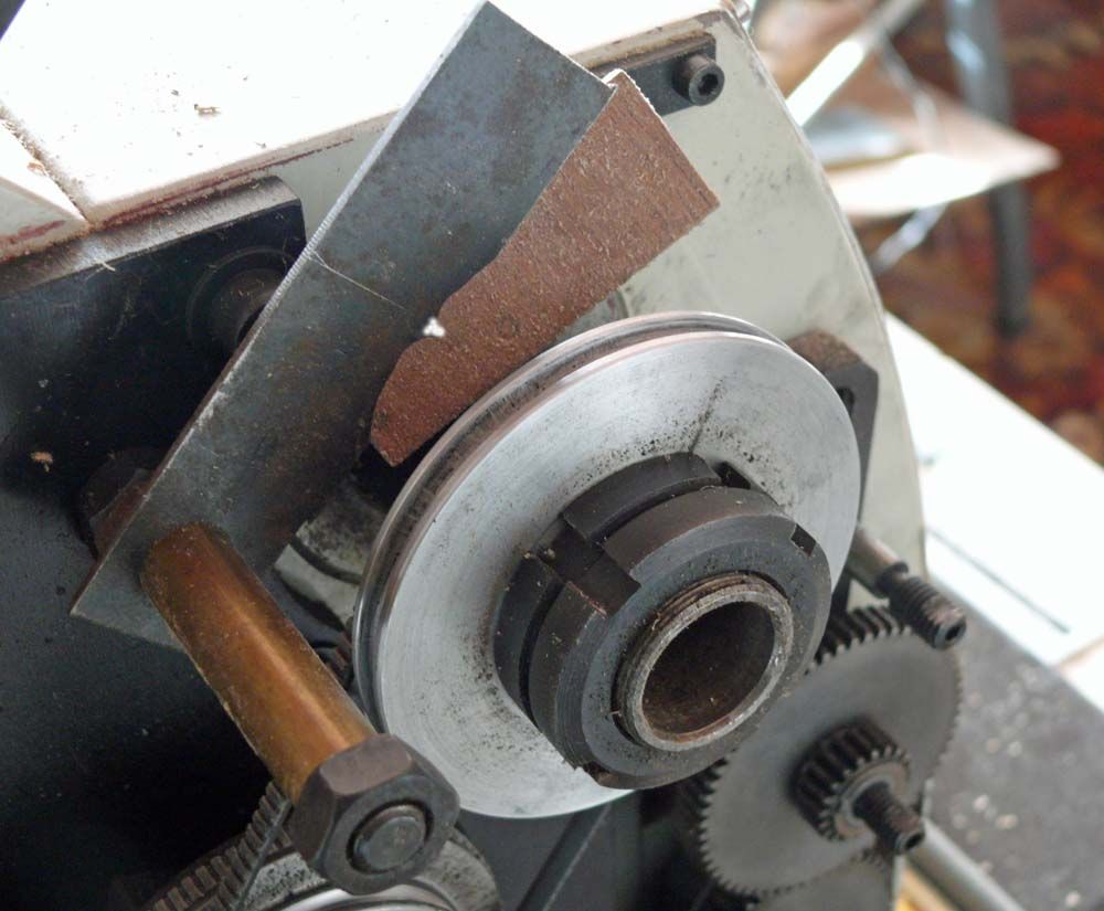

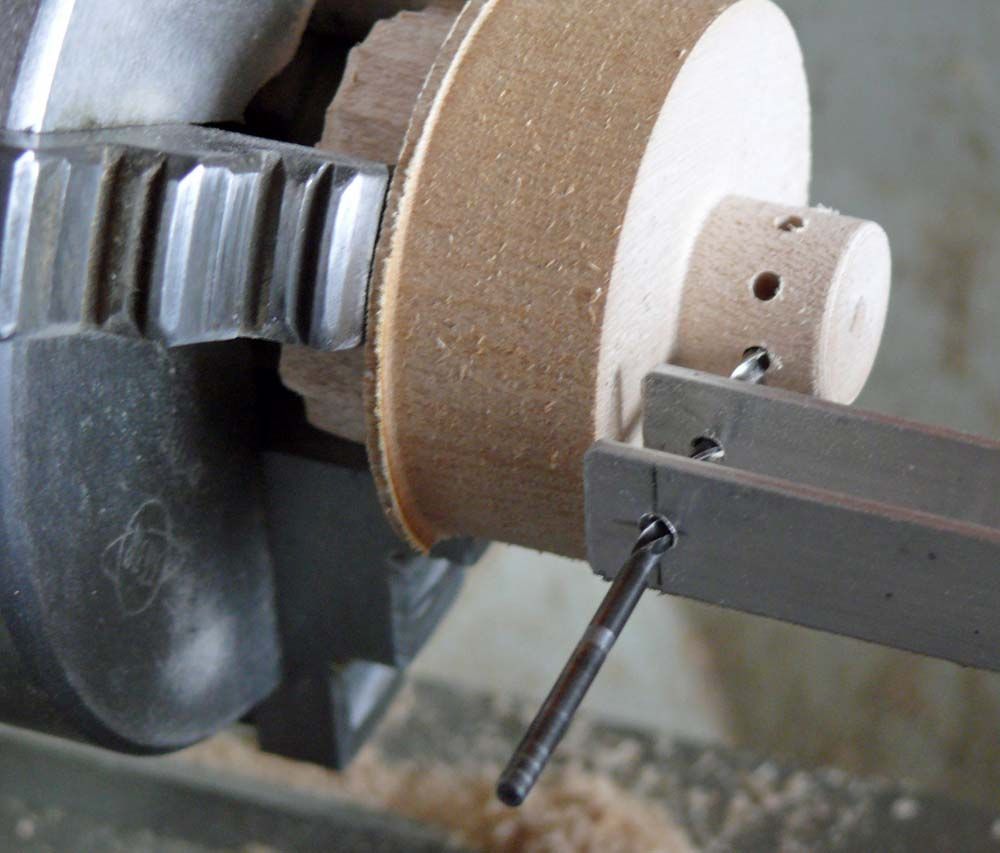

                                                    Some time ago I devised a method of drilling wheel rims reasonably accurately……It`s in Eureka Moments, if you can find it!
                                                    To drill eight holes in a rim, with any form of accuracy, is quite a tricky job without a dividing head
                                                    My lathe has a 40 tooth sprocket inside the headstock, mounted on the spindle……It`s behind the pulley
                                                    I made a pivoting arm, with a single gear tooth, shown white, which engages with the sprocket teeth
                                                    To drill eight holes in the rim, the sprocket is indexed round every five teeth
                                                    If I wanted 20 holes, the sprocket would be indexed every twp teeth and so on
                                                    In the tool post is a length of Ali channel, which is used to guide the hand drill
                                                    To be continued
