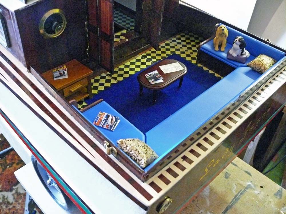

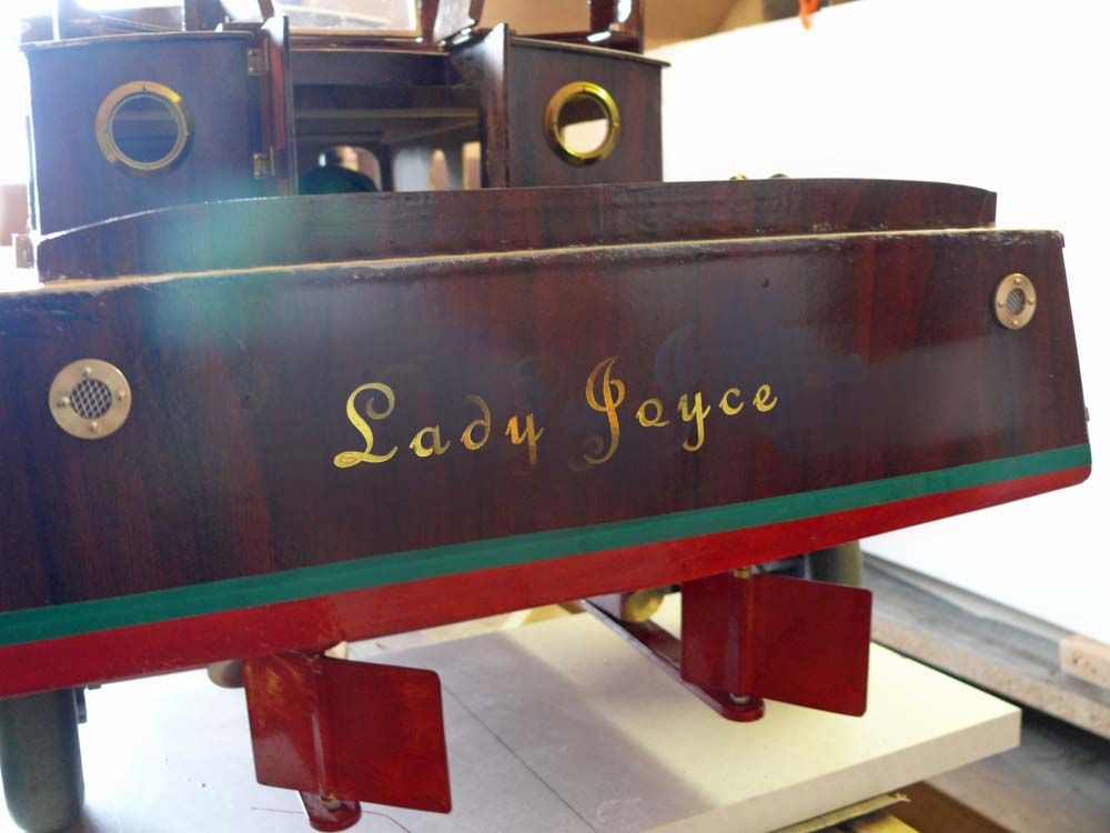

                  Paul…..I`ve managed to disentangle the gold lettering with a scalpel
                  Many thanks and kind regards to Jane….xxx
                  And played about with the furnishing arrangement

                    Oooh … now that is what I call pretty! Very, very nice lettering indeed!

                      Have to confess, the lettering was put on, a bit …"Cock eyed" for the photo, but Photo Shop put it right!…..Ha! Ha!

                        The lettering looks ok (despite your attempts with photoshop lol) The fitting out of the rear cockpit is coming along very well and I do like your use of redundant lock fittings.

                          Those Yale Lock rings are difficult to find these days

                              Just skipping around the forum waiting for some glue to dry hmmmmm and found you latest pictures, love that checkered flooring, looks fantastic, if fact it all does, the lettering is very elegant.
