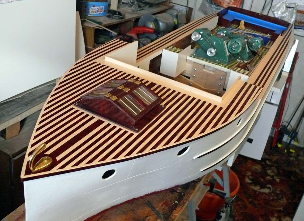

            Work in progress
            Very labour intensive, but well worth the effort?

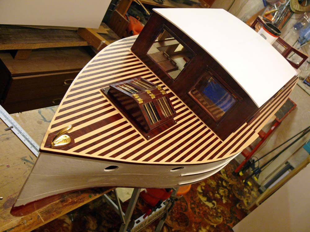

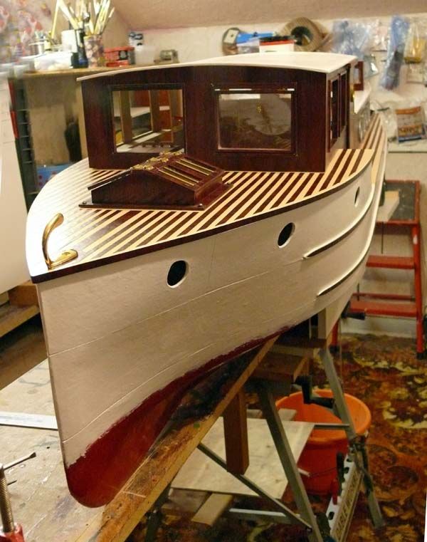

                    #56458
                      The decks are one coat varnished now and are looking delightful……What a relief
                      A big stressful job out of the way……The build should be all freewheeling downhill from now on?
                      For me, making a boat is not all Sunshine and Roses…….Viz
                      Some jobs are great fun….Such as building the structure, knowing that all is going well or fitting the motor drives…….Or slapping on the undercoat
                      Some jobs are really hard work and boring…..Such as cutting out the frames………Filling and sanding
                      Some jobs are fiddly time consuming and nerve wracking…….Like planking a difficult tricky, impossible to make area…..Like the Thomason Bow……Or the deck stripes…..Or using Fablon for the first time….Or covering the hull and decks with lining paper
                      Some jobs are light entertainment and bring a smile……….Running the motors for the first time……..Loverly
                      Some days I feel like packing it in!
                      But standing back, right now……It`s looking very pleasing
                      What building jobs do you chaps, love and hate?
                      #56459
                      Banjoman
                        @banjoman
                        That is an extremely pretty striped deck effect, Bob! Looks very classy indeed, with a truly lovely flow to the lines!
                        And am I right in thinking that the brassy thing up at the bows used to be a coat hook? It does rather look like one …
                        For my part I've always enyoyed most parts of a build except filling, sanding and waiting for glues or paints to cure properly … Whenever one of those are on the programme, I have to give myself a proper talking to, in order to make sure that I don't let my innate impatience get the better of me.
                        /Mattias
                        #56461
                          Thank you, Banjo
                          The stripey deck was a lucky alternative solution to the original idea of having an inked lined planked deck
                          It also hides the imitation wood finish!
                          The hook at the front is a brass coat hook, I was after an enclosed handle type really, to be strong for beaching the boat, out of the water. Will keep my eyes open in the mean time
                          Cheers…….Bob
                          #56477
                            Hi Bob
                            The brass hook looks quite neat from the camera angle and really fits in with the colour scheme.
