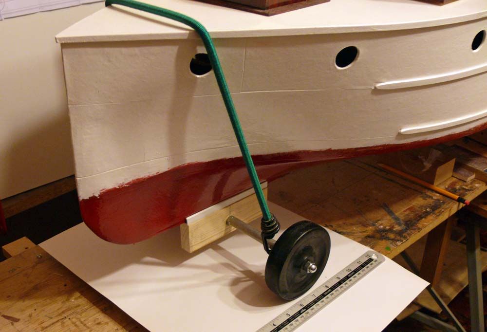

        Front transportation wheel……..Sorted!
        Wheels supplied by the clubs skip watcher……..Duckie

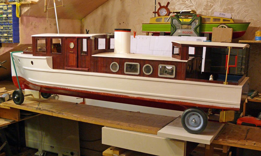

          Even more work in progress today
          Need to tidy up for Ellesmere!
          Fixed the rear windscreen and canopy

                  Thanks Duckie
                  Not looking forward to applying the water line stripe yet
                  It's a bit cramped below the rubbing strip area for my liking
                  Will probably buy some plastic lining tape at Ellesmere

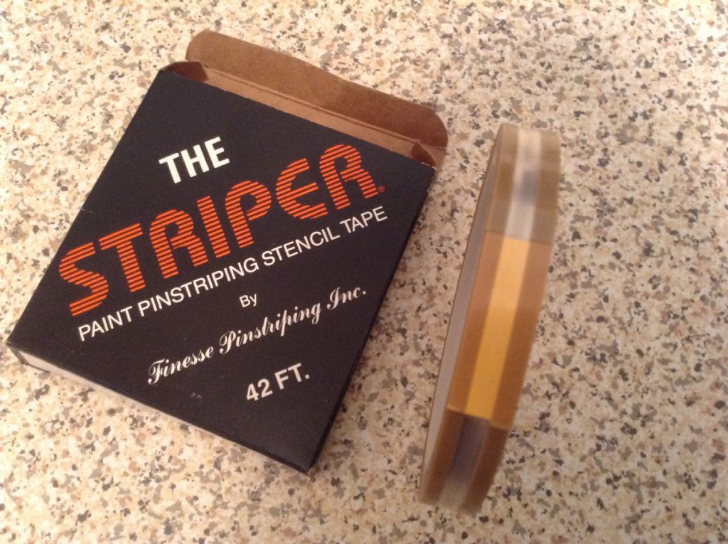

                                    Colin the pinstripe tape is called 'the striper' made by an American company, Finesse Pinstriping Inc. I found mine on eBay. ( must confess I haven't tried it yet, ) but basically it is two tapes stuck to a 'carrier tape' the whole lot is stuck where you want it, and then the carrier tape is peeled off leaving the two tapes each side of the paintable hole. If that makes sense.
                                      #56164
                                        Well done, Chris……..It's easy when you know how!
                                        Never knew this type of tape existed………Don't fancy it either!
                                        Thanks anyway

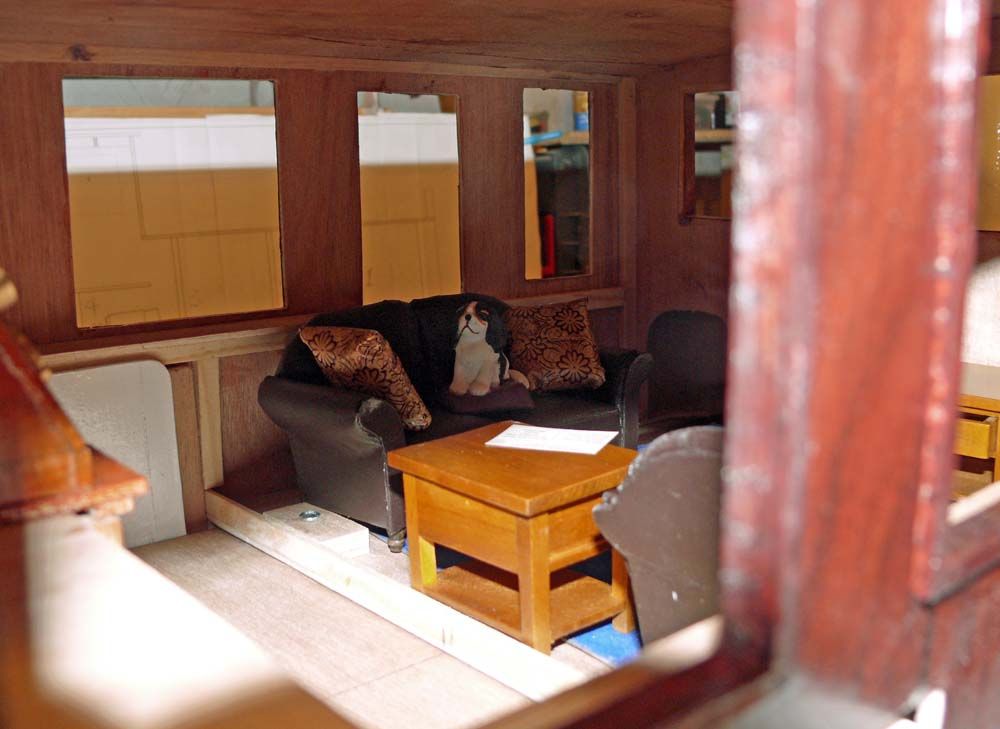

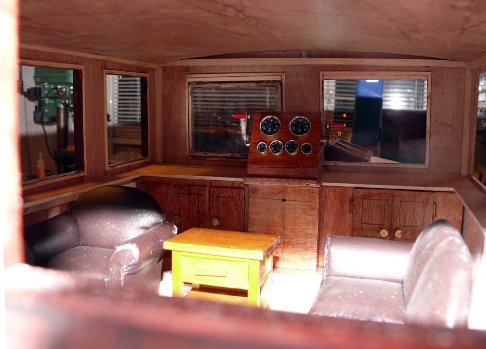

                                                  Found some 1/12th scale furniture today and it was great fun rearranging the floor layout and peeping through the windows, taking a few pictures. Saw some very pretty working Tiffany table lamps and table settings etc
                                                  There`s no end to the stuff that could be added
                                                  Spot Maisie on the settee again
                                                  All for the children of course!

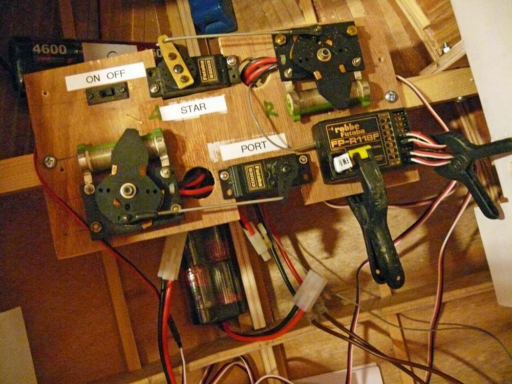

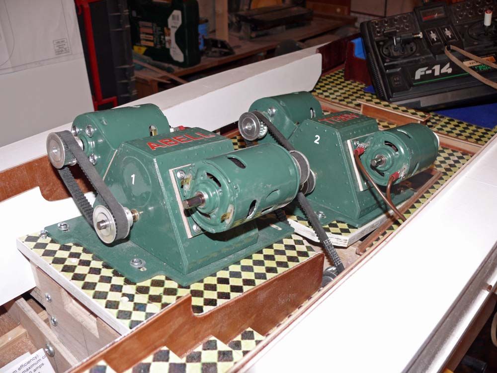

                                                    Finally got the motors running!
                                                    And what a grand sight!……….It was an all action spectacle!……….Nice to see the timing belts running smooth and true
                                                    There was quite a draught behind the props too!
                                                    The poor controllers got very hot after a few minutes running and smelt it too……..Don`t look Dave!
                                                    I wonder how the ESC`s cope with the electric fire effect?
                                                    It was great fun, all the same……….It can only get better

                                                      Bob. Please please please please get an electronic ESC (s). Are those Bobs boards going to hande 20A+ from each pair of motors when under load…when they get hot just on tickover out the water !!!!
                                                      i suggest you fit a fire extinguishing feature in your boat.
                                                      Great motors, a real feature (will they look so good in black??)
