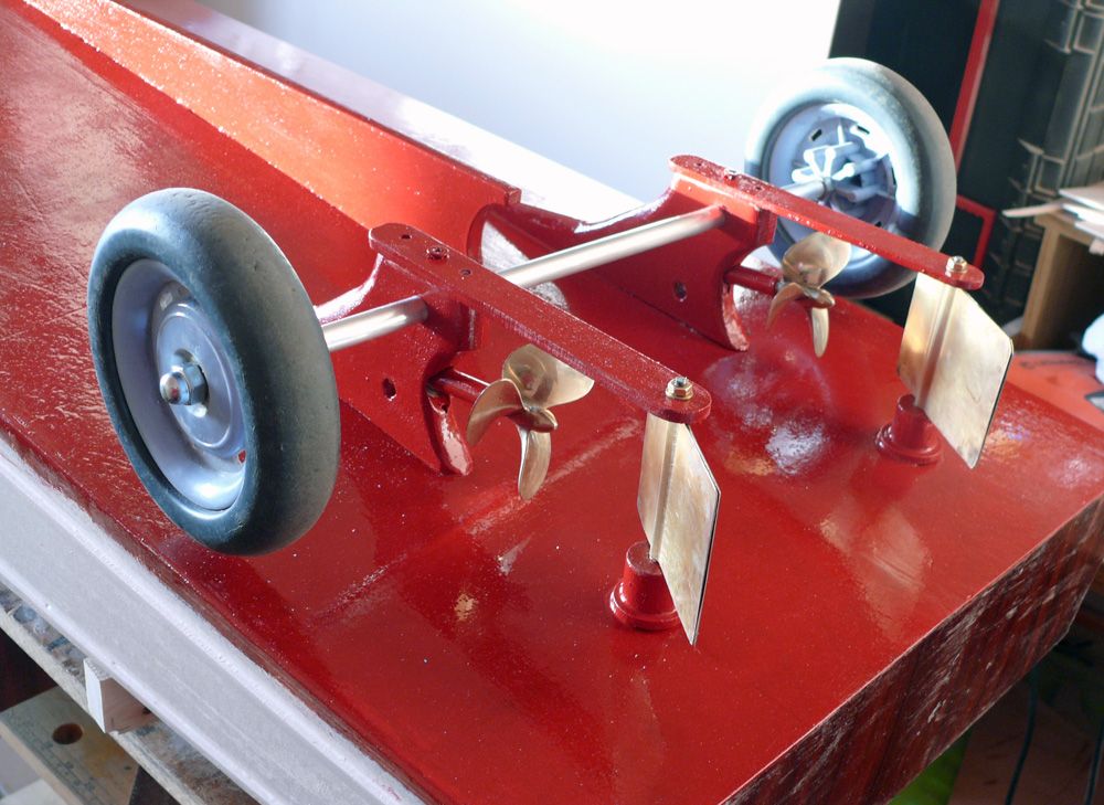

      This model is extremely bulky, so handling it from the car to the pond and into the water, needs to be as simple as possible, manually and mentally
      To make room in the car, the fixed wheels idea has got rid of the stand and a launching trolley……..Nice?
      For once, it's not a high speed model….It's a Vintage Gentleman's Launch and will simply purr around the lake in sedate style, hooting and tooting along the way, hopefully, the wheels will create some interesting water disturbance too
      The fun part for me, is the building…….I'm hoping the sailing will be too
      Thank you for your comments, my friend……I can always take the wheels off, if necessary
      The prop blocks are bulkier than usual, in order to take the fat prop shafts

        Bob. Thank you for that. As usual my comments were just my personal opinion but its you thats building it and will do what you want!
        The problem of transporting and launching larger heavier vessels is of course an issue and one that indeed needs addressing.
        You wheel approach is certainly a way round this and novel too. We could do with some exploratory work in this feild, and although I dont care for the wheels, will be very interested to see the practicality of them in use and also the effect of them on the boat. i suspect this will be negligable, as you say, it is a boat for pottering around with.
        I of course have several items with wheels and i would think that they make no difference to the craft in the water considering the general shape of them.
        Motorising yours (like my Toyboata) would be the way to go, if you dont mind me saying, and would be the icing on the launching wheel saga.

          Ashley….There you go again……..Sit down, you're rockin' the boat
          How can I have motorised wheels? They are under water most of the time
          It's a fanciful idea, but it would mean that the front wheel would have to rotate, and at the moment, we've got just a brass rubbing strip

            if you were to revisit my Toyboata article, you would see that the wheel axle has meccano toothed wheel on it, and the prop shaft has a meccano worm drive on it.
            The propshaft has a prop on the end, but the shaft in rotating also then turns the wheels at a very reduced rate (due to the worm)…
            If you had an easily replaced nylon strip at the front , this should do you as a low friction rubbing strip (it will be water lubricated). We are not talking about driving miles, just off the ramp??

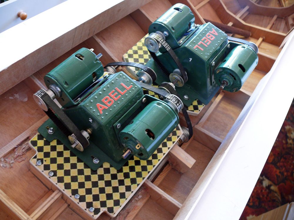

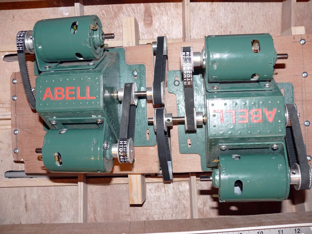

                    Am I missing something here. Don't get me wrong the Abell drives look absolutely fantastic, but, do you really get twice the power / torque by using two motors connected by a belt? What if one goes wonky?
                    Might have covered this off before or elsewhere, apols if you have.
                    Andy
                    #54965
                      Hello Andy
                      If the motors are working hard, then they would give out twice the power
                      But, in our case they will just be tootling along
                      Should one motor pack up, then the system will run as normal on the one healthy motor
                      Thanks for your question
                      #54966
                        Hi Andy
                        The Abell drives are Bobs own creation and I have to say that it is an impressive and very elegant way to add extra torque to a power train.
                        As you can imagine a 5ft model will require a lot of motive power, especially so when moving against a current, and Bobs solution of adding matched pairs of motors is a very innovative method of solving the problem.
                        The really elegant part is the ability to change the gearing by simply substituting smaller or larger pulleys to the propshaft ends.
                        Brilliant idea.

                              Final drive belts installed
                              Now the drive can be finalised and tidied up
                              Sorting out the belts and pulley sizes was just like being back at work
                              BOB
