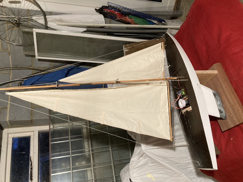

                            #93137
                            Alan Latham
                              @alanlatham99319
                              Not sure why it has rotated.
                              #93138
                                It is the way your camera has encoded the image data I'm afraid.

                                  #93140
                                  Alan Latham
                                    @alanlatham99319
                                    It's ok with a landscape photo; the first was portrait.

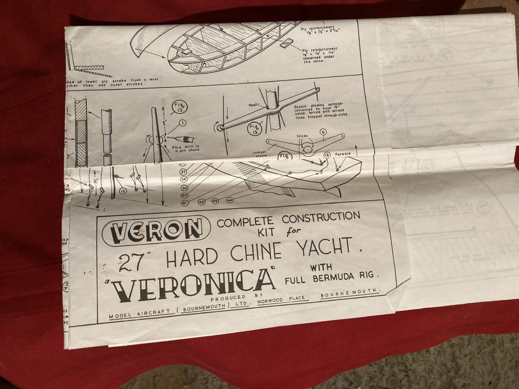

                                      @alanlatham99319
                                      Original Plans
