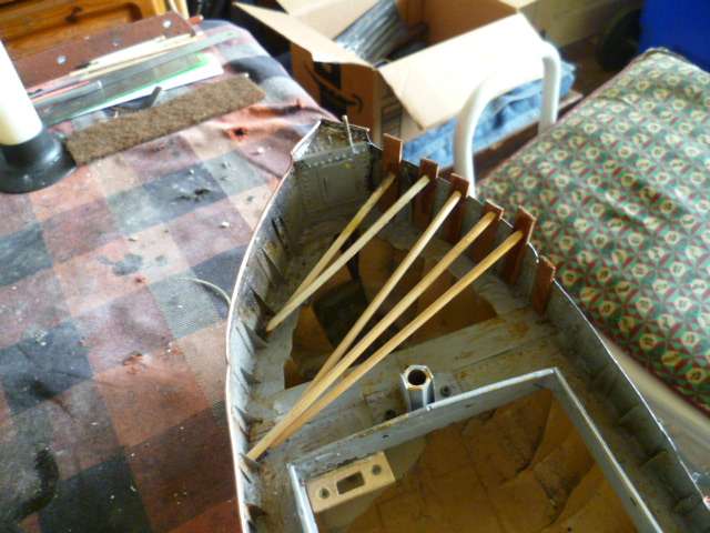

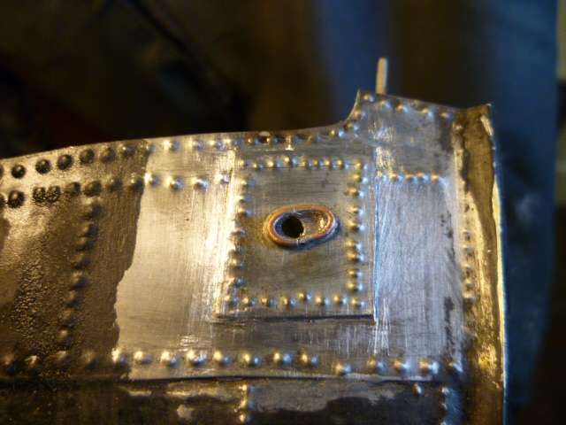

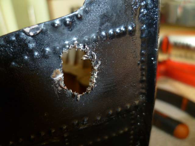

                  Hi all.  Been a month since I last posted anything.  First two weeks were all about garden projects but I did take mi Puffer sailing every weekend.  Then I joined Jim’s club and managed to fall over a stone wall I was repairing.  Blue light to the hospital and operated on the next day.  Broke mi left hip and wrist.  Apparently I now have a shiny new ball joint in mi leg and a wrist full of plates and screws.  Got out last week.  I can get about the house on a posh Zimmer frame and underarm crutches but mi left hand is a bit useless at the moment. It’ll all be right eventually.  🙂
                  As all I can do is sit at a table I thought I’d start finishing mi Puffer.  Stripped her apart which took ages and decided to finish the hull.  She needs the flushing ports, the rubbing strips and the eye for the anchor chain and painting.  Started with the anchor port and here’s the result using a Dremel with one hand!
                  P1050592
                  Time for a rethink!  Two days later managed to clean up all the dross and decided to plate her.  Here’s the end result.
                  P1050598
                  Given two hands I could have made an almost invisible repair but I can live with the plate.
                  Just old Puffer wear and tear or at least that’s mi excuse!

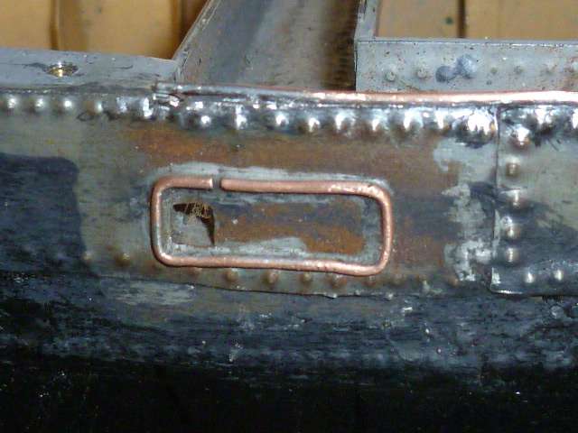

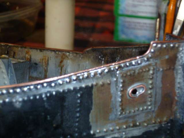

                          Slow but steady progress.  The freeing ports are highlighted with copper wire and the small square holes give true drainage to the deck.  I don’t think I’m going to attempt any flap doors at least not yet.
                          P1050604
                          The edges of the bulwarks have been wired to give a finger safe edge.  It should have been a easy job but with mi duff hand had to use temporary shoring and a load of clips to hold the wire in place.
                          P1050600
                          Here’s the result which I think I can live with.P1050602

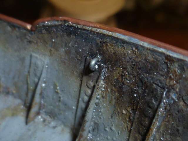

                          The last job was to solder in a series of ‘eyebolts’ along the inside of the bulwarks to anchor the rigging.  It was a small fiddly job but best done now while the hull’s in a mess again.
                          P1050603
                          Now it’s time for the wood fenders and I can then start getting getting some colour on her.

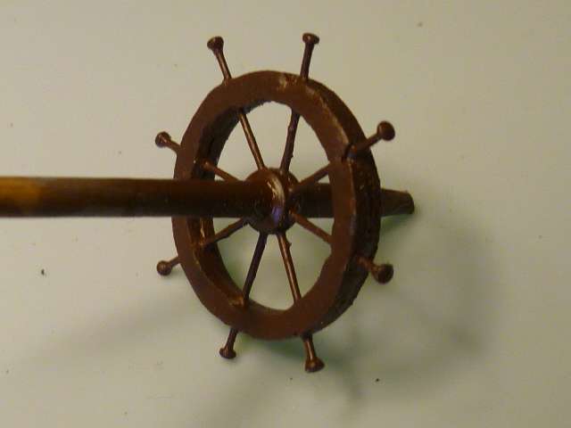

                                              You might find this interesting. It’s a picture of the wheel for my Puffer.  I thought I’d already posted a picture when I made it ages ago but obviously not.  It’s just a sandwich of 22mm fibre sealing washers and pins on a a cocktail stick all glued up and lashed with brown paint.  At my scale it’s about 3 feet diameter.P1050607
                                              The old Model Maker and Model Boat mags describe this construction quite often and some where embellished to works of art.  What you see is as far as I’m going with mine.
                                              Len. 🙂

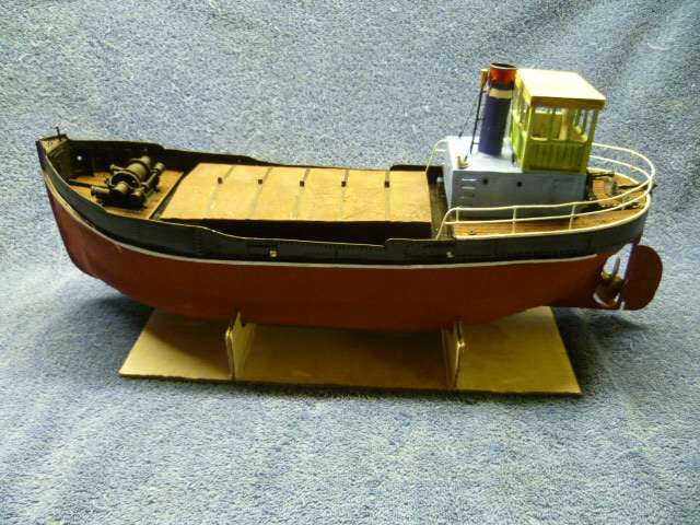

                                                    Now walking without crutches but hand still duff.  Anyway, here’s a picture of the real progress.
                                                    P1050608

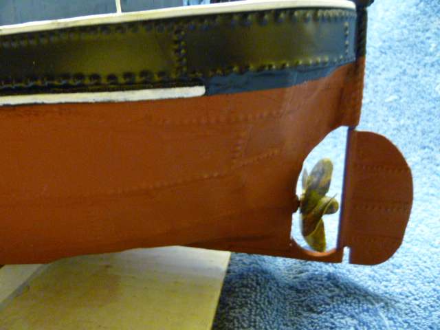

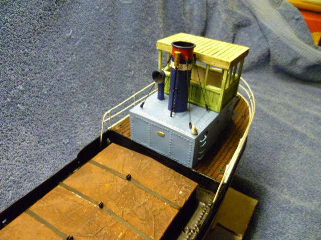

                                                    The rubbing strips are on and painted white with the hull red and the uppers black.  After the first few sailings I decided she was over propped.  At full throttle she was off like a speed boat and had to be well ballasted to keep the prop blades just under water.  The prop was reduced from 45 to 42  mm.
                                                    P1050610
                                                    This gives a lot more clearance, allowed me to remove some 300gms of ballast from the bow, level her by shifting the battery forwards and gain a pleasant increase in freeboard.  I’ll probably regret it but we’ll see!
                                                    The stern has had the most attention with the railings finally being done.  Not the best job but as good as they are going to get at the moment.
                                                    P1050612
                                                    The verticals are bits of paper clips soldered into to rear deck and the railings are copper wire from heavy house cable.  Funnel is stayed with 0.6mig wire.  Bit of a paint job with some weathering applied to the ‘white’ wheel house.
                                                    All for now,
                                                    Len.
