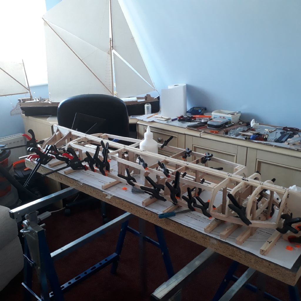

                20190508_185525.jpgHi Ray
                Thanks for head up about the lake
                Going to Midhurst show instead.
                Photo shows start of project
                Should be finished about 2021 LOL

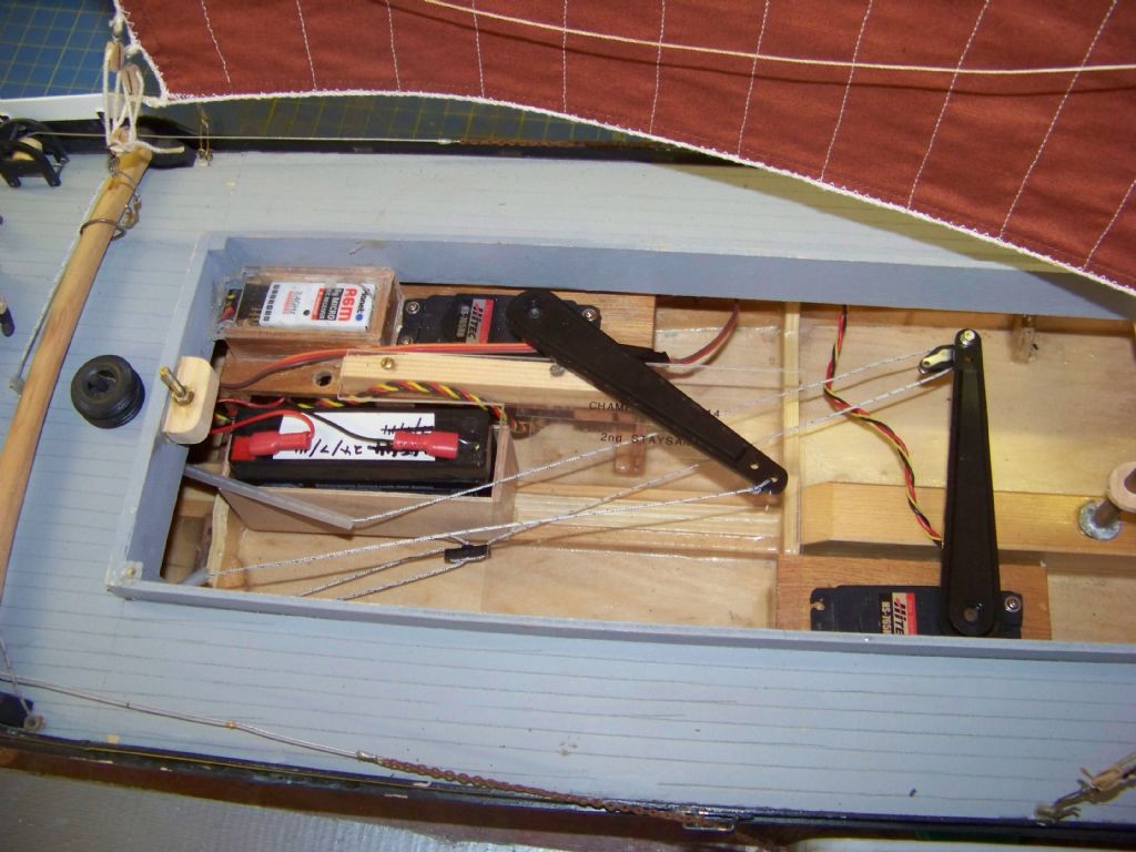

                                  Hi,
                                  here is foto Peter Simmond´s Veronica, the double sheet.. for Mainsail,single sheet for Vangs100_2265.jpg

                                      It's good to see the internals of other boats to see the different solutions to the same problem.

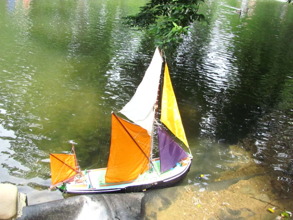

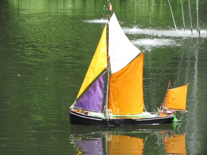

                                        img_1712.jpgimg_1711.jpgHi,
                                        Yesterday I put Gusty Cat for the first time on the water. After about 5 minutes the servo rudder stuck. I was glad to get the model to shore. It seems to me that even with a small staysail the model will run well.I have to replace the servo and then try the model again. Unfortunately, I was not able to take a picture of the model during the very short cruiseimg_1709.jpg

                                          Hello Tom,
                                          Good to see her on the water where she belongs, the servo will be an easy fix, glad to see you have good weather at last ! And your dog can take you for a walk 😀
                                          Eddie and I are going to build Destroyers next, we should have a small navy soon 😮

                                            Hi.Tom, nice to see her on the water and with some sunshine, look forward to seeing her under sail soon.

                                              Hi gents,
                                              mea culpa, mea culpa .. today I tried to turn on the GK receiver again, nothing worked. Finally, I found that the battery had a low voltage, about 9.5V.Then I could be surprised that nothing works…
                                              If it comes out tomorrow, I'll go back to the park with the model. For a change … I hope at least a little wind will blow……when model seems to be ok…

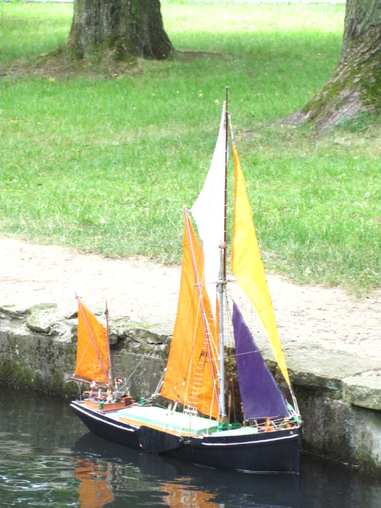

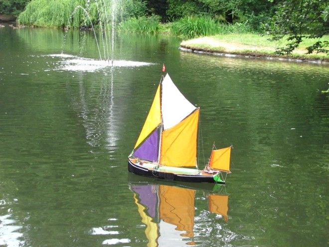

                                                  img_1723.jpgHi Eddie,
                                                  next troubles with password now.
                                                  So … I found out that the servo was probably OK, the problem was caused by a discharged battery. I recharged the battery and took the spare battery with me. Everything was OK. I loaded the model + accessories onto the cart and brought them all to the park to the pond.The weather didn't feel very good to me, it was quite cold by the water,
                                                  and the wind almost did not blow. The model behaved unexpectedly well on the water, so I could make some photos.
                                                  Next time I need to fix the clutch on the auxiliary engine and I would like to install a mini voltmeter to monitor the battery voltage. It would make my control much easier.
                                                  Next photos are in the album (Gusty Cat)

                                                    Hi. Tom,pleased to hear that you are slowly eliminating your problems, as you say not enough wind to fill the sails.
                                                    Perhaps another day though.
                                                    Charging my batteries at the moment ready for tomorrow, but rain is forecast, Susie May only uses about 250 milli amps over a 3 hour sail time.
