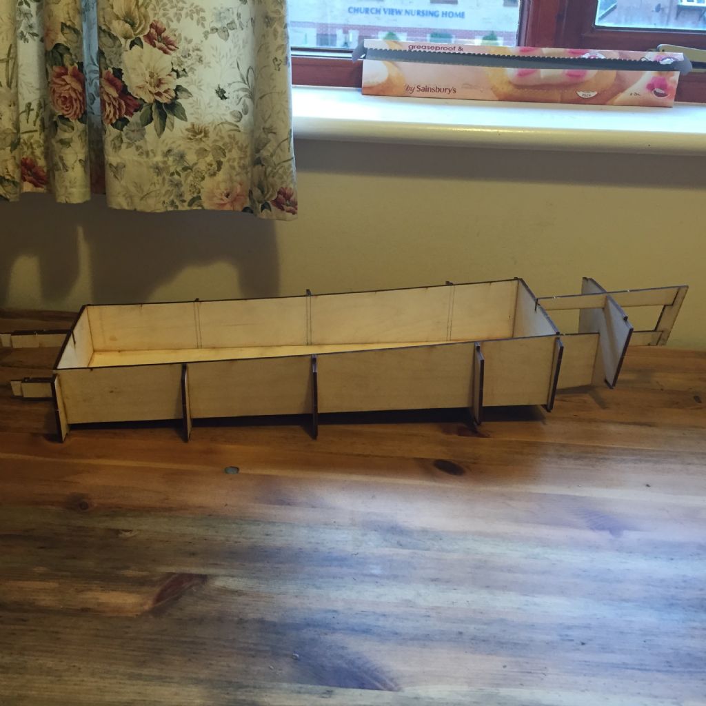

      got a Thames river police kit so made a start putting it together last night , using pva wood glue as instructed so can only do small stages at a time while glue drys . Has anyone built one of these before ? I believe it's a aerokit but correct me if I'm wrong ?

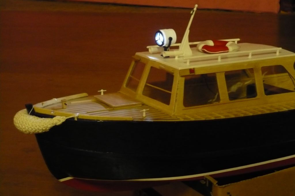

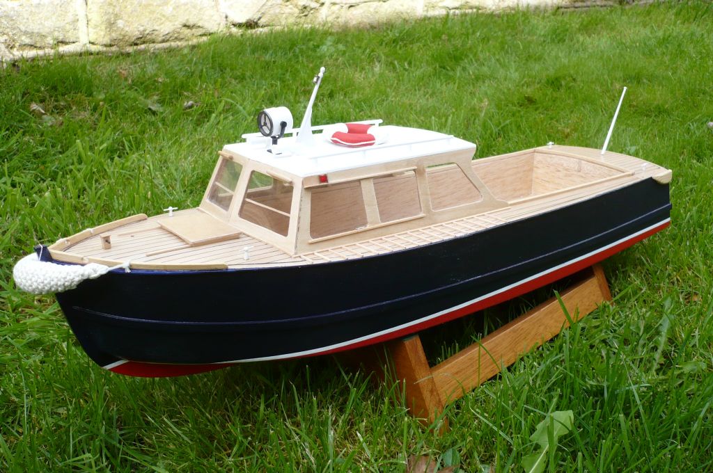

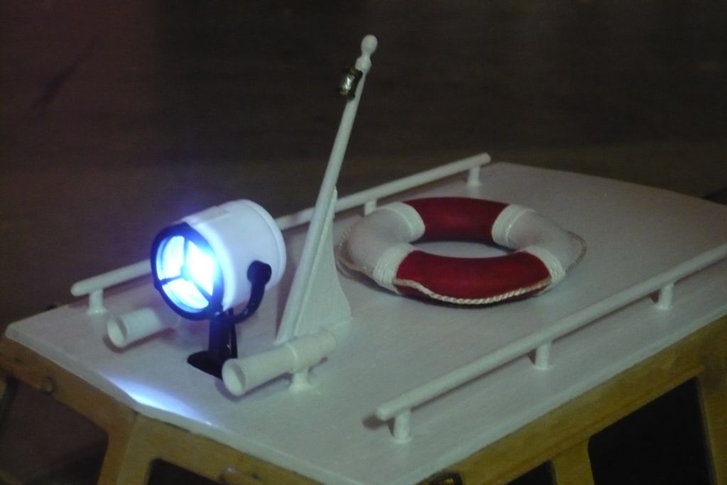

                              Matt,
                              Had a look around and found some photographs of the Veron Police Launch. The last one shows the roof detail including the air horns. The lifebelt had to shaped from obeche as nowhere could one be found to the same size as the one shown on the plan.
                              Motor was a Graupner ECO 600, but the model never saw the lake. Today, a brushless set-up would be better.
                              Somehow I regret not repairing the model and having some lakeside pleasure.

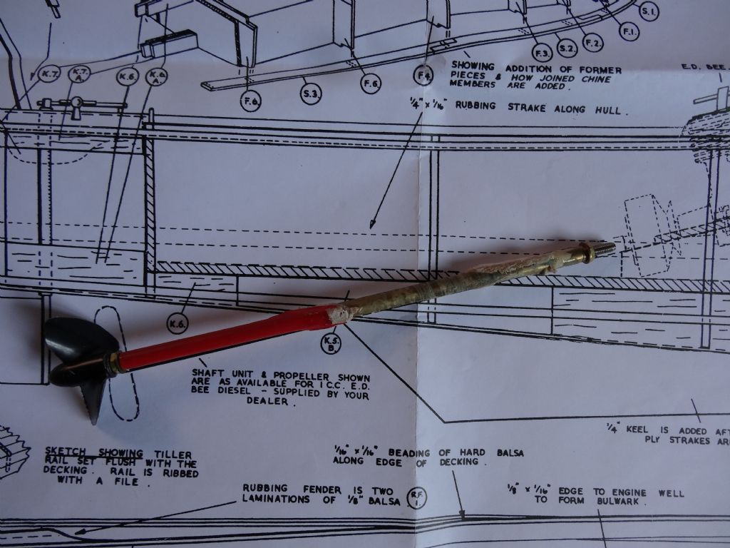

                                    In the booklet the prop shaft mentioned is a 8" but is that the complete length of just the outer tube ?

                                      Had a look in the shed and found the propeller shaft which had been removed from my Police Launch. I've overlaid in on the plan. The length of mine was a 7" outer tube, which is shorter than the original plan, or the 8" suggested on the instructions provided with your kit. The reason for the shorter shaft was to allow for the length of the huco coupling and ECO 600 motor. This installation still retained the correct tube length under the hull.
                                      Looking at the original plan, the shaft length is approx 7.75" long which appears to be a unit manufactured for the 1 cc E.D. BEE Diesel, which would have been the power unit many years ago. This appears to be a close-coupled unit, without having seen one I can only guess no flexible joint was part of this early installation.
                                      The propeller in the photograph isn't the correct one ( It's obviously too big just happened to be one I had in the spares box), screwed on for this illustration. It may be worth laying out your chosen coupling, motor and propeller before choosing and ordering the shaft.

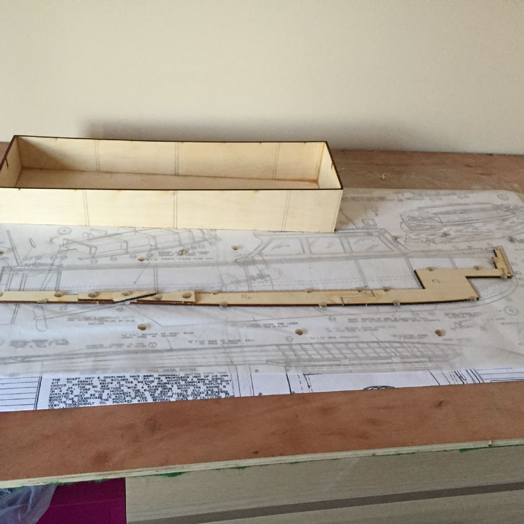

                                                      Been plodding along slowly but not impressed how the upper and lower chine fits together the plan to pin to is longer than the peices where you got the joint had to be half pulled out from next peice and glued , I will have to reinforce later once know nothing in the way .
