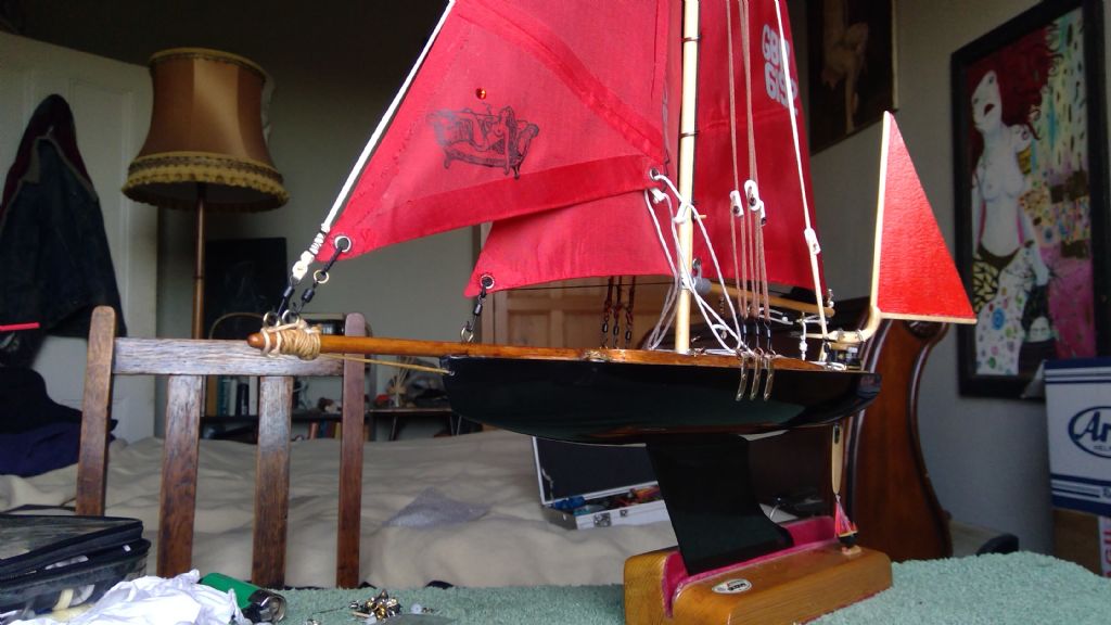

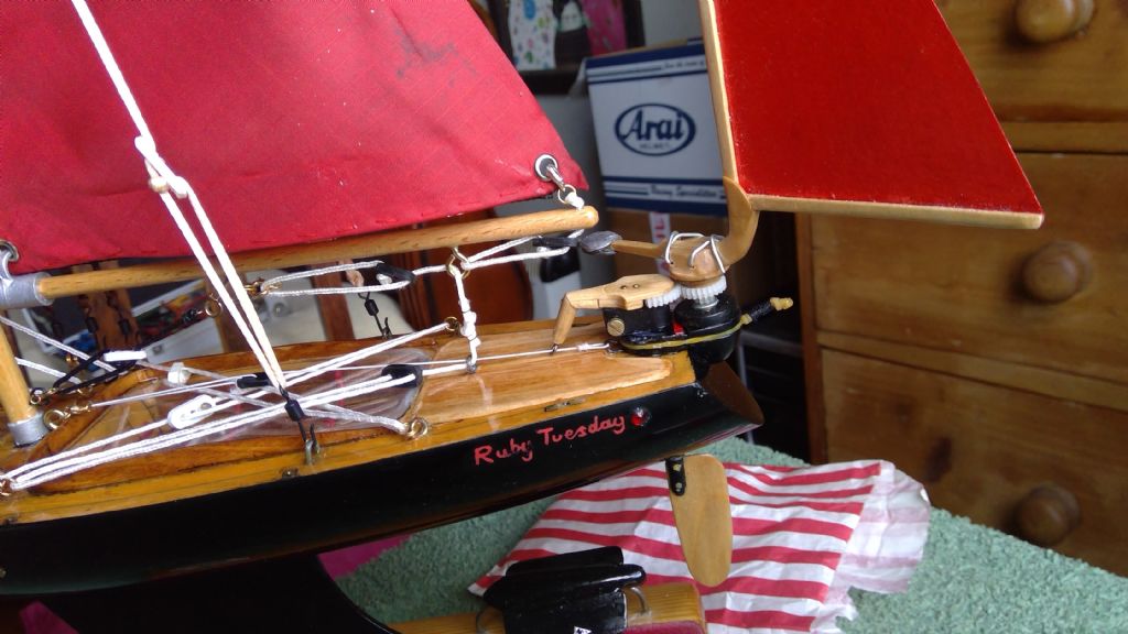

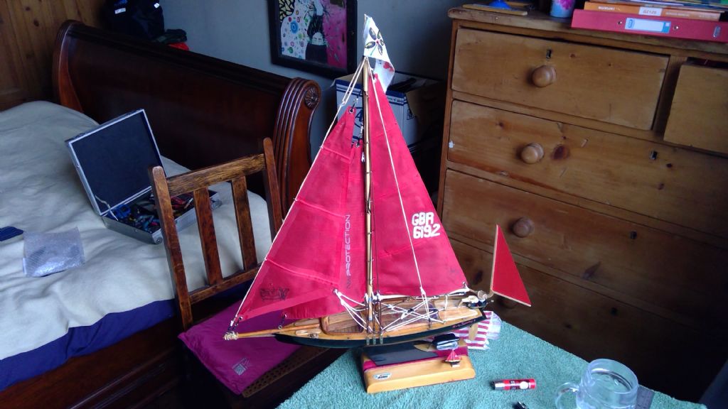

        not yet tested on water

            Perhaps Colin can consolidate them for you then we can follow your work in a single place.
            The steering gear looks to be quite a competent piece of kit, I wouldn't worry about the size of the rudder until you have tried it. Too large a rudder can be as much of a problem as too small a rudder, especially with automated gear. Adjusting the size either way after trials is fairly straightforward.

              Hi I have q 12 inch loa yacht with a vane steering and you may find it more effective to have a smaller gear on the vane.
              My one has a 4: 1 reduction and sails very well. I set the sail plan to slightly fall off the wind and the vane will hold her nicely on course. You only need a very light elastic band to hold the rudder central but can twist it up a bit if the wind is strong.
