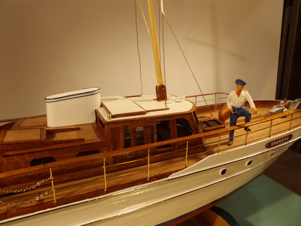

      Very nice Ray. Like the wood handrail capping. Photographs nicely on the wooden dining table!

              Is it the roof hatch being obstructed by the mast stays Ray?
              #104149
                Yes I like plenty of pencils & pens too Neil
                Chris goes to the top of the class with the mast shrouds/stays are in the wrong place !! but I have told the skipper he can only use the roof sliding hatch as a vent or fully when the mast is lowered

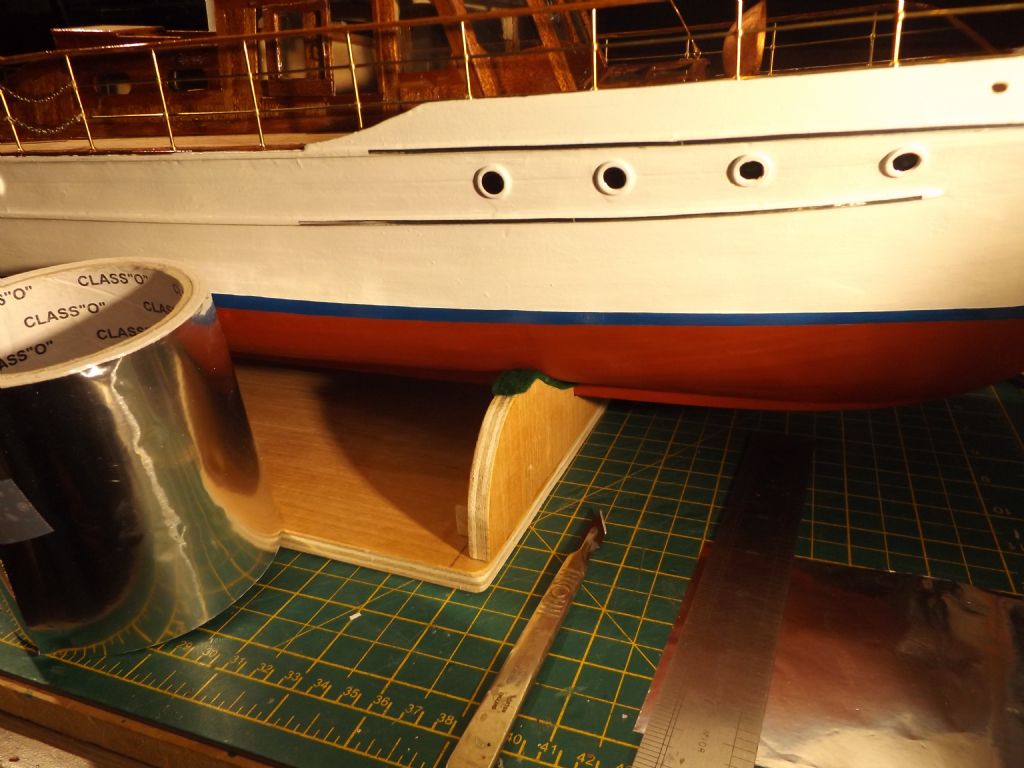

                Another first for me she has nice shiny rubbing strakes, maybe polished stainless or chromed brass ? so I have used a roll of chromed aluminium tape liberated from a site many years ago from the aircon ducting subcontractor, so sliced into 1/16" strips, it's self adhesive and burnishes down nicely

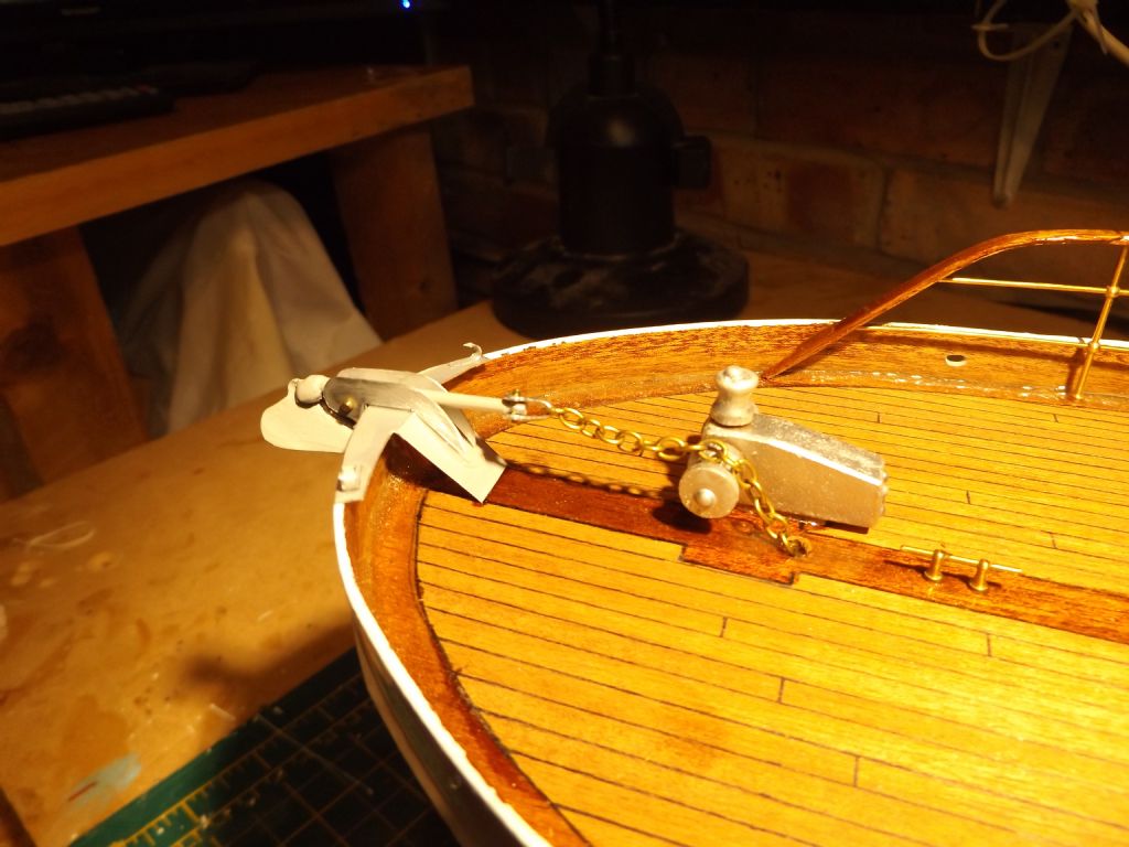

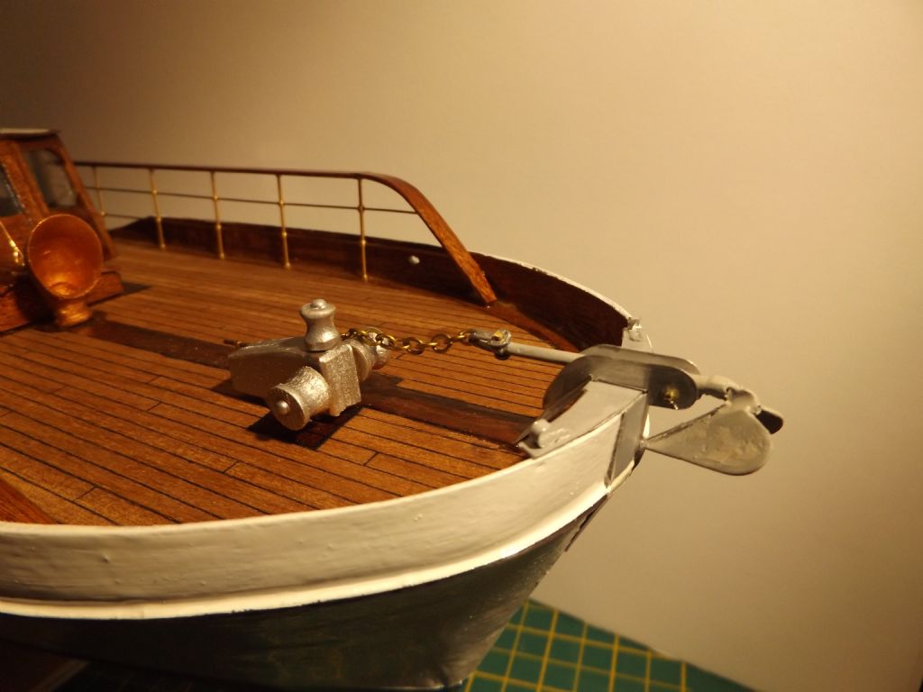

                  shandau51.jpgHi All,
                  This bow mounted anchor has been troubling me, but I think I may have got away with it, nice commercial white metal plough anchor hanging over the bows through litho plate , not a pretty detail in my view but easier for the crew to handle, rather than having a derek on the bow to put the anchor on the deckshandau50.jpg ??
                  #104222
                    Nothing wrong with that, Ray. All sorts of anchor handling styles out there. Ashley

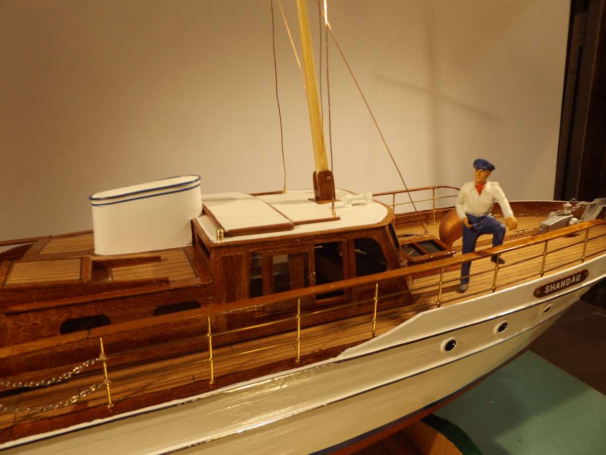

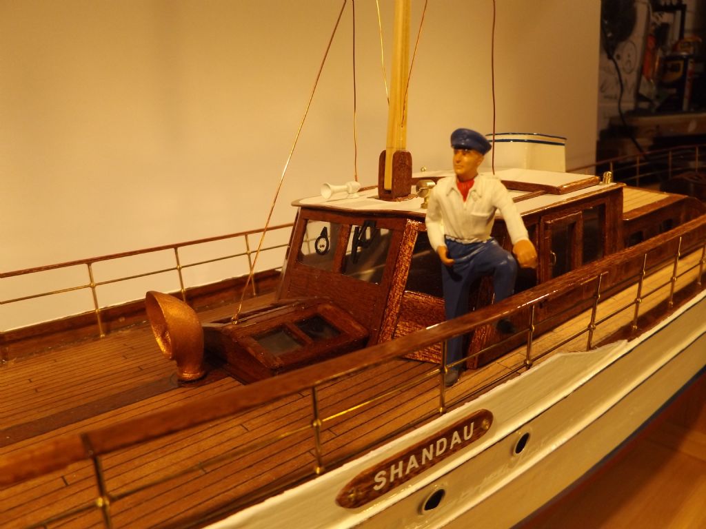

                      shandau54.jpgshandau53.jpgHi All,
                      With exception of a few details like nav lights & flag staff on the stern & painting the copper rigging silver, I'm calling it a day with Shandau, next time you may see her is in the mag as a free plan the skipper looks happy ! On to flying projects now Lockheed U2 on the drawing board glider for the slope when the wind blows and with electric ducted fan for when it doesn't, Duxford tomorrow for photos of the real thing up there

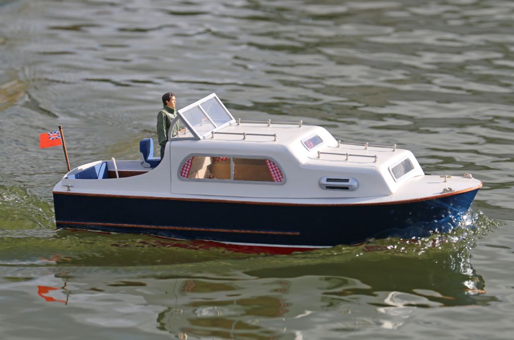

                                      Yes the old Tupperware box but ply & balsa will do the job just like my Freeman 22 which was a GRP boat.
