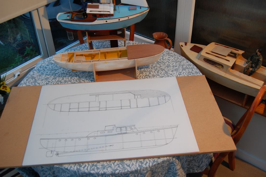

        #103168

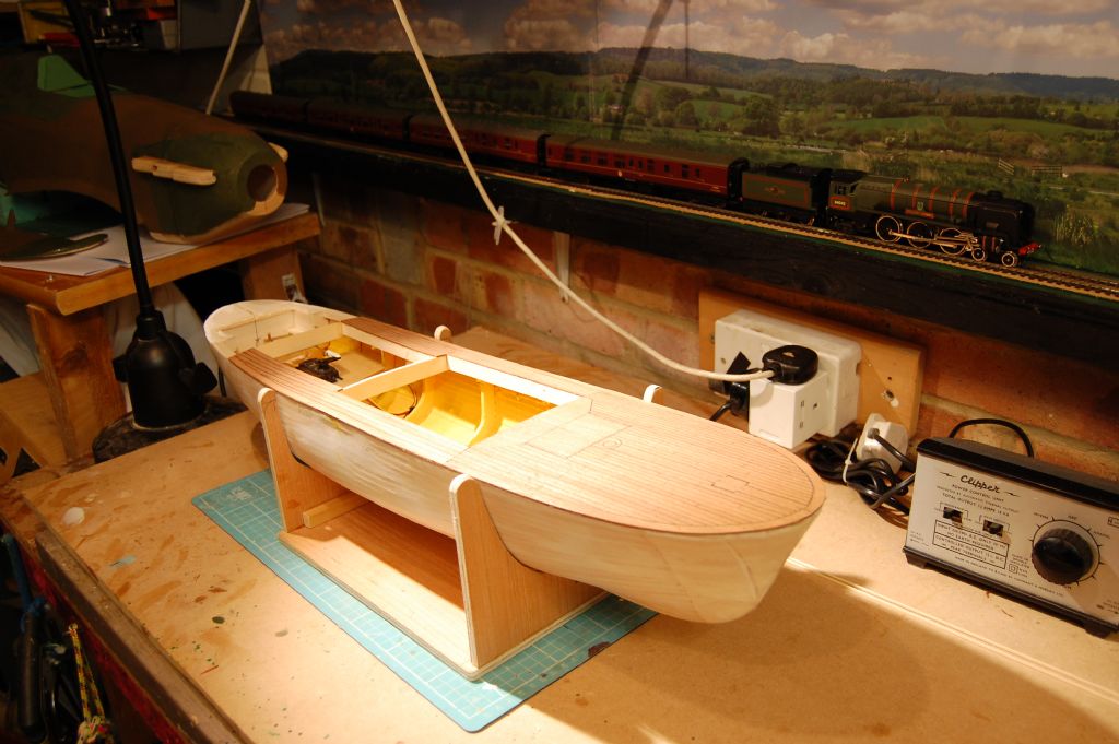

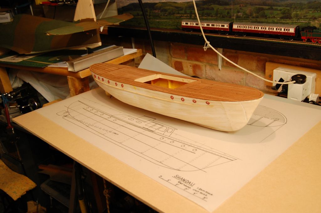

          I sort of hit the wall with this one when the hull was complete, and realised I need to go back to the drawing board and draw the plan view so I could mark the planks on the deck, on the basis that this design/plan maybe inflicted upon the British public at some stage the side view and plan have been drawn properly. The worst part is looming the mahogany upstand coaming on the foredeck to the bows !!
          The conservatory has turned into my drawing office and boat store temporarily

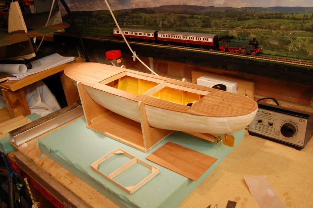

          #103219

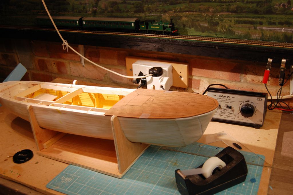

            shandau22.jpgHi All,
            Looks like a workshop day tomorrow, about 5" of snow here now !!
            I'm lucky my garage is in the house so I only need a small fan heater to keep building shandau23.jpg

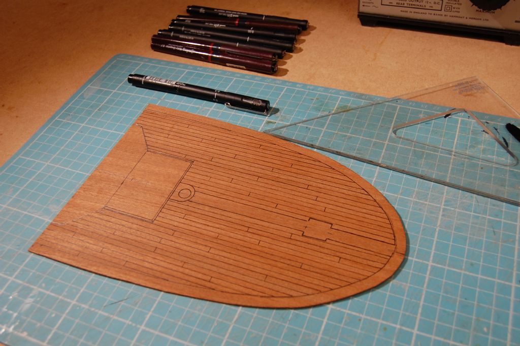

            The foredeck planking is now drawn on the mahogany sheet in black ink, with plenty of joints the planks on the fullsize are only 4" wide
            Still I can crack on with the rest of the deck now, the mahogany foredeck bulwark is going to be laminated round a former, well that's the plan for now.

                Posted by Ray Wood 2 on 11/12/2022 20:33:36:
                what pens did you use to draw the planks Ray, and where did you buy them please. cheers. neil.
                #103252
                  and did you draw on to raw timber or did you seal it first before "planking" it.
                  cheers mate
                  #103254
                    Interesting questions. I have just done exactly the same with a kit I'm putting together and trials on bits of scrap tended to weep slightly when I used either an ink pen or a Pilot roller ball type. In the end I had the best result with a black ball point pen. I only got away with it though because it is a 1/12th scale, anything smaller and the line would have looked too thick.
                    #103255

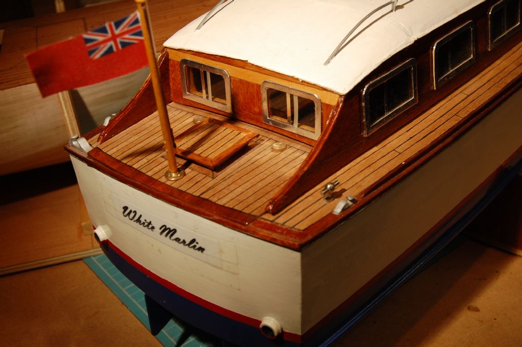

                      whitemarlin foredeck.jpgHi Neil & Richard,
                      Well this maybe one of the only original idea I've had
                      I use some disposable Rotring drawing pens which are 15 years old and still going strong, and I bought a set of uni pin fine line pens maybe 6 different nib sizes, I used a 0.3 for the Shandau.
                      I rub the mahogany down with P180 Hermes SF 168 to lay the grain down, then after some marking out in pencil I make several passes to build up the line thickness this way the ink doesn't bleed.
                      The mahogany edge strips are coated with oil based varnish and brings out a lovely colour and the planking is coated with water based varnish, which I hope looks like oiled teak
                      White Marlin is still a favourite of mine
                      I have joined the local Gym, just off swimming !!

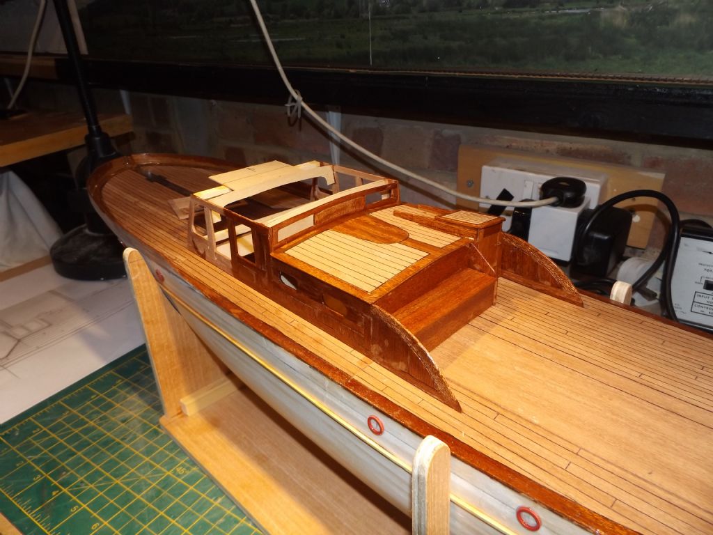

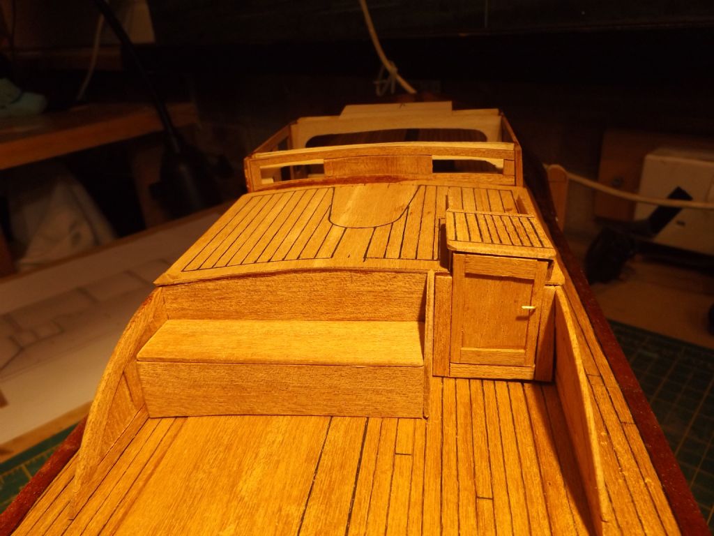

                            shandau25.jpgHi All,
                            There seems to be a pre-christmas rush going on with the Shandau build, the removable rear access hatch is now in place, the portholes from fibre washers and the 1/16" X 1/16" obeche rubbing strip are attached, will have to start thinking about the wheelhouse superstructure soon !!

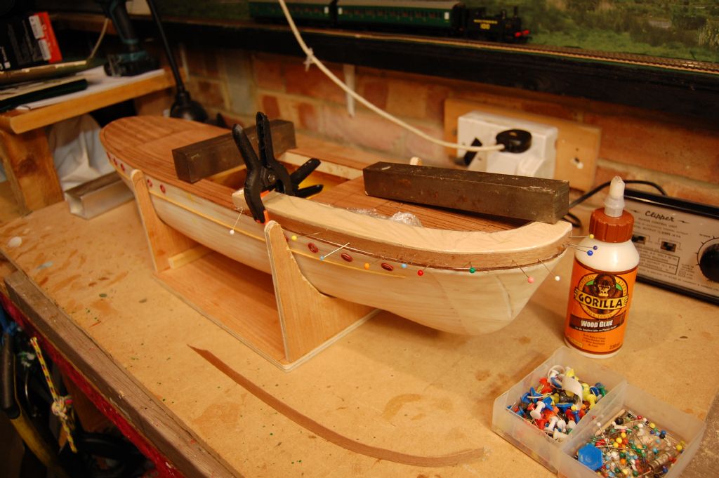

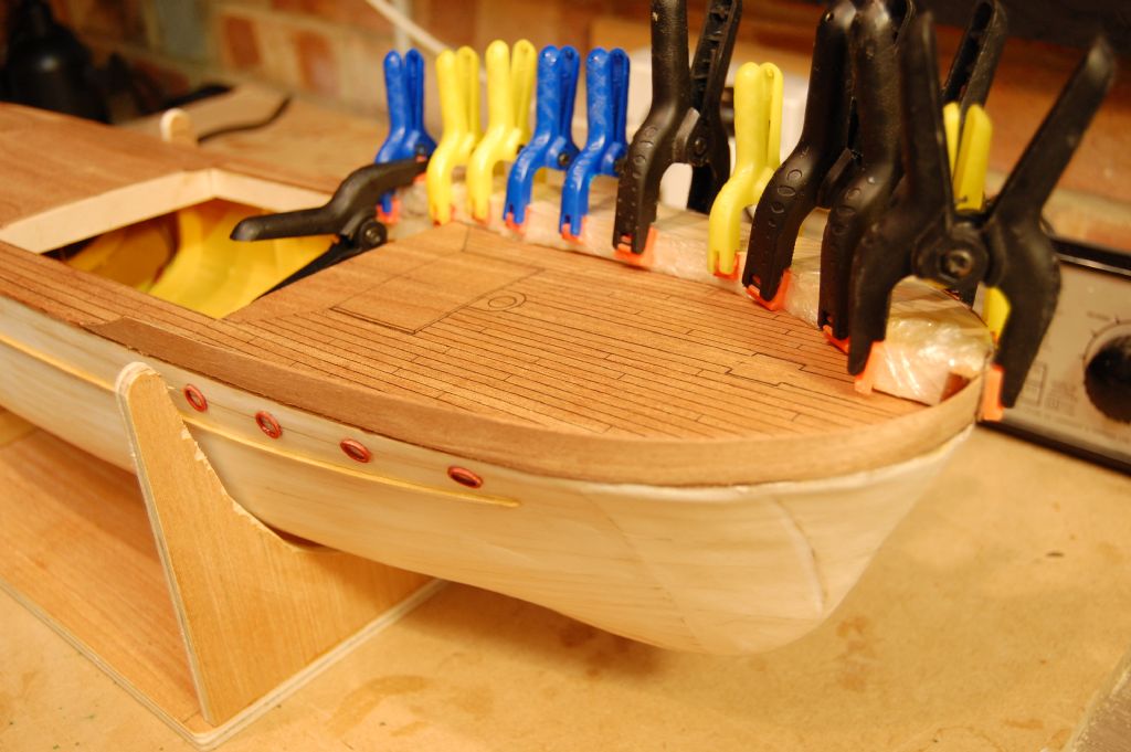

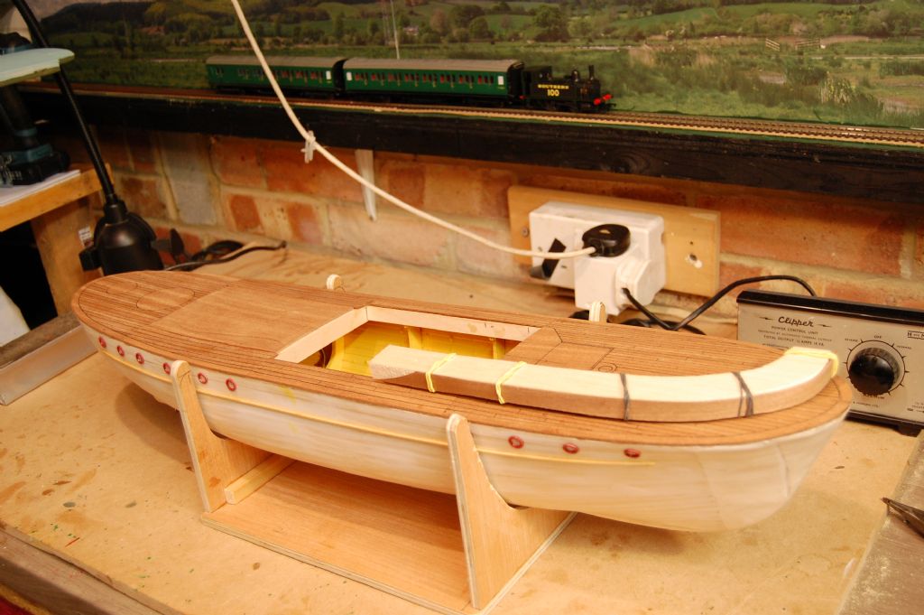

                                        shandau28.jpgHi All,
                                        Well I'm at the stage I was dreading the mahogany bulwarks at the bow !! this is the worst part of the build so far,
                                        If this goes ok I will proceed, If not it's going on the shelf
                                        The 2 laminations of 1/32" mahogany have been soaked in water and left to dry round the balsa former, this is tricky because of the deck camber, but as long as I get the mahogany colour inside the bulwark I will be happy filler on the outside may save the day

                                            Well the starb'd side turned out ok, some trimming & filling lets hope once the port side is dry I can get on with the wheelhouse

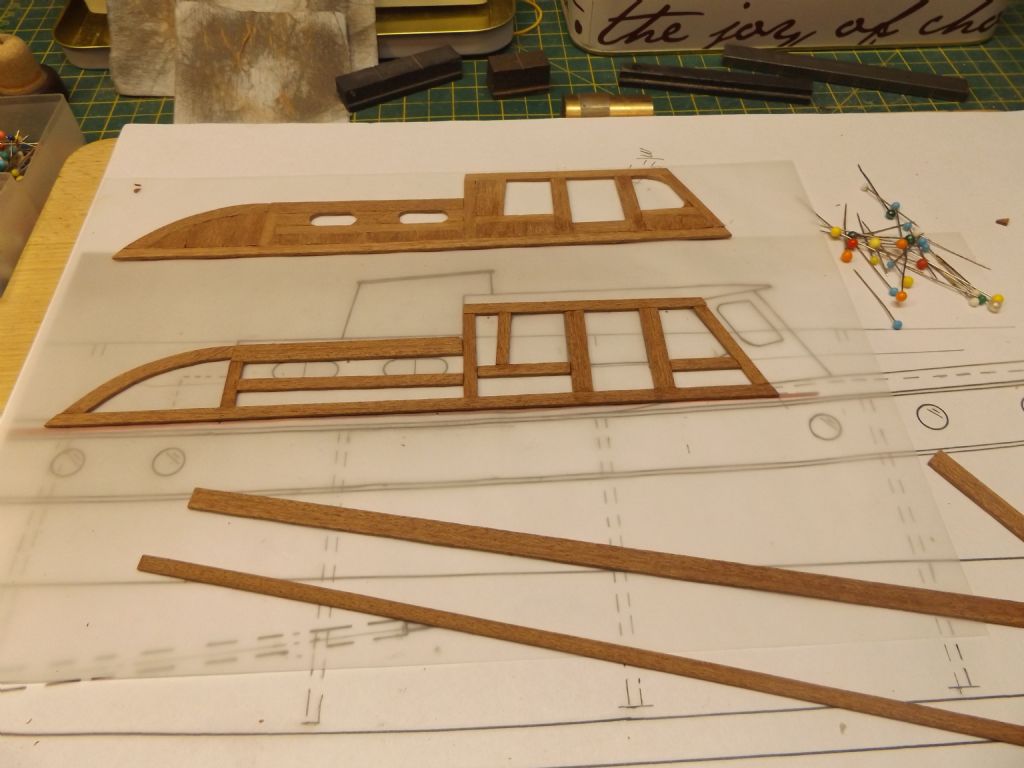

                                                The wheelhouse is rather like a marquetry iigsaw puzzle, which is really an easier way of construction with all the windows and openings, I can't wait to varnish it to see the grain of all the panels as the fullsize
                                                All the 1.5mm mahogany planks cut on the bandsaw using the fence, must be the best thing I ever bought !!

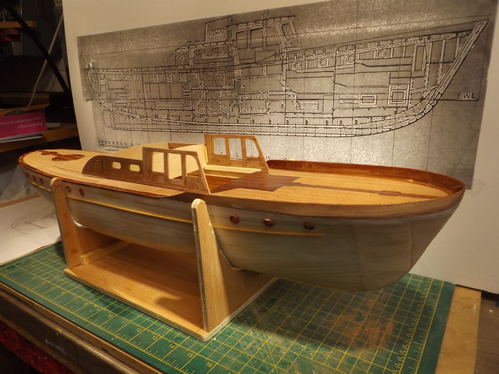

                                                    #103566

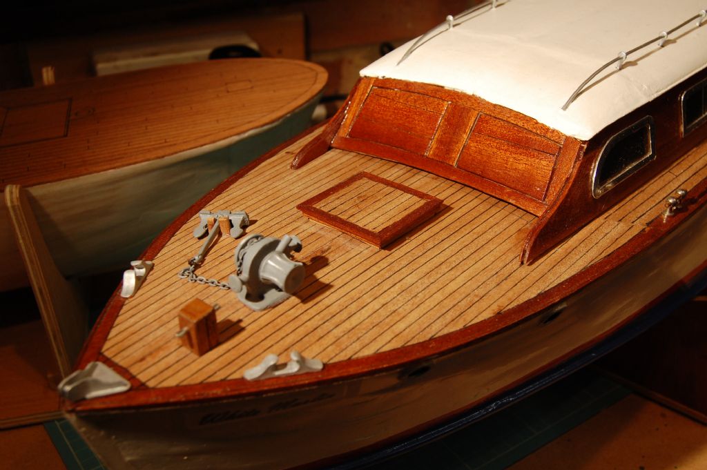

                                                      shandau32.jpgHi All,
                                                      Well at least the owners have a seat to sip their Cocktails on now in the Med !!
                                                      What a difference a drop of varnish can make I'm enjoying this part .
