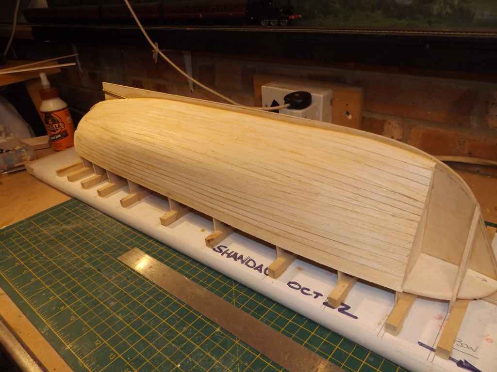

          Planking nearly complete, at some stage it's best to let the planks lay straight without too much twisting , just the tricky tapered steelers to complete

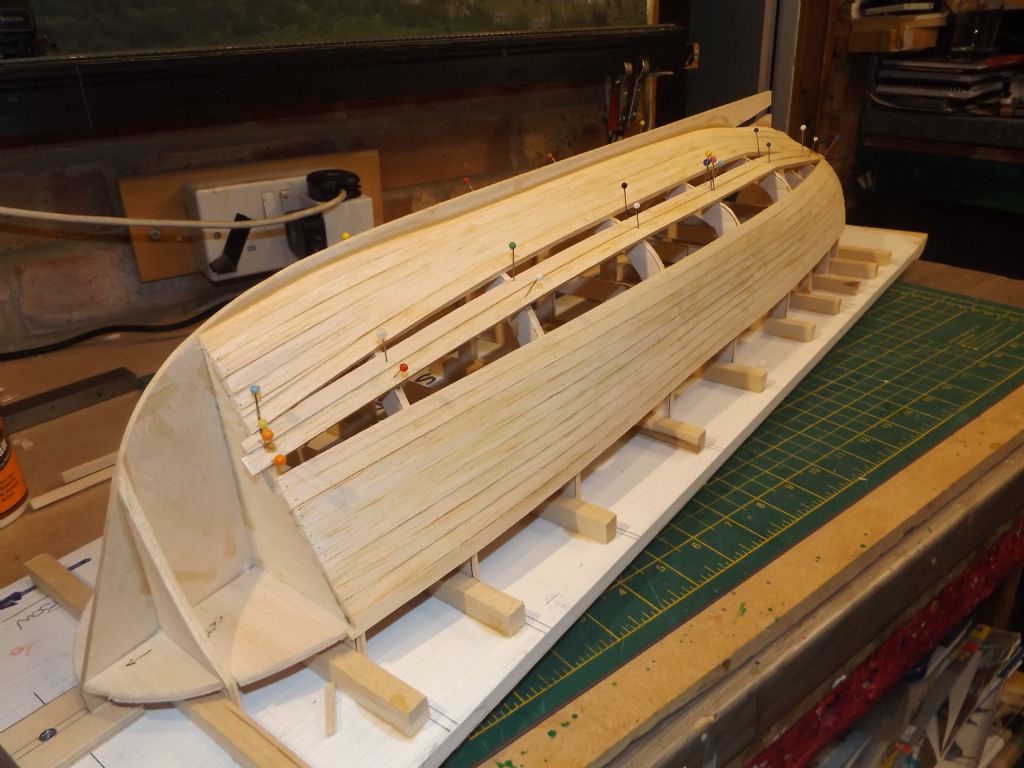

                shandau planks 10.jpgHi All,
                Strange how people enjoy the process of model building, I enjoy creating the hull shape as Neil says Billings kits must have put more folk off boat building over the years with the strip wood they provide for planks !!

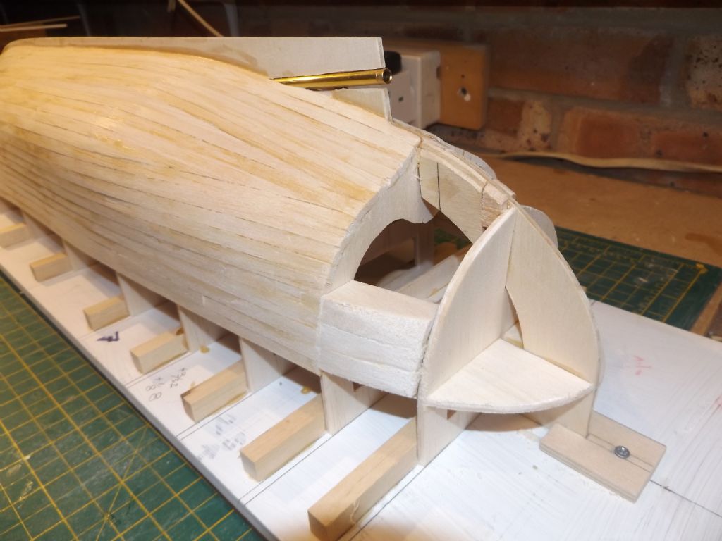

                Well the planking is complete to the centre section, but will need plenty of lightweight filler and sanding before glass clothing with water based resin, now just started to balsa block the stern, decided on sticking with balsa sheet cut to infill and carve to shape on this one.

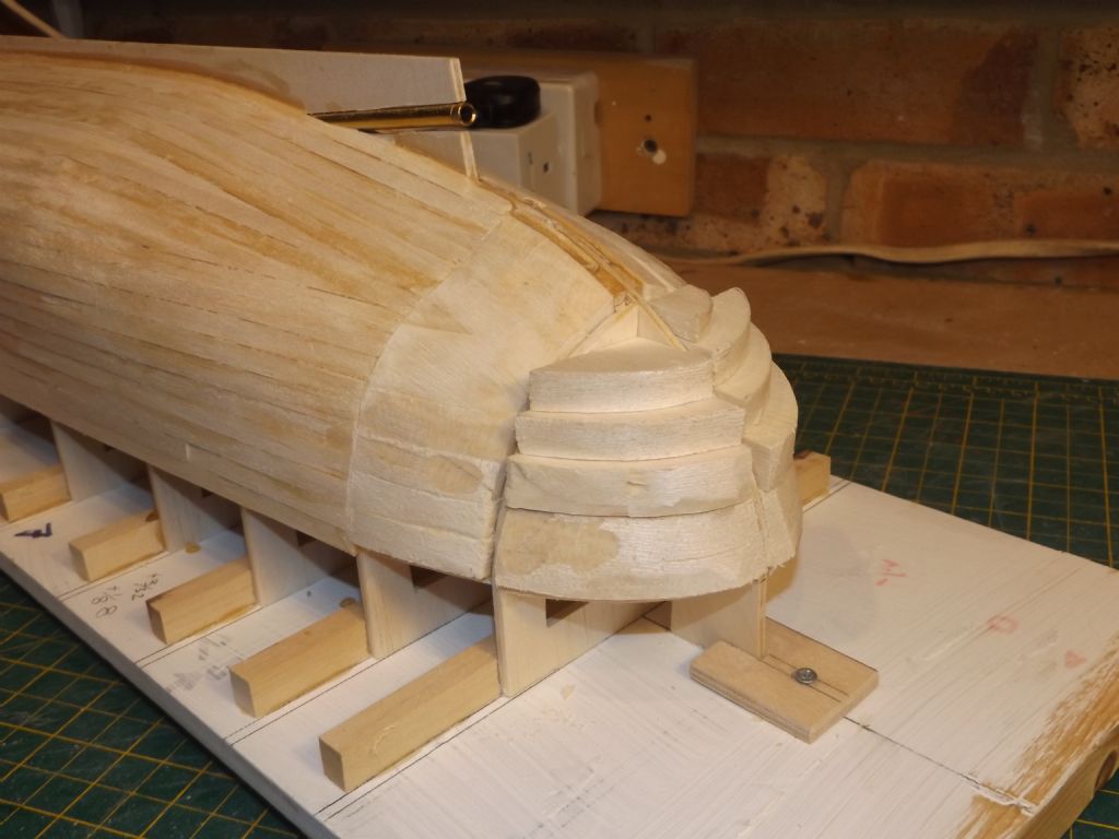

                      Hi Jim,
                      I use the deck radius as a template and make sure there is a good overlap for carving, another photo today the stern is complete and filled, and the bow is making progress, I must order some mahogany sheet for the deck ! already thinking about the next build a tug most likely

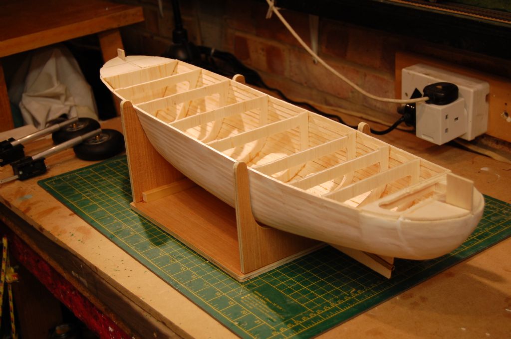

                            Well, the stern is complete now with some help from this lightweight filler from Amazon

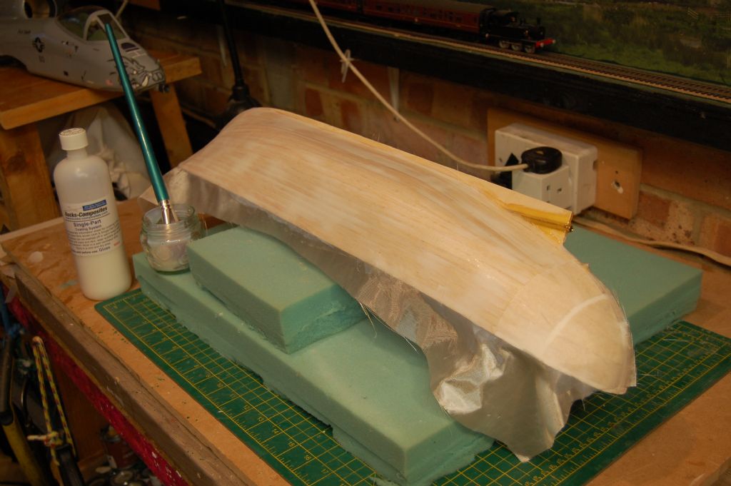

                                        We are at the lightweight glass cloth stage It's great stuff as the weave allows it to follow the shape and be brushed through with the water based resin over the compound curves , about 5 coats will be required to build a good surface for primer.

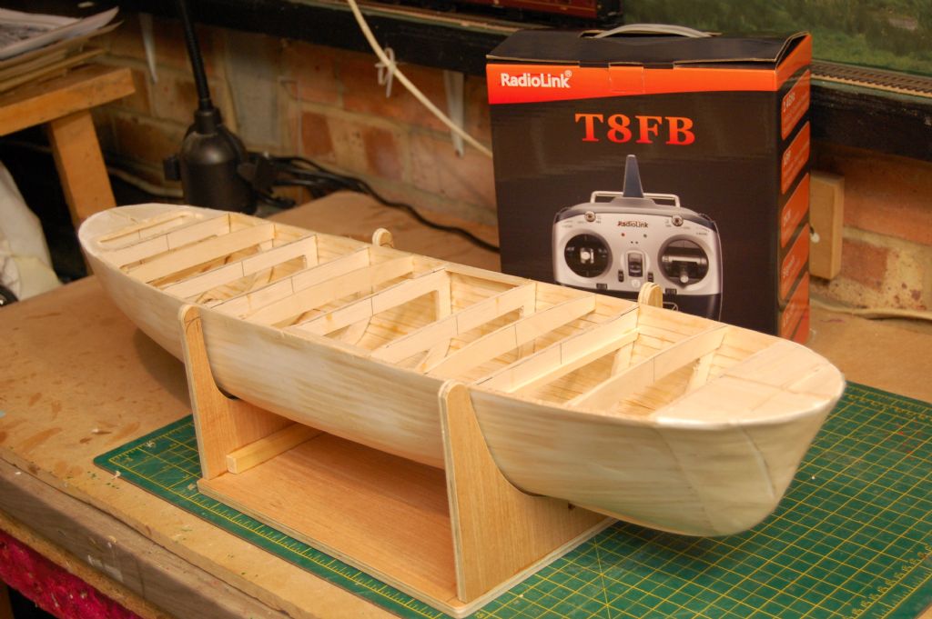

                                            I think the choice of balsa grade is the key, Hard,Medium & Soft is normally available from SLEC. try and get medium for planking if you can ? Soft bends well but will suddenly break, try and keep you planks laying straight, I didn't have to damp the outside of any of the planks on this one, It's more a case of twisting them as you get near the stem and loads of pins & gorilla wood glue
                                            Just started installing the cambered deck beams from 1/8th ply.
                                            My new wireless set in the background standard set 8 channels dry cell no frills just servo reversing, comes with 2 receivers about £65.00 well happy with that for the A10 Tankbuster.

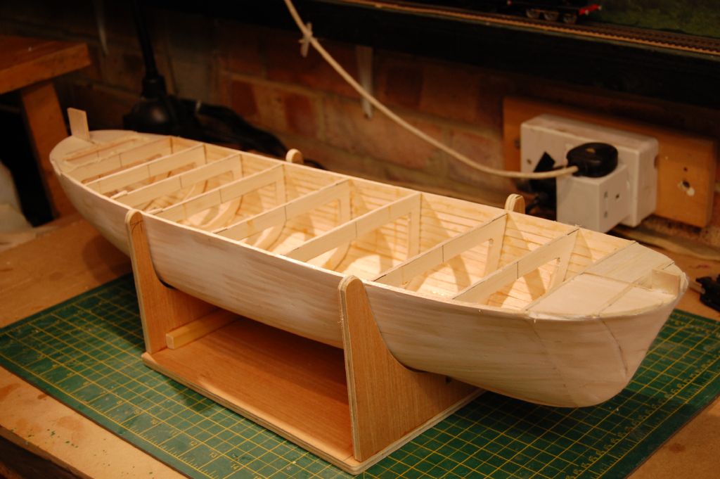

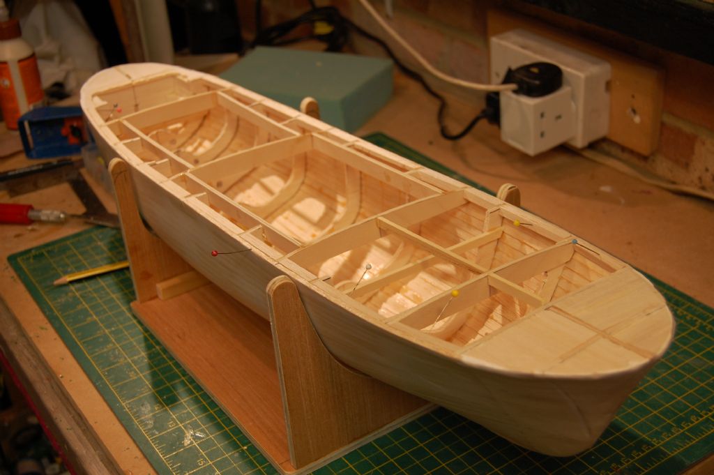

                                                  Thought I'd better get on with the working parts motor and rudder/servo etc, but here we have the deck beams in place with 2 large openings for internal access, mahogany has arrived from Mantua Models for the deck so the tricky part is approaching the planks are only 5/32" wide at 1/24th scale so will do a trial piece with the black pen to see how they look.

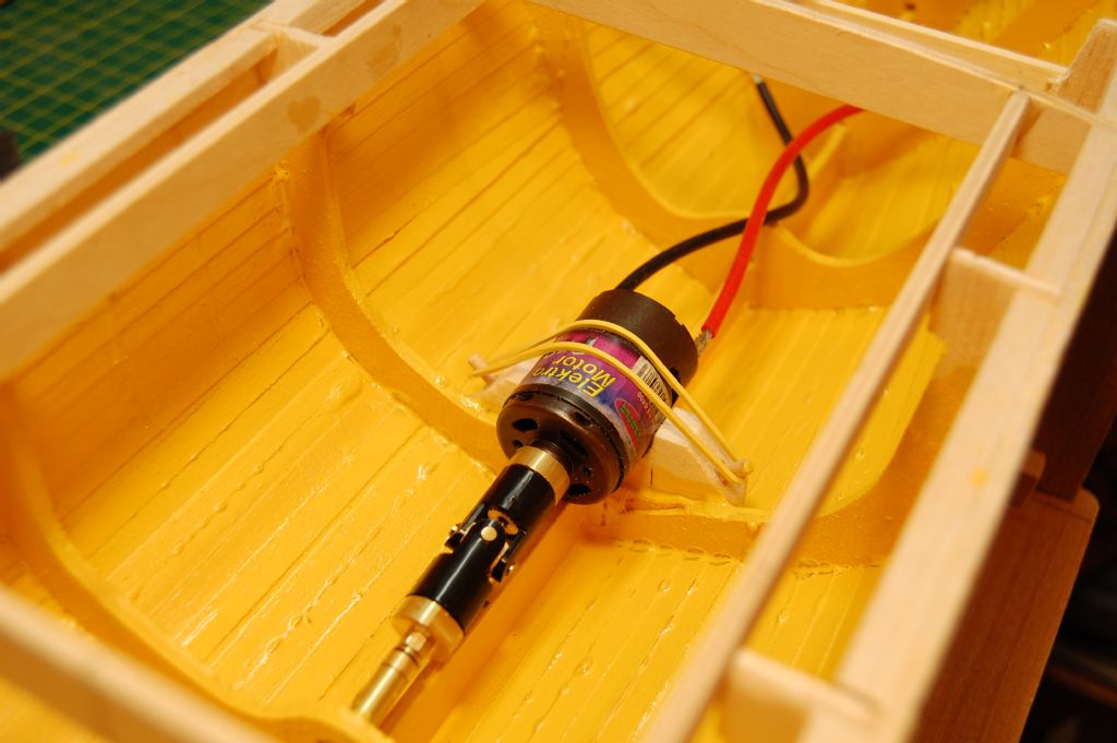

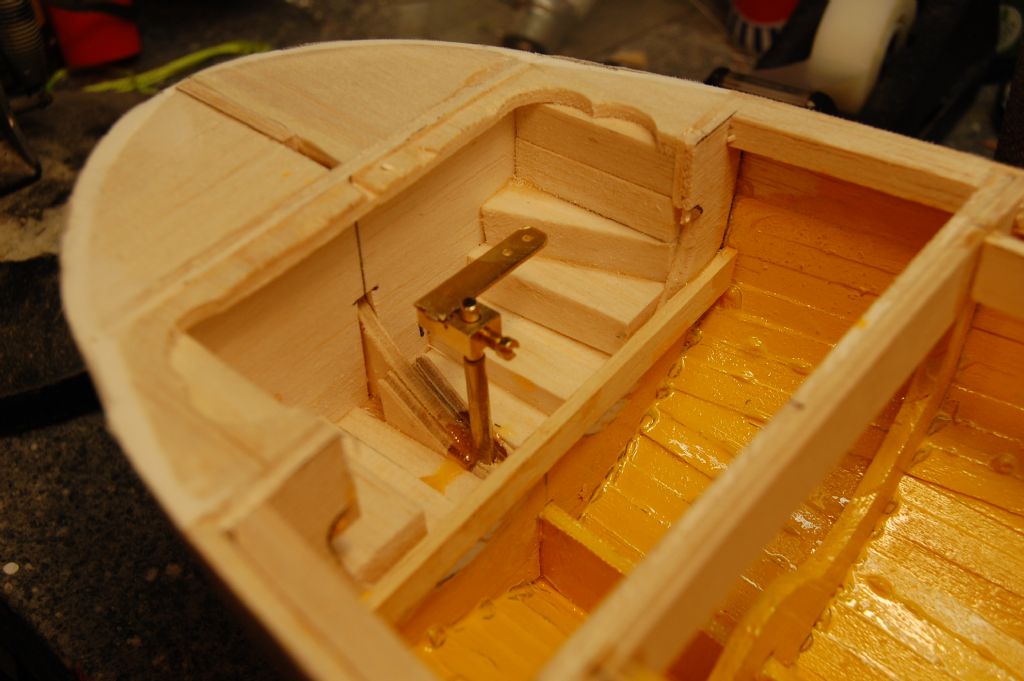

                                                      shandau19.jpgHi All,
                                                      I thought I'd install the 400 brushed motor and tiller arm after a couple of coats of yellow Humbrol enamel, It certainly makes it easier to see what's going on inside before I start the deking. The faithful 13amp pin cut andshandau20.jpg with a brass arm soft soldered on does the job
