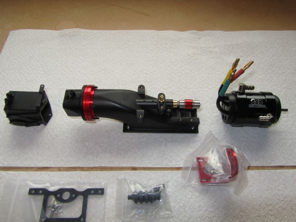

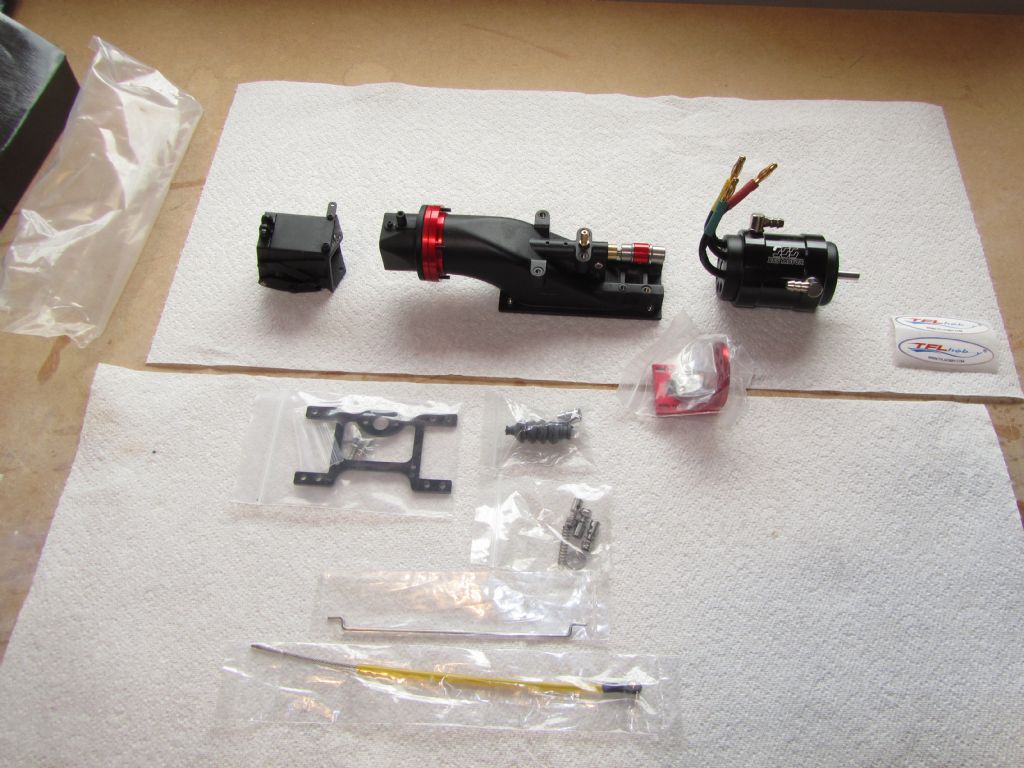

After the stern-drive I fancied building something with a water-jet and had been thinking about it on and off for a while, though mindful that I still have my Faireys to finish!

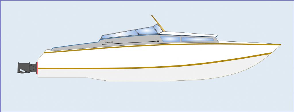

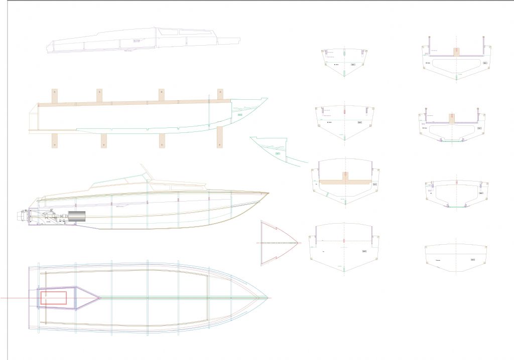

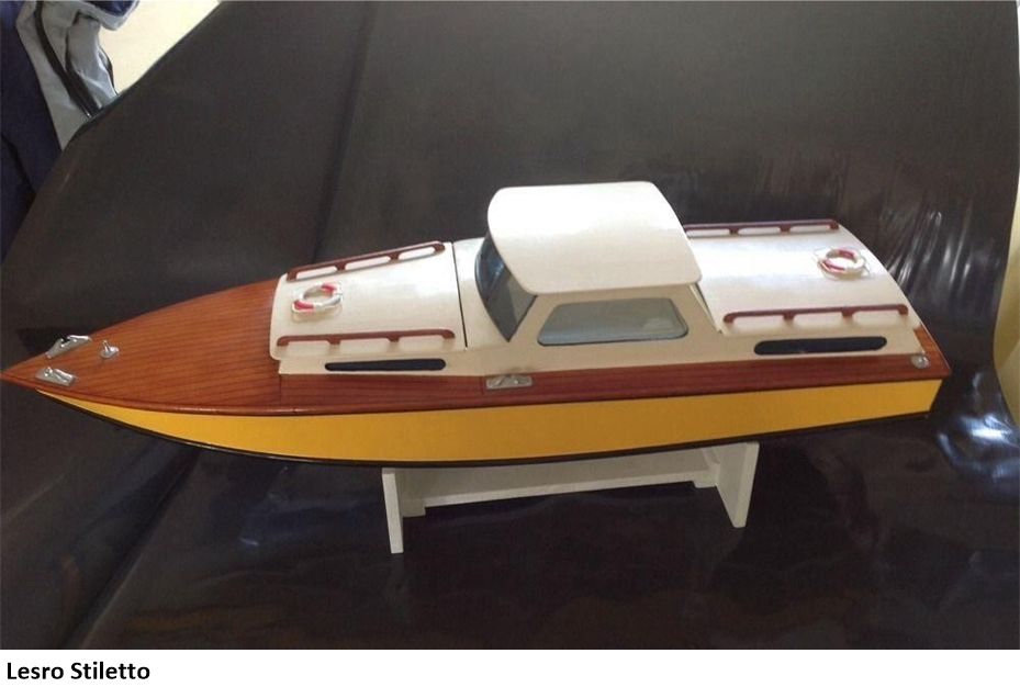

I’d had thoughts about designing my own boat but having produced drawings for the Lesro Stiletto/Rapier at a size midway between the two and liking the hull but thinking the superstructure was dated I decided to use that as the basis for some more modern versions. One of these was an open Sport which would fit the bill. I was going to use my usual lift-off superstructure but with no components in the cabin area this wasn’t necessary which would make things simpler and I could follow the Lesro build method to some extent.
I curved the cabin sides and introduced some curve in the hull sides as they approach the stern and of course had to modify the vee hull to accommodate the water-jet.

Drawings are a stage where I can start cutting some ply.
