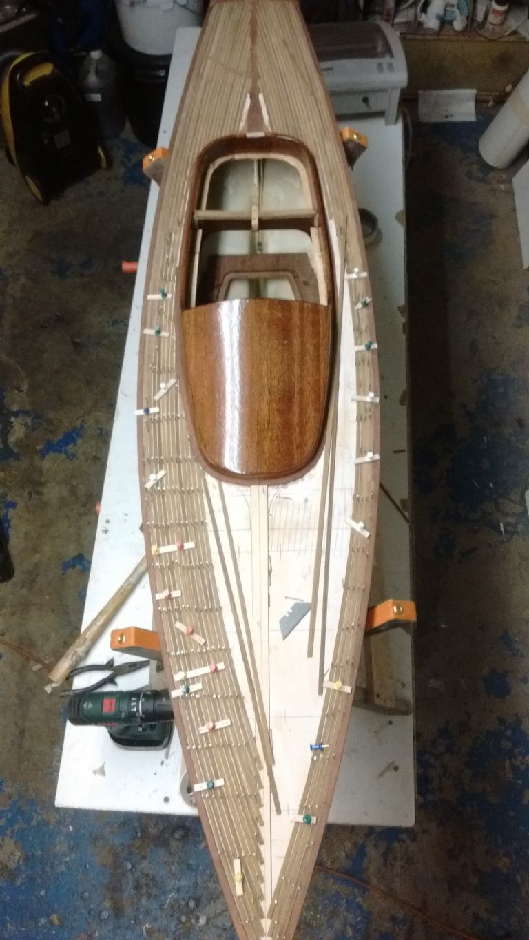

                            img_20160401_212349607-480x853.jpgHi I've been a bit busy at work so I've not been able to update my build but ,here's some more pics the aft deck is now planked now I'm onto the front ……mark img_20160401_212559485.jpg
                            #64789
                            Martin Field 1
                              @martinfield1
                              Mark, I somehow missed that post. Very nice planking my friend, as befits such a lovely model.

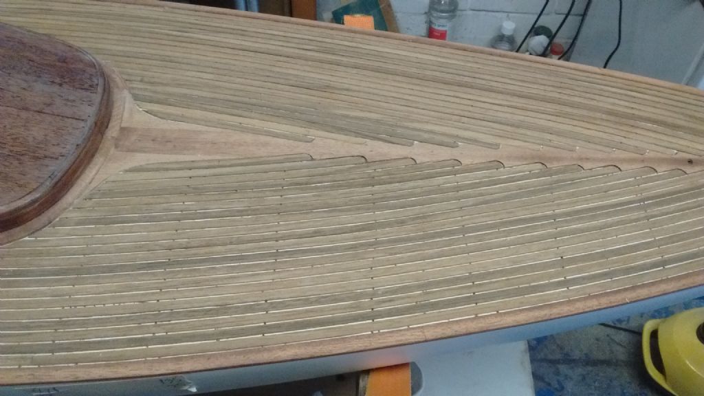

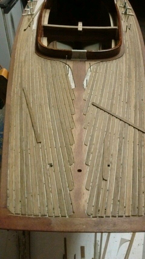

                                          #64887
                                          mark69
                                            @mark69
                                            Hi all I have now finished the planking its been a long process bit testing sometimes I must admit !glad I've done it though (I blame Martin ) I was just going to cheat ,anyway now i I have to stain the mahogany again and start to varnish ,…..markimg_20160424_192358578.jpg
                                            #64888
                                            Martin Field 1
                                              @martinfield1
                                              That's right, blame me! You'll have to be careful staining just the mahogany, if that means doing the covering board and king plank.
                                              But that is such a lovely job. Well done, Mark. I like the radiused ends of the planks where they joggle into the king plank, too. Never seen that before.
                                              Martin
