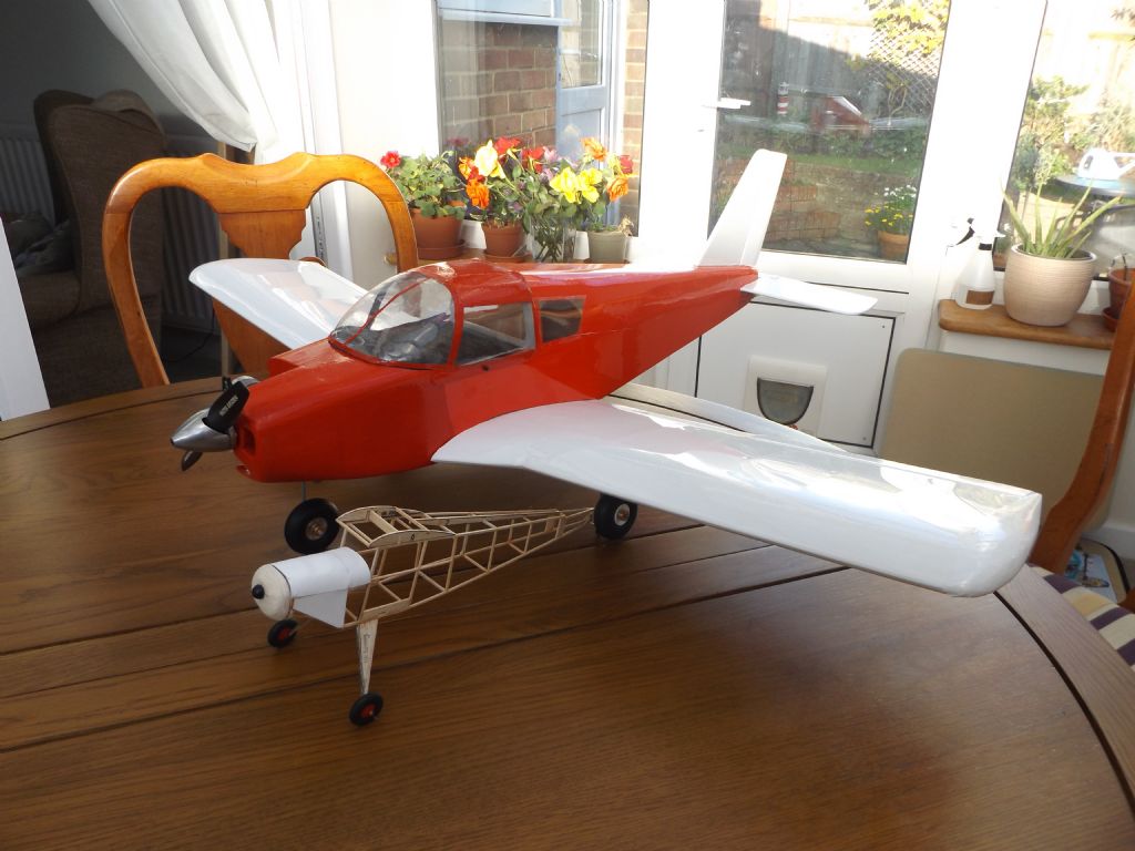

                                              Which aircraft are you building Ray? It`s good to have a change now and again.
                                              Regards,
                                              Jim.
                                              #98398
                                                Hello Jim,
                                                Currently building a Piper Cherokee 39" span from a free David Boddington plan in a recent magazine which seems to be re-issuing a lot of his old designs, I'm enjoying the build very much
                                                The baby is an Auster Arrow from the KeilKraft Flying Scale series and takes me back to being 10 years old again, loving the tissue covering, I have to do the doping in the shed, the management doesn't approve of the aroma, always reminded me of pear drops
                                                #98399
                                                James Hill 5
                                                  @jameshill5
                                                  Hi Ray,
                                                  Nice looking models. Will they be electric power? It`s a long time since I built a flying model. My first attempt was a Hawker Hunter made from 1/8th and 1/16th balsa sheet, silhouette body and drawing pins for balance weights at the nose!! It flew very well and I had a lot of fun with it.
                                                  Regards ,
                                                  Jim.
                                                  #98403
                                                    Hello Jim,
                                                    Although I have been flying electric for the last 10 years at my local football field with the same foam Acrowot by Chris Foss maybe 150 flights to keep my hand in for flying, the Cherokee has a 2.5cc 2 stroke glow motor which would struggle to take off from grass, my grandchildren live near a lovely flat beach, great when the tides right out
                                                    The little Auster is just rubber powered like in the good old days.
                                                    #98405
