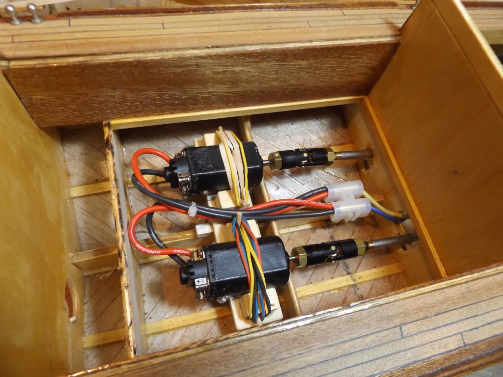

        Here are White Marlins twin brushed 480's during winter maintenance.

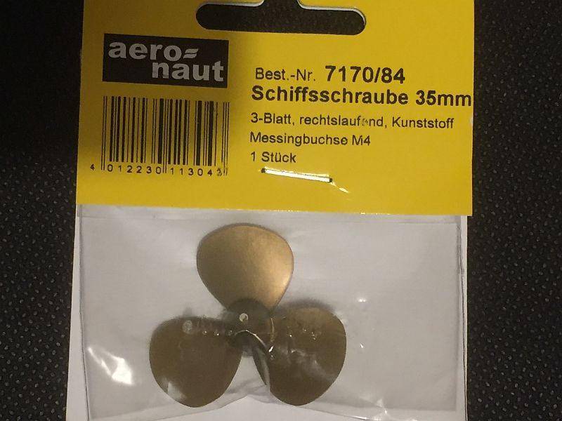

              I bought a pair of these props for the boat ( RH and LH ) and wondered if anyone has used this make before?
              They are 35mm diameter, but I don`t know the pitch. It looks quite fine to me and I`m wondering how much thrust they would produce. They`re nicely made in brass coloured nylon.
              Regards,

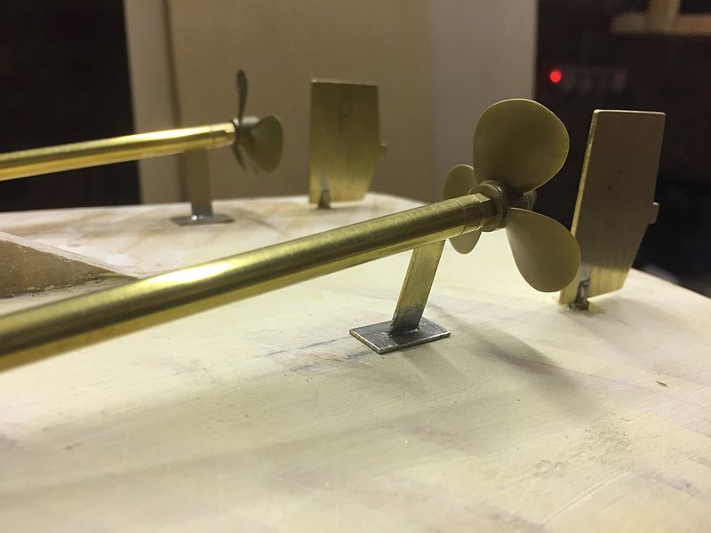

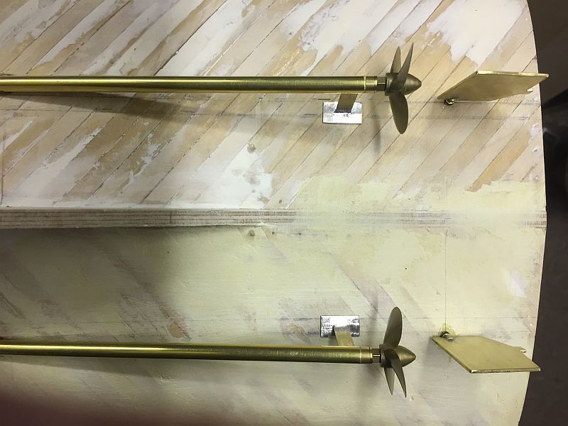

              #94457
              James Hill 5
                @jameshill5
                #94458
                James Hill 5
                  @jameshill5
                  Things have been a bit slow over the last month as,since last posting, I`ve been in hospital after having a heart attack.
                  At the moment I`m limited to nothing too strenuous so hopefully the modelling won`t be affected too much but I`m surprised at how much stamina is missing just now.
                  Anyway, trying to start catching up, I`ve made a couple of support posts for the end of the prop shafts. The base will be stuck to the hull with araldite and the uprights soldered to the prop shaft. On the actual boat the shafts were exposed and the uprights held the end bearing.
                  Hopefully when the weather warms up, I can get outside and carry on filling and sanding the hull.
                  Jim.
                  #94459
                    Hello Jim,
                    Yes I thought you had gone AWOL ! sorry to hear your news, but very glad you have come through it
                    Your running gear is looking good, I never fancied having exposed shafts on a model as there is a fair chance they could pick up weeds or an old piece of string !!
                    Still glad to see your going to have some relaxing modelling time ahead to aid your recovery
                    I find plastic kits a great diversion, Building a Short Stirling bomber at the moment, and 5 other projects !
                    Best Regards Ray
                    #94460
                    James Hill 5
                      @jameshill5
                      Hi Ray, nice to hear from you to.
                      The good thing about this hobby is most of it isn`t too heavy to manage although I wish I`d done some shifting of stuff in the garage before now, but there we go, It`ll get done in time.
                      I haven`t built a plastic kit for a long time, having spent years building ( or attempting to build ) the railway in the garage. Like most people, I`ve got kits still to build including an O gauge Black 5, so apart from the boat, there`s lots to do. But for now, the boat takes priority.
                      Best wishes , Jim.

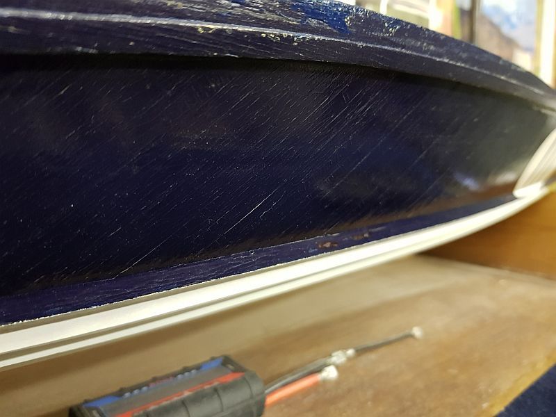

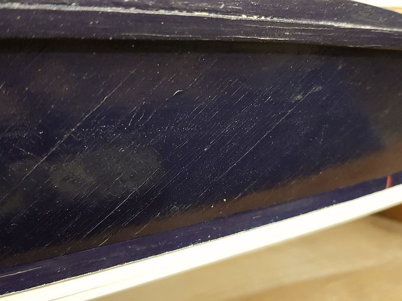

                                      James Hill 5
                                        @jameshill5
                                        20210503_160441s.jpgA couple of pictures of the arising problem,20210503_160338s.jpg
                                        #95268
                                          @timrowe83142
                                          Hello James
                                          Is the paint raised in the "cracks" or are they definitely cracks. If you can tell me I may have some ideas.
                                          I like Ray's Cigarette so much I am building two. Boys games for my grown up son and me.
                                          Frames and keel cut out, brushless, esc and servos sorted out and waiting no to go to the model shop to buy shaft, prop and coupling.
                                          Tim R
                                          #95272
                                          James Hill 5
                                            @jameshill5
                                            Hi Tim,
                                            Looking at the hull through a magnifying glass and a light,some of the paint is showing signs of slight crazing and the diagonal lines are where the plank edges are.
                                            It could be that the paint across the plank joints has just separated and the joints are still ok. The boat was built in the 90`s so I don`t expect it to be perfect after all this time. I was just hoping to slow down any more movement before I manage to see how it runs.
                                            I suppose I could re-paint over the Blue. I`d have to colour match it as the paint on there came from Woolworths household range! Midnight Blue I think.
                                            I`ve taken some pictures of what I think are Cigarette boats from a 1990 Offshore Boat calender by Beken of Cowes and I`ll try and post them. I wish I`d kept the Daily Express newspapers of the time of the Cowes -Torquay races. Double center page spread with all the boat details. A big event at August bank holiday weekend.
                                            Many thanks for your reply
                                            Regards,
                                            Jim.

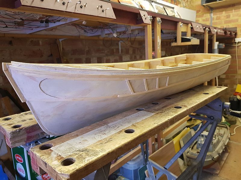

                                              #96036
                                              James Hill 5
                                                @jameshill5

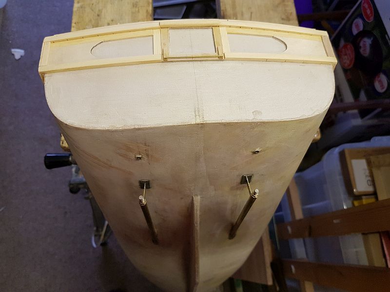

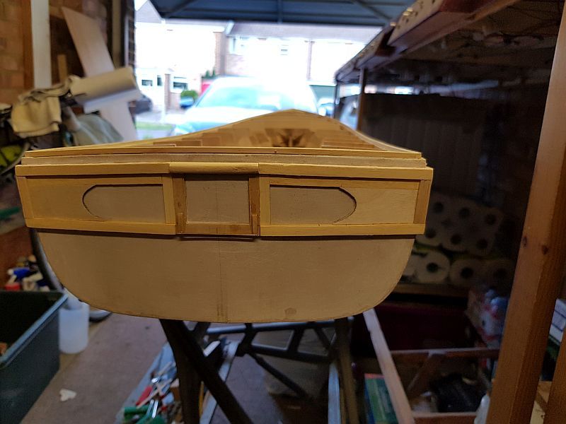

                                                20210609_205211s.jpg20210609_201520s.jpg20210609_201453s.jpgFinally managed to glass cloth the hull which ended up better than I thought it would considering I`d not tried that before.
                                                Since then I`ve been making and fitting the various wooden shapes that were attached to the hull. I`ve had to use modellers license once or twice to get round things but It`s a reasonable representation which is mainly what I hope to achieve.

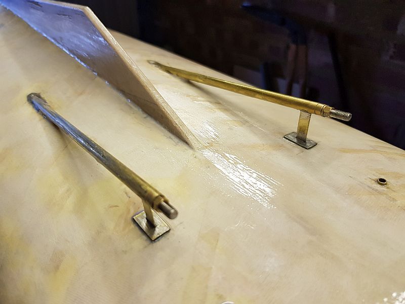

                                                The prop shaft supports are now glued and soldered in place so I can now give the hull some extra coats of epoxy.
                                                Next job now is to fit the deck and work out where openings need to be cut. The deck will probably be glued down with araldite eventually, unless there is a better way. After that, decide on batteries and speed controllers, especially as there are two motors to control, so, some reading to do for information.
                                                Beyond that, build the cabins etc . Looking forward to that.
