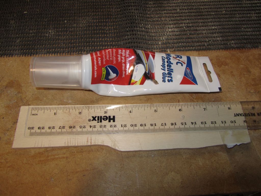

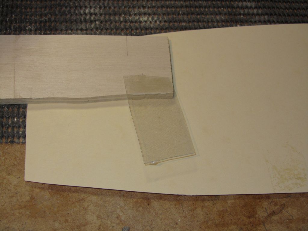

      Hi Jim
      Certainly the Deluxe Materials one does, much better than superglue in that respect. I've just tried gluing a piece of clear plastic from a food carton and deliberately got some glue on the "window" to see how it dries. Supposed to dry clear in 30 – 60 minutes and I think I read somewhere that you can peel it off from where you don't want it? Strength grows with time.
      I'll see how it's performed in a bit.
      Deluxe Materials tube is 6" long containing the glue which is 80ml. If you only want a bit and a finer tube might be better to go with Ray's version, though as I said it's good for other things.
      Edited By Chris Fellows on 11/02/2022 16:59:21
      #99476
        Test piece was stuck fast and where I'd got glue on the "window" I pushed it back with my fingernail. Smears elsewhere I removed with some spit and a finger. Obviously best that you don't get it where you don't want it. Gets my vote.

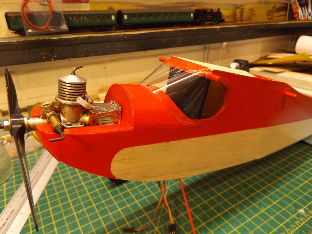

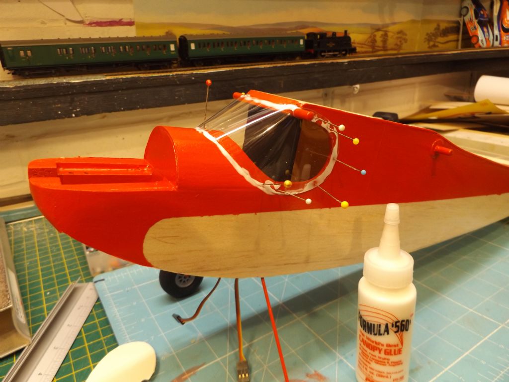

                poppet glaze 1.jpgHi Jim,
                Just to show how well the canopy glue works here is a before and after it sets shots of the cabin glazing on a little Vic Smeed's Poppet, which is nearly ready to take to the sky's in the spring.

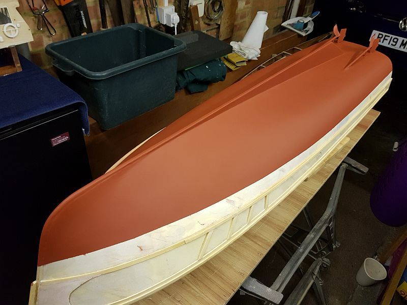

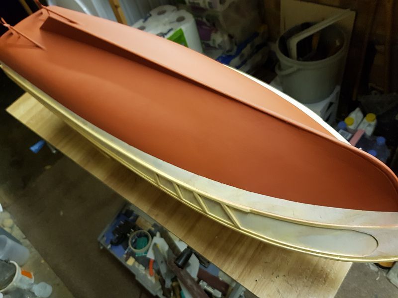

                  20220213_205924s.jpgHi Chris,
                  That Poppet is coming along nicely.and the pictures of the canopy glue shows how well it works. Seeing the engine reminds me of one I bought back in the sixties which I think was a Mills 75, though I may well have got the name wrong.
                  Sprayed the hull at the weekend. Came out better than I thought it would. One or two blemishes but I`ll leave them as it would only cause more problems. The water line is estimated from photo`s so it will be interesting to see where it sits in the water with everything on board. I shall paint the black on the hull and then varnish both colours to seal them.

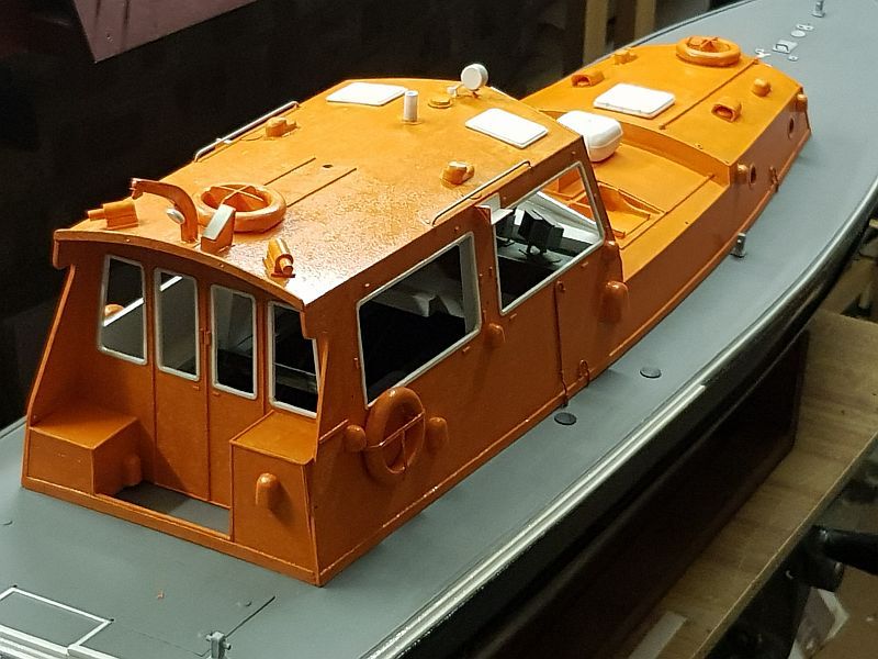

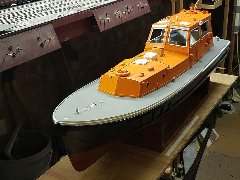

                    20220305_122225s.jpgManaged to put some colour on at last.
                    The hull has been sprayed the usual red oxide rattle can for below the water line and the black section is Humbrol enamel. At the moment both have had one coat of satin varnish applied and will have at least one more.
                    The deck is also enamel with two coats of matt varnish,
                    The orange topside has one coat of paint so far and I reckon will need at least two more. I was surprised how much of the grain of the wood showed through, even though it had all been rubbed down and sealed with sand and seal. On the hull that`s not so bad,as most working boats had an air of use about them so I don`t mind that but I`d like to improve the cabin area so I`ll rub it down with 600 and 2000 wet and dry paper in between coats and see what it`s like.

                      Looking very nice Jim.
                      I think a bit of wear, here and there, on the cabin adds realism too – door /hatch handles etc,
                      Just admiring your railway switch panels too – very professional !

                        Hi Dave,
                        Thankyou for the comment. I `m sorry to say this but my switch panels are about as un professional as you could getsmiley
                        The swiches change polarity on the points. The L E D`S indicate turnout ( red ), straight through ( green )
                        The white bits are plastic rod drilled to take brass rod running inside brass tube, in a straight line,to change the points. As the points are changed, a micro switch changes the led`s red to green , depending where you`re going.
                        If I can, I like to keep things as simple as possible.

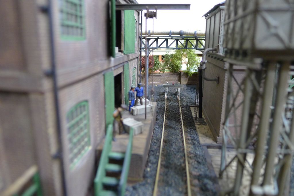

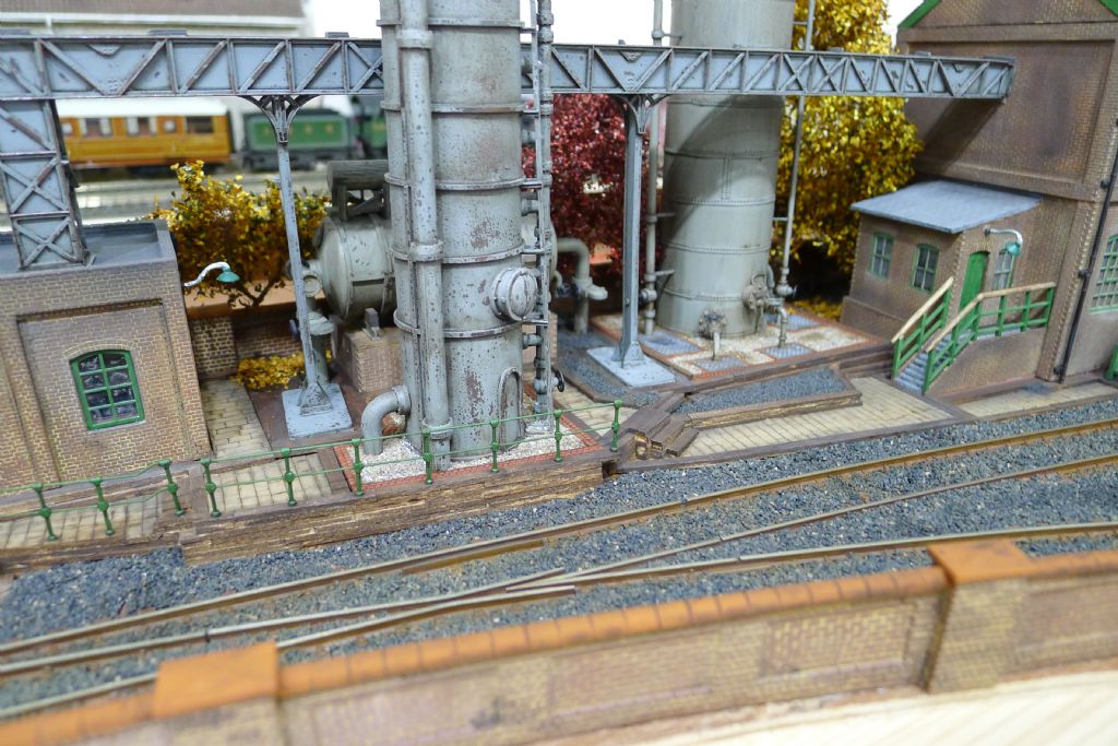

                          There are a few railway modelers on here Jim, I think many of us are simply modelers of any type or description and turn out hands to whatever we fancy at the time.
                          My layout has a long way to go yet, as my wife keeps pointing out!
                          This is my gasworks corner:

                            Hi Richard,
                            I`ve noticed one or two others on the forum have an interest in model railways as well as other forms of modeling ( aircraft etc )
                            I agree with you, I think once you start on one form , curiosity sends you in different directions to see what can be achieved in another subject.
                            Your gasworks corner is just as I remember the gasworks they had in Aldershot back in the 1950`s on a school visit.. I found it a facinating place ,with all sorts of things going on. Long gone.
                            The detail on your gasworks is terrific and must have taken a good while to construct. My own layout I`ve not touched since I started the current boat build but I will get back zto it one day.
                            Do I see an LNER loco and Gresley coach in one picture?

                                    Yes James, The gasworks was built as a separate module as it was to go in a far corner and the shot was taken before it was fitted with a LNER loco going past with a couple of Gresley teaks. I went for a period of around 1947 and set in my local area so the layout is called The Lincolnshire Loop as that is the nearest section of disused track to here. It is surprising just how many repurposed ex railway buildings there are in the area that I can use to scratch build my own versions when the time comes. The gasworks took the best part of a couple of years, on and off as most of the buildings and structures were either severely hacked around kits or scratch built units. I tried to lay out the works as realistically was possible with a retort house at the start, followed by a scrubber, a condenser, a wash unit, a filter bed and a metering shed before the gas holder. In between there is a water tank, a tar collecting tank, a boiler house, fan room and pumping house. Each one took a month or two. The track is laid to provide a run around loop for road goods and a siding to supply coal to the retort house and the boiler house as well as remove tar from the tar tank.

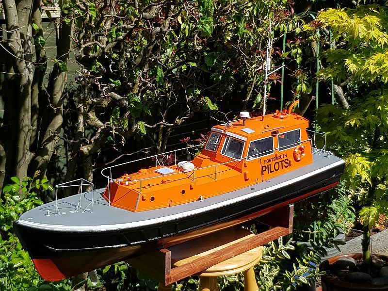

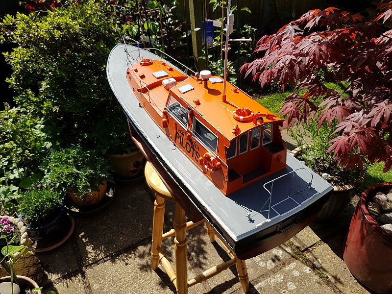

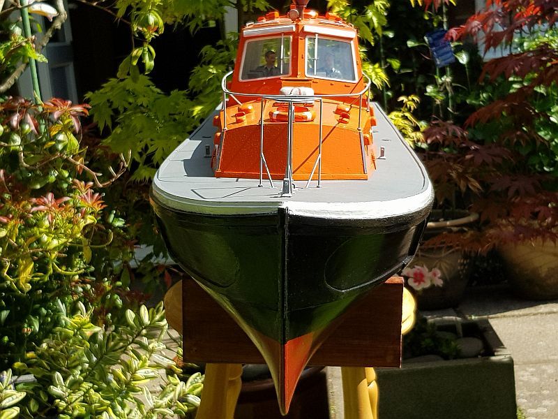

                                        20220430_110011s.jpg20220430_105755s.jpgFinally managed to get it finished. Pleased with the result but as always, I think one or two things could have been better.
                                        Now need to see what it`s like in the water
                                        I haven`t put the various wires etc on the mast as that needs to be taken down when transporting anywhere so there was a chance of damage
                                        To all those who have given me advice whilst building, many thanks.
                                        Now the wood has just arrived I can have a go at Rays Cigarette.
                                        #100363
                                          Hello Jim,
                                          Well you have done your subject proud
                                          The Returning modeller is certainly back , It has been brilliant to see you work your way through the build on this thread, I'm sure she will perform as well as she looks, well done ! you will fine the Cigarette a walk in the park in comparison .
                                          Kind Regards Ray
                                          #100364
                                            Lovely looking job. As a retired merchant seaman I have spent many a happy time leaning over the handrails as I watch the pilot either embark or disembark and have always admired the power of these small craft. I did actually once experience the pilot missing the ladder and ending up in the drink!
                                            Beautiful job, I'm sure she will look as impressive as the real thing on the water.
                                            #100366
                                            James Hill 5
                                              @jameshill5
                                              Ray and Richard,
                                              Thankyou for your kind comments. I must admit I find it a pleasure to be able to be in the garage trying to make a model or two. The garden is occupying a bit of time now and again at the moment but once I get the prop shaft and prop then a start on the Cigarette will be made..In the meantime I can start marking the plan out.
                                              I also need to try and get in touch with the MYA again regarding the Marblehead yacht that I have. I never had a reply last time.
                                              One thing I`ve learned from this last build is I think planking from bow to stern would have been easier than diagonal.
                                              Many thanks once again and I`ll try and get some pictures when it goes in the water.
                                              Jim.

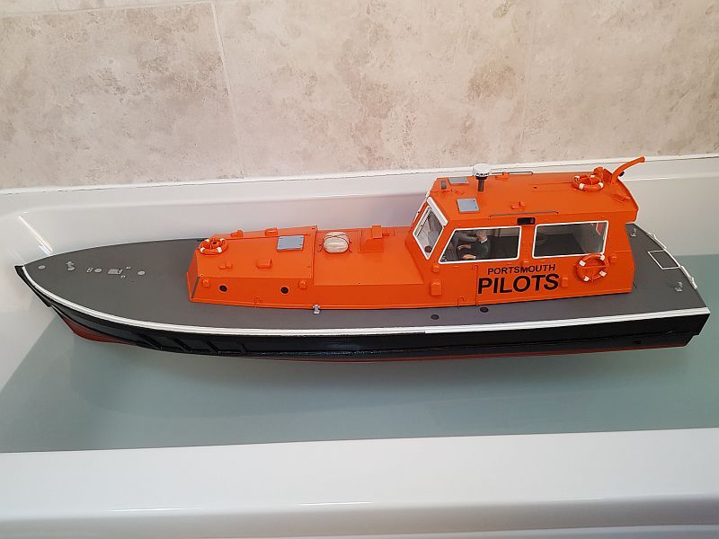

                                                    Finally got it afloat. ( Minus the handrails and mast, just in case! )
                                                    Pleased with the way it sits in the water. My estimated waterline position ( from pictures ) isn`t too far out, about 6mm high, so I`ll put a bit of extra ballast in to bring it down a bit more.
                                                    I took a gamble with the two props but when trying the power, the push was quite impressive so movement through the water should be pretty good. Time will tell.
