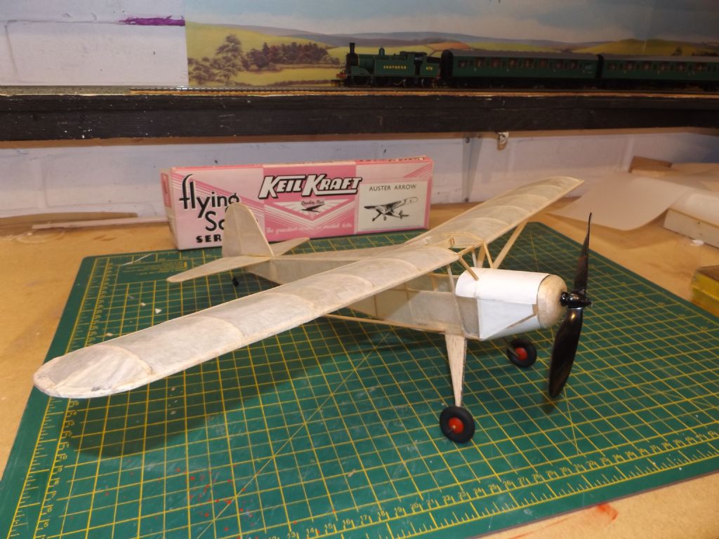

          That's a nice glider kit, I'm lucky having the North Downs in Kent quiet near me, the White Horse Country Park is insight of my office window (back bedroom) so when the South Westerly blows we head off up there for some slope soaring, which is how I learned to fly RC models back in 1977
          Have been doing sticks & tissue paper recently the 1/16" x 1/16" really sorts you out, quite pleased with this little 22" span Auster Arrow

            I was looking through your gallery pictures the other day and saw the one of your Auster Arrow. A lot of the older prop models do make into great fliers.
            The nearest suitable flying site for gliders for me would be the top of Butser hill, just off the A3 ( M ) on the way to Portsmouth, about a 45 min drive from my place.
            You`re right. I can imagine that 1/16" X 1/16" does test your patience now and again, but it all looks good when it all comes together.

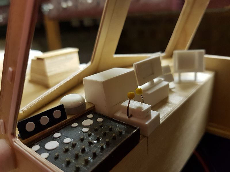

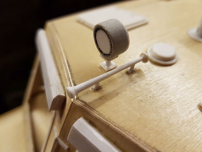

                                    If you read this, I just wanted to say that that is an impressive view of your loft. What a collectionsmiley
                                    I`m having enough trouble trying to find room for things in the garage with all the extra boat stuff. Maybe I need to down size the railway!sad
                                    Boatwise , things are a bit fiddly at the moment. Because the cabin is fairly large I need to put things inside so I`ve been trying to make some of the equipment you can see in a photo I have. All unpainted just now. I then need to make four seats, possibly from mdf as they have a shape to them.Still looking for figures.
                                    After that it`s handrails to make and then paint everything and it should be finished. Then, on to the Cigarette.20211129_105607s.jpg

                                      I like your detailing for the helmsman's controls, you need some lights inside the cabin to show them off ?

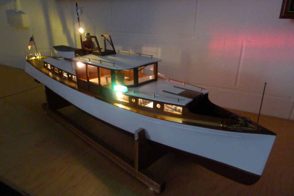

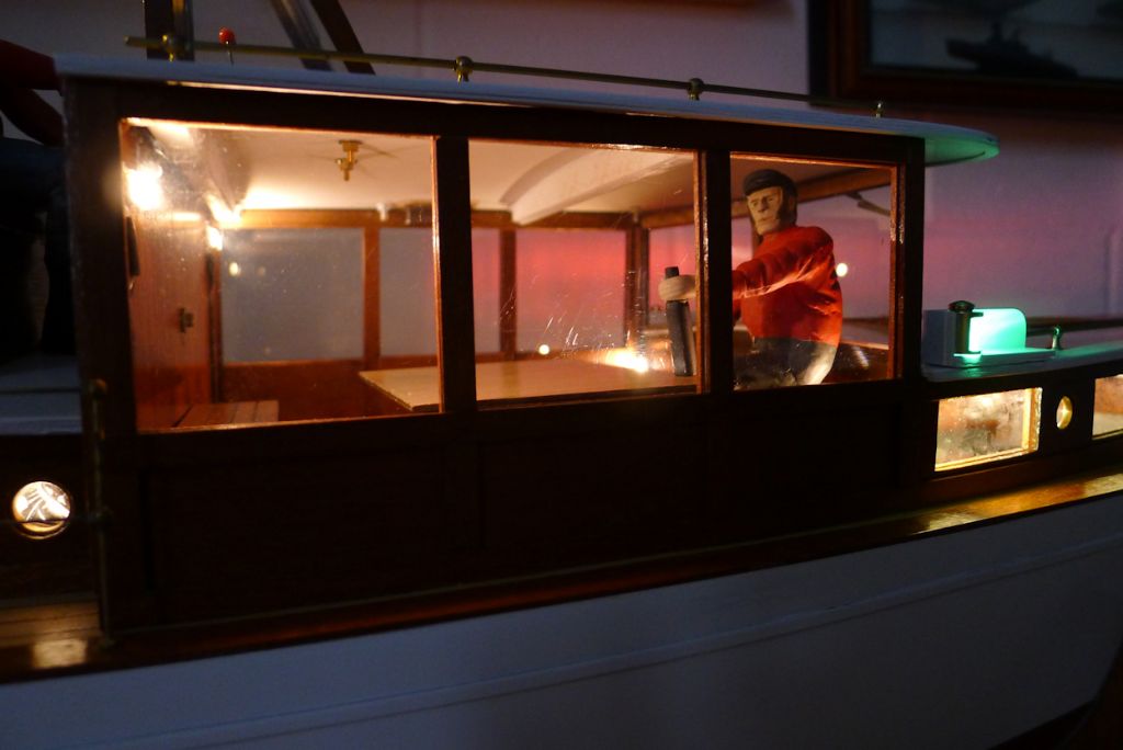

                                          James, This model has four LEDs fitted in each cabin, in the four corners. It gives a much more even light with far less shadows. They are powered by a separate battery and switched from the transmitter.
                                          Edited By Richard Simpson on 30/11/2021 19:25:15

                                              Thanks for posting the pictures. The LED`s certainly show the interior very well and that`s a very nice model. As a railway modeller yourself, you would know all about small lighting systems for buildings etc, which is where I was going to look. Just a case of rigging something up.
