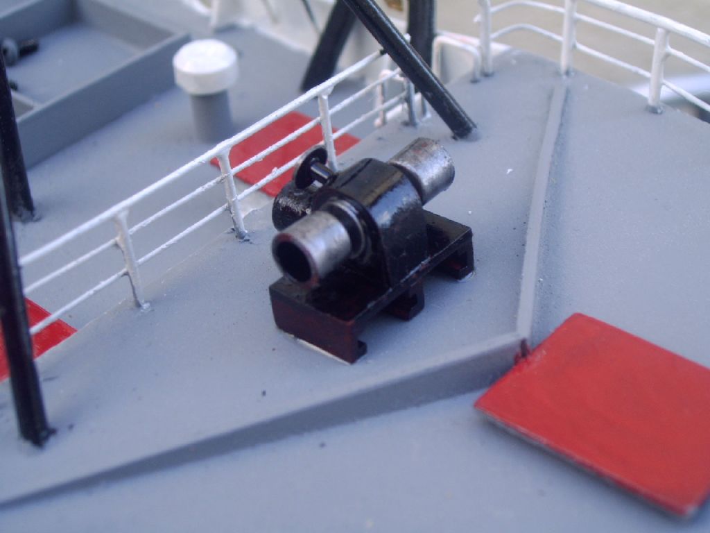

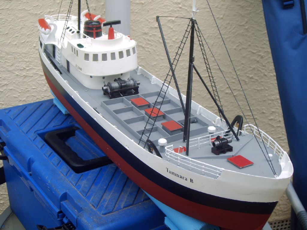

        You’ve a very good point there Mike. Just where do you stop with the detailing. fish nets are one I believe I will do anchors possibly another, Anchor/foredeck winch is a definate, so definate in fact I’ve retro fitted what is possibly a slightly to modern electric winch. (scratch built from styrene sheet and birthday cake candle holders)  What do you think?

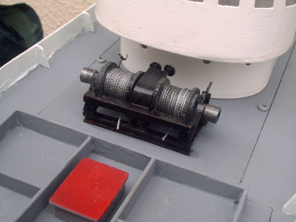

          Manymany thanks to Bob for the drums for the trawl winch a superbly accurate piece of turning mate. they slotted straight aftera little distressed paintwork.
          I’m chuffed with the end result  both the overall effect and inparticular the appearance of a little rust on the framework achieved by painting with red oxide 1st then dry brushing gloss black over avoiding the corners.

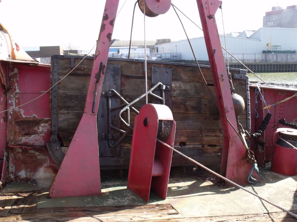

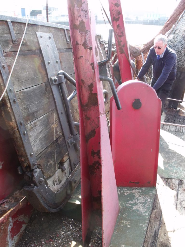

            That looks superb. A great job on the winches. You’ll have to put some port of regsitry numbers on it, though! The otter boards question is a good one, I would have expected them to be a pretty standard size, but I don’t know what that is. Best I can do is go back again to the photos, with one – in it’s usual stowed position – on view.
            …..it looks somethin between 5.5′ to 6′ deep and about 10′ long, but that’s a guess. Note on the second photo you can see the warp to the rear gallows going round a bollard on its way from the starboard drum (extreme right). Not sure about the net mesh size – always a contentious point!
            Mike
            PS – just realised – there’s a net behind the chap (a former deckie) who was taking me round.
