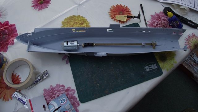

      Airfix have just released a 1:350 kit which suited the bill. The hull is not solid and so to start I glued the base to the sides to try and get a rough idea of how everything will fit:
      Measuring up

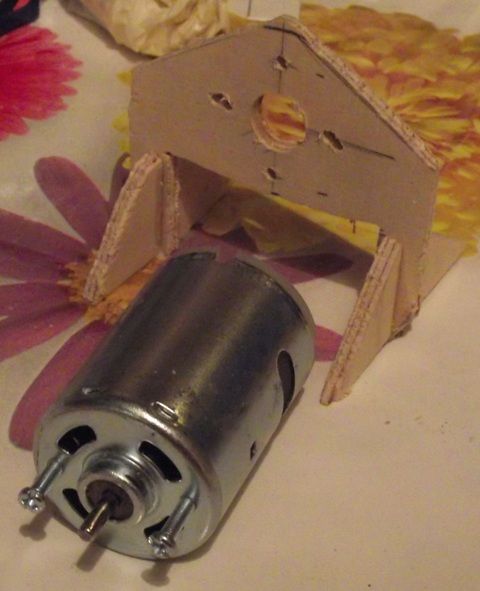

      Due to the space available the motor will be mounted above the battery and with a scrap of wood I created this motor mount:
      Bodged motor mount

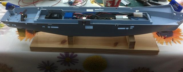

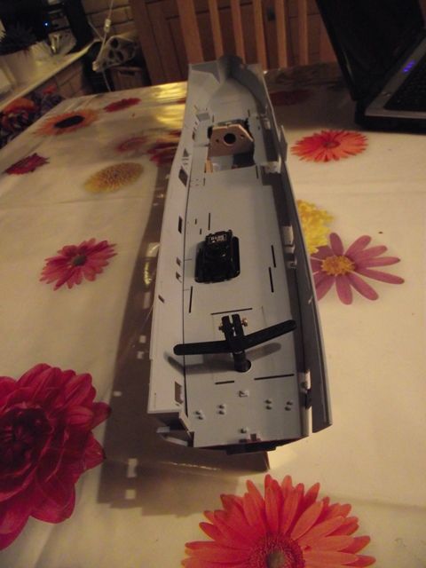

      Very rough and ready. The kit comes with a 'hanger deck' so that the lifts can be placed in 'mid lift' if you want to. What it does mean is that with a couple of holes cut it creates a perfect mount for all of the electronics and also adds structural support without too much need for cross bracing – well hopefully….
      Hanger with holes!

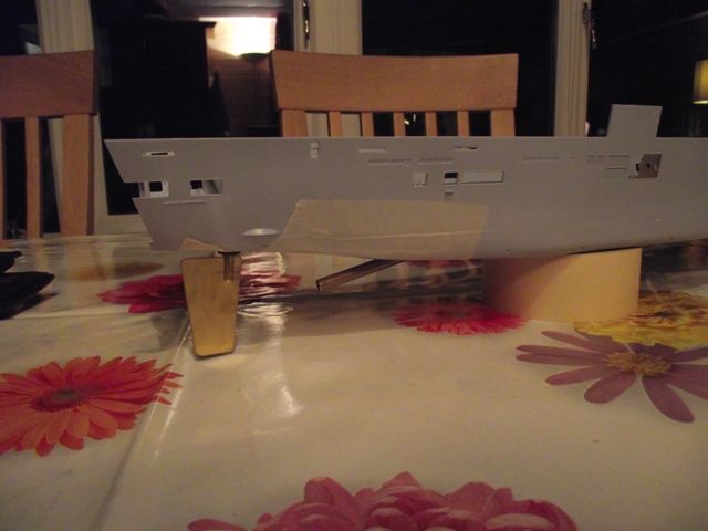

      Rudder taking shape

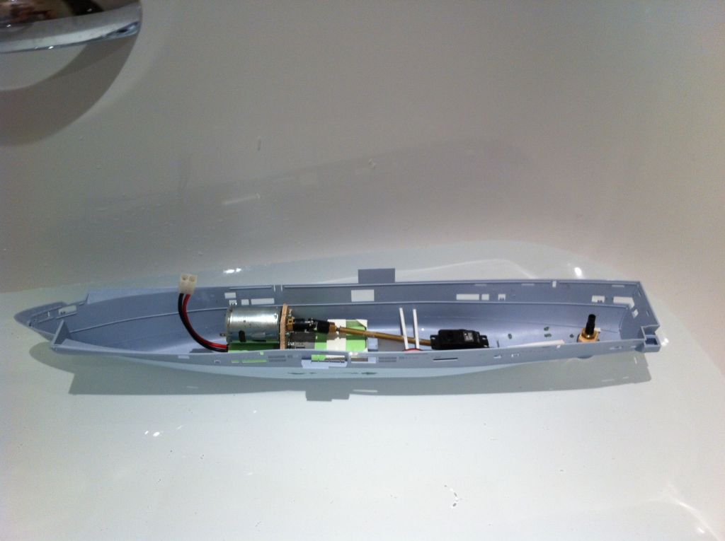

                Bath trials…….
                Bath trials
                The main problem – apart from a small leak around the shaft, was that it sat dangerously low in the water line!
                Can anyone suggest a small battery? Currently got a 7.2V NiMH which is a bit heavy. 6V would be suitable.
                Thanks
                #34058
                  That looks a pretty big motor for the model. I think you could get away with a smaller one and a 4.8v battery which would reduce weight considerably.

                      David, I would use, myself, personally (if I was doing this) an MFA 380 <or similar> and stick it to the base with silicone sealant. Lower the Cof G this way and also lose the weight of a mount.
                      A 6V NiMh pack of AA cells is small and light.

                        Due to the rather unsuccessful bath trials she has been lightened and thanks for all of your suggestions – the battery has been chanced to a AA pack and the motor was replaced to something that was a little more suitable.
                        The model itself has been very useful in the fact that the hanger area has formed it's own waterproof box, and with a bit of work I have managed to fit everything in!

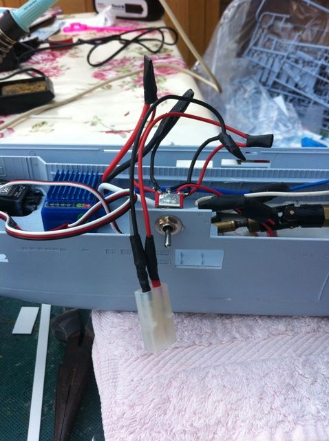

                        Electronics fitted
                        The switch on the side is a DPDT that connects the power source to a charge lead. This is wired so that when it is in the "bow" position it connects the battery directly to the ship's electronics and in the "stern" position it can be used to charge the battery via the connector as shown. The connector I am planning to hide underneath one of the hanger lift hatches as I don't want to butcher the ships asthetic any further!
                        DPDT in situ
