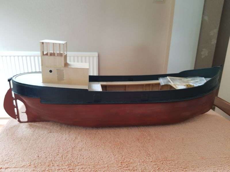

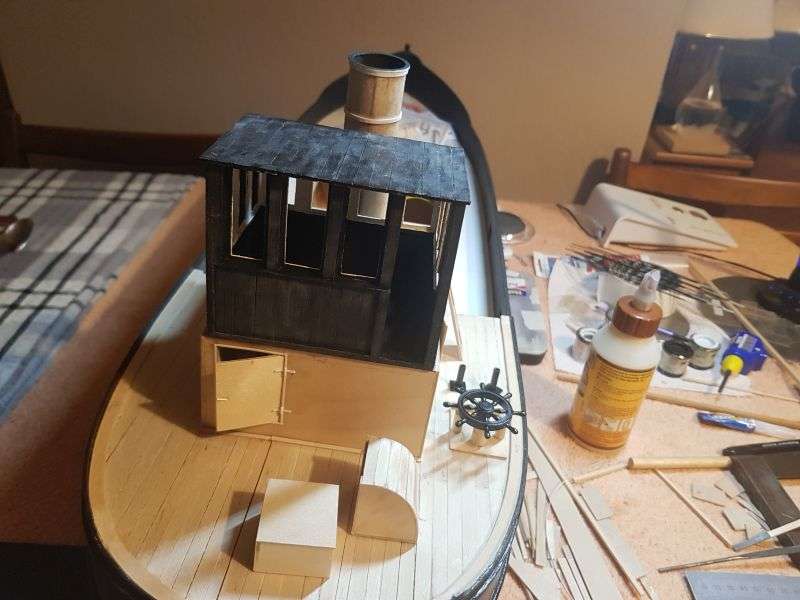

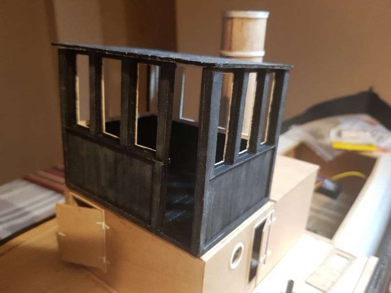

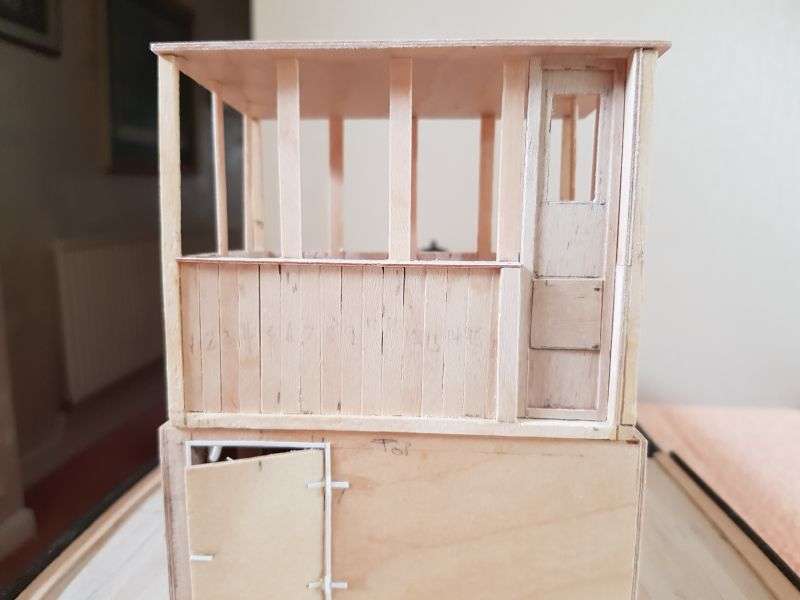

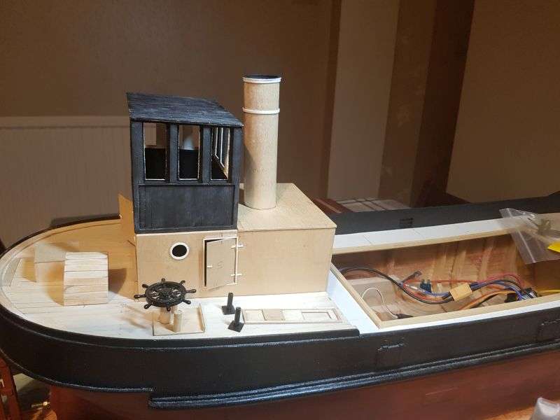

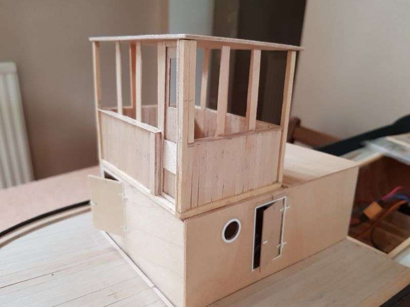

                  Finally managed to get a little bit of progress.
                  I’ve been cutting out fiddly bits on the wheelhouse at present. Hopefully the couple of pictures show what I mean. Nothing is glued down yet, still the internals to do. The glazing is ready to fit when suitable. Once everything is ready to put together I’ll sand and seal it all, then paint it and fit the windows. Hopefully the pictures have posted. Haven’t done it for a while and there was a lot of head scratching went on.
                  Jim.20240929_11433220240929_11482820240929_115013

                    #122537
                    Len Morris 2
                      @lenmorris2
                      Hi Jim,
                      Looks excellent.  Well done.  Have you chosen your superstructure colours yet?
                      Len.

                        That looks lovely Jim! eventually, I will do my poor best to copy you on this, as this looks much more accurate than the superstructure that comes with my Caldercraft kit!

                          Hi Len and Alasdair, thankyou for your comments.
                          Len, I haven’nt picked any colour schemes yet, but i quite like the idea of a greyish engine housing and some sort of wood colour for the wheel house.The internals of the wheelhose require the ships wheel to be fitted ( I now have a wheel), a binnacle , which I’ll have to make, and then maybe a few more bits and pieces to make it look more interesting.
                          The pictures you put up Len look great, Colour certainly brings things to life.
                          Alasdair,
                          I’m certain you will make a fine job of it. I’ve certainly had to correct a few things on the way to where I am now.
                          Watching both your builds with great interest.
                          Jim.

                            Hi Jim,
                            Where are you going to fit your wheel.  Up against the front face or the back face of the wheelhouse?  My plan shows the wheel against the back face so the skipper would have his back to the wheel when steering.
                            Len.

                              Hi Len, that’s where my plan shows it. Directly behind the funnel, on the back face, so the skipper would be standing on one side or the other to enable him to see where they were going. I’m having fun trying to sort out how I’ll fit the windows. I think I’m on my third idea!!! Not as easy as I thought it would be to try and make a decent job of it.
                              As there ‘s a ladder up to the wheel house door I’ll have glue the wheelhouse to the top of the engine house roof. It will all lift off in one piece then.
                              Jim.
                              #122582
                              Len Morris 2
                                @lenmorris2
                                Thanks for that Jim.
                                Wheel against the back face it is.  You might find the last post on my thread about glazing of interest.  My ladder rails to the wheelhouse don’t attach to the engine house they just touch at the bottom so the wheelhouse can still come away separately.

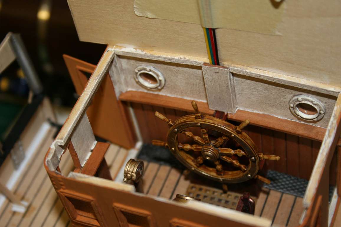

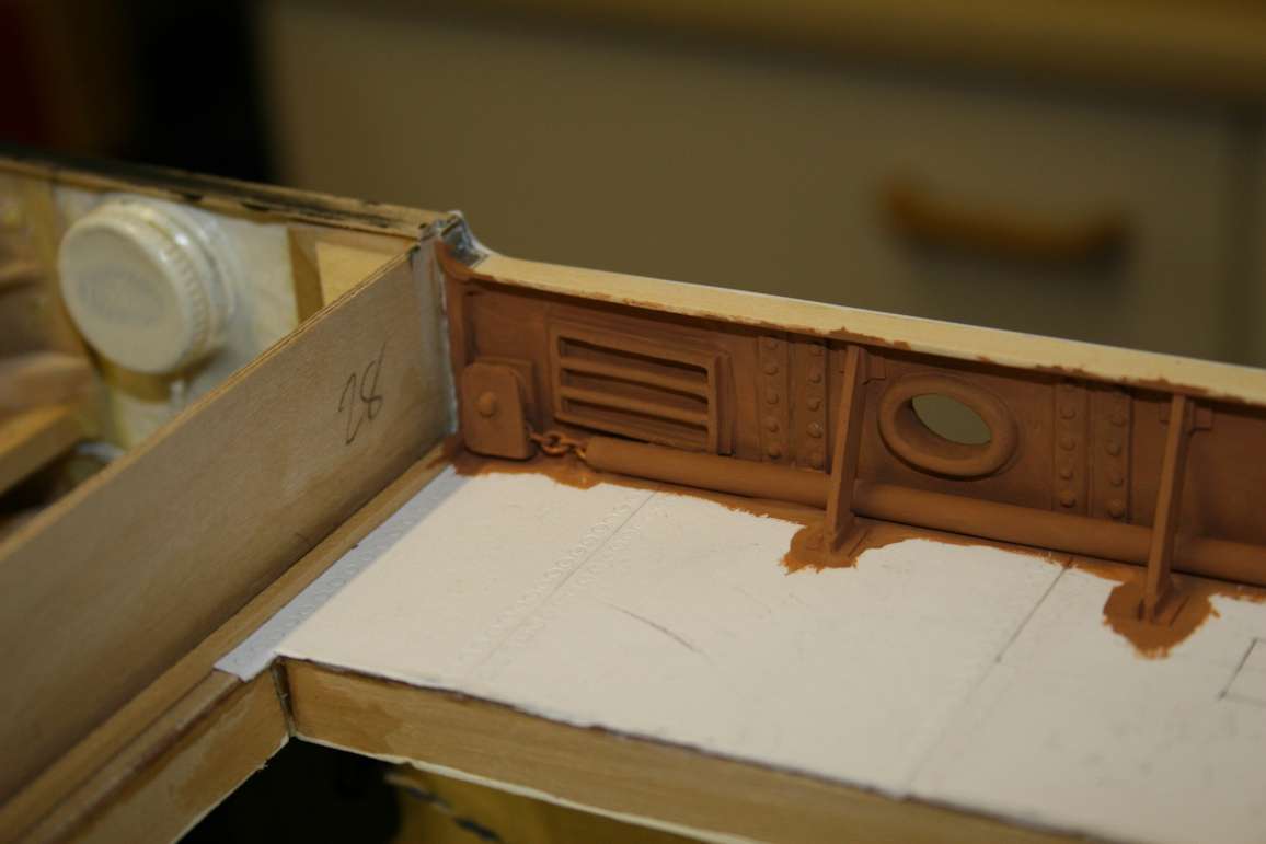

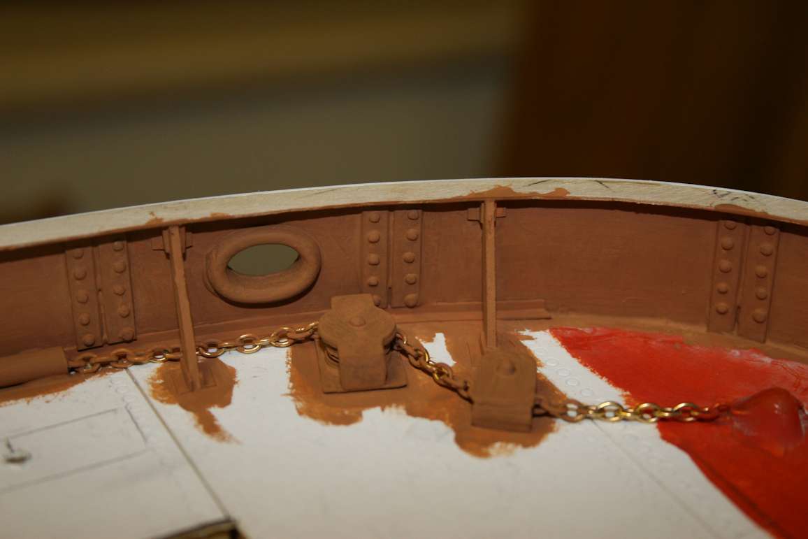

                                  I’ve seen a number of ‘discussions’ over the years when ‘experts’ have advised that both the wheels on my Ben Ain is the wrong way round!  Not only is it according the the drawing in a C.V.Waine book but it is also correct as per the original builder’s plans, kindly forwarded to me by the ship’s last owners.  When the wheel was this way round the cox simply stood to one side, which was necessary anyway in most puffers.
                                  08-11-06-13BenAinConstruction126
                                  05-05-24-17BenAinConstruction 842
                                  08-11-06-15BenAinConstruction128

                                    My plan comes courtesy of Vic Smeed and  from the drawings of Sott and Sons of Bowling, Dunbarton, so like you Richard, we can’t really be any more accurate than that.
                                    One thing on the drawing I found strange, was the chain from the wheel to the rudder at one point runs down the outside of the engine house, then goes under the decking. the drawing shows it as a chain , but in reality I would have thought it would have some sort of cover over it to stop the crew getting caught in it. I don’t really know.
                                    My next target is to find some thing to represent ships crew.
                                    Richard , did you make the binnacle in your picture?, or was it sourced from elsewhere?
                                    Jim.

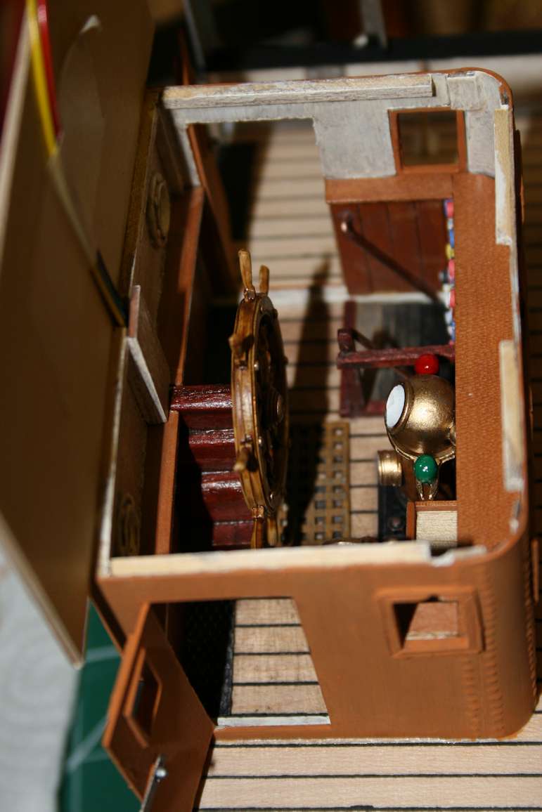

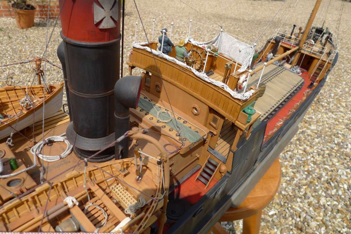

                                        Jim, The figures on the ship above are two of the original kit supplied figures from Mount Fleet Models and the binnacle, along with the wheel and the telegraph,  were also part of the original kit, however they are all 1/35th scale.  Just a word of caution with 1/24th scale, cast white metal figures, they are quite heavy!
                                        As regards the chain, it was frequently run through conduit of various types but also exposed in many places.  Not only would that be a hazard from the perspective of the movement of the chain but it would have been liberally coated with grease as well to try to prevent rust.

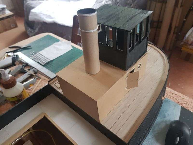

                                              Managed to make a few more bits.Window openings are now finished. I can fit the windows now it’s all been painted and fit the retaining strips in place. One or two deck fittings made and positioned. I made the funnel from thin ply rolled round reducing diameter formers until the right size was achieved. After butt joining, I glued some strips of ply down the inside to make sure it all stays together. The funnel will be red at the top and black from there to the base.
                                              The ships wheel and binnacle ,and one or two bits need to be glued in place. The door has been made, just needs finishing off and painting. After that, it’ll be down to making more deck fittings. including the crew.
                                              Once the wheelhouse has been completely fininished, and any paintwork touched up, I think the next move will be the handrails. That’ll take a while.20241027_203059s20241027_203130s20241027_203142s20241028_133734s
