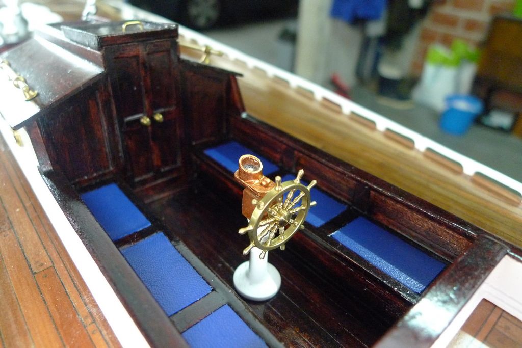

            So! Having given the wheel, too, a coat of clear varnish, to keep the brass from tarnishing too quickly, the pillar and wheel could be united! It has not yet been glued down (something I won't do until the helmsman has been fitted), but apart from that this means that the actual build of the boat is now finished!
            Not counting the time between May and October last year when I did no builing because of moving house, I have spent 79 weeks, and thus, on the I think reasonable assumption of an average of ten hours work per week, just under 800 hours on this build.
            That said, I am of course not entirely done yet, as there are still a couple of crew figures to prepare and add!

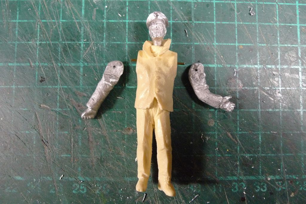

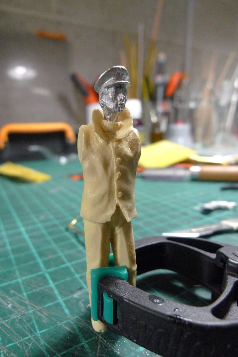

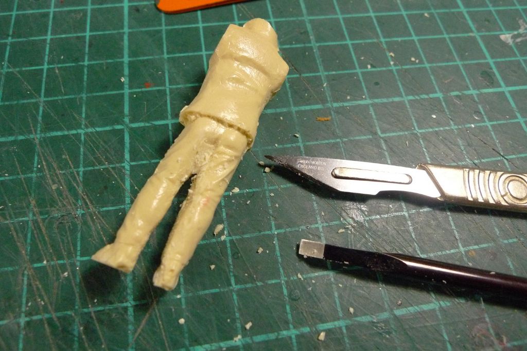

            For these, I have gotten some 1:24 resin-and-white metal figures from Dean's Marine, first up of which is the intended helmsman.
            The resin casting of this particular figure is basically OK, although a fair bit of cleaning and clearing needs to be done, and also, at a further stage, some filling in or adding on.

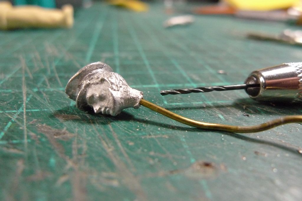

            After some intial work on the resin body, I then drilled a hole into the base of the neck into which I could insert some soft brass wire …
            … the other end of which could be put into a corresponding hole in the torso.

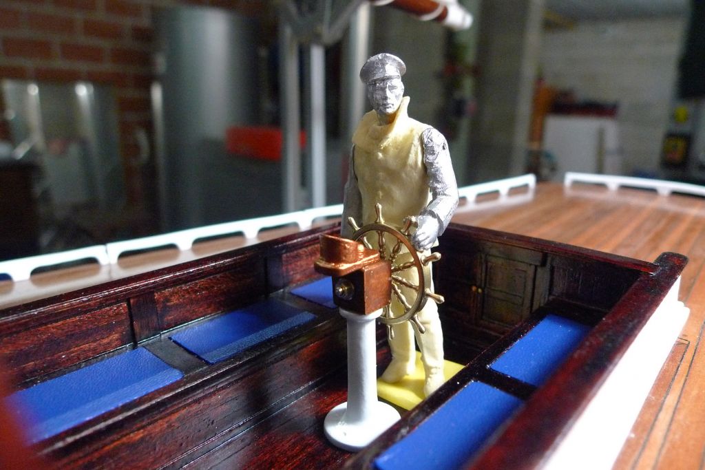

            I also pinned the two white metal arms through the shoulders …
            … so that the figure could be dryfitted for a general check. The pins will also help keep the arms in position when they are eventually glued on, but that'll be for later; next up will be some more fettling …

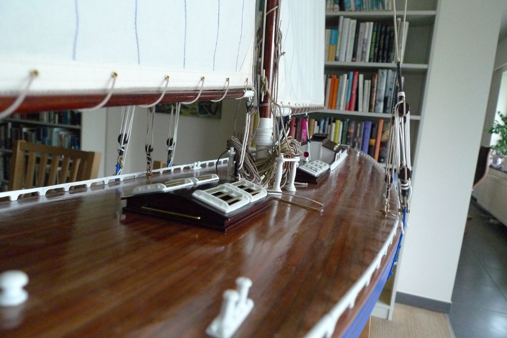

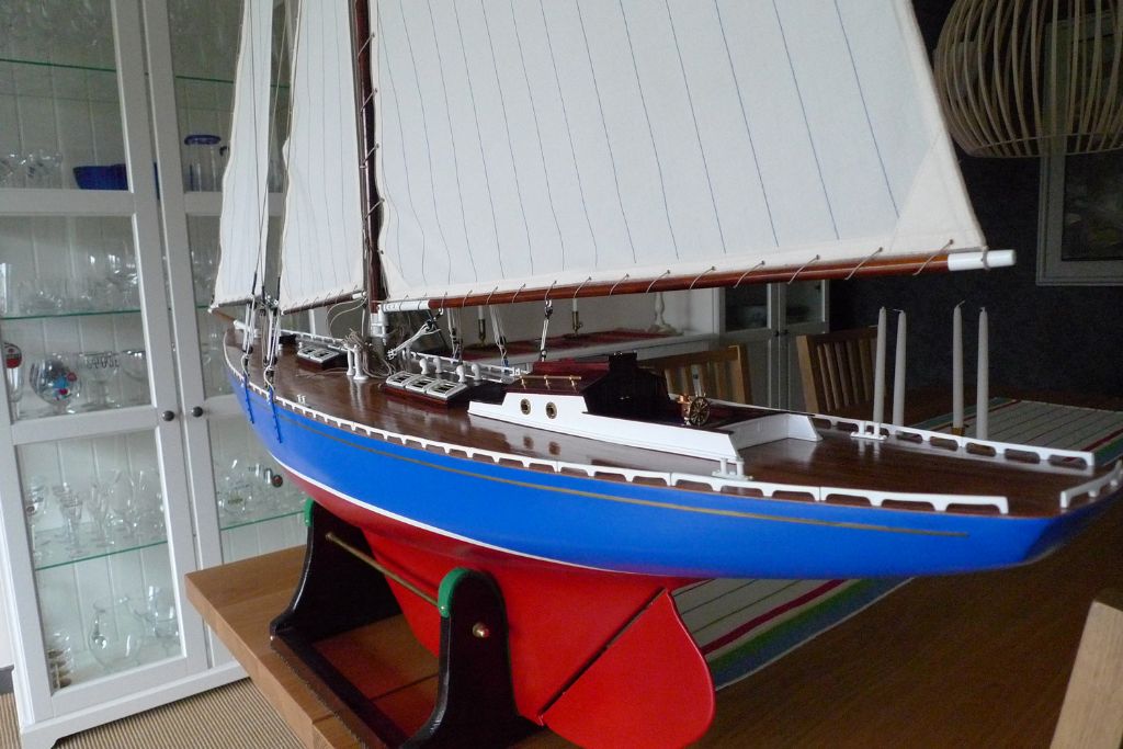

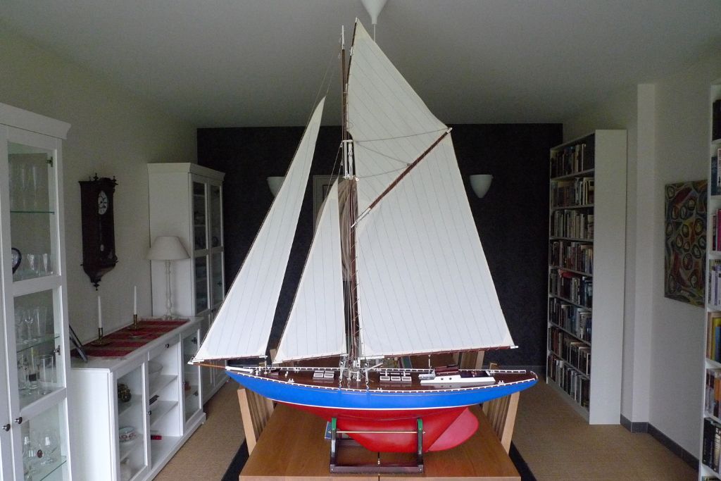

              Before i continue getting on with the crew members (of which I plan to show two), I brough the model upstairs from my workshop, where there is enough ceiling height that I culd reset the topmast, in order to take a couple of photos of the finished article in daylight, so here goes:
              To be continued …

                Wow! Mattias what a beauty! If that first photo was on the water you would be hard pressed to say it was a model boat. That deck and sail detail again wow!
                I will miss your build postings so I hope you will be starting on another for us to enjoy
                Many thanks .
                Eddie.
