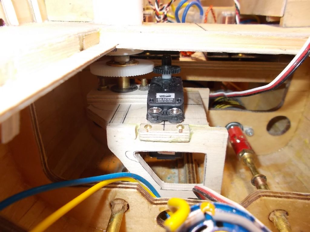

                        John W E
                          @johnwe
                          dscn0865.jpghi there, if you go on to EBAY they do 180 degrees servos which are round about the £5 mark – but make sure you get the analogue one and not the digital one. That is one method,.
                          Also, if you go onto YouTube – there is plenty of videos – which show you how to convert a standard servo to either continuous rotation or, 180 degree movement.
                          I used a similar servo from EBAY myself for a crane on one of my models. I used a continuous revolving servo, but, used a gear ratio of something like 5 to 1 to give a smooth rotation of the crane. Just food for thought.
                          john
