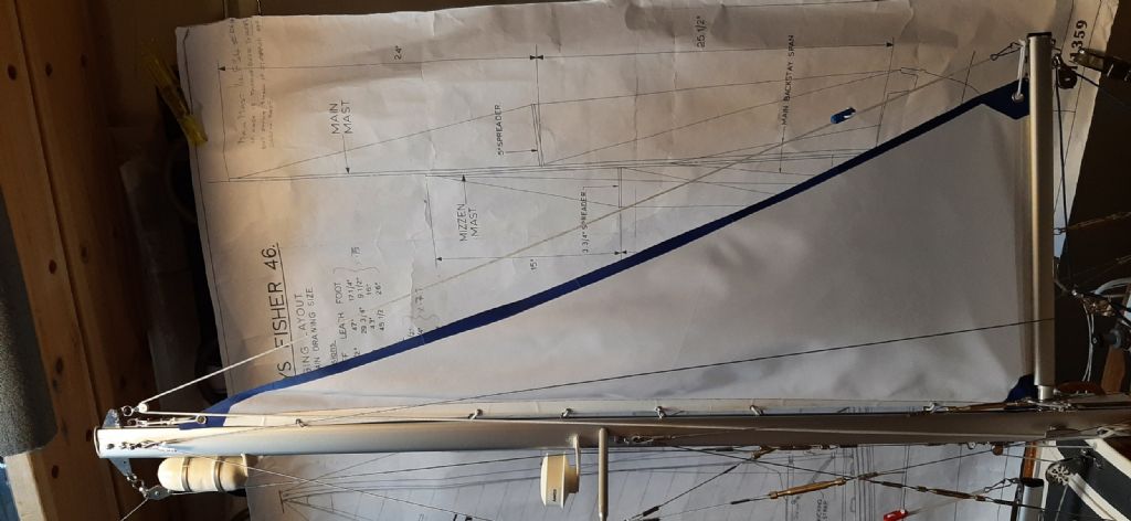

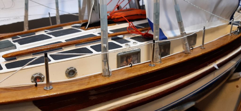

              20210322_181216.jpgSails have been produced and are draped over their respective booms ready for an eyelet-punching session.
              Stantions have been loose-fitted onto the bulwarks and threaded with .6mm elastic.
              The infamous pulpits are stashed away for drying/cureing/whatever. New alu' and brass tube has been ordered and is en-route from Oslo just in case I have to start again. The thinned Humbrol seems to be drying better than in the first attempt.

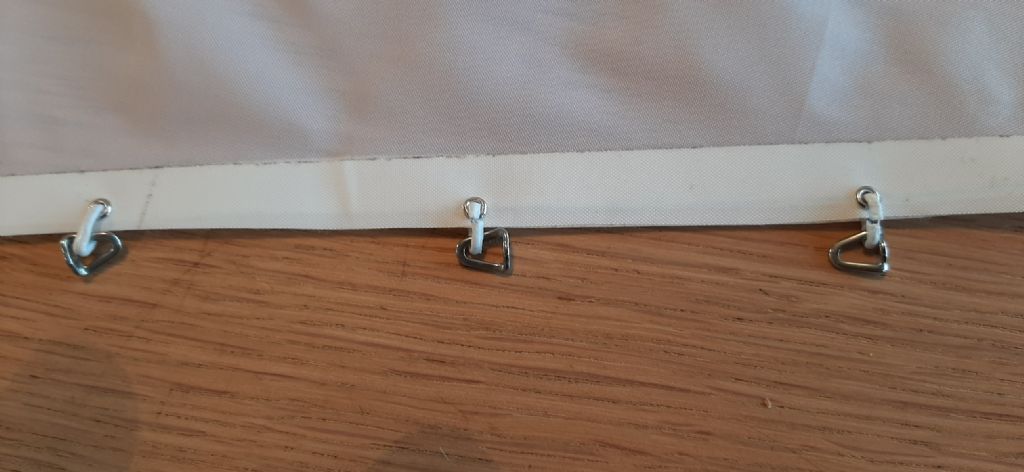

                  More delays,
                  the super 'boom sliders' I bought from CMB over a year ago are just that…BOOM sliders. They slide nicely in the BOOM slot. They are not however big enough to stay hooked into the MAST slot! They are made of nickel plated brass so I think I can file off the plating on the underside and solder on some brass wire to increase the diameter of the baseplate which is supposed to slide inside the mast slot. Trying to locate some small brass washers or thin plate but no luck so far. Already have brass wire,20210324_090622.jpg so will try that later today. Sliders shown here on luff of the mizzen sail.
                  Admiralty getting first Covid injection this morning.
                  Never a dull moment!
                  George
                  #94399
                  gecon
                    @gecon
                    The boom sliders where 'adapted' slightly yesterday. The base which fits into the boom slot was enlarged with some brass wire and solder. Could not source any thin brass plate locally but did cut a piece of 3mm brass tube lengthwise! and flattened the half-tubes into a 'plate'. then short cut-offs were soldered to the base of two sliders -as a test. Worked OK too but going for the soldered brass wire otherwise I have to fabricate the brass plate from 3mm tube!
                    Anyway the mizzen is 'in the groove' for the time being.

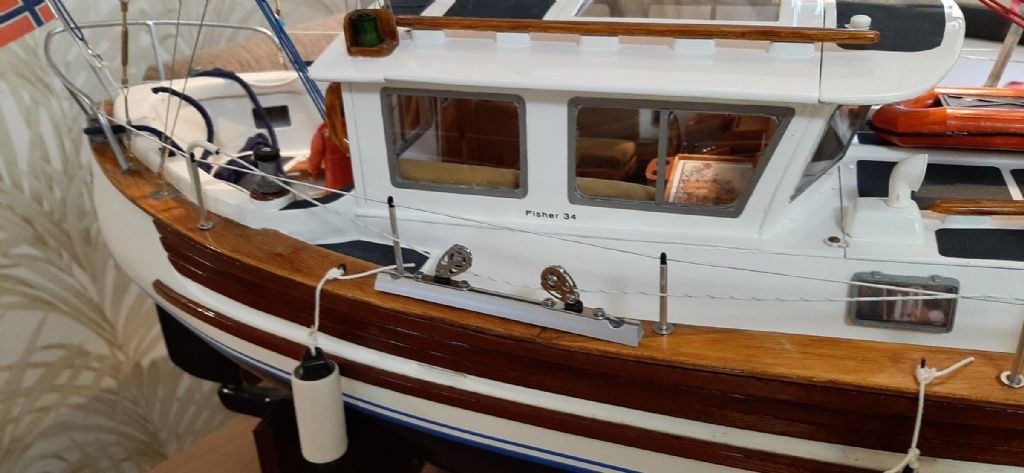

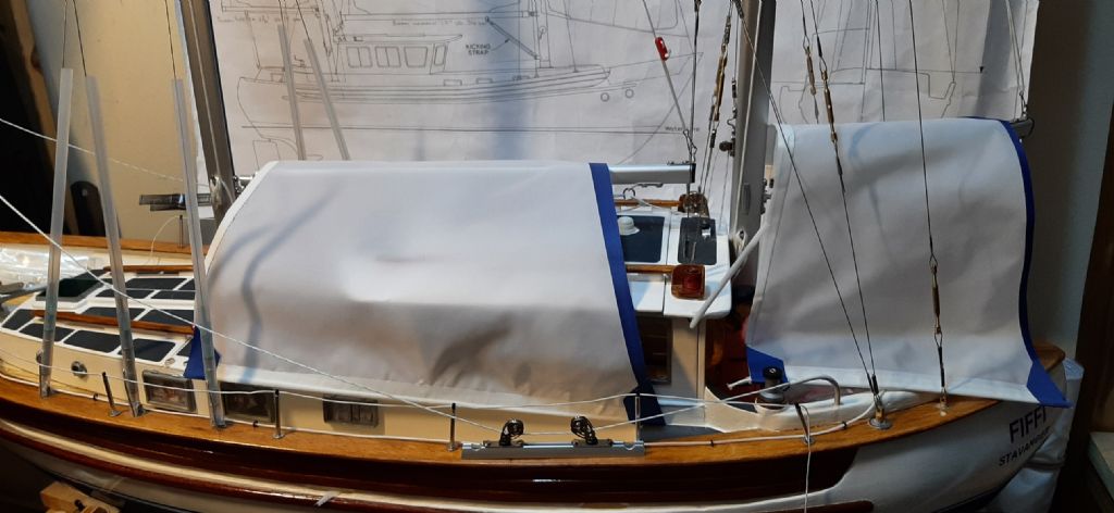

                          20210327_153523.jpg20210327_153647.jpgFiddled with the sliders and managed to make something which worked well enough. Sails can now be hoisted. Still a lot to get done before launching though. Forecast not that good, so may have a few extra days due to the wx. Took some quick photos. Allways a lot of 'clutter' in my pics due to not bothering to move items out of the way! Flower pots, lamps, salt &pepper etc. Will do some better photos prior to launch…..in case they are the last photos above the surface!

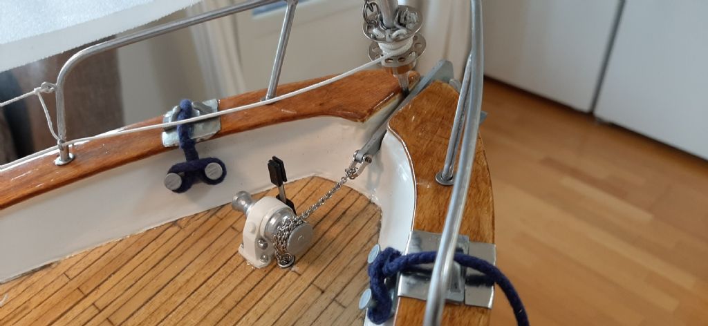

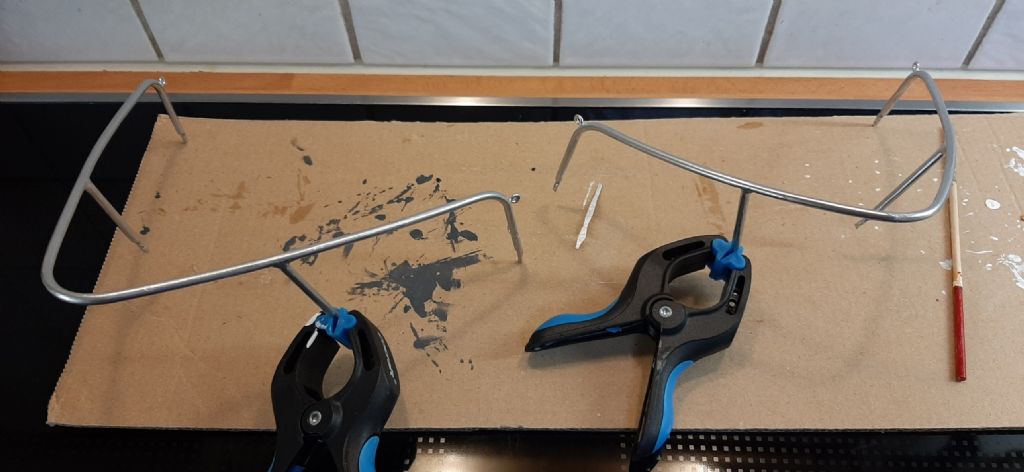

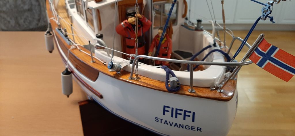

                            20210329_175522.jpg20210329_175713.jpgGood glue-day today…did a lot of small fiddly jobs which have been on 'the list' for a while now. Have to do things in the right order though.
                            Many ready made items epoxied in place, bollards, fairleads, roller furling winch on port coaming.
                            Also took a chance on the silver paint and epoxied the pulpits to the bulwark cappings. No fingerprints on the pulpits this time! Guard rails threaded through the stanchion tops and 'stretched' in place.
                            Still some work to do before ready for floatation test at the local lake -or maybe the shopping centre water-park where I tested the Comtesse last year.

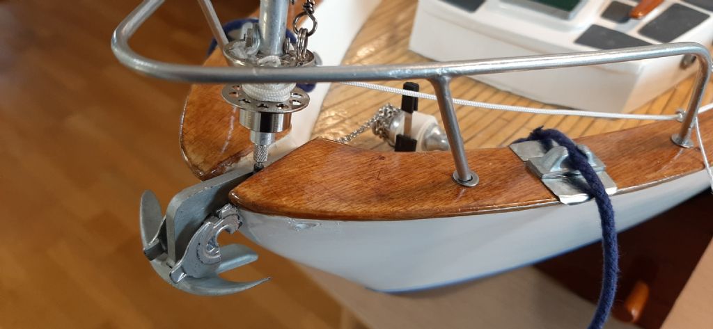

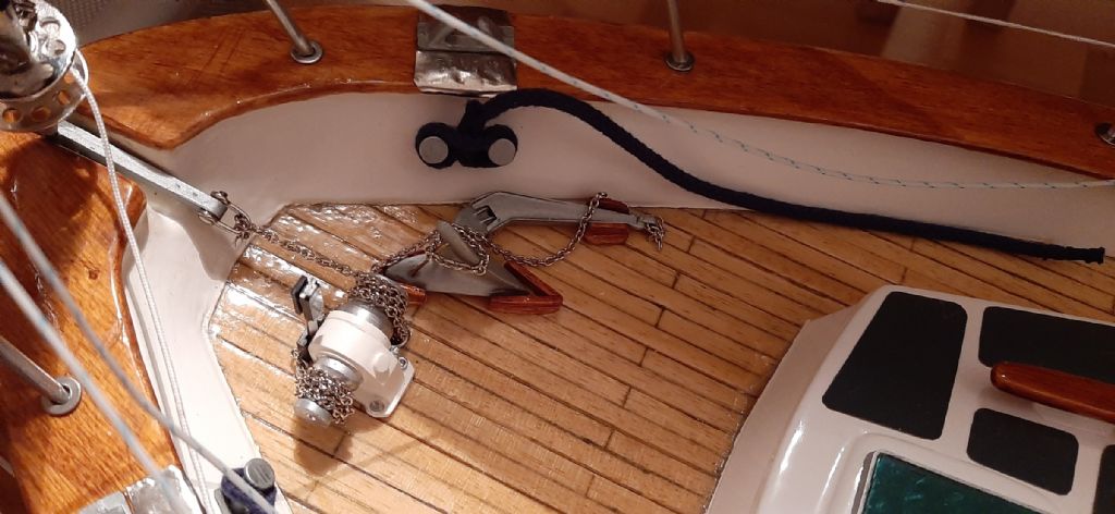

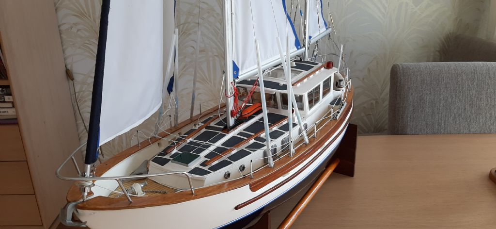

                              20210330_160852.jpgThe anchor windlass was fitted yesterday together with Bruce anchor and chain. Manual operating handle and a slightly strange stemhead fitting for the anchor were produced from car windscreen wiper bits. Fitting not glued in place yet because I'm not sure I'll use it.
                              Weather report is OK for the next couple of days so may well have a ceremonial launch tomorrow or friday. Not much breeze forecast -and I don't really want much either!
                              Trying to revive an old-ish Roam3 action kamera to see if I can get some onboard photos. A bit optimistic, but worth a try.

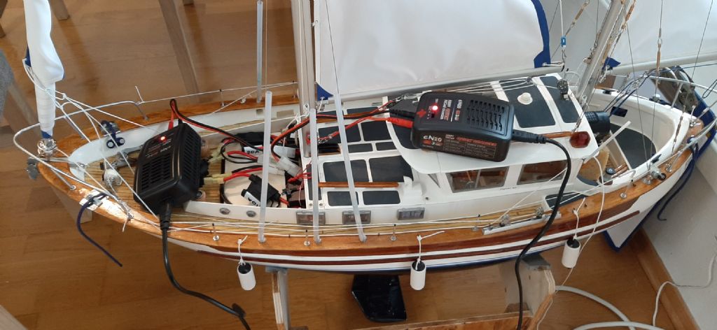

                                Whatching batteries being charged is as exciting as whatching paint drying. This particular job is a 'major event' for me prior to launch in a day or two. Looking out for any signs of smoke during charging!
                                One can just see the wing keel lingering below the hull….bolted on of course.

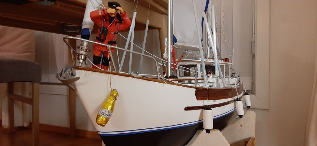

                                    Funny you should mention that Chris. At 1730 local time I was trying to locate a bottle! Couldn't fin a 1/12th scale magnum anywhere! The whatchman Chopper kindly donated his magnum of 'RHUM' which I think he nicked from the good ship Venus as a souvenir!
                                    It's shown here at the ready. Not sure if the chocolate bottle will break though!

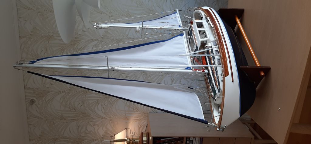

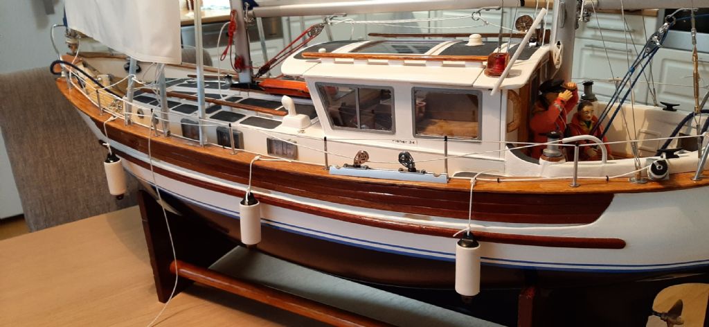

                                            20210401_150508.jpgLaunched at 1245 local time. A slight offshore breeze took her sedately away. Sailed very well in fact. Had wedged my Contour Roam 3 action-cam in the wheelhouse doorway on a foam base. So have 10 minutes of video. Post a couple of photos from the PC screen. Get something onto YouTube eventually. 20210401_150437.jpg
                                            After about 5 minutes on the water the 'lady' inside my transmitter voiced several times a warning about LOW receiver power. I did not realise what 'she' was saying until I had no control of the boat! Luckily after my son in law started taking off his jeans to start swimming, Fiffi turned for the shore! Took several minutes of turning with the wind before I could wade out and get her. One photo shows my waders off the port bow just before retrieval!
                                            At home when I swithced on again to do some tests everything worked perfectly. Wiggled the swithches and wires but could not reproduce the problem. So I do not yet know why the Rx low battery warning sounded. The transmitter screen showed that there was 0.0v in the receiver immediately after the shut-down, but back at home it was again showing the expected 5.0v from the BEC system.
                                            I should have tried swithching the Tx off and on again at the lake -as my grandson suggested. Might have had a longer sail today.
                                            May try everything again tomorrow as is. I considered some months ago to use a dedicated RX batt instead of BEC. So if the problem crops up again, it'll be twin batt-packs for the Rx. I have two speed controllers so I can try the BEC from the other controller.
                                            George

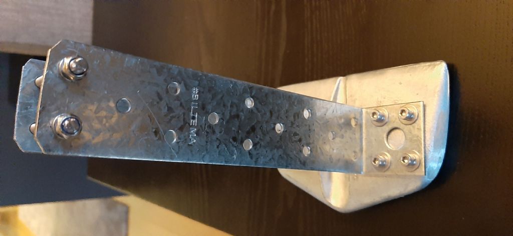

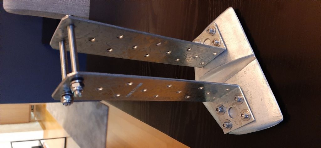

                                                20200811_233706.jpg20200414_200955.jpgHi Chris, if you mean the genoa sail, yes it worked just as I'd hoped. If I'd utilised the whole internal length of the hull I'd have achieved another 5cm of sheet travel each side and that would have been perfect. The Fisher will not sail close to the wind so it does not matter if the genoa cannot be sheeted tight into the shrouds.
                                                Post photos of keel from my album. Keel is boltet through the hull. The wing is the same as on the Comtesse yacht from Krick. The 'legs' are galvanised angle-irons! Four equally spaced carbon rods were drilled through the keel and through the iron/20200414_200946.jpglead shot ballast. I used the two holes which gave best balance and covered over the other two with cloth and resin -and paint!
                                                George
