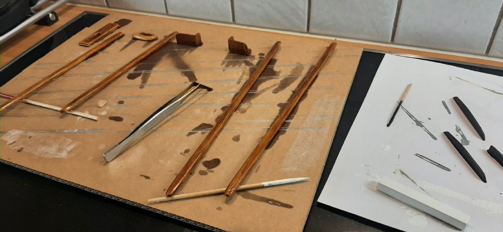

                Painted white gloss on some coach roof sections and other bits today while the Admiralty was doing her nails! Managed to use the wrong gloss paint so will have to start again in two days. We usually pack away the Xmas tree and decor' today 01.01. but have not started yet. It'll be done during this weekend while waiting for the 'wrong gloss' to dry thoroughly.

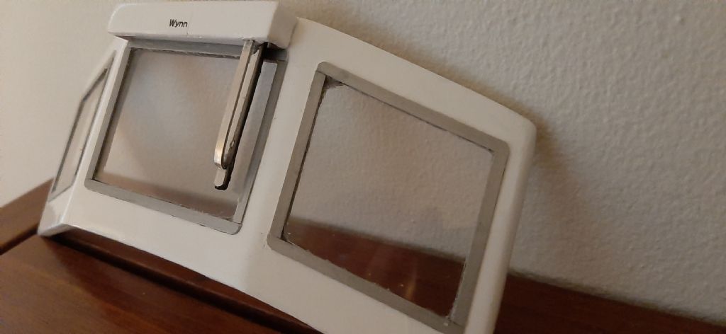

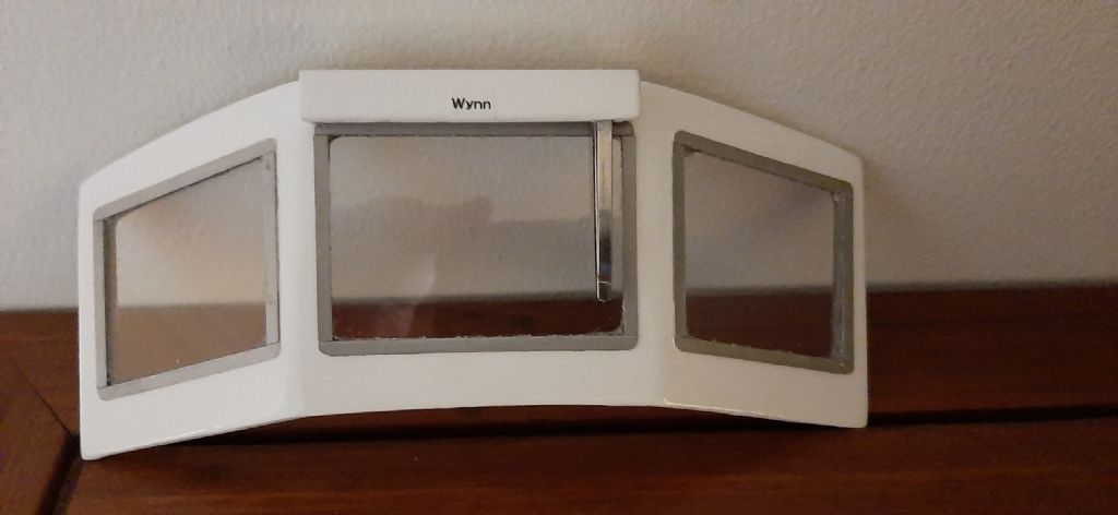

                  Spent last couple of days on final production of the wheelhouse front screen. Managed to make a Wynn linear wiper unit as fitted to my particular full-size version. Fishers have had different types of wipers fitted through the years. I hope to be ready for stepping masts in a couple of weeks. Still have not decided on how to secure the 20210107_155611.jpgcoach roof sections and that needs to be done before masts and rigging.

                    Hi George,
                    I like that wiper very realistic, Stepping the mast on top of the coachroof is a real pain if your trying to maintain some access the internals and RC I imagine your shrouds & backstay will be operational ?

                    #93107
                      George, what he said. How big is the lettering? It’s very neat!

                      gecon
                        @gecon
                        Hi Ray, the mast will be keel stepped, it goes through a hole in a fixed centre section of the coach roof and 10 cm down to a block which is glued to the frames & keel. It's allmost self-supporting. This can be seen in some of the photos posted previously.
                        The wiper is made from spring steel and rubber -both from my daughter's car's disgarded…….window wiper! smiley
                        I've also made a map-light for the wheelhouse chart table -used wire and metal from top of a bottle of sparkiling wine.
                        Hi Ashley, the capital letter 'W' is 2mm. Printed on a hand-held 'Bother P-touch' dymo-thingy.

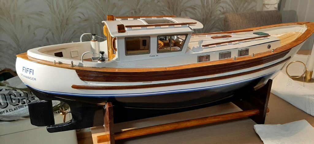

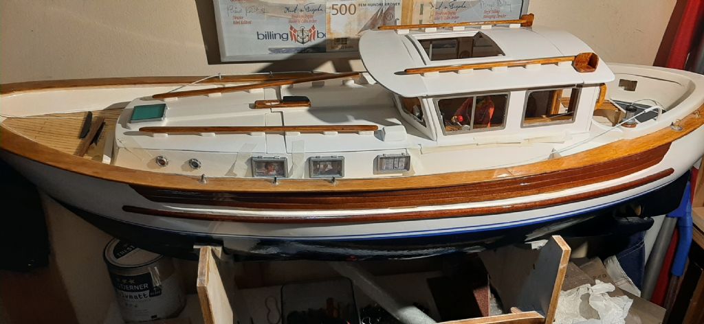

                          General overall view. Ready at the end of next week set up rigging and step the masts…I hope.

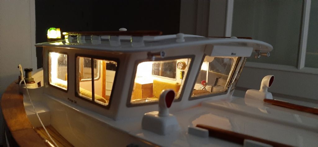

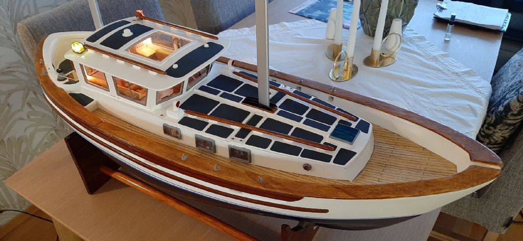

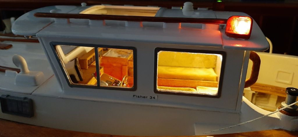

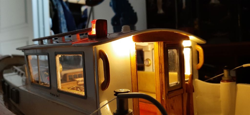

                            20210110_141443.jpg20210110_141602.jpgAfter having been enlightened by Ashley, I got the urge to 'enlighten' the yacht. Installed nav-lights and cockpit work lights. A by-product was wheelhouse interior lights but these need to be subdued a bit. Maybe splash some red paint on the bulbs or thread over some red drinking straws….to simulate night-lights.
                            I had not originally planned for working lights so there's no stern light. It's too much agro now to try to get wiring to the aft pulpit.The two cockpit worklights could be fitted with 'blinkers' to give the correct 67.5* each side but only if the Admiralty puts in a complaint about the missing stern light.
                            We're being told to stay home as much as poss even here in south-west Norway, so that means I should have plenty of time at the 'shipyard' next week to get ready for stepping masts and rigging by next weekend. Not that there's any hurry, the local lakes are frozenface 1220210110_141555.jpg

                              Adding the lights was a good decision George. It really lifts the model, especially as you have interior detail.

                                gecon
                                  @gecon
                                  I see from the photos that some light is 'leaking out' through the joins!blush I think I used 15-min. epoxy there so have to apply something to the inside of the join. Maybe some 'teak' woodwork will do the trick.

                                  Dave Harrison
                                    @daveharrison24862
                                    George the lights look fantastic, are they LED's or grain of wheat bulbs ?
                                    #93191
                                    gecon
                                      @gecon
                                      Hello Dave, as usual, I don't often have short answers to questions…..but I'm working on that deficiency!
                                      They are LED…and I thought they were called 'grain-of -wheat bulbs' due to shape and size. I did not plan on having working nav-lights. Too fiddly I thought. BUT…when digging out the Christmas decorations in early December, I found a packet of battery operated lights! These are designed to drape over some indoor plant or feature which you want to 'brighten up for Xmas'. 20 small bulbs-in a-row on 95cm of thin wire, a battery box for 3xAA batts.
                                      I noted that I could maybe thread them through the Fisher wheelhouse to jazz it up a bit. Maybe I would be allowed to have the yacht on display on the sittingroom sideboard for a few hours in the evening -so long as it was gone on the morning tide.
                                      The battery box is beneath the stbd bench seat. The wired-on-lights are then routed up to the stbd nav-light, then to the aft stbd cockpit light, then over to the port cockpit light etc, then down under the pt cupboard, helmsman's seat and instrument consol. Bulbs which are not inside light-lenses are either painted over red to reduce the glare (done last night) or routed through red mailkshake straws to produce a slight red floor-level 'night-light' effect.
                                      It's a bit Heath-Robinson but I'm so positively surprised, that I am already looking for 'propper' lighting to build in to my next boat, a Billing Colin Archer, 1/15 scale.
                                      I'm not sure if all those LEDs will effect the R/C gear but I don't intend to sail at night so the lights will not be 'on' at the same time as the R/C gear. There is however a good bit of wire in a ring across the whole wheelhouse! It's easy to remove the whole lot if it gives problems. It' a nice 'party-peice' for the time being.

                                        Good to note that the lights are accepted by the learned. I was sure that at least Chris would like them -being fair(e)y lights. But now they're Fisher lights!
                                        I've located & ordered som 'propper' ones. from CMB, marketed by Krick. " 2 whites, one green, one red in a set. These will go into the already started Colin Archer RS1. Must re-check that order to see if they're 'in stock' or 'awaiting delivery'.
                                        The xmas fairy lights are marked 'indoor use only'sad so not sure just how long they will live. They could be however, a simple, cheap way to achieve illumimation of the entire interiør of a liner – ferry- Ray? Red/orange acrylic on them gives a nice subdued hue. I have seen some dedicated interior 'liner' lights somewhere, but not sure where. Others will have found this out years ago I suppose.

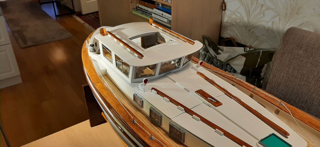

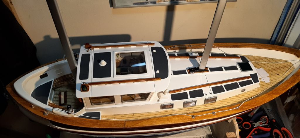

                                                  20210116_155351.jpgThere was the usual Friday-delay yesterday due to Mrs Harvey from Bristol calling in with a creamy countenance. The treadmaster work then became a day late and the start of the rigging project is now postponed until Sunday.
                                                  The 'treadmaster' is now all glued in place. It makes the coach roof look a bit too busy I think. The original Fishers usually had 'lighter shades of grey' -or lighter shades of other colours. If Chris's OCD kicks in I might have to see if I can paint it lighter but, I think I'll just stop scrutinizing it and wait and see if it fades a bit in the summer!
                                                  There's slight cross-lighting from the top of the nav-lights so a matt black cap is to go on the top of each one. The navlight boards should have been slightly higher -or the light-lenses lower!
                                                  I'll spare us all for photos of thin bits of wire-and-bottle screws until it's all in place. I have not yet worked out how to make the roller forestay but have some ideas, so we'll see how it goes.
                                                  George

                                                  #93288
                                                    It is a bit busy as you say George, due to the contrast in colours (and that's without the OCD!), though I guess the full-size boat had that amount.
                                                    Had to think about the Mrs Harvey comment for a minute, well a few seconds, as I thought it was cream cakes initially! Talking of which, no Fair(e)y cakes, but my wife did make some very nice blueberry muffins earlier which are yummy when still warm!

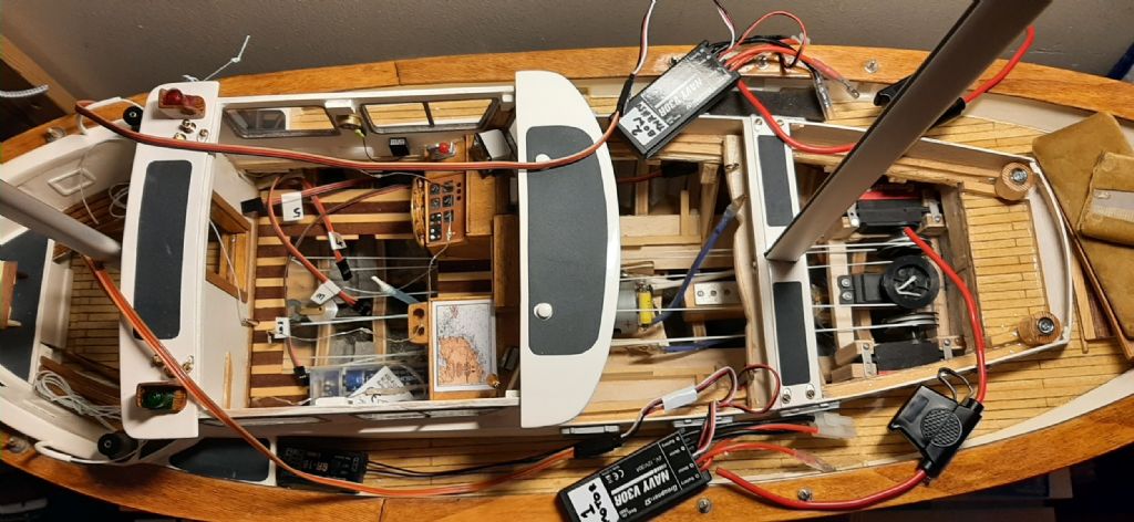

                                                      It's getting even buisier! Decided that it would be best to install the R/C gear before the standing rigging. All that 'string' would probably get in the way of installation work.
                                                      After reading comments about fuses/no fuses, I have bought a couple of water-resistant in-line fuses to reduce the risk of it ll going up in smoke.
                                                      I think I have worked out a possible way to the make a roller furling unit for the genoa. Ordered in some parts yesterday. Googled all over the place for months now but only photos/drawings of full size furling gear on offer.
