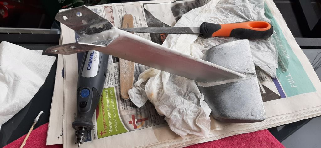

              20210421_152812.jpg20210421_152907.jpgThe shiny raked keel (Moonraker?) has now been removed and the galvanised angle irons have been ecapsulated in 1.5mm aluminium sheet and strategically faired with lightweight epoxy filler.
              There is lots of discussion about painting alu' and/or galvanised steel. Some say rub it down+degrease it and just paint it. Others say special undercoat/primer must be used. I've bought a rattle-can of alu'/galvan' primer which will be tested outdoors in a day or two when the wind calms down a bit. It'll get a dose of the 'standard' dark blue alkyd/enamel ca.24hrs. after that.
