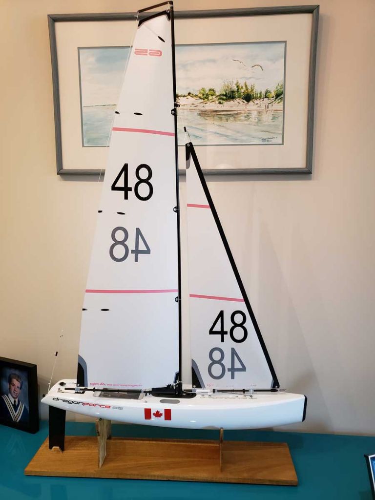

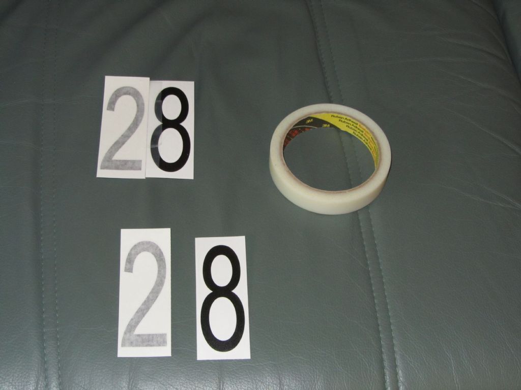

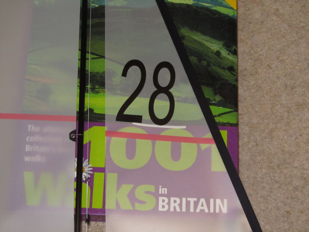

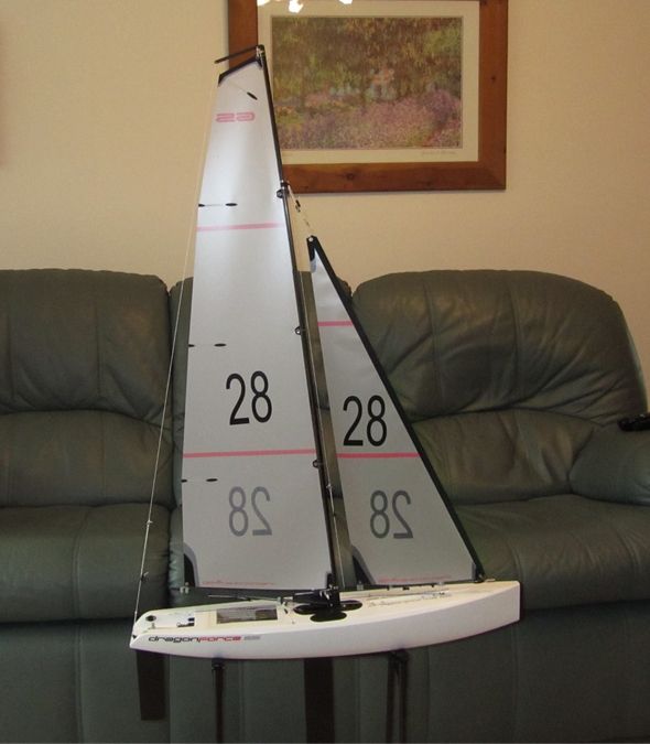

                Being a wet Bank Holiday I've fitted the numbers. I'm always apprehensive doing this. I say always, but this is only the second time, which is probably why I'm apprehensive!
                To ensure that the numbers are correctly spaced and upright to each other (particularly the eight) I first taped them together so that they could be positioned as one. Once I'd decided where to position them on the sails I used some lining tape on the back of the sails (as it comes off easily) to mark the position of the bottom of the numbers and then applied them by pulling off a little of the backing of each number at the bottom and progressively pulling off the rest as I smoothed the numbers down. To save having to remove the sails from the hull I used some thick books to support the sails and keep them flat.
                Top tip. Buy some additional numbers as I did! One of the 2s didn't release cleanly from the backing and puckered up and had to be replaced.

                  I also put my numbers onto my sails, although I cut stencils and painted them on. After I assembled them onto the boat I noticed that my starboard mainsail number was too far back and I won't be able to add a "1" in front if necessary at an event. You may have the same problem on your jib.

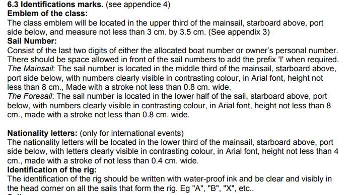

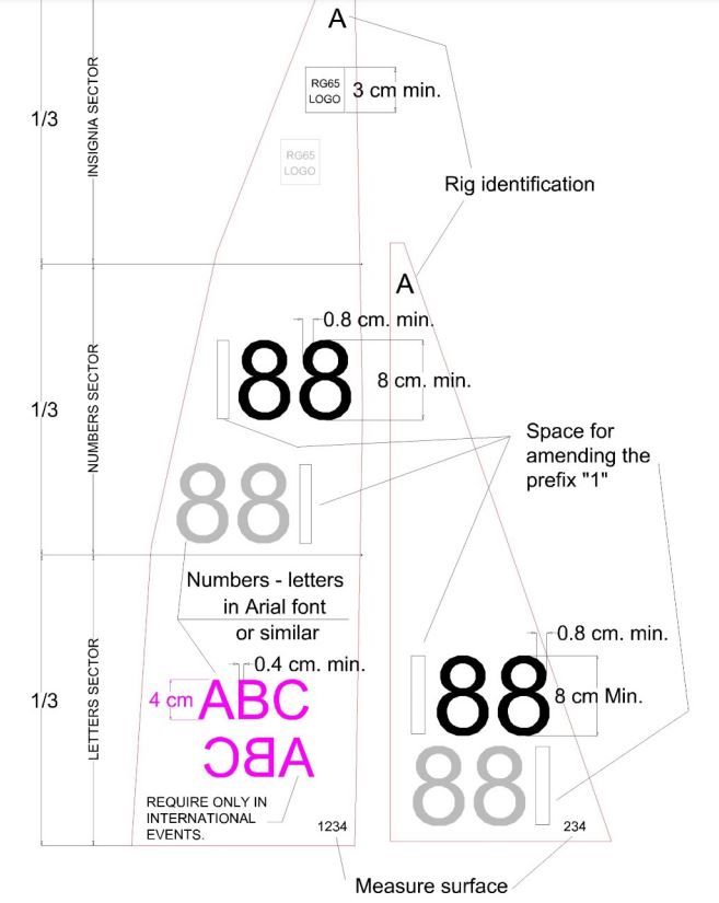

                      A bit of a coincidence, I used my membership number also. Six or seven of us bought DF65's this winter to learn to sail and do some friendly racing so we won't be taking the numbering too seriously.
                      This is what I found on sail numbers:

                      #95256
                        Thanks for posting that.
                        I did wonder if there were regulations for positioning of the numbers. I've positioned mine where I thought they looked best!
                        I doubt that I will be doing other than club racing anyway. I've got Fairey builds to be getting on with!

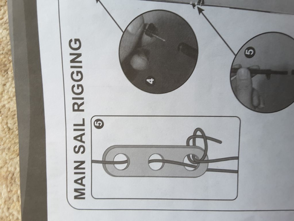

                            Bowsie
                            #95293
                            Eddie Lancaster
                              @eddielancaster
                              Yes totally wrong, I do like the Joysway bowsies but they do have to be threaded the right way round.

                                Yes the DF65 is my first ever sailboat and I was able to use the Joysway bowsies correctly. The design with the little trench between two holes and the pocket at the third hole for the knot made it very easy to follow the instructions for rigging them. Even my fat fingers were eventually able to do the job. I used the Dyneema thread supplied with the kit and I don't see any tendency for the lines to slip.

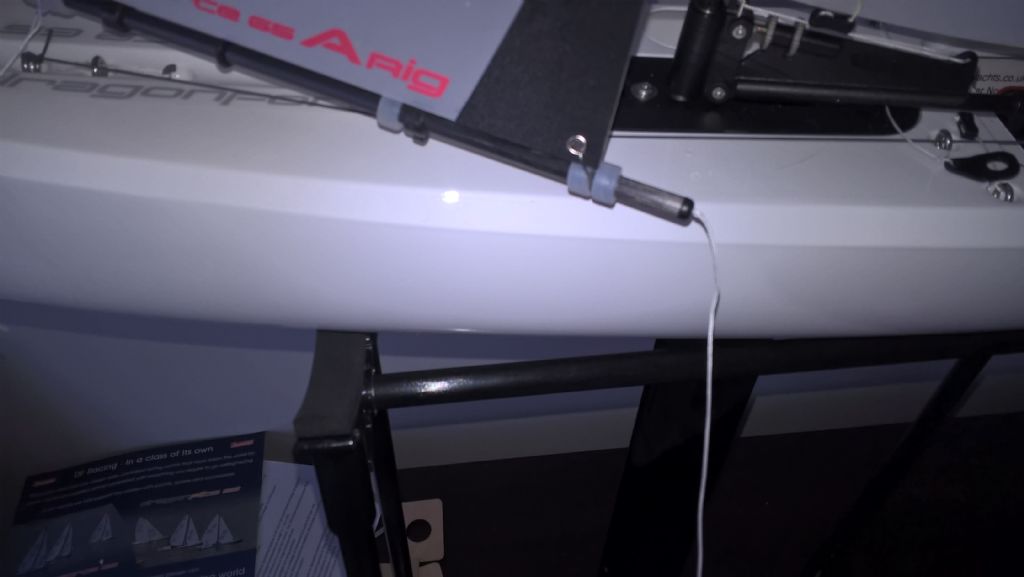

                                  Yet again I am encountering, or anticipating difficulties.
                                  I am at present rigging the Jib. As listed in the "Rigging the Jib" section.
                                  I have reached item 11, cut a 700mm length of Dyneema thread. Attach to the "Fore Stay fitting", se fig. 11. This I have done.
                                  It is what comes next that is causing me some consternation. Primarily as I do not know the "WHY", I fear that something is not understood by me, or what I am trying to achieve. There is a very long piece of Dyneema thread emerging from the Boom. Figure 12 seems to indicate that this piece of thread is pretty short and goes through a ring and Bowsie.
                                  Can I be reassured that all is well, if I only do this or follow the instructions in an appropriate section.

                                    Hi Carl,
                                    I think you'll find the ring is attached to a line down from where the forestay attaches to the mast, this allows you to raise the jib boom for sail shape.
                                    This is only if it's the same as the Dragon Flite, I sold my Dragon Force !!

                                      I found that they seemed to be very generous with the Dyneema thread. Just follow Instruction 12 and picture 12 on page 9 of the assembly manual and your rigging should be done. The ring [in picture 12} ended up being about six inches above the deck on my boat.

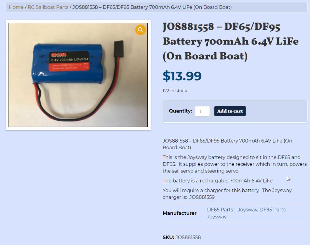

                                          The accepted norm is to use the Aileron stick for rudder and the Throttle stick for the Sail Winch. Try it, you may like it. Also, from the research I have done they seem to recommend a LiFe battery pack for the servos as a 2 cell LiPo pack is too high a voltage. I bought the one offered by Joysway with my DF65 kit. You also need a 6" extension lead if you want to place it in the alternate location by the mast.
                                          #95314
                                            As Steven says a 2s LiPo is too high a voltage. Use either the supplied battery holder with 4 AA batteries (can be rechargeable) or the rechargeable battery pack that Steven shows. The only radio installation is the receiver and connecting the rudder, winch and battery cables to it and then binding it with the transmitter.

                                              Approximately how high is the ring above the deck. At 700mm the ring is not far from the deck. It does seem they have been generous.
                                              The earlier lengths stipulated seemed to be much less than generous. Particularly when tying (double) knots with my pudgy old fingers.
                                              #95316
                                              Steven S. 1
                                                @stevens-1

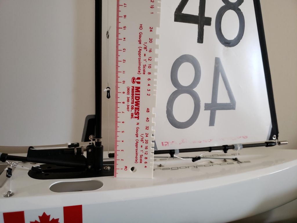

                                                Carl – On my boat the ring ended up about 145mm above the deck, but I don't think it matters much. I think it could be anywhere from 70 to 600mm above the deck and still do the job.

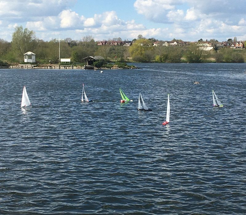

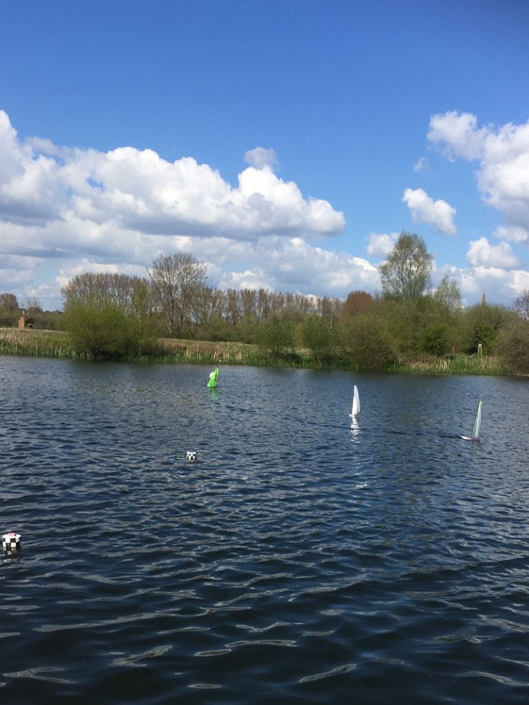

                                                  Had my boat on the water for the first time today. In the morning at Wicksteed Park, there was no wind to speak of and I didn't take a photo, sailed at my new club at Emberton Park in the afternoon, a lot more wind with some very strong gusts that took everyone by suprise.img_1120.jpg
                                                  A lot more water and boats to what I am used to.

                                                    Carl – yes, as said, it doesn't really matter where the ring is positioned as long as you have sufficient run to adjust the bowsie. My other boat doesn't have a ring and the cord is taken directly from the end of the jib boom to the mast eye. I like the idea though and am going to fit a ring.
                                                    Eddie – looks like a nice lake. Racing, even if just for fun, adds a whole new element to sailing. I can't wait to get started again.
