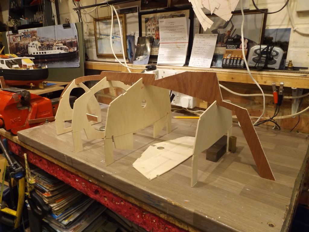

      chez when article.jpgHi All,
      As I hav'nt started a new build this year so far, and having tried in vain to tempt Dave Cooper to build one, I ended up making a start with the bulkheads, She is described in the Radio Modeller in 1971.chez when 2.jpg so here we go again

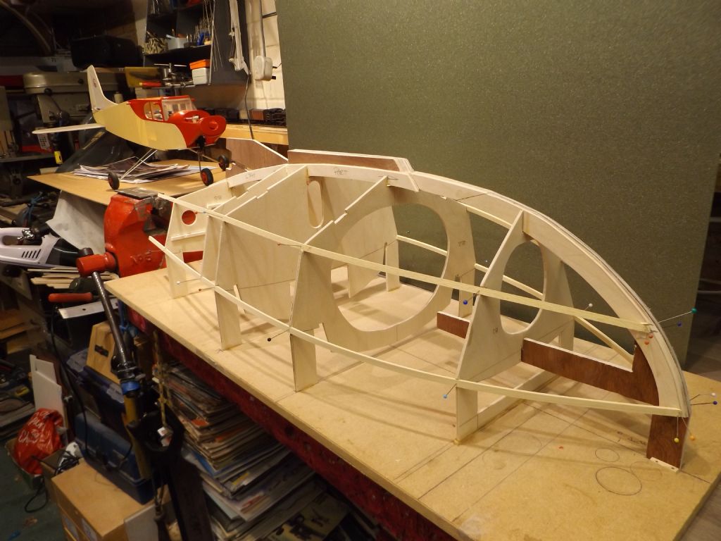

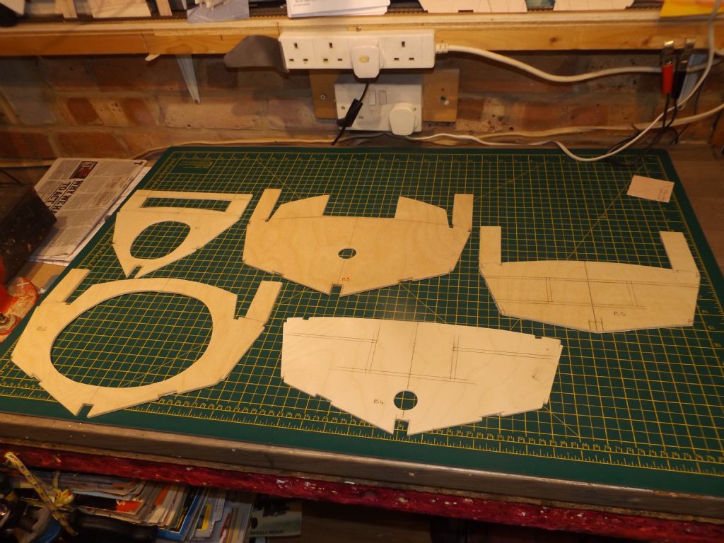

                            Having cut the keel shape with it's extensions I thought I'd have a dry run before I start putting the doublers on, she is going to be a big girl 14" beam, may pick up on Georges idea of fitting an auxlliary motor.

                              Chez W has progressed and is set up on the board, with the keel having provision for a stern tube, and the obeche stringers glued in position, so far so good, some slight adjustments to the bulkheads shape required but that may just be my cutting ! they are all the same but different
                              KK Mini Super progressing in the background.

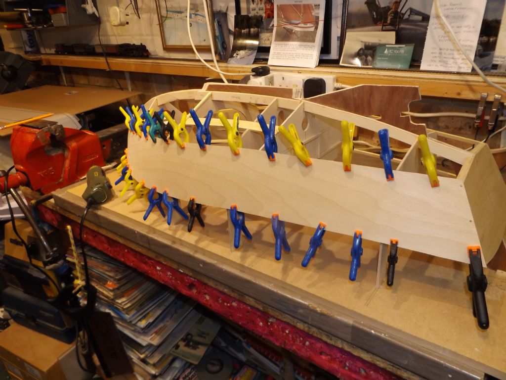

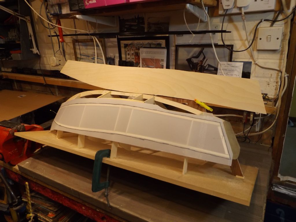

                                            chez template.jpgchez clamps.jpgHi All,
                                            Well my friend Eddie egged on by Tim has just put the Nimbus shadows in the mail to me, I've been well set up here well and trulychez starb ply side.jpg !!!
                                            Some progress on Chez, only for anybody who hasn't done this before a few pointers as I'm still learning
                                            The side skin shapes are taken from the job on tracing paper pinned to the stringers, that is then transferred to the 1/16" ply and cut to shape. Back in the Aerokits days the skins would have been glued and brass pinned to the stringers, but if you have enough mini clamps from Poundland they do the job well ! once the Gorilla PVA waterproof glue has set trim the sides with a block plane, so far so good

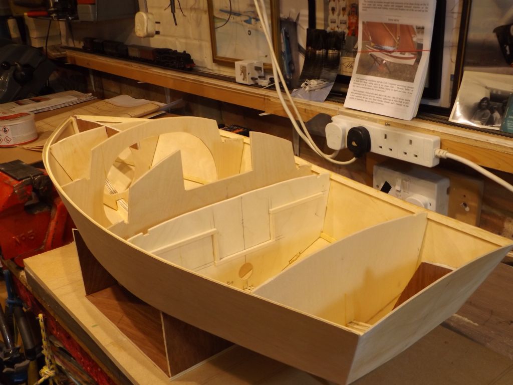

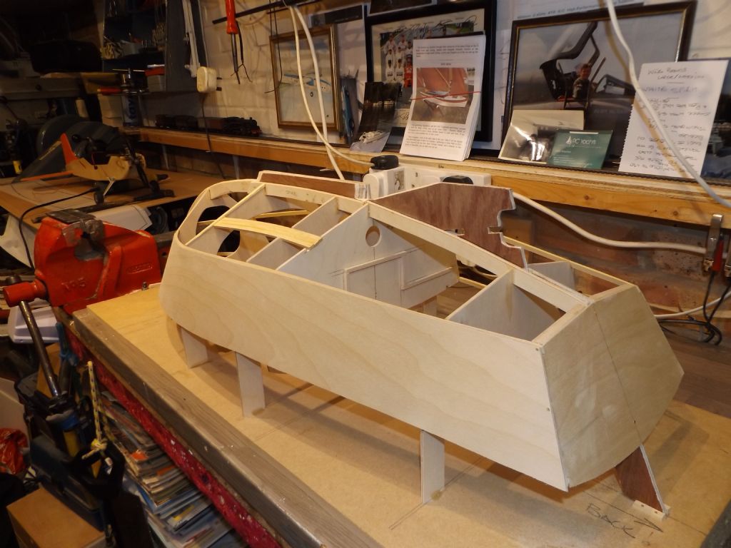

                                                  Well she has made her bid for freedom from the building board with the frame extensions removed and sitting in her stand, tempted to keep going but will be taking a break now while I finish off fit radio to chez hull on stand.jpgsome boats for the new season
                                                  YM Eventide, Osprey trip boat, HMS Cossack, and MS Oldenburg.

                                                    Hi. Ray, that’s a nice curve on the deck line, she will be a big girl with that broad beam laugh.
                                                    You will be busy this Easter with four new boats to launch and trial, as long as Admiralty will allow.
