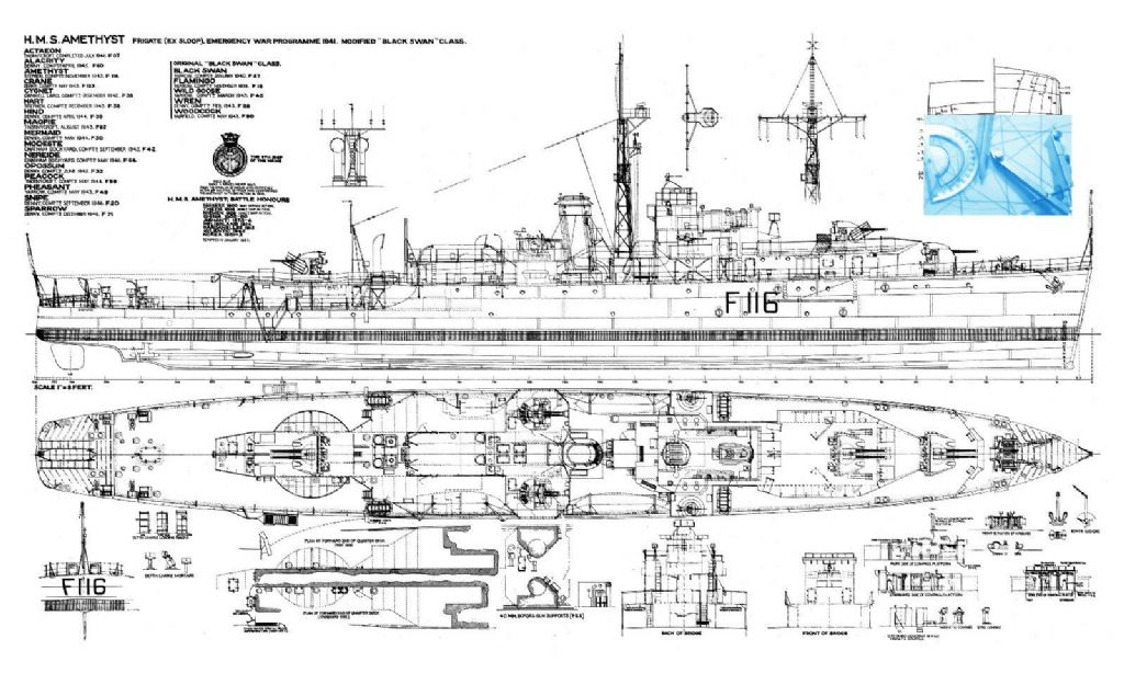

                I think that I have created an album and uploaded a copy of a plan that I came across which originally had the cross sectional drawing in the top right hand corner but it has been obliterated.
                If anyone recognises the plan, perhaps they can send me a scanned copy of that particular section.

                  Hi Peter,
                  The drawing you are looking at is by Norman Ough. The Brunel Institute in Bristol holdes the Norman Ough collection but copies are not currently for sale although they can be inspected. Somebody on EBay is selling copies though, probably reproduced from the original magazine article and offered for sale as a digital file.
                  64AAOSwTuJYv0dt”>https://www.ebay.co.uk/itm/Model-Boat-Drawings-Scale-1-96-WW-II-H-M-S-Amethyst-Build-Display-or-R-C/302973966770?hash=item468aa7d9b2:g64AAOSwTuJYv0dt
                  Sarik Hobbies sell the Vic Smeed design in their collection which also includes a body plan.
                  Whether either of these will match the hull in your posesssion rather depends on which drawings Deans used as a basis for the kit. Neither Norman Ough nor Vic Smeed are likely to have used the original plans which are probably still held by the National Maritime Museum. I suspect you would find that they differ in some respects from each other and from your GRP hull.
