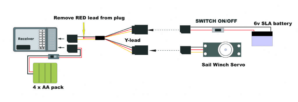

I have need of some advice, as regards to radio wiring.
I have at present, a 6v sla battery powering the whole caboodle, but what I would like to do is, use the 6v sla to power the sailwinch, but have a seperate AA pack for the reciever & rudder.
I just don't know how to wire the 2 power packs to the reciever.
