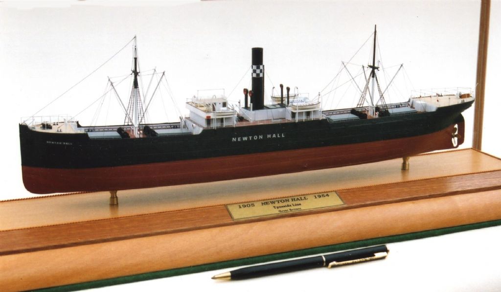

                      #88017
                        @bobwilson59101
                        Pete,
                        I print white names on a black background in a normal word processing programme. You can just abou see it here.
                        #88018
                          @bobwilson59101
                          And rather better here:
