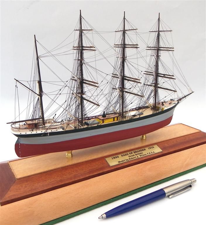

                          Look at this, the huge 2,127 ton Pass of Brander, a steel four-masted barque of very full hull lines, completed in 1890. In 1909, she ran from Cardiff to Callao, Peru around Cape Horn in 58 days, covering a total distance of 10,033 miles, giving an average speed of 7.2 knots. Probably with several thousand tons of coal as cargo. With steel masts and rigging, those big ships could really be driven far harder than flimsy wooden clippers and their average speeds were quite respectable as well.

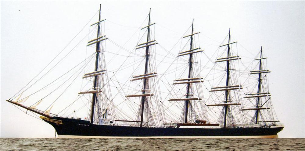

                              The big iron and steel ships had large sailrooms usually inside the poop deck. They usually had a brand new suit of sails that they would save for the hard weather parts like rounding the Horn, or winter North Atlantic, and a suit of worn sails for everyday use in warmer climates, plus a vast amount of new canvas in bolts two feet wide that the sailmaker could make new ones from. All folded up, they didn't take up all that much space, but were very heavy and hard to handle. But they didn't take up as much space as a steamship engineroom and the coal bunkers, so all of the hull below decks was open for cargo. A ship like the Preussen, below, could carry 8,000 tons of cargo –

                                  The Preussen had about 26 miles of rigging! But ships like Preussen and Pass of Brander had steel masts and spars and most of the rigging was steel wire, so they could really be driven hard, but even so, they could not compete with 10-knot steamers. In my models, the masts, spars and rigging, including the ratlines are 100% metal, the rigging being fine copper wire. No knots anywhere! The 900-ton barque would have been rigged with rope, but in the model, it is all copper wire.

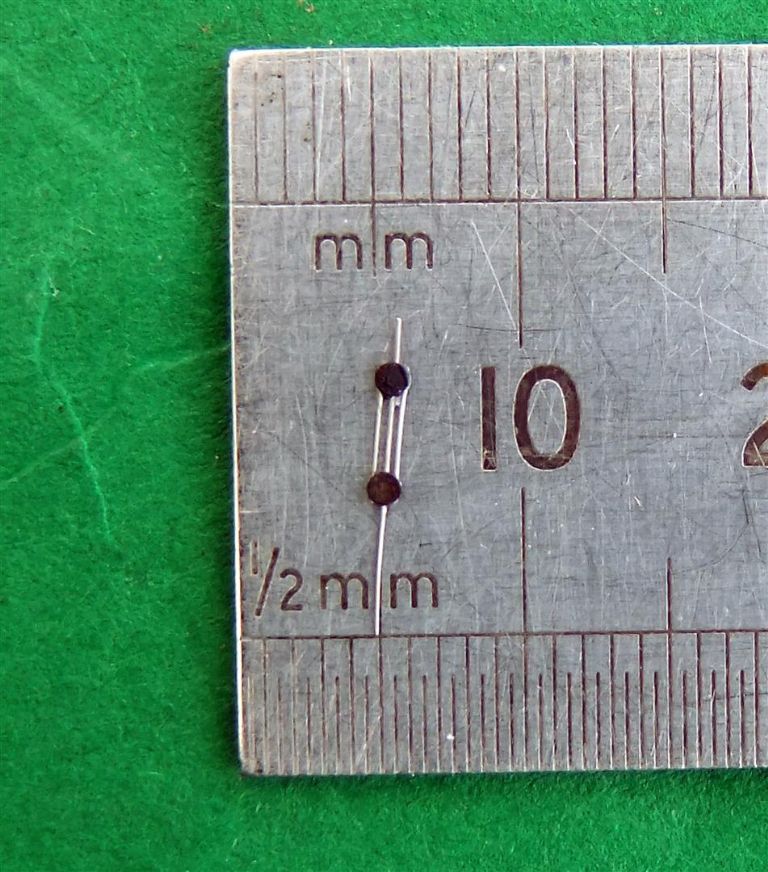

                                            In a word Bob. how do you manufacture your deadeyes ….17 in 20 mins. sounds like mass production.
                                            I used to make mine from kids brown coloured mini. plastic knitting needles, sliced , and then drilled with the 3 holes. They didn't have the radiused face though and I don't think anyone noticed except me!
                                            Pete.

                                              38 swg tinned copper wire wound on a small frame spacing via two 8ba bolts top and bottom. Small paper circles stuck on. When dry, cut the two outer wires from top and bottom, leaving just the centre ones – All very simple, and you couldn't really use this method for large models, but it looks great on miniatures.

                                                Thanks Bob, An absolute bulls eye mix of perfect authenticity and a very simple method……I think of my own approach to miniaturism as being quite inventive but I would never have dreamt of this solution.
