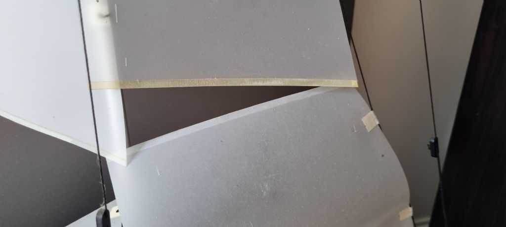

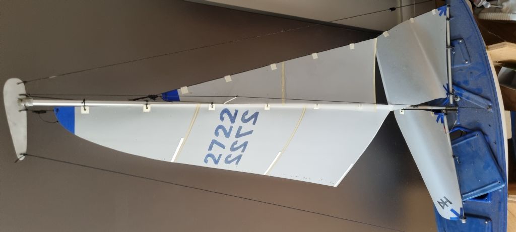

        I'm looking for some help with the sails on an old 540 model yacht. I have three sets and they are all made up of individual panels. These seem to have been stuck together with some form of double sided tape which has now let go. My question is, what do I use to stick them back together?

          At the risk of being obvious, but cleaning off the old gunk and using more double sided tape would be easiest.??
          Not a sailman myself, but what are the sails made from?? Plastic or something…Mylar perhaps.

            Ashely has it about right. I make sails, so clean off the old residue and use new double-sided tape. If it is Mylar you can use acetone to get rid of the old stuff. If not, use white spirit.
            You could make the overlap of the joints a fraction wider. You will lose a small amount of luff length if you do. The most important thing is to reinforce the join at each end to stop the "peeling" effect. The best material to use is Mylar tape on films. On woven materials I use deck patch or sail number material. Cut out a disc or a diamond shape and fold it over the end of the join.

              The original sails were one piece of drafting film not panelled, your boat looks like it may have been raced, 3M invisible tape would work on film but you may haver to tape both sides.(not as good as the tape Tim uses)

                  Looking at your photos, there is reinforcement around the eyelets. Same sort of thing like I said is required at both ends of the join.
