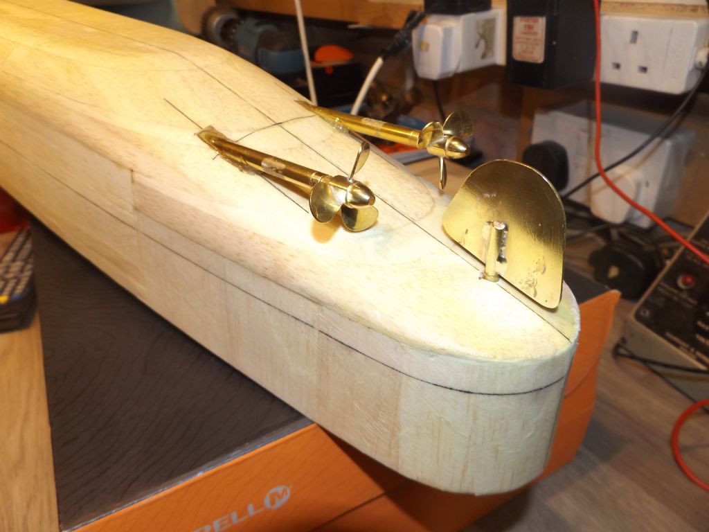

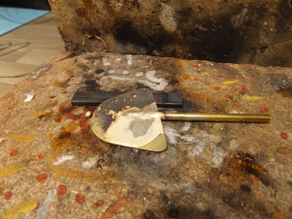

                  coss rud 1.jpgcoss rud 2.jpgHello Cossacks,
                  Back to the steering department, looks like the single rudder on the plan is correct, and to be honest the only option for a kwik build. so with some brass rod, tube and small piece of 18g brass sheet all traced and cut to shape, silver soldering is the strongest method of soldering with the job really clean, Easyflo flux as a paste with water on my trusty fire bricks and lamp we have a rudder

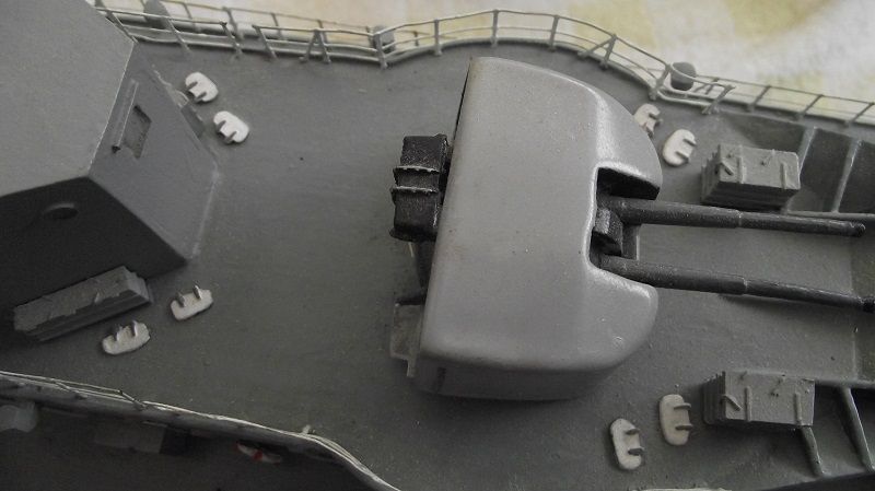

                    Do these help Ray?

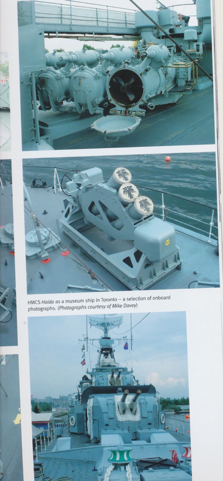

                    Turret front: (the sharp end wink):
                    and the rear:
                    Regards
                    Roger

                        Hi Roger,
                        Thanks for those pictures, I think the original Tribal turrets were replaced on the surviving ships after the war, I have found some pictures of the removed turrets from an Australian Tribal.Regards

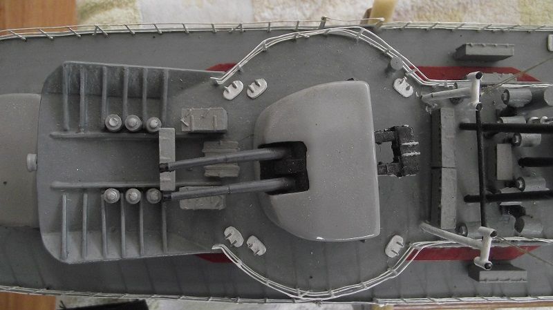

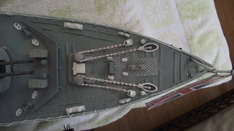

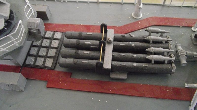

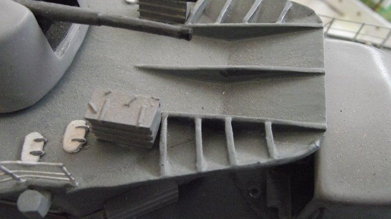

                            Hi. Cossacks, further to the above photos here are some of a Deans Marine 1/96 Cosack.
                            The rear hatch over the rudder stock.
                            Torpedo tubes amidships.
                            Forward upper gun.
                            Forward blast shield.
                            Anchor winches.
                            Hope these are of some help, I have more of the superstructure if they will help.
                            Regards to all.
                            Eddie.

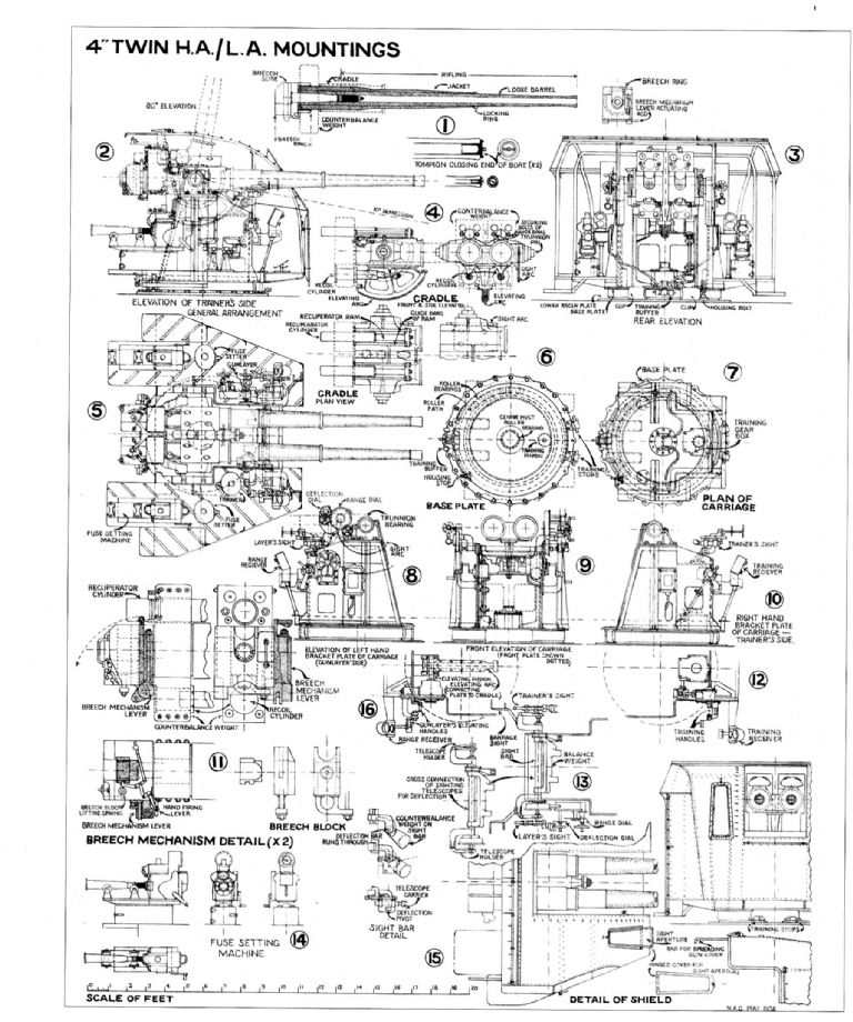

                                #83687
                                John W E
                                  @johnwe
                                  Hi Ray will this help you out ?
                                  it is from the Norman Ough book

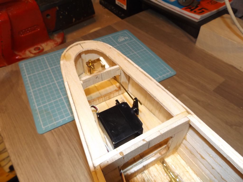

                                                Hi John,
                                                That's good news, we are not rushing the build, and we all have other ongoing projects, variety the spice of life and all that 😀
                                                I put the rudder servo into Cossack last night so the moving parts are well on the way now before starting the decks & superstructure.

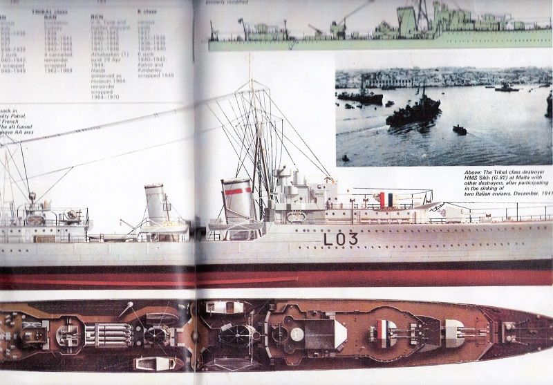

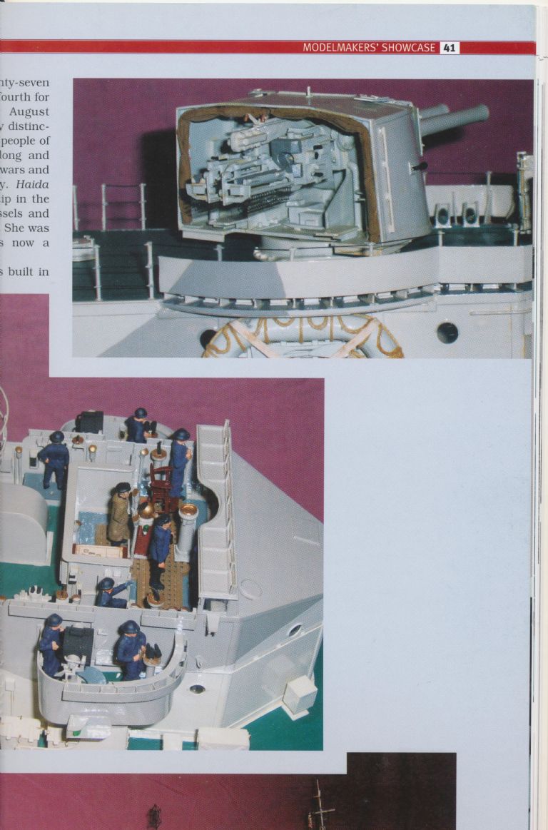

                                                    Back to Cossack, here are the pictures of Cossac I mentioned ealier.
                                                    This last picture is across the centre of the book so is distorted, but all the pictures should give an idea of the layout and position of all the deck elements.
                                                    Regards.
                                                    Eddie
