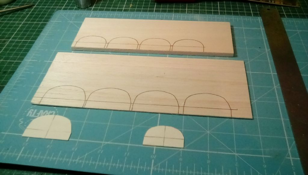

        The great thing about a larger ship project is the ability to build some others parts which will be needed later, so having a Go at the gun turrets 😀

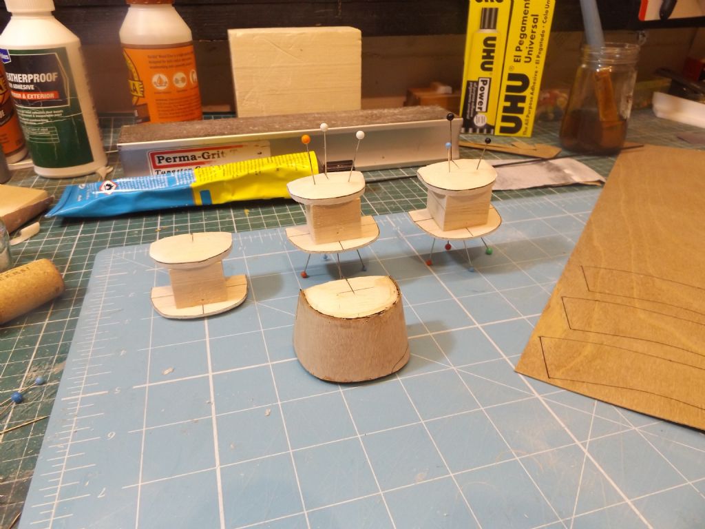

              Good Evening holiday makers & Cossacks,
              Something about being by the water is so attractive & expensive 😀
              Turrets simple balsa make up, I thought 1/64th ply wrapper was a good idea at the time, not sure now 😀 still it gives a fine surface, may have to turn some 1/8th dowel for the gun barrels.

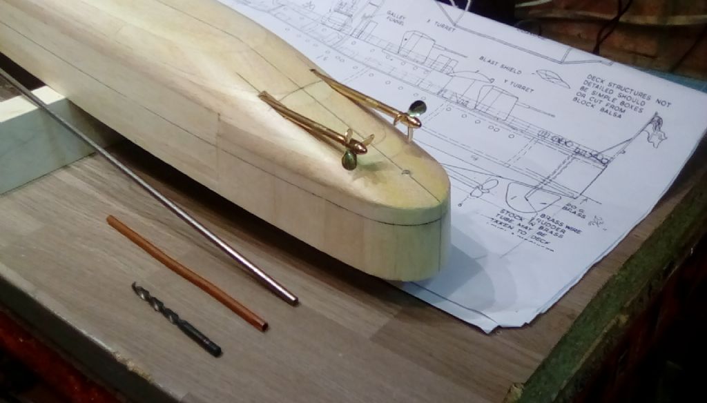

                        Evening Cossacks,
                        Long procedure starting with 1/4" drill then some copper tube sharpened then a length of bright mild steel rod with some slots cut in the end and a lot of luck 😀 2 long holes drilled for the stern tubes, and try the props for size & clearance. So far so good !
                        #83530
                          Yup, nothing like a bit of controlled violence to achieve your ends. (both of them!)
                          #83532
                            That's very neat Ray considering the level of violence used! Ashley

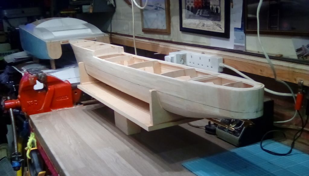

                                      Evening Cossacks,
                                      The only down side of the thick base planks of this type of construction is the cutting and carving required to get the 385's low enough to keep the stern tubes as low as possible for scale effect, here she is on her mdf stand going to keep her on an even keel 😀

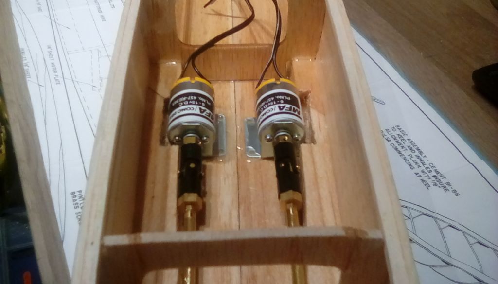

                                            Hi Cossacks
                                            We have power in the engine room, single rudder next 😀
