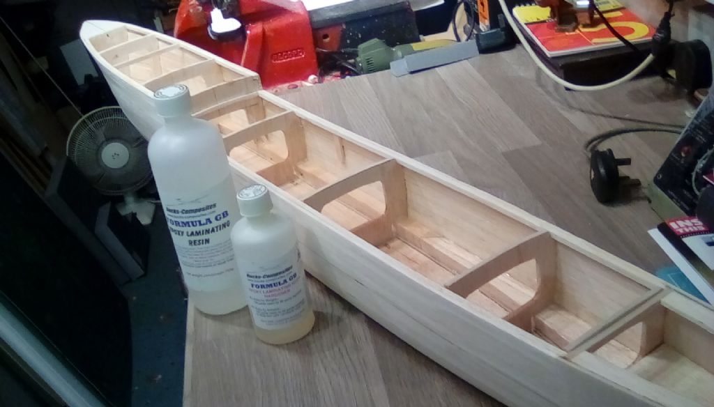

                    Good evening Cossacks,
                    Not much progress this weekend, put a coat of Bucks Composites laminating resin in the bilges, just to protect the Balsa 😀

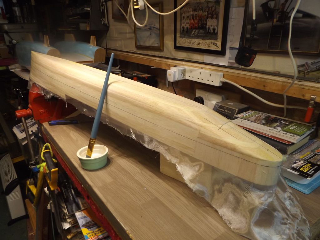

                      coss waterline.jpgHi All,
                      Here is my way of marking the waterline, and with the clingfilm wrapper the first voyage in the bath !! without the ballast in this photo, I'm going down the lightweight glass cloth and water based resin sealer on the hull, less messy than epoxy

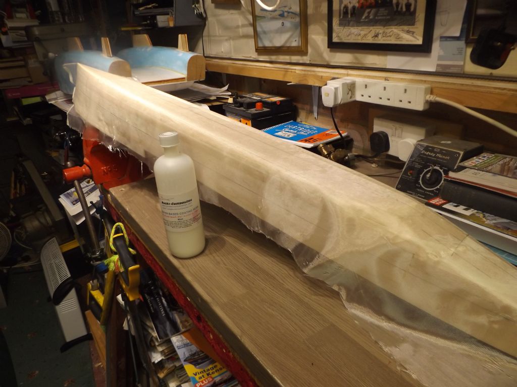

                                        coss 1408 cloth.jpgHi All,
                                        Trying the water based resin from Bucks Composites is much easier to apply, but I probably need 10 coats to build it up and fill the weave in the lightweight glass cloth
                                        Trimmed off the excess cloth this morning looking good so far, doing the other side tonight.
                                        #83446
                                        Boiler Bri
                                          @boilerbri
                                          Hi Ray, I have not seen that covering before. Does it shrink to the shape?
                                          Brian
                                          #83447
                                            Hi Brian,
                                            Primarily been used for covering model aeroplane wings , no shrinkage involved just brush the resin through it. Takes compound curves well. Epoxy resin maybe slightly stronger, but is in my experience a messy expensive experience.
