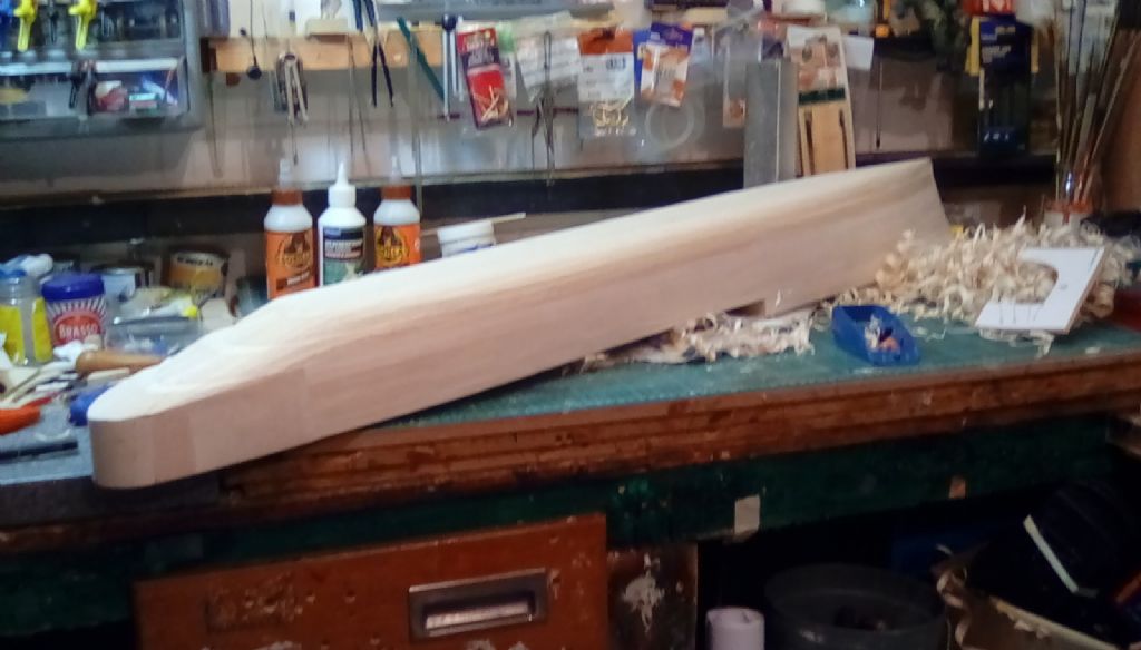

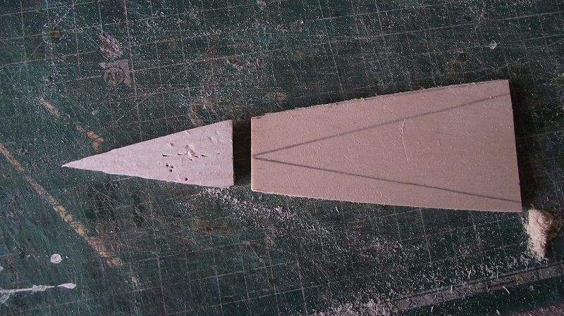

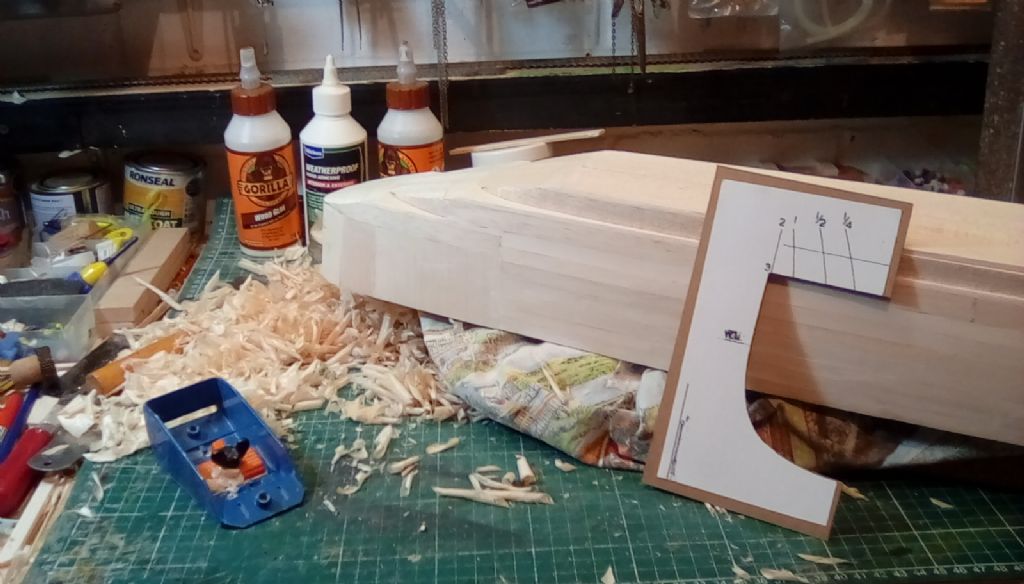

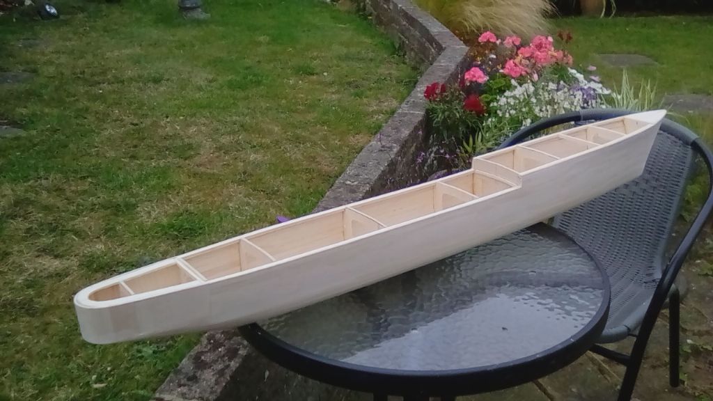

                              img_20190803_082136.jpgGood evening Cossacks,
                              Been doing some planing and sanding today she is beginning to look ship shape now 😀 David razor plane, Permagrit block and fine glass paper most useful.
                              Edited By Ray Wood 2 on 03/08/2019 19:39:14
                              #83249
                              Boiler Bri
                                @boilerbri
                                Taking shape Ray. Soon be on the sanding sealer. 🤗
                                #83250
                                  Hi Brian,
                                  Yes we are getting there 😀

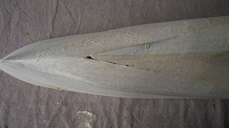

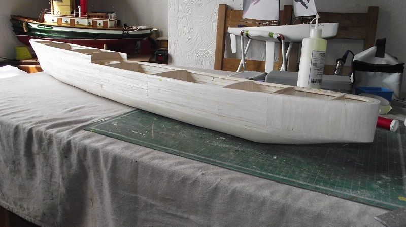

                                          Eddie Lancaster
                                            @eddielancaster
                                            Hi.All, had a problem this morning, I sanded through the hull bottom at the bow!
                                            But it was soon fixed with a couple of pieces shaped to fit inside the hull, and then off to Dunelm for a coffee and bacon bap while the glue driedsmiley.dscf3607.jpg
                                            Finished sanding the rest of the hull using the hull profiles to get the right shape, I hope,
                                            It's ready for some filler now were the planks are not quite aligned with each other.
                                            As you say Ray very satisfying building from scratch, even with a vacuum cleaner full of balsa wood dustfrown.
                                            Regards.
                                            Eddie.

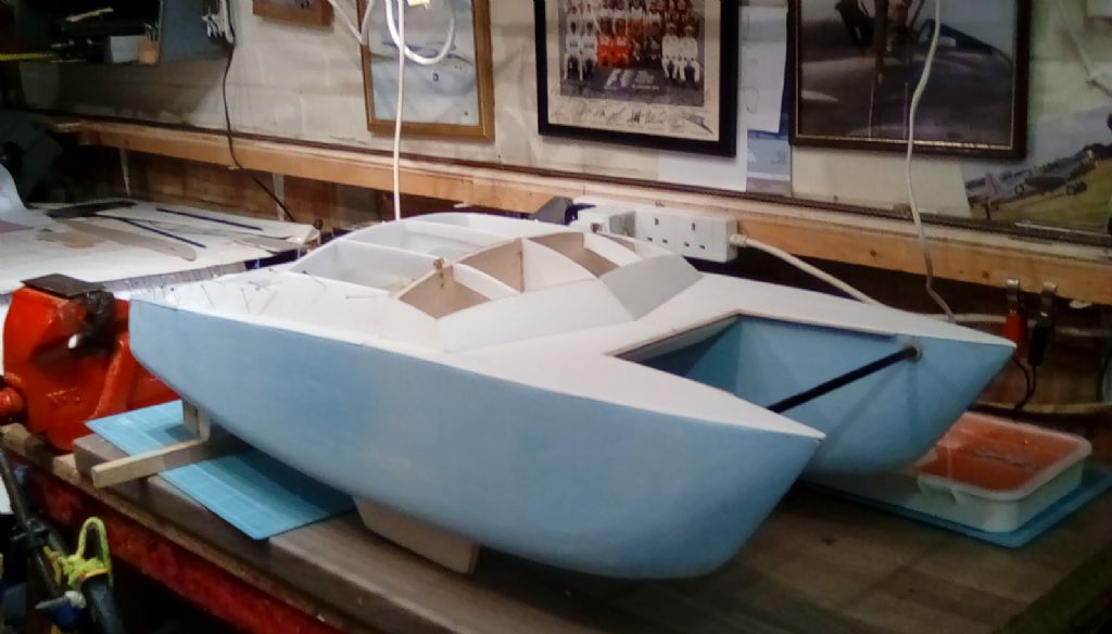

                                            #83312
                                              Well done Eddie,
                                              These things happen 😀 I've used a fair bit of filler on mine, good tip from you regarding Inwoods at Huntingdon popped in today on my way back from site I'm involved with at Holbeach Lincs, only 3 1/2 hours from Maidstone 😀
                                              Buying Depron sheet for my cat superstructure,
                                              Are you pressing on with the deck ? I'm going to buy the motors and shafts this weekend to get them installed while I have good access prior to putting the lid on it.

                                                #83314
                                                  Hi Eddie,
                                                  There and back in the day ! Only been nicked for speeding once so far 😀 I think the Jontika standard stern tubes about £8 is what I use, only oil them no problems.
                                                  I'm going to wrap the hull in cling film and float her to establish how much ballast is needed, so I can build it into the base before I glass cloth the hull, Well that's the plan 😁
                                                  Are you still sailing barges 1st September at Herne Bay ?

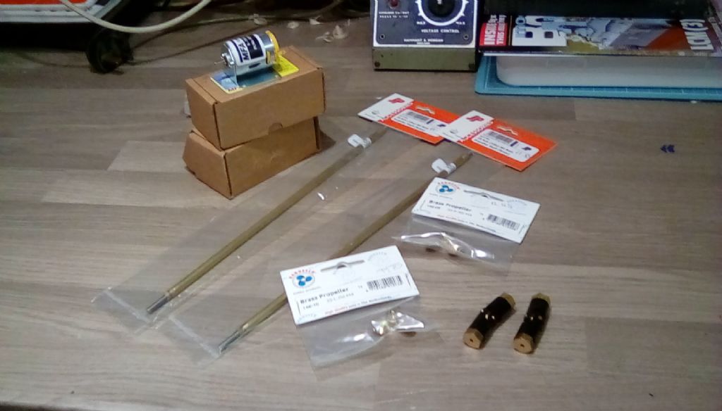

                                                      Hi Eddie,
                                                      Popped over to see Rob who runs the Dockyard Model Shop at Chatham and splashed out on the expensive bits, interestingly he said more & more folk building from plans these days as they are not willing to pay £300-400 for a kit of bits. Interesting but common sense 😀 I will weight all the parts for ballasting as I go along hull currently 450g.
