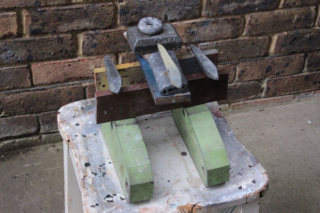

          I'll raise you Eddie, this is what weights look like….

              Those two big green weights at the bottom weigh a ton! I'm told they are balance weights off a Boeing 747. I've had them over 35 years. I think they are tungsten and not depleted uranium! (hopefully!)
              They are really useful for all sorts of things but drop one on your foot and you are looking at jam!

                One way to find out if they are tungsten as in tungsten carbide is to take try filing one of the blocks and if it takes the teeth off the file, you know its tungsten, but, don't drop it on your foot surprise – John

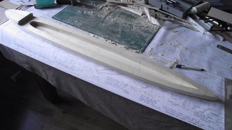

                      Put the frames on then you can fair them into the bottom planking. This form of construction is simple and economical in materials and you can correct errors by adding extra material if needed.

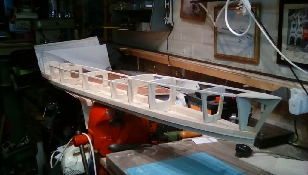

                                I thought I'd start at the sharp end and work to the stern with the bulkheads with notches out for 3/16" square inwhales to give the deck a better fixing area, also made the stem from 1 /16" ply to make it more sturdy 😀

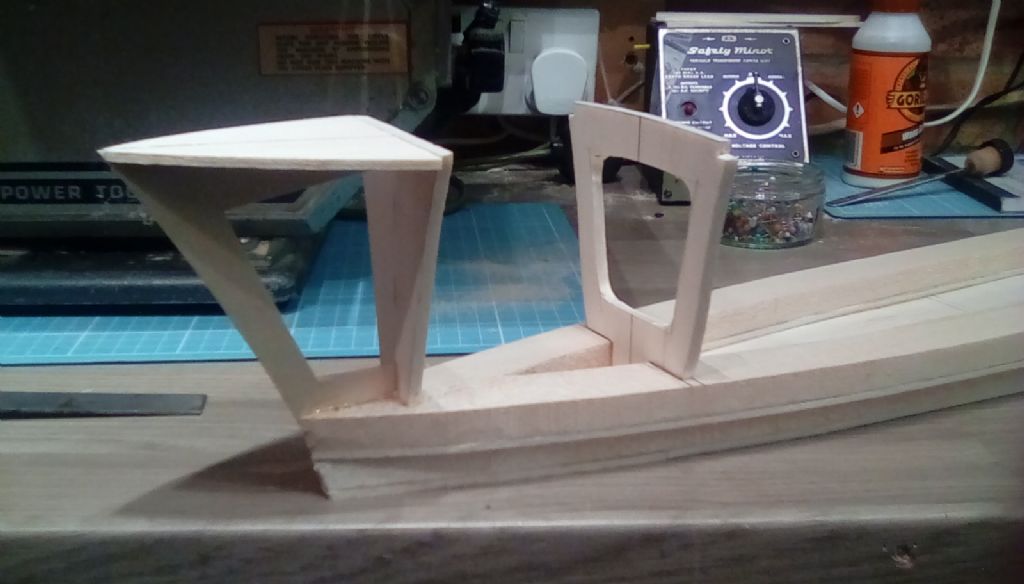

                                  Looking the part now, using the strip at the deck edge gives you the chance to see how wonky the bulkheads are and eye them through and make adjustments, the stern is going to be interesting as she wasn't designed for access to the rudder. As designed with a single rudder, but as she will have twin screws I think we need twin rudders? Space is tight and access has to beimg_20190720_211157.jpg allowed for, so plenty to think about 😀
                                  #83069
                                    I think the original ships had single rudders. From what I remember of my Cossack build, space in the stern was very tight and I think it might be difficult to fit non scale twin rudders.
                                    However the two shafts were quite close together so a single rudder might still be quite effective if the blade intercepts the water flow from the props.

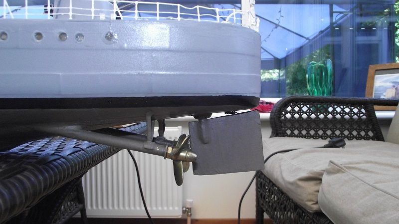

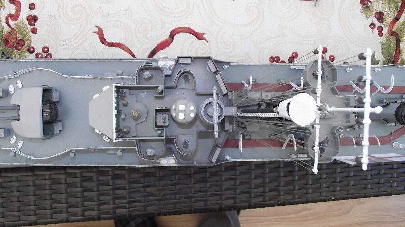

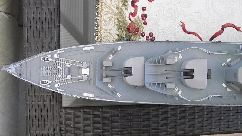

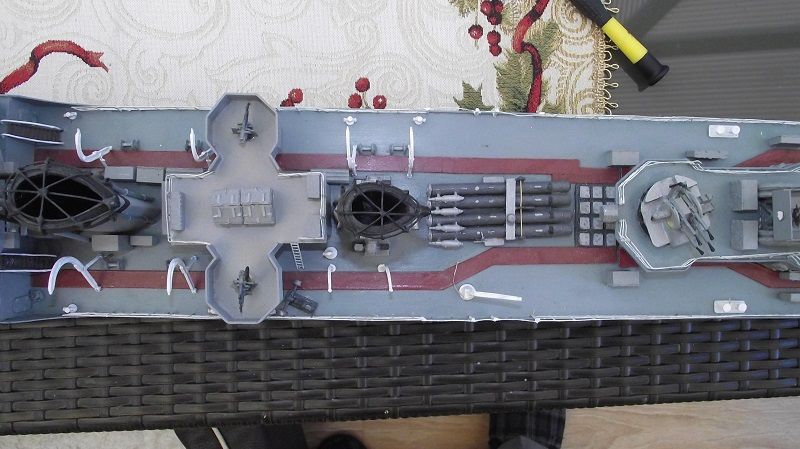

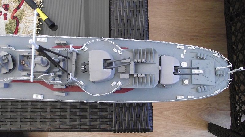

                                          Hi.All, some photo's of my friends Deans Marine Cossack to 1/96 scale.
                                          The rudder perhaps over scale at 1 3/4" long X 1 1/2" deep, but it works well, the shape is correct as it was taken from an original blue print.
                                          The rear gun deck.
                                          The mid section, the red areas are raised walkways for the crew for when the decks are awash in heavy seas.
                                          The bridge.
                                          The bows and fore deck.
                                          I hope these are of some use to you all.

                                            Hi Eddie,

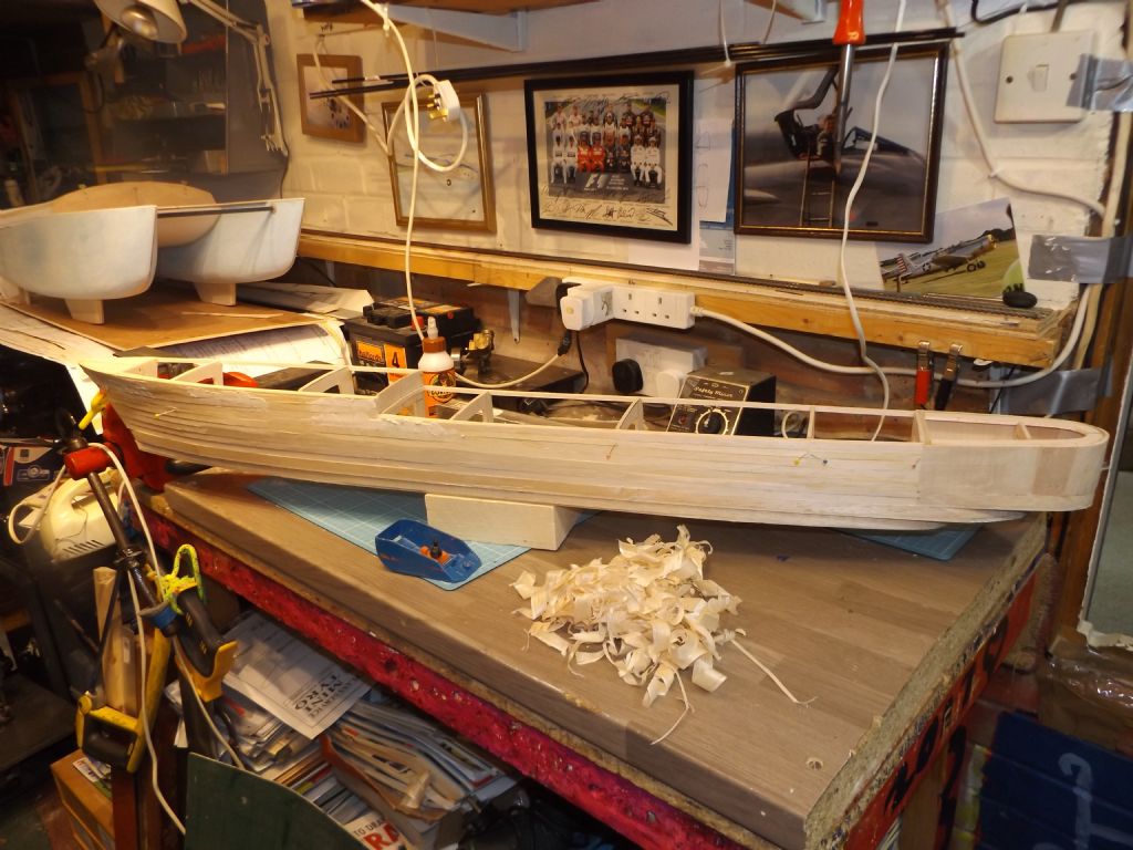

                                                    Yours is looking good I must admit, and what is that lurking in the top right? a sailing catamaran?
                                                    Edited By Roger Clark on 24/07/2019 13:34:02
                                                    #83123
                                                      Hi Roger,
                                                      Shall I get the enlargements and send them to you ? It would be good to see some more Cossacks being built 😀
                                                      Yes long running catamaran project coming along its a 1978 Comanche 32 bit of a challenge to keep it light, just ordered the sails from Frank at Nylet so I'd better get on with that aswell 😯
