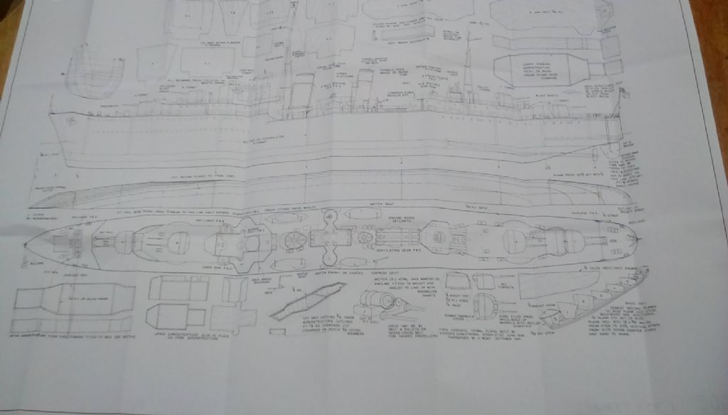

                        Hi Cossack's
                        My plan has arrived 😀 I may have to cut it in half for my local print shop to enlarge 127% to 96th scale.As their machine will only print A1 width.

                          #82880
                            Hi Eddie,
                            Receiving the drawing was like meeting an old friend again after 50 years since I built her the first time in 1969 , good level of detail, I think we have picked a good design. 😀

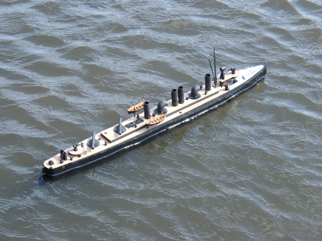

                                                  #82913
                                                    Getting the weight at the bottom is paramount (my opinion) unless you like building models that can only sail in calm conditions.
                                                    My Hasty has a steel flat keel & large bilge keels, and is very stable even in choppy weather. I have seen a pukka very nice TBD that whilst the dogs wotsits in the scale department, looked as if it was about to fall over just sitting still…
                                                    hms hasty TBD
